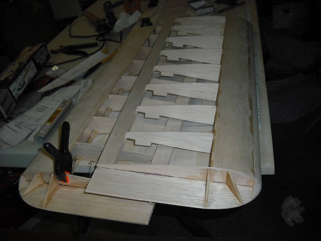

Did some flying this morning then back on project. Much time needed for shaping the leading edge. Using quarter round balsa stock would save time on this.
Cutout wing tip components and assembled before attaching to wing. Next I'll join the wing panels, finish sheeting top/bottom, apply rib cap strips and webbing between beech spars. Need to decide whether to use two or single aileron servos.
