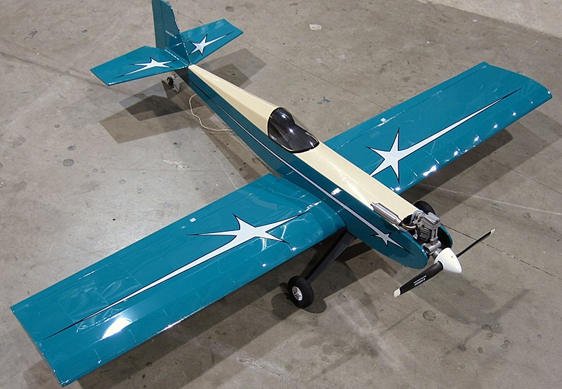

I have a Four Star Forty that I dearly love and am looking to build another one. My question is whether or not anyone has tried sheeting the wing from the leading edge back past the main spar? That would obviously add a lot of strength to the wing but at what cost? Would it adversely affect the flight characteristics of the airplane?

The additional weight that such a modification would add would be marginal in the overall scheme of things, and the benefits derived would certainly outweigh any possible negative.

I agree. I don't think you are going to gain enough benefit to justify the added weight you are going to get. The best mods for a 4-Star, in my opinion, are cutting a couple bays off the ends of the wingtips and take out some of the dihedral out of the wing. Doing those mods will really wake this bird up and make it fun to fly, but still keep it tame enough for newer pilots<div>

Most of it!! The sheeting of the wings LE I have done several times. Strength added, not much, people not sticking fingers through the covering and breaking stringers priceless. Removing a couple of bays outstanding roll rate!!

I've always built D-tube wings. That sheeting will most likely be in front of the balance point, which will be a good thing in most cases. The added strength and ease of handling is worth every gram. Weight? Maybe an ounce. The best thing to do is throw that lite ply in the trash. It is heavy, weak (for plywood) and usually warped.

I always leave in a little dihedral, I'm not an aircraft engineer but the next kit I build like an Extra or Kaos that has no dihedral will be the first so I figure if they have it then who am I to remove it. Even if I lay one side flat and add a block of about 1/2 inch to the other that adds a little. I block both tips though so you do the math.
I have a sheet of 1/32 door skin I use for the LE and turtle decks on the 4*s but also use contest grade 1/16 balsa. Both are light weight but the sheeting is thinner.

OK, here's my plan. I am going to build the wing with sheeting on front 1/3 of wing. I am going to shorten the wing by at least one bay. I am going to remove most of the dihedral. I am going to put servos in both wing halves for the ailerons. Will it fly?

One of the things I did to mine as to add some 1/4" tri stock to the leading edges of the ailerons, rudder and elevator for two reason. One, so I didn't have to sand that bevel in the trailing edges and two, just to add a little more area to the control surfaces. And then I used a canopy from a SSE. It was an awesome plane until the covering took a dump.

GB, thanks. Tip plates should help the roll rate even more. Itwould make a good trainer. I've used a Sig Somethin Extra for a trainer.
