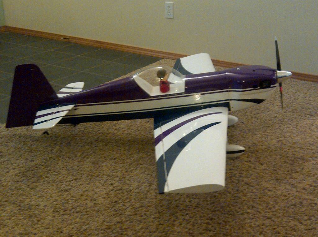

Finished and maidend my GPCap 232.
I bought a GB Cap 232 kit from a fellow club member.
It took me about 8 months to build it. Family and a full time job can get in the way of more important things like my hobby...
This was only my second RC kit build. I have built a few control line and rubber powered planes when I was in my teens and twenties.
Everything in the kit seemed to be good quality except for the plastic parts (cowl and wheel pants).
The build was straight forwared. My only modifications where extra reinforsment to the fire wall and landing gear bracing. I also reinforced the cowl with nylon cloth and epoxy.
I used an O.S. 70 surpass that I got off ebay. After I adjusted the valves it ran very well.
I maidend the plane last tuesday.
Ran it up and down the runway a few times to make sure it tracked staight.
It pulled a little to the left but was very managable and evan lifted off the ground unexpectidly for a few feet.
Then came to moment of truth. It took off the ground effortlessly, and I only had to give it a few clicks of down for trim.
this plane is a dream to fly. Very smooth and responsive. I did not get too aggresive on the first flight. I did do a few rolls and it tracked level through the rolls with out giving any down
on the elevator when it was upside down.
landing was very smooth. I was able too slow it way down and it settled down as smooth as butter.
However, on my second attmept to take off the, long grass caught on the wheel pants and flipped the plane which resulted in a broken vertical stabalizer.
I was able to fix this by the weekend and I flew it again yesterday.
Again, it was a dream to fly. Too bad they don't make this kit any more.
However on my landing the wheel pant broke and went inverted on the wheel which acted as a brake and flipped the plane over and broke the vertical stabilizer again.
I fixed it last night and removed the wheel pants.
If I where to build this kit again, the only thing I would do differently is reinforce the vertical stabilizer and wheel pants.
I will try to add some pictures.

Sounds great and it was a good kit. Back in the olden days there was a bit of a problem with the Cap's, we called them Snaps for a reason. On landing, if you slowed down just a tad too much the plane would snap on you without any warning at all. I still have/had an old kit built 80 inch Cap that will snap on me if I slow it too much. It's in storage.
Take your plane up high and slow it down like you were landing several times to see if your plane will do that.
The designers of kits and ARFs made some changes or improvements to the plane and seemed to have removed that little problem. I just don't know who or when the improvement was done?
Just an FYI. Mine doesn't give a wing rock like an Extra, it just does it, instant snap. By going high I learned what the speed was where it did it's thing and never fly that slow. My old kit was cut in Mexico years ago.
Back then the plane had a bad rep but the one's I have flown the last few years hasn't had a snap problem at all!!

I tried what you suggested.
I took the Cap up high and slowed it down to a crawl. It did not snap at all. Once it slowed down to a certain point, it would start sinking but it was very stable.
This is defianatly the favorate of my planes.
