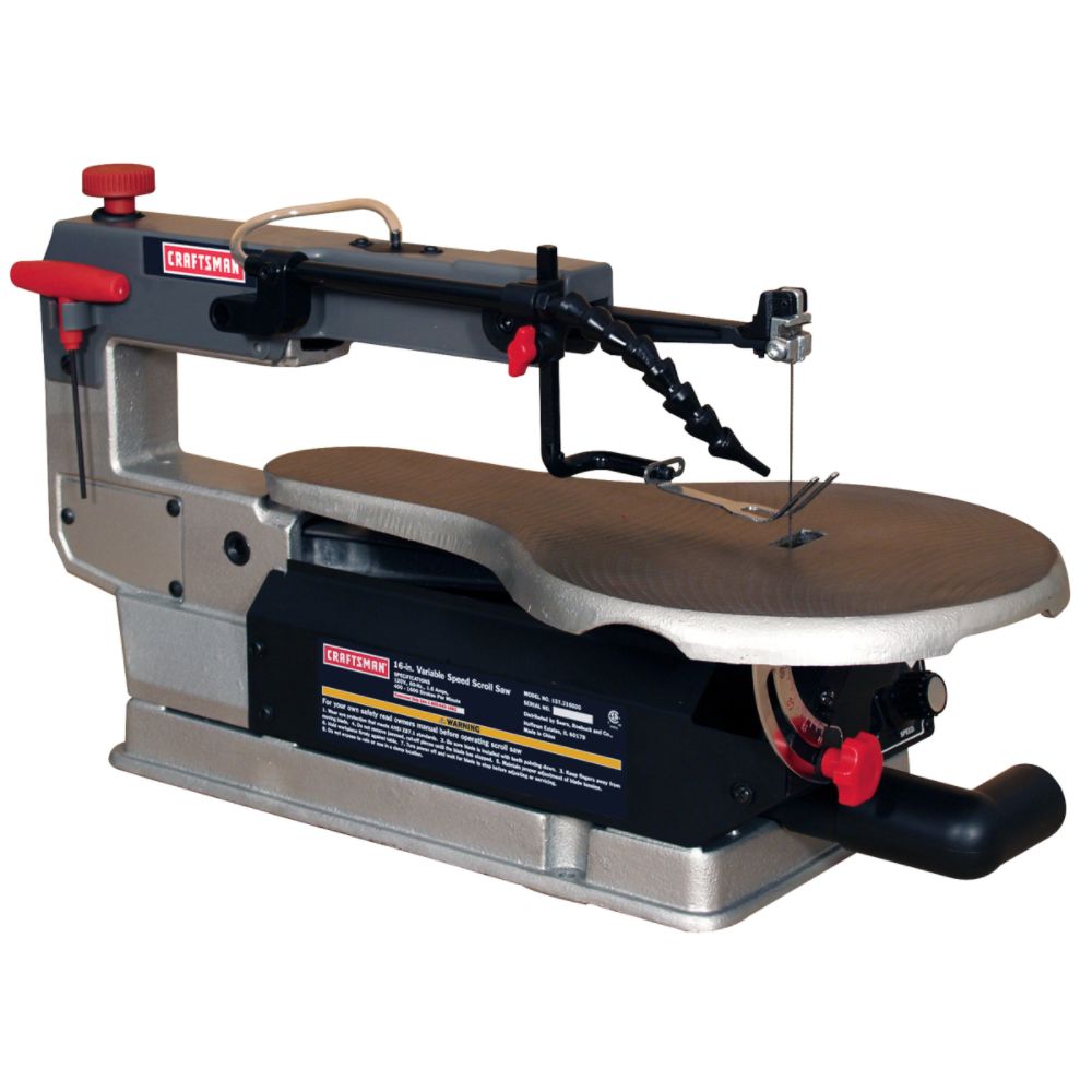

I scanned through the manual for the Mark II and it mentions a "jig saw" but to me it looks like the head of a "scroll saw" in the picture.. What I call a "jig saw" is a hand held reciprocating saw that doesn't have a table. When using one the material being cut must be suspended or hanging over the edge of a table or saw horse to allow the blade to operate freely.. I haven't seen the Balsa wood in the kit, but seems this type of saw would splinter it..
My Scroll saw has a table that the Balsa could be firmly pressed down on so there isn't as much vibration and less chance of accidents.
But that's just me....

This is my Jig Saw
This is my Scroll Saw
Which one are you guys using? I was thinking my scroll would work better..?

The scroll saw most definetly.
I use a 16" band saw with an 1/8" blade. I also use a 5" disc sander, this gets more use than anything. A drill press comes in mighty handy as well.
A couple of good sanding bars at 12" and 30" will come in very handy as well. You will want to get some medium and fine adhesive backed sandpaper for them as well. They really help to keep the wing panels nice and smooth while sanding. Try and resist the urge to use sand paper in your hand on the plane. The soft balsa will develop peaks and valleys very fast when sanding like this.

I have the same scroll saw and it's just right for model work. I like the quick blade change function. I put pads under the four feet.
Sears also has a table sander in the same price category. It has the disc sander in front too. This is a must have tool.
