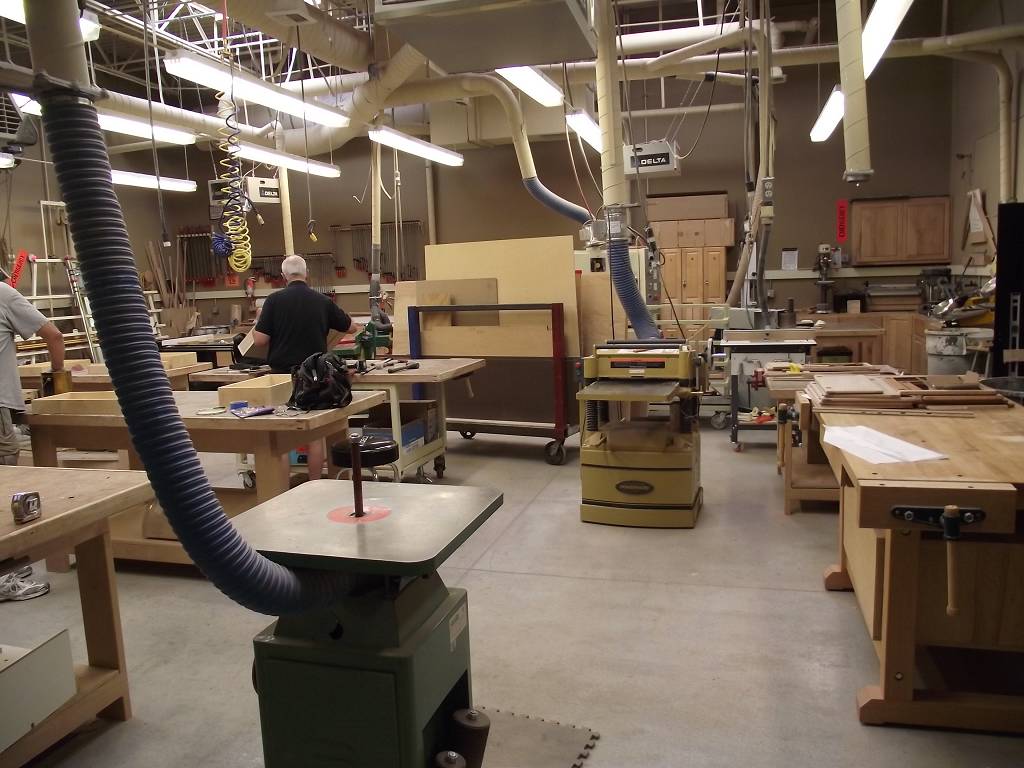

Old 08-21-2012 | 09:49 PM
My Feedback: (-1)
Joined: Apr 2003
Posts: 14,400
Received 9 Likes on 8 Posts
From: Hemderson, NV
Default RE: First Advanced kit build, recommendations on tool purchases recommended
ORIGINAL: Hydro Junkie
Let me throw another idea at you. A few years ago, I was working on a project that required holes and round end slots cut in the parts. After trying to sand the slots with a sanding drum in a drill press and fighting the wood the whole time, I found a convertible oscillating spindle/horizontal belt sander at Home Depot. It has become my ''go to'' sander ever since. While I still have my belt/disc unit and the assorted pad, belt and DA sanders, the spindle/H-belt still gets the lion's share of my work
An orbital sander can be your friend but not a lot of people have one in there home shop. I'm presently building a couple of Swoose float planes from plans. I also cut almost every piece of wood in both planes, sheeting and sticks. Belonging to a super wood workers club is an even bigger help. One of the guys gave me three long blocks of balsa and it was enough for most of the wood I needed. Having a re-cut saw is also nice along with the micro sanders.
What I have at my club is outstanding but at home I have the normal tools found in any builders shop if the builder has been doing it for a while.

Old 08-22-2012 | 07:20 PM
blw's Avatar
blw
Joined: Mar 2004
Posts: 9,449
From: Opelika, AL
Nice shop. It's a neighborhood/homeowner association shop, right?
