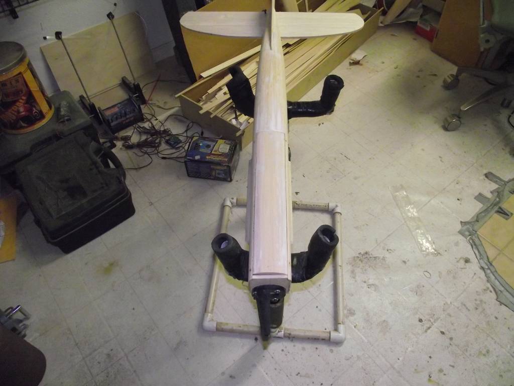

I recently finished my 4Star. I took it to the field, got some of the bugs worked out but now have a problem with the tank level. I built the tank compartment stock with the platform for it to rest on. However, I built the engine inverted. It is a Magnum 91 4S.
The problem is that the fuel is siphoning into the carb and flooding it. I think I need to lower the tank. The problem is that there isn't a hatch and I will have to cut open the top of the fuselage. I hate to do that to a plane that I haven't even flown!
The fuel compartment is so small and hard to get to, I don't see any other way than to cut open the top. In order to get in there and cut out the platform, I think I will have to.
Before I do it, does anyone have any thoughts on alternatives?

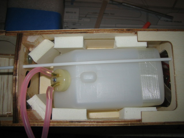

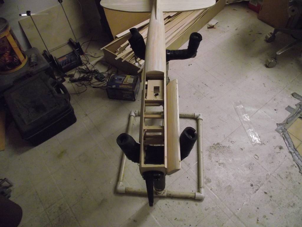

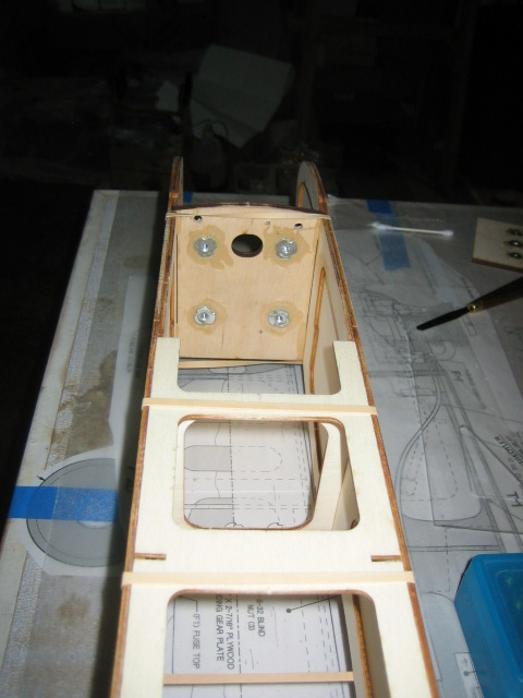

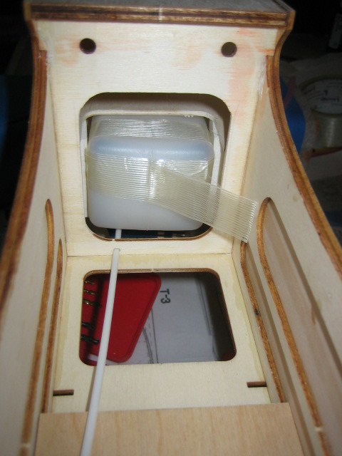

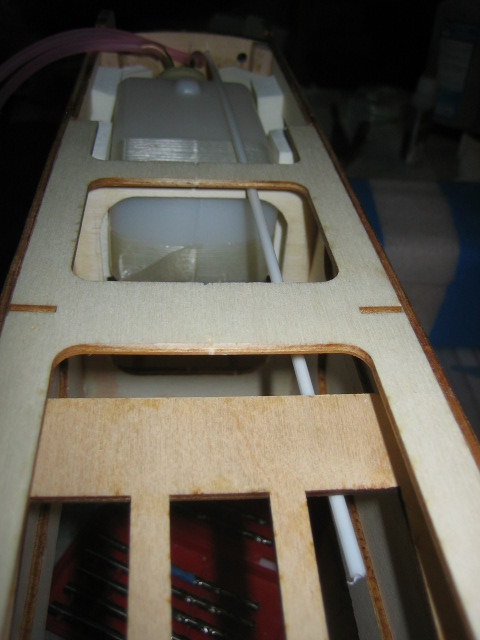

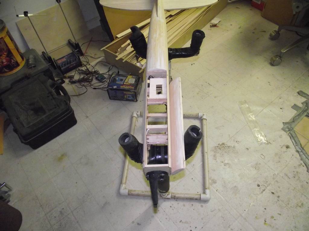

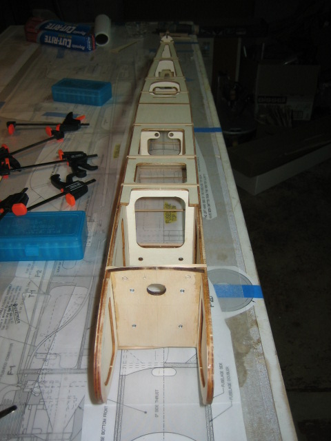

Truth be known - yea, a tank hatch is useful but not sure how much help it would be for solving OP's problem.
Looking at the pic (4Star60 - assuming that this is the OP's plane as it has a 91 4-stroke) the rear former allows for the removal of the tank. It does not need to be radiused if a tank like mine is used. You will need to pop the tank tray out, narrow it so that it will fit between the doubled fuse sides, and supported with balsa block the set the tray at the new level.

Coming back to your original question. I always use 3 lines from my fuel tank. To carburator, to muffler pressuretap and a filler tube that stays plugged up all the time after fueling.
The pressure lineequalizes the atmospheric pressure and makes the fuel flow by gravity if the level of the fuel in the tank is higher than the carb. Which leads me to the conclusion that u have to lower the tank.

A hatch allows you into the tank area so you can cut out the shelf the tank is sitting on. Being able to get the tank in and out is really helpful. With an inverted engine the tank center line MUST be lower then the carbs spray bar. How you are able to get the tank in and out is up to the builder, one of the joys of building but you must think ahead. Sometimes you can just install a new tank and disconnect the one you have. Just a thought?
