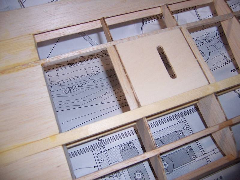

Okay, I'm making my way through the build of the Four Star 40. I'm almost done with the wing but I made what I'm sure is a newbie mistake. Despite the warnings not to get glue between the aileron torque rod and the brass collar, I somehow did. This morning when I went to test the travel in the torque rod on the left side, there wasn't any. Locked tight. Just to add to this, I used epoxy to glue the aileron assembly to the trailing edge because I thought it was important that it not fall off during flight! The rod is basically welded to the brass collar.
Anyway, I was able to cut the assembly away from the trailing edge but it's not useable. I need to replace this with something similar or possibly even better. I saw some assemblies listed in the DuBro catalog but I'm not sure which one will work. Obviously, not the micro or 1/2 A versions that they list, but are there others that will work? What about other manufacturers?
Any help would be appreciated as I'm close to finishing the wing. I'm moving on to the fuselage now to see what else I can mess up. Anyway, it's been enjoyable building it thus far. It looks like a great kit, however, I did have to order some additional 1/4" stock because one aileron was cut slightly smaller than the other for some reason.
Thanks!
Bob

Any of them the proper size will work. Better yet, just use two servos about 1/2 out on each wing half and forget the torque rod. These are great flying planes, any 40 - 46 engine will work fine.

Dual servos are excellent. If you search this forum you may find photos of how someone else has implemented dual servos.
Too late now, but sometimes heat will soften epoxy. Applying a soldering iron to the brass tube might have allowed you to wiggle the torque rod free.

Hmmm, 3 votes up for dual servos and no votes for torque rods. I had originally considered duals, but being this my first build I thought it might be easier to go with the plans and instructions. Now I'm thinking it might be worth investing in a second servo and the necessary wires.
I'm guessing since the single servo opening is already there I can just use this as the channel where the servo wires meet up with the RX, right?

I've fixed the same mistake by cutting off the old brass tubing. I had some slightly larger diameter on hand, and carefully cut a slot down the length of a piece. I cut out the length I needed and spread the slotted brass tubing with a slot screwdriver just enough to slip over the torque rod. I then used duck billed pliers to compress the brass tubing enough to work smoothly with the torque rod. Glued carefully in place and it worked fine.
Are you sure there is too much CA to not use uncure and soften it up? I would try that first.

I used epoxy not CA, but in removing the brass/aluminum torque rod from the balsa assembly peice I pretty much destroyed that part. I would need to cut a new one from 1/4" stock. I'm starting to lean toward dual servos as I was considering that option at the beginning anyway.

Just an FYI but for anyone using epoxy and making a mistake, epoxy softens with heat. It can be removed with a covering heat gun very easily and the wood and in this case metal parts are not damaged and can be used again.
To torque rod or not to torque rod??? It works and has been a good system for a lot of decades. The 4* 60 uses two aileron servos, it's often done on the 40 but it's just another either or thing. Today a lot of builders aren't good enough to install the rods correctly and opt for two servos. I use two servos just because it makes my set up easier with my radio.

Actually, the trailing edge is in pretty good shape. I was able to cut out the torque rod assembly fairly cleanly so I only need to do a little sanding.
