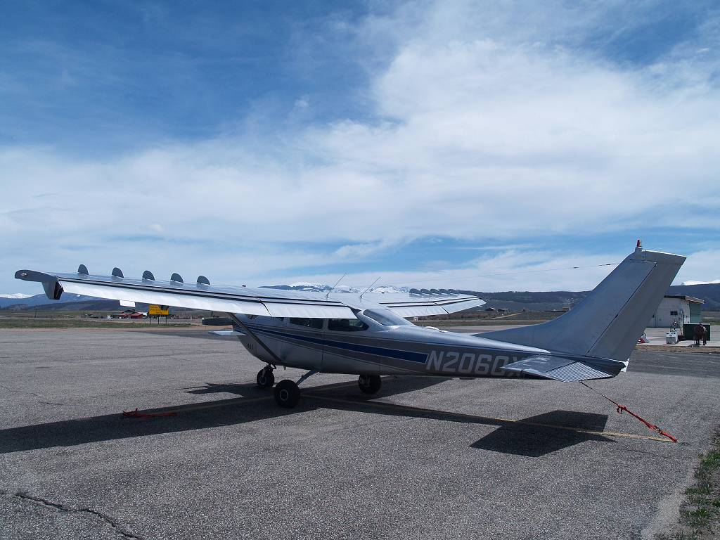

Howdy Everyone! I'm currently building an Old Royal C182 true scalekit from 1976 that I bought about 30 yrs ago and stuck in hiding. (Got a Big house and finally found it again!) I own N2060X, a 1985Peterson Wren Conversion, one of 4 in the world with the IO540. (260HP)The rest had the 235's in them. This kit has a 72" wing span and I want to replicate the Double Slotted Full Span Fowler Flap system with the Wrens teeth on the wing, along with the Canard on the engine cowling. The canard and elevator linkages I have figured out, but HINGING the flap system is kind of a challenge, along with incorperating the Wrens Teeth. I think I can make the alerons work with a flexible pushrod (when flaps are extended, as the alerons are incorperated in the flap system) but no one has a hinge out there for a double slotted system. I have some untested ideas but if anyone out there can help I'd appreciate it.
Thanks, Mooseairways. Contact [email protected] for pics of the Wren wing. This will be a challenge as there were approx 2000 extra parts in the Wren wing! Sure flys good tho!!!
