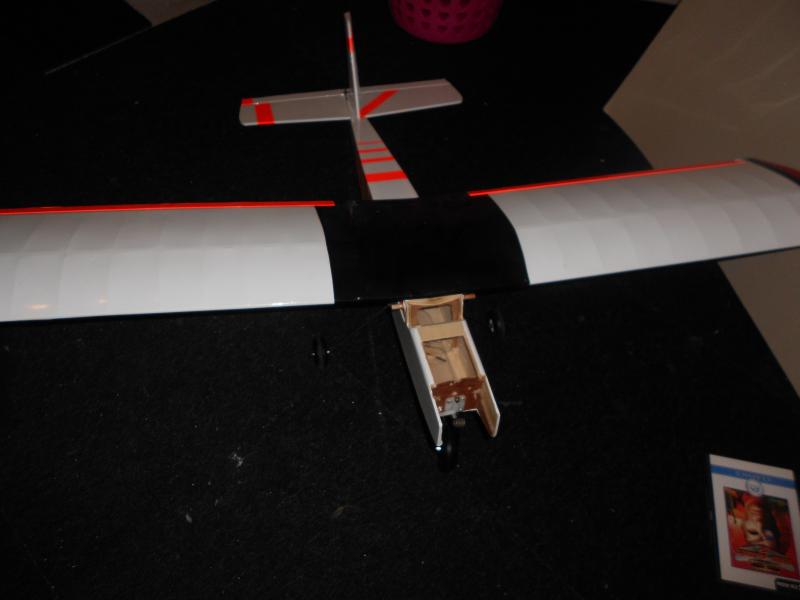

Hello All,
I got an empty Eaglet 50, which has never flown. It is also not complete and missing some parts.
The Eaglet was standing for years on a loft.
I will finish it and fly the old lady, she is made for it.
Is there someone who can help me with the original plans on PDF or tiff ?
Highly apprerciate your help
Best Regards, Rolver

Lol, you almost got your entire post in the title!<div>
</div><div>Looks like a front hatch and windshield missing. Anything else?</div><div>You could make a hatch from scrap balsa, and a windshield from a soda bottle. A hair dryer will help soften the soda bottle to fit the plane. </div>

No there are also balsa parts missing, the windows I have. But you can not help me with plans.
So if there is anyone who can help me with that, it will be appreciated

Hello Juan,
Beside the fact that I like to have the plans for "crash repairs
", I have to finish the nose part.
When you can make a picture of the nose part where the engine has to come , it will be a great help.
I also don´t know where the electronics and tank have to be placed. And I should like to know where the CG is.

The tank goes behind the fire wall.
The nose had a builld up motor tray. Yoa are missing the plywwod tray that holds the motor and two spruce square formers that go to each side to give suport to the motor tray. This assembly has right and down thrust.
The. Servos , rx and battery go on the cockpit area, any were according to the cg.
The cg is 25% to 30% to the length of your wing cord( measure from laeding edge to trailing edge at bottom) this number is your Mac.
Multiply the mac number times .25= your to front cg
Multiply the mac number times .30= your further aft cg
Start with cg at 25% mac, better to be nose heavy.
Will look for the plan today.
Cheers
Juan<br type="_moz" />

Hello Juan,
Great information, thanks and if you have a plan................
@ Cars II : Thanks, i have downloaded and print it.
I'm really happy with this info, guys. I think it is an easy plane to fly and because I have learned to fly with a nitro trainer this will be a very good plane for me.
Thanks again and if there is more info or photo's from details send me a pm for my mailaddress.

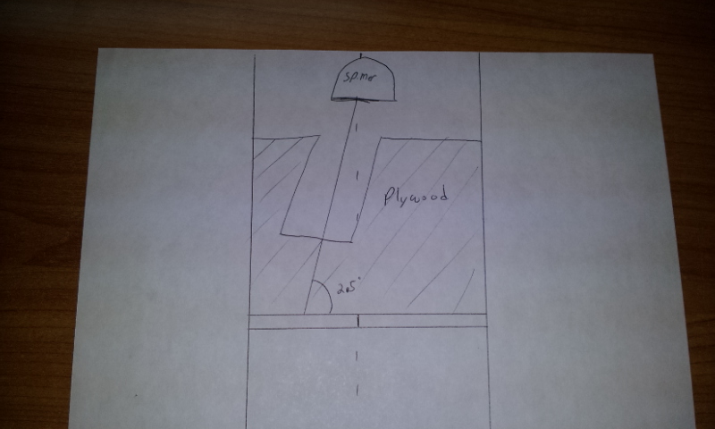

Rovler:
Bad news the plan don´t exist any more. So many years ago that I build this kit. Was 15 years old then, and today 38.
You can manage with out since your plane is almost finish.
You already have glued the the spruce suports for the plywood motor mount SO YOUR DOWN THRUST IS ALREADY THERE.
You only need to build the plywood motor mount having 2.5 degrees to the right. The size of the opening depends on your motor and needs to be offset so your spinner will be at the center.
Will add a picture to gve you an idea.
Cheers,
Juan

Hello Juan,
Thanks for the info, it's a pity of the drawings.
I will survive
If anyone read this, you still know that I highly appreciate the plans.
Not only to finish the Eaglet, but also to know how it is build in case of........................
Regards, Rolver
