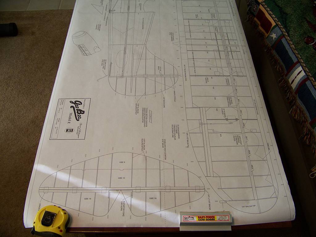

Gee Bee Model E only
The build begins. A quick note, the horizontal stab is made up of 2 pieces. They are keyed to aid in gluing. The tabs are not located centered on the parts, so if at first they don't line up, don't start hacking away, flip one of the parts over :-)

Are all of the parts shown on the plans? If not then trace the 'missing' ones for future reference.

Plans do not show all the parts. There's just a side view of the fuselage & plan view of the wing.
Just a heads up, the wing plans that came with the D model that I received were undersize. I don't know if Brodak has corrected that yet.

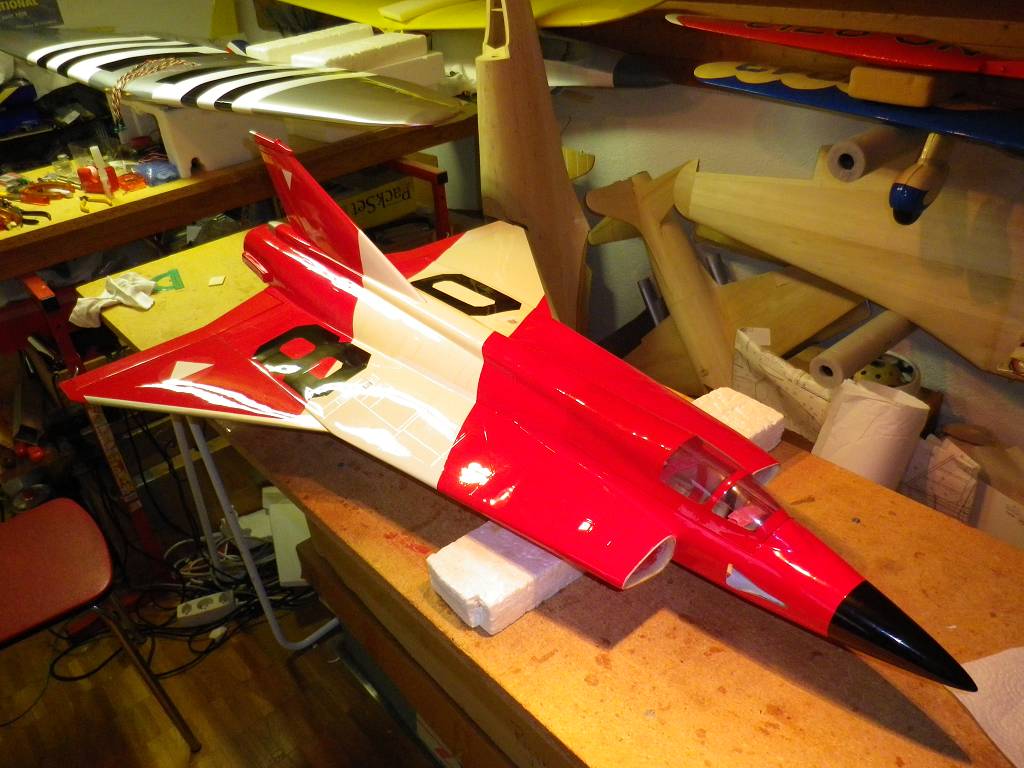

Hi Joe, yes I still have the Gee Bee D and I fly it 3 to 4 times a year. It is not an everyday-flyer, although it has no bad habits.
I also did some work on a Gee Bee E from Coverite. But it is sitting there for years. I will first make an everyday-flyer before I restart the work on my Model E.
Regards, Aldo
Behind the fuse of the YAK you can spot the tail of the Model E and underneeth the wing is the cowl. I have too many projects.

ARUP, we'll see. I've got the OS-FL-70. I had it nib. I hope it's not a mistake. I haven't heard much good about this engine. One of the reasons that I'm installing it in the up position. It's got some really funky plumbing for the fuel tank. I'll be posting some photos of the engine installation in the next few days.
Ardo, nice looking jet. Is it EDF, turbine. I want to do the turbine thing, but just can't seem to get past the possibility of $7000.00 dollar smoking hole. :-)

Thanks Joe, it is an EDF-powered proedf-Draken. I think today it's sold through Hobbyking. Power is 6S4000 with a 90mm Midi-Fan and a NeuMotor. About 1500 Watts in 2.7kg plane. It does fly quite nice.It is not a dollar-burner. Most expensive part is the ESC from Kontronik. We have a grass runway, therefore the Draken is for bungy and has no landing-gear.
