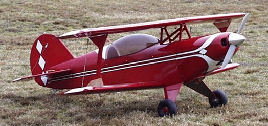

I've attached a pic of my last Pitts (a Cermark 1/4 scale ARF S2B - great flyer, but lousy quality), which I flew for 2 seasons 'till I lost it in a midair at the end of last season.
