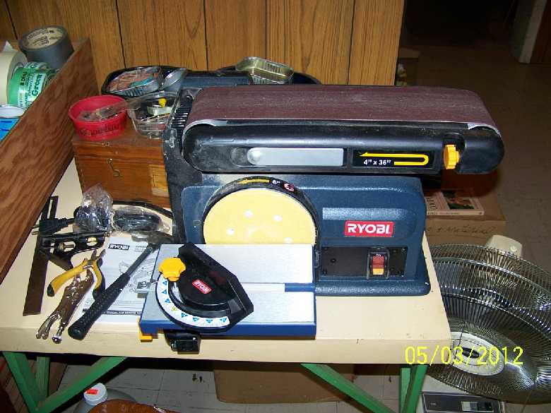

Some day you may wish to buy something like the picture is showing.
It is most valuable to finish parts for good fit prior to gluing.
I waited much too long before getting one.
Suggest you use good wood glue and fillet all the joints; use CA only for tacking.
Also suggest you cover and finish your model with light but strong fabric and genuine aircraft dope.
Best wishes for your build.

I got one of these and don't know what I did before without it. I lucked into mine from an estate sale.
