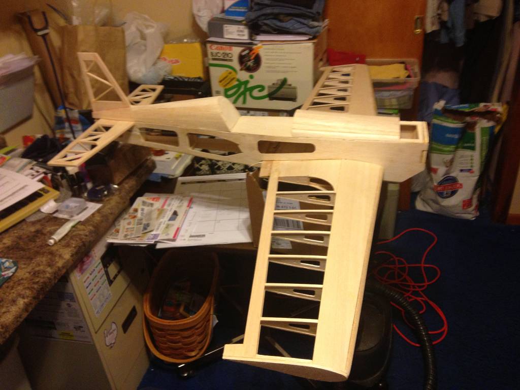

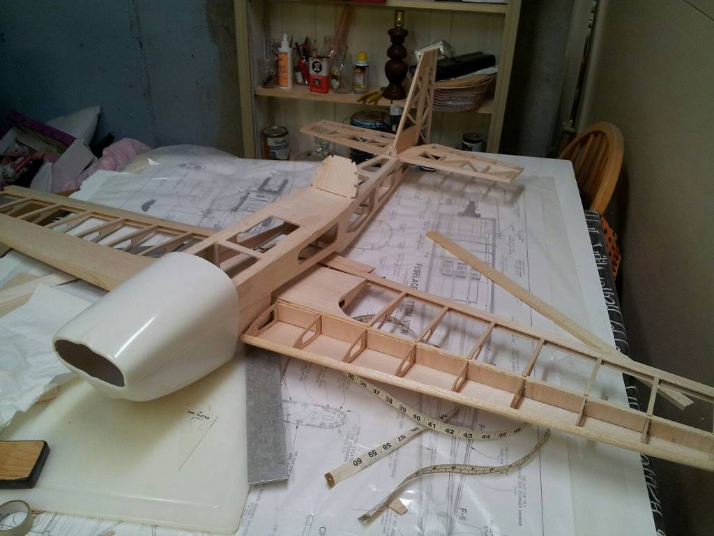

Nice work! I always like seeing a clean frame job.. very cool. Double check the sub-crutch formers above the landing-gear plate. I found those to be thin.. and wished I would have put 1/4" in there when building.. as that area did fail on me, the sub-crutch and formers just basically folded. No big deal, as it was clean internal break.. that I simply added another layer to the crutches and formers down there.. if that makes sense.. even some tri-stock of some sort might not be a bad idea there.. as it was the only area that was easily comprimised.
Stalls are very typical aerobat.. straight and clean drop. It doesn't seem to like 3D type stuff.. as the plane likes to be flown a bit faster then a foamy for sure.. Its not big at all on floating. Still it can just cruise along level at a quarter throttle all day.. which is probably about landing speed... It can literally be flown right down to the runway.. shutting the engine down about a foot off the ground. A key to all that is keeping enough power pulling it along.. with that they fly very smoothly.
These planes absolutely shine in bigger aerobatic manuevers.. for sure. Loops are as big as the sky.. Hammerheads all day long... rolling circles.. knife-edge..
I dont know if I mentioned.. I have a Magnum .91 4-stroke. Plenty of power.. It has unlimited vert .. so vertical manuevers are well within the realm. Do yourself a favor and install flying-wires if you "up engine" this plane. Sullivan makes a great set for these.. I found using the 91 could create flutter/vibration/etc.. the flying-wires shore up the tail well.. and you can install mounting points within your frame(hor/vert stabs) if you like.. A few strips of c/f tape along the LE stab areas can't hurt either. I did not do that on the first 300 I built.. and lost it .. because of that.. the second one I did all that(and maybe more).. the plane is still in great shape.. and even its taken a few hits/crashes... with no damage to the points I'd already shored up. It sounds like alot.. maybe.. this is a plane I flew the heck out of for 5yrs or more.. It taught me alot.. and was/is a great stepping stone into larger aerobats.. and thats just what I did..
Keep up the great work man.. can't wait to see this plane.

Thanks for the reply its helpful, I did brace the landing gear a bit but I might a little more. Sorry for no updates iv'e kinda taken a break for a few days but i'm going to get back too it soon. Do you think flying wires are really needed if I put a smaller engine on mine? Like a .46 2 stroke or a .70 4 stroke?

t-max, DGrant gave you all good advice. You can never make the landing gear mount area "too strong"! A little extra well placed wood in that area is smart, and the small amount of additional weight is not a factor as it's very near the C/G. You're doing a nice job, keep it up. What are you going to use for covering? I would steer you away from Monokote and suggest using Ultracote. Have you seen "K.C.'s" fax T-28 that I recovered for him? That's Ultracote! I'am pleased to see you doing so well in both your flying and taking on a kit build. Good job! Regards, 52larry52

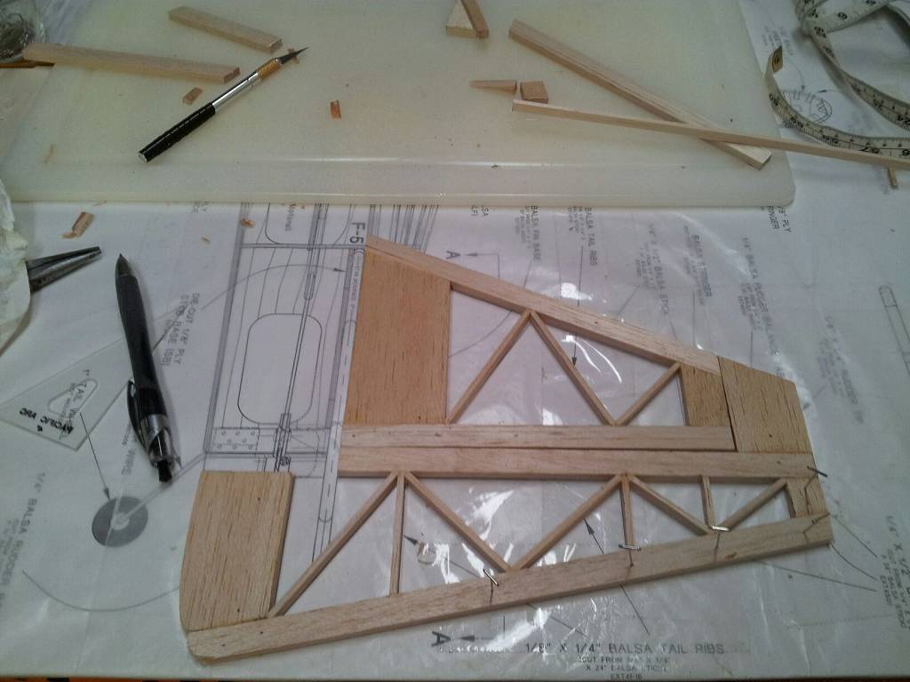

Nice looking job. I completed the GP Extra 300s .60 size and yours seems very similar.
Regarding the pictures that you have posted of the vertical fin and rudder - suggest that you double check the construction ofthe trailing edge of the fin as well as the leading edge of the rudder before you go much further. I suspect that those pieces of balsa should extend to the bottom of the fuselage as one piece.
Love seeing the pictures.
Charles
Charles

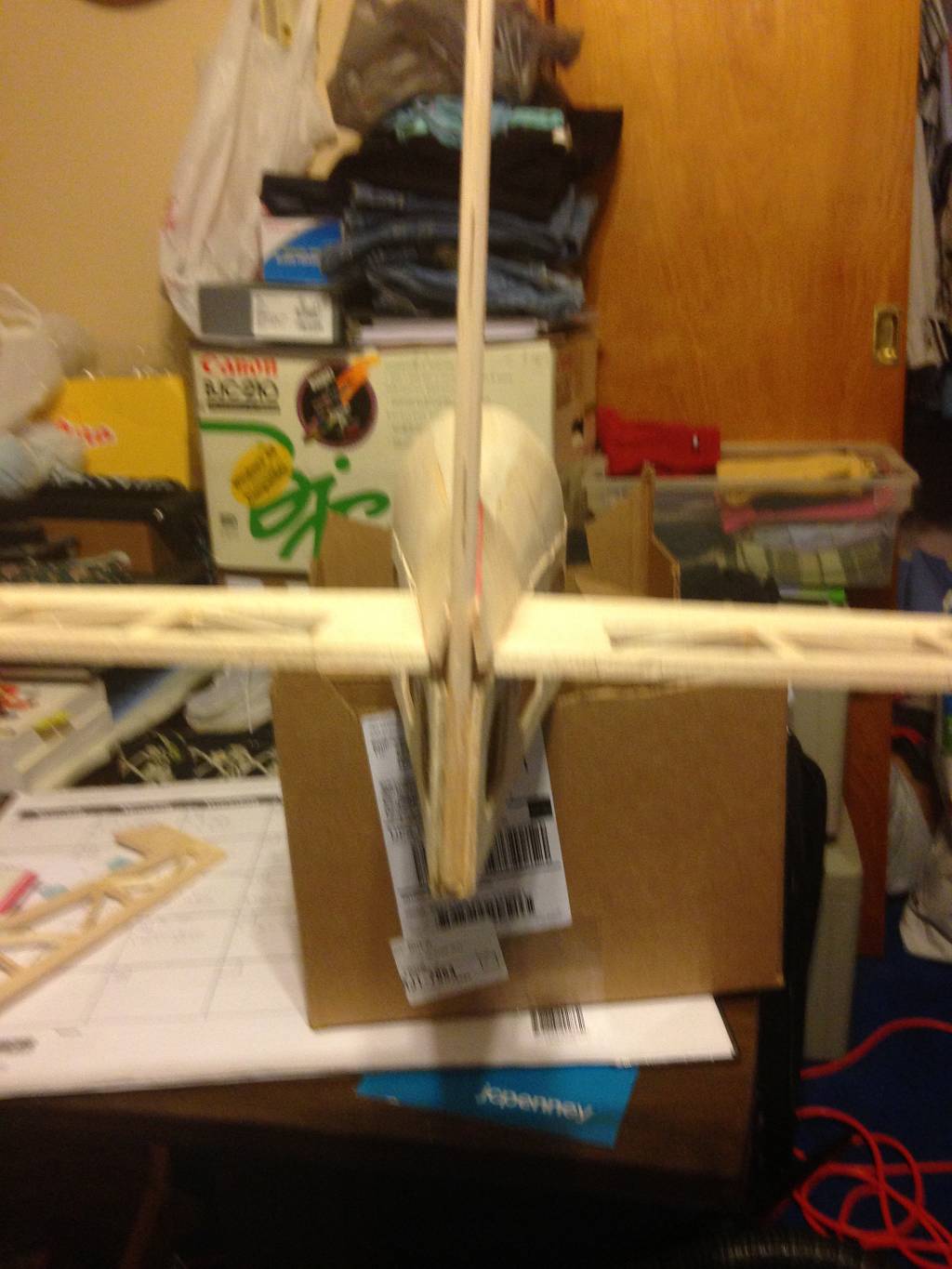

I'm building the same kit and about the same place T-max97 is on his build. The elevator on the side view of the blue print is tricky. I built my vertical fin and rudder with a long post that Lone Star Charles talks about. Good build on the kit!
