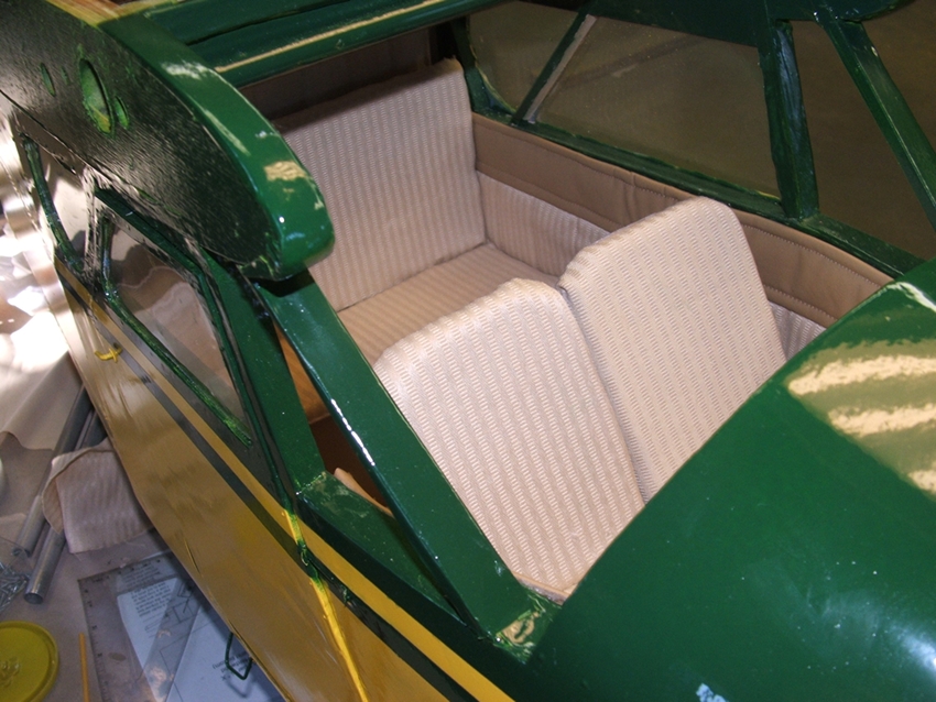

Old 04-15-2013 | 05:06 AM
TomCrump's Avatar
Joined: Apr 2003
Posts: 7,614
Received 5 Likes on 5 Posts
From: Traverse City, MI
Default RE: Canopy/ windshield adhesive.
ORIGINAL: jollyroger
I've had a couple failures with R560 for whatever reason...maybe I applied it wrong but I don't see how. On my Fly Baby, the windshield came loose almost immediately after 24 hours of cure time. I had to reglue it several times since and it looks bad gooped up in the corner. The windshield on my Seniorita also came loose even after gluing it on the inside as well. I dunno, maybe the glue was past its time when I used it. I have 2 new tubes of RC560 so I'm going to try one of those. I also have Weldbond so it's a toss up here. I have to make a decision.
Thanks for the replies.
Snow again last night...temp to 45* today so far. This Northern Michigan weather is nuts...as always.
Patience is the key. I used to have trouble with canopy glue until I figured that out.
Now, it may take a few days to glue the windshield, but it stays on.
I work in sections, letting the canopy dry until it is clear. Then I move on to the next section.
If possible, I screw the windshield in place, as I go.
I would be willing to assist you, if you want. Feel free to call me, or stop by.
