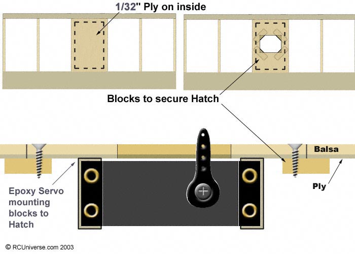

I am starting on a CG Ultimate and want to put in a servo in each wing. Anyone got pictures, suggestions or info on doing this right?

Get the Higley book "BIPES". There's a wealth of information on how to do that and a bunch of other good things to the Ultimate. Just finishing my 2nd one now and I put in the wing hatches - a LOT easier his way than the way I cobbled it together the 1st time.

Thanks MJSteve. I have snuck a peek or two at the book at my LHS but at $35 not sure I want to buy it.
I think it shows the servos exposed under the wing and what I'm after is mounting them sideways inside the wing with somekind of access hatch. Think that would look a lot cleaner.
A photo or drawing(Minnflyer you got your ears on buddy) from someone whould be a great help.

Does this help?

Thanks Minnflyer. Just what I needed to get the brain moving in the right direction. Seen your drawings everywhere and believe you have or had the same plane.

My Ultimate Bipe has the aileron servos mounted exactly as MinnFlyer shows, and it works great!
