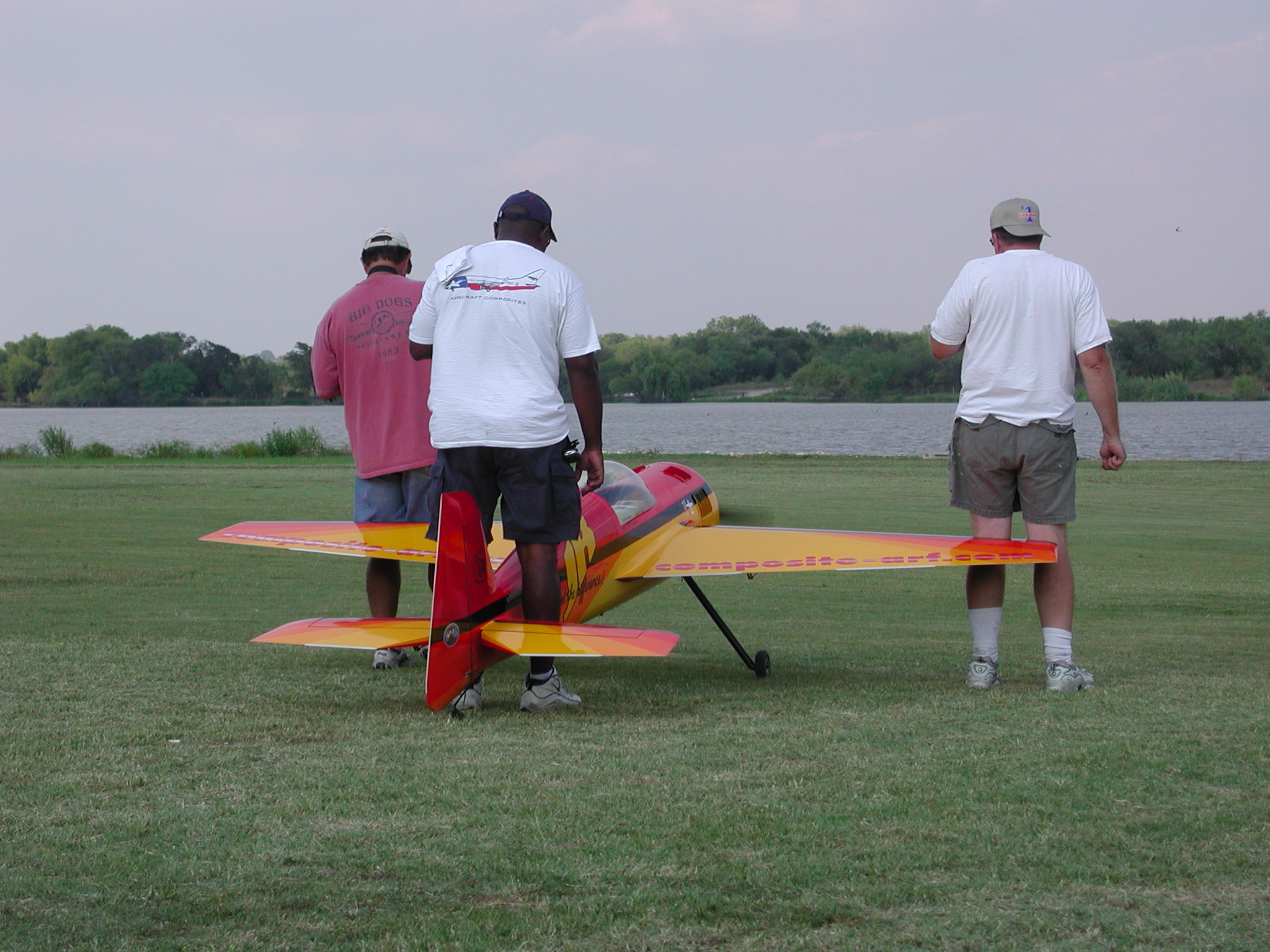

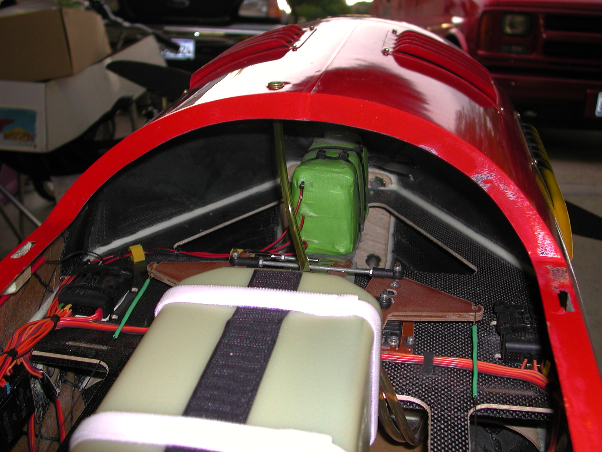

Here are a couple of pictures that date back over a decade but I think you will find them interesting anyway. There were a bunch of us fooling around at the lake on a Sunday, one of the guys got a good shot of Chip Hyde's 3.3 Yak sitting beside mine take notice that even back then Chip told Andreas; owner of Comp ARF that the pull, pull system felt mushy for competition, pulled it out and went with push pull as you can see in the picture. The 3.3 if factory setup for 4 ea servo's ganged side by side and connected by linkage and ball ends as seen in the picture. Just for fun I am including a picture of the pull, pull system I installed in the tail of my Staudacher 14 years ago, I actually needed tail weight because of the power plant. The servo pictured produced 27 LBS. of torque @12V and had a cost of almost $700.00 back then, and the servo mount box in that picture is around 10" long to give you an idea of servo size.
Bob
