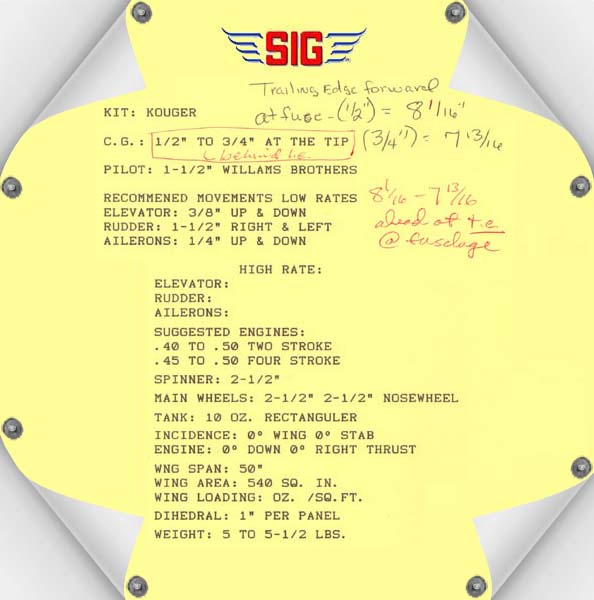

You can find the setup info on Sig's website here:
http://www.sigmfg.com/BuildManuals/SIGRC35KougarSP.html
Also, here is the info just in case you don't get to the website

Thank you sir!
