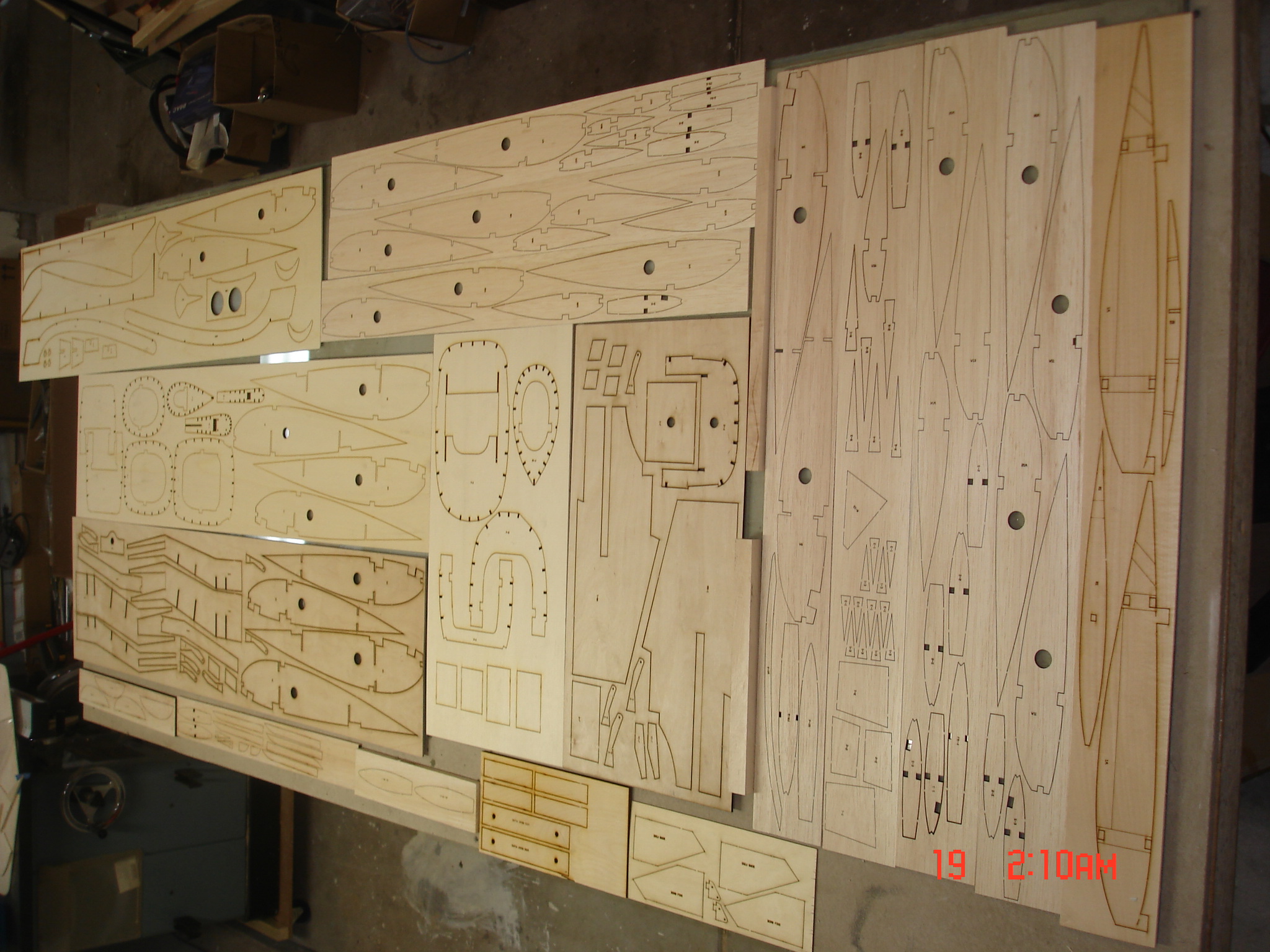

You need a large plotter. You might check with a Kinkos to see if they can scan and put the file on a flash drive for you. When you get copies of plans at Kinkos, they have to be scanned first. The problem with the type of file that you need is those are usually found in CAD software. The DXF files are the types use that a CNC machine reads. That is needed for the laser cutter. Otherwise, you might contact a local custom woodshop or a machine shop that uses CNC machinery. At my job, we have a large scanner and run 4 CNC machines. If I had access, I could do it, but it would not be possible as I could not get permission. The best thing would be to make some phone calls to these places and see if they can do it reasonably cheaply. Then you could just email the file to National, or snail mail the flash drive. If you can get National to do it, you will be happy.
Here is my Stuka kit..... The quality of the cut, and organized nature of the parts is pretty clear. These guys have found a dedicated customer here.

That Stuka kit looks great! I will check with Kinkos about getting a copy made and put on a flash drive. What kind of file would they be putting on the drive? PDF? Thanks for the info!

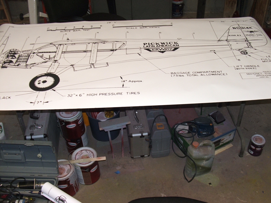

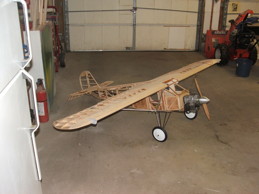

Originally Posted by drube
I was looking over the plans today with a buddy and was seriously thinking of cutting the kit myself. All I have is a scroll saw and some sanders. I think I could do it.. The hard part for me would be figuring out how much wood I would need.. I would order from National Balsa.
In the past, I never wanted to cut my parts, and I frequently used kit cutters, including National Balsa. Last Winter, I decided to cut my own kit for a 72" Velie Monoprep.
I enjoyed the process more than I expected, as I found it to be a rewarding experience.
This success led me to do a larger project, starting out with a set of 3 views, blown up to a 102" wingspan Ryan Brougham.
I think that you would enjoy cutting your own kit. Don't be afraid to give it a shot.
PS: I suggest that you listen to the advice in post 14. Years ago, there was a long thread, here, about this company.
