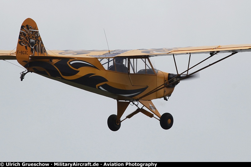

Here's an out of the ordinary, but yellow, full wing Cub.

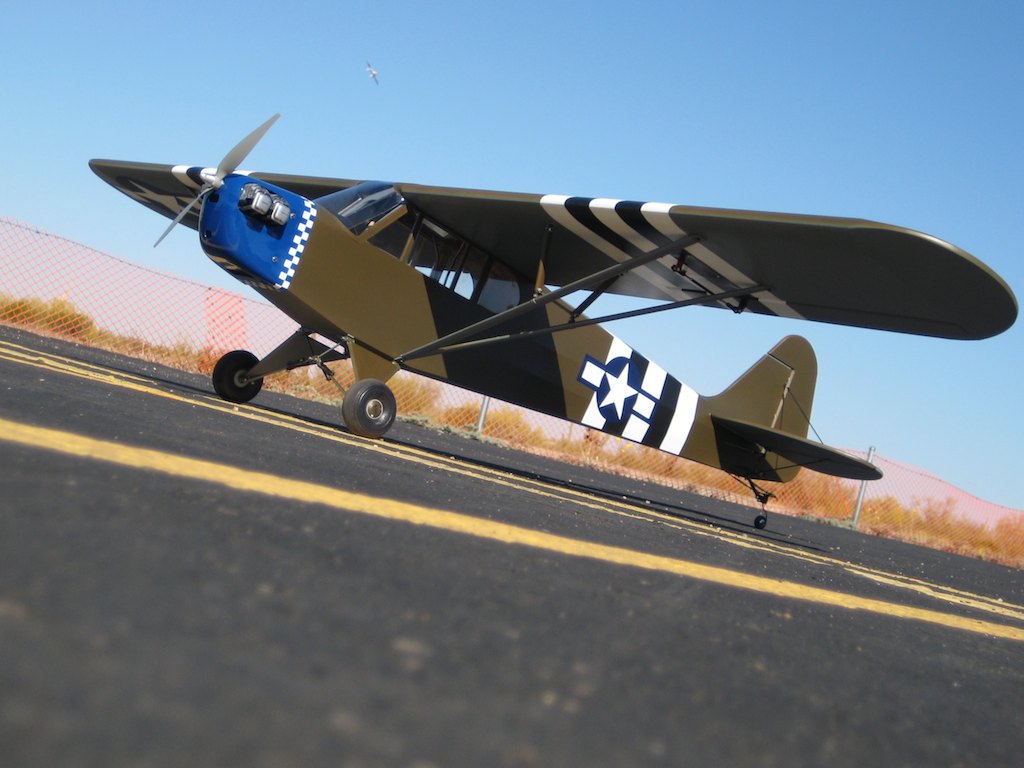

I'll give my two cents...
I have the Sig 1/5th Scale Cub and have been flying it for many years. It is a really great kit and probably one of the best flying Cubs around. I also have an Aero-Works Sport Cub and a Sig 1/4 Cub but the 1/5th remains one of the best flyers.
If I were to do it again I would stay with the full wing. A Cub will never be a fully aerobatic plane but it will do some mild stuff. I think the full wing retains the character that Piper had in mind for the plane.
When I started the build I fully intended on using an OS 70 Surpass II four stroke... However, part way through the build I changed it to electric (Was my first electric plane). I get 10 minute flights using half the capacity of the 5S5000 Pack I use to power the plane.
SunDevilPilot
