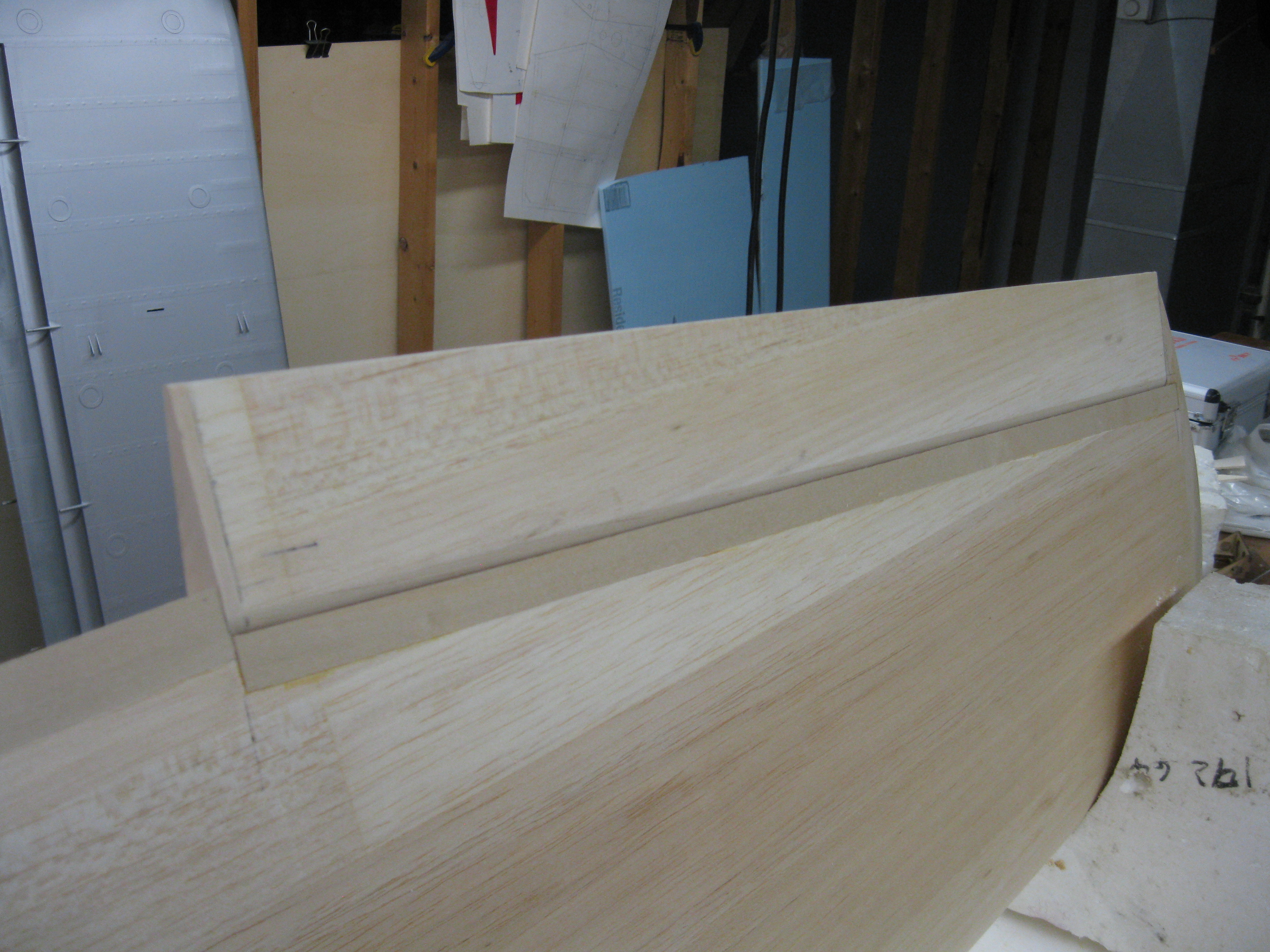

Default Robert hinge install
How do you guys install the robart hinges? How far back from the leading edge of the control surface should the hinge point of the hinge be? The leading edges are round and sit in the trailing edge of the wing so there is no hinge gap?

From: Springdale, PA
If the leading edges are round then the pin should be located away from the trailing edge the distance of the radius of the leading edge. Then rotation can occur without changing the gap. I'm doing a wing now I will post photos later.

Here are the hinge install photos for a round leading edge. The aileron is approximately 3/4" thick, the hinge points are glued in so that the center is 3/16" away from trailing edge.
