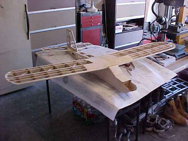

The LT-25 is framed up and sanded and ready to cover. I will use the Magnum 25XLS engine.
