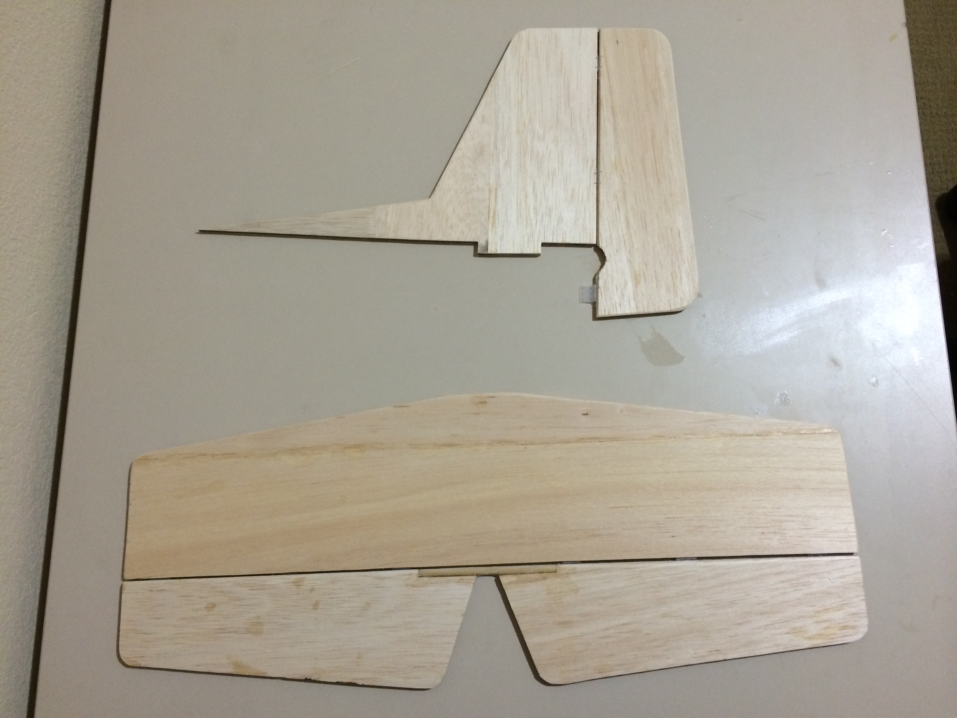

Default Alien Aircraft FunMaster 72 Build

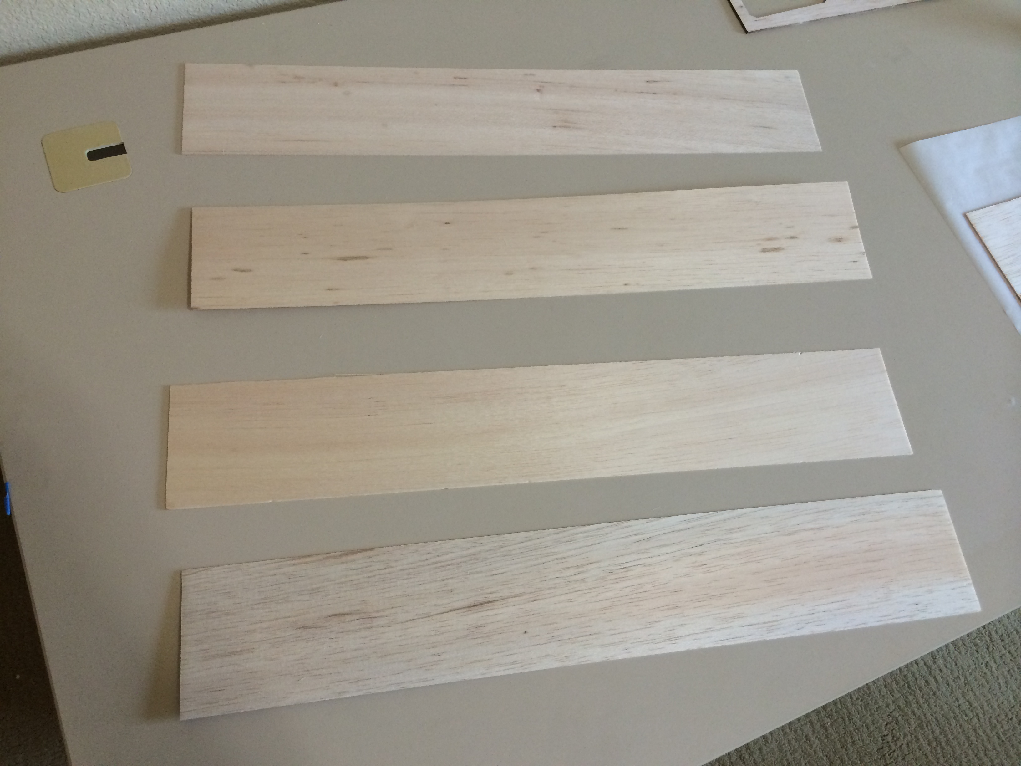

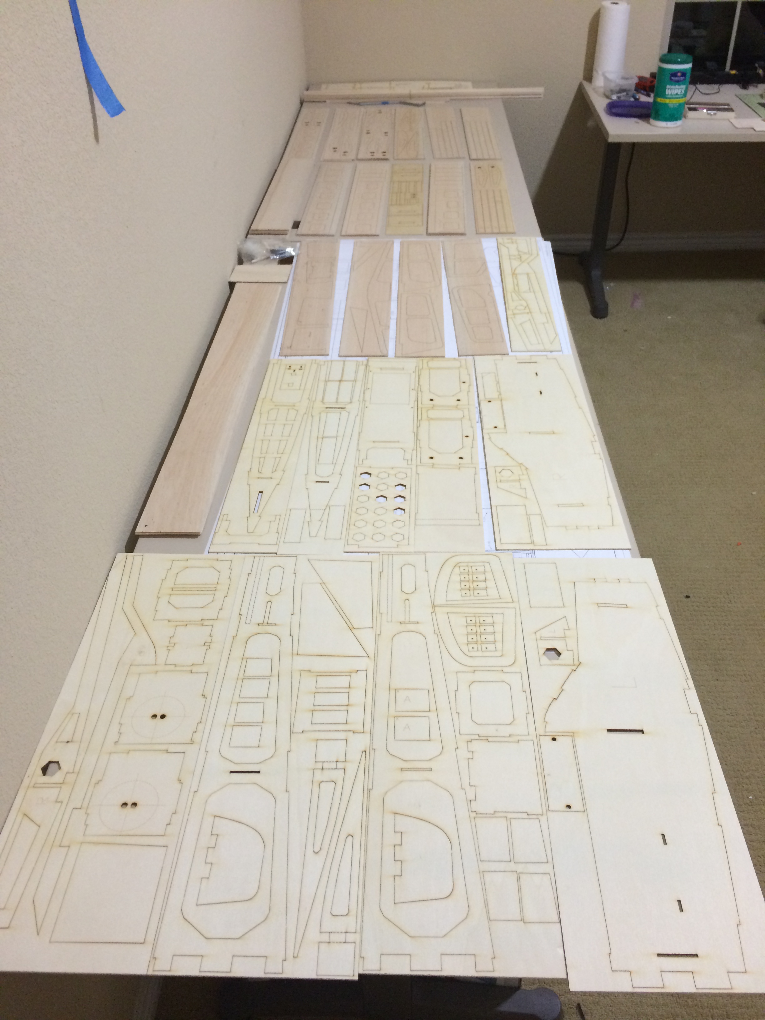

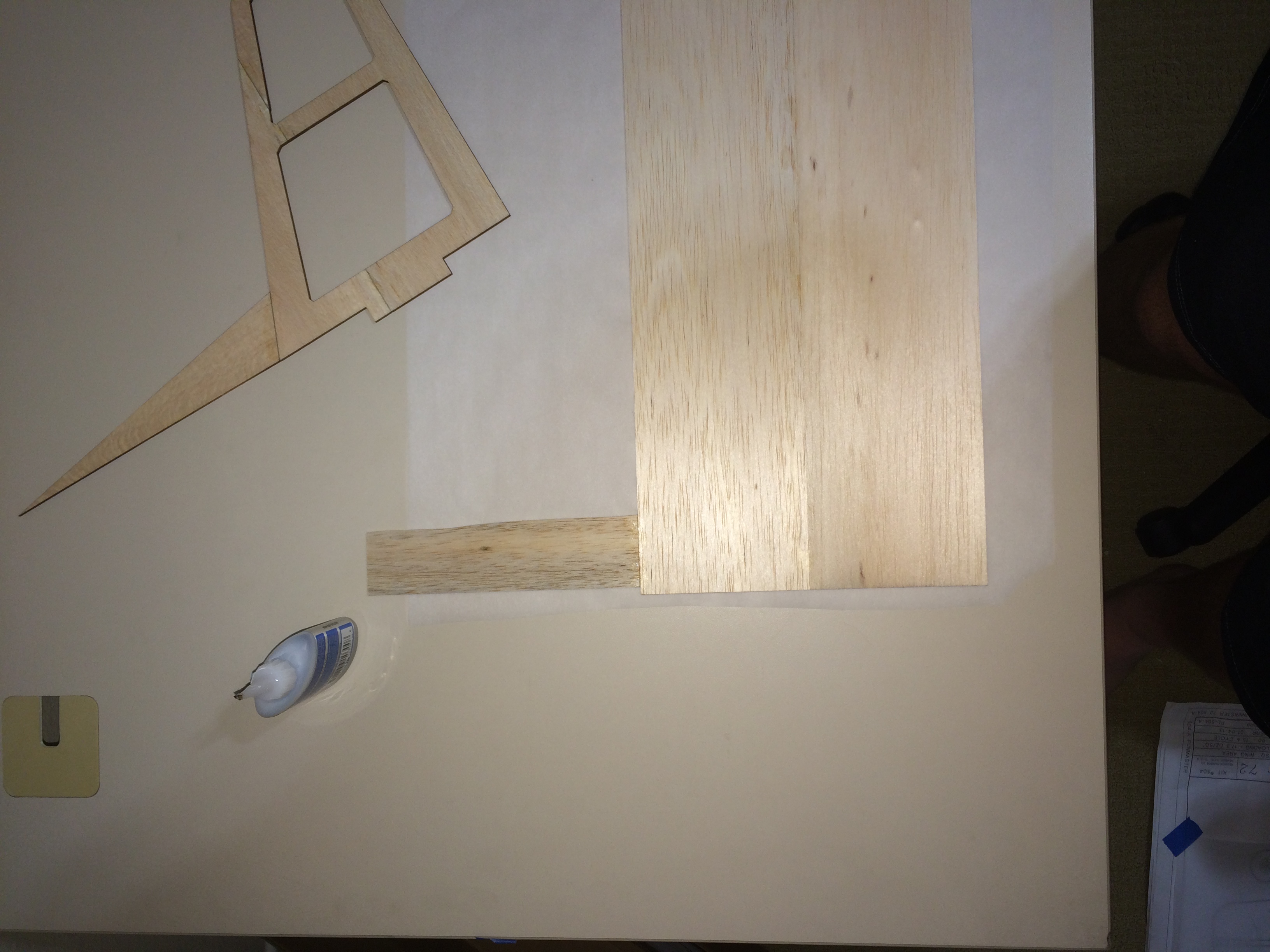

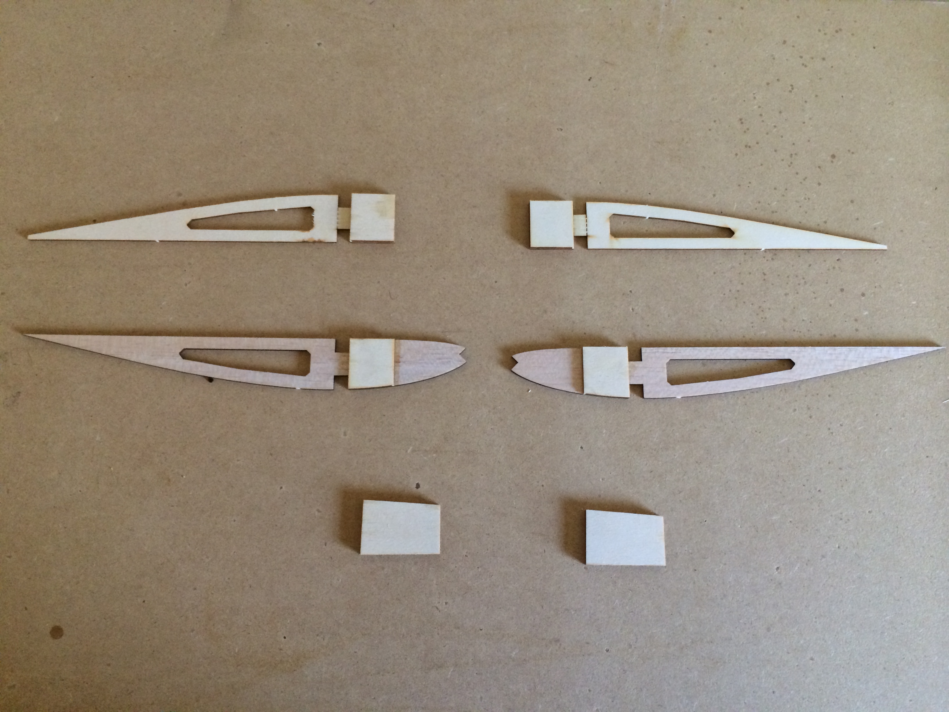

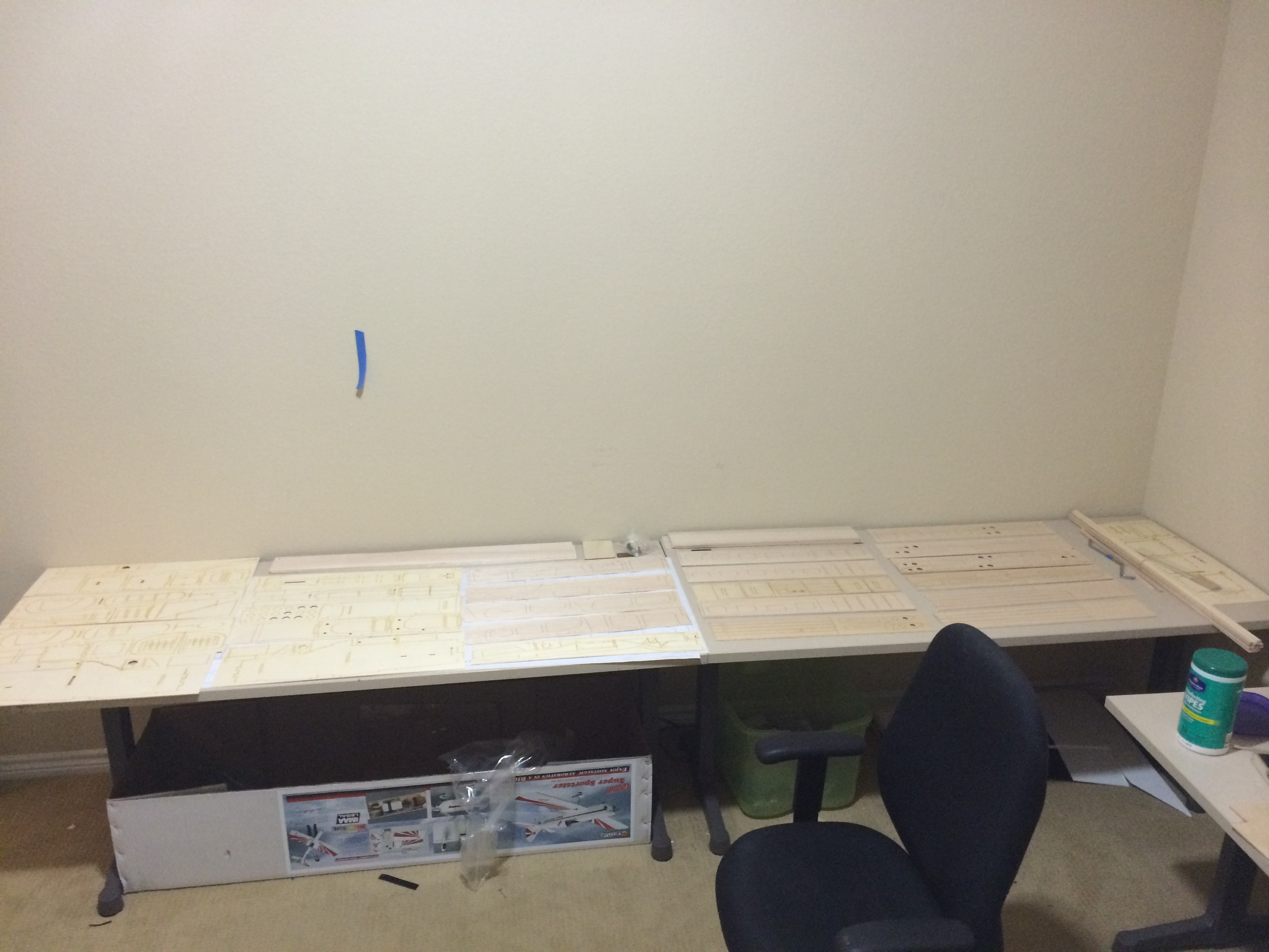

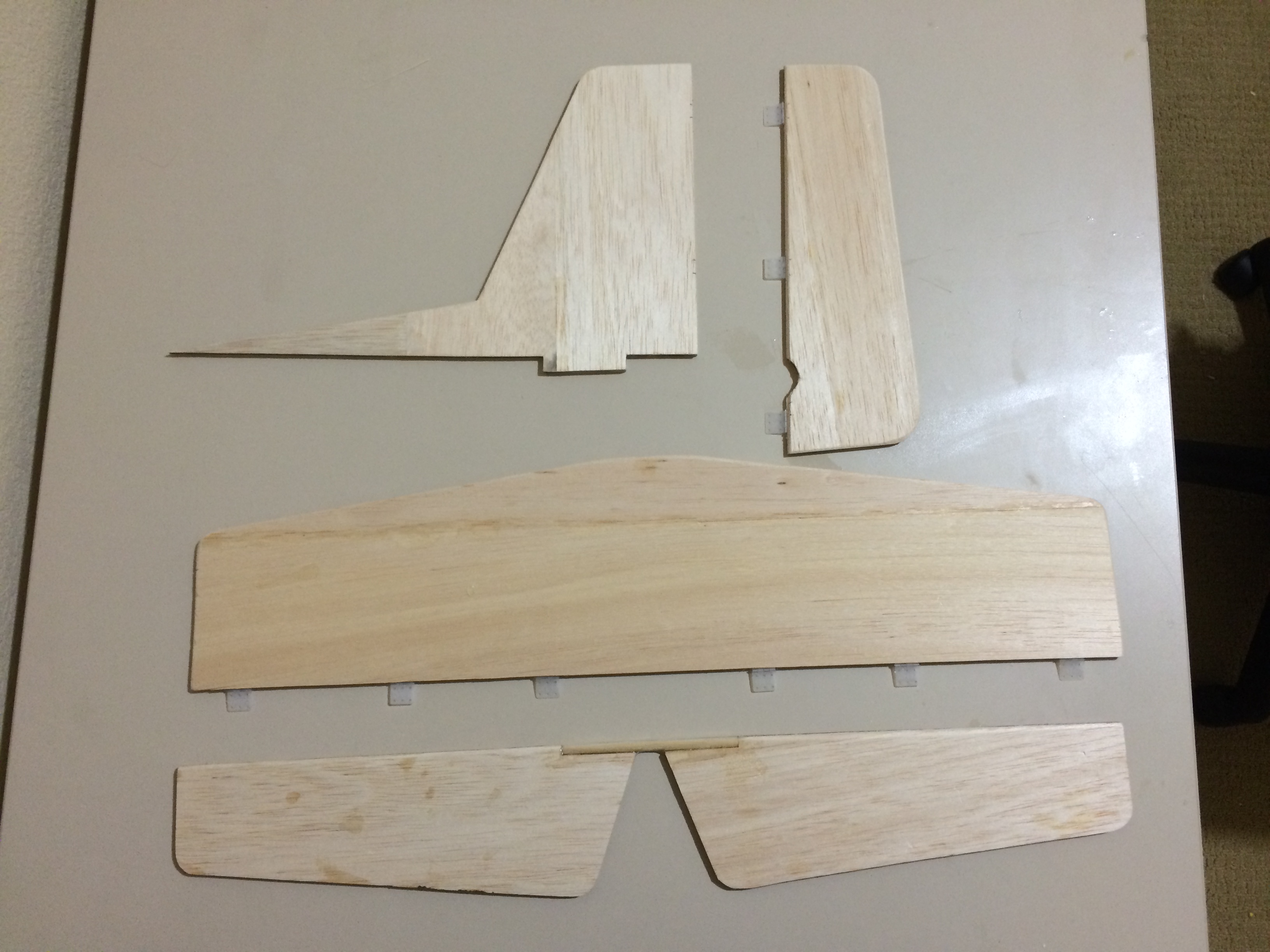

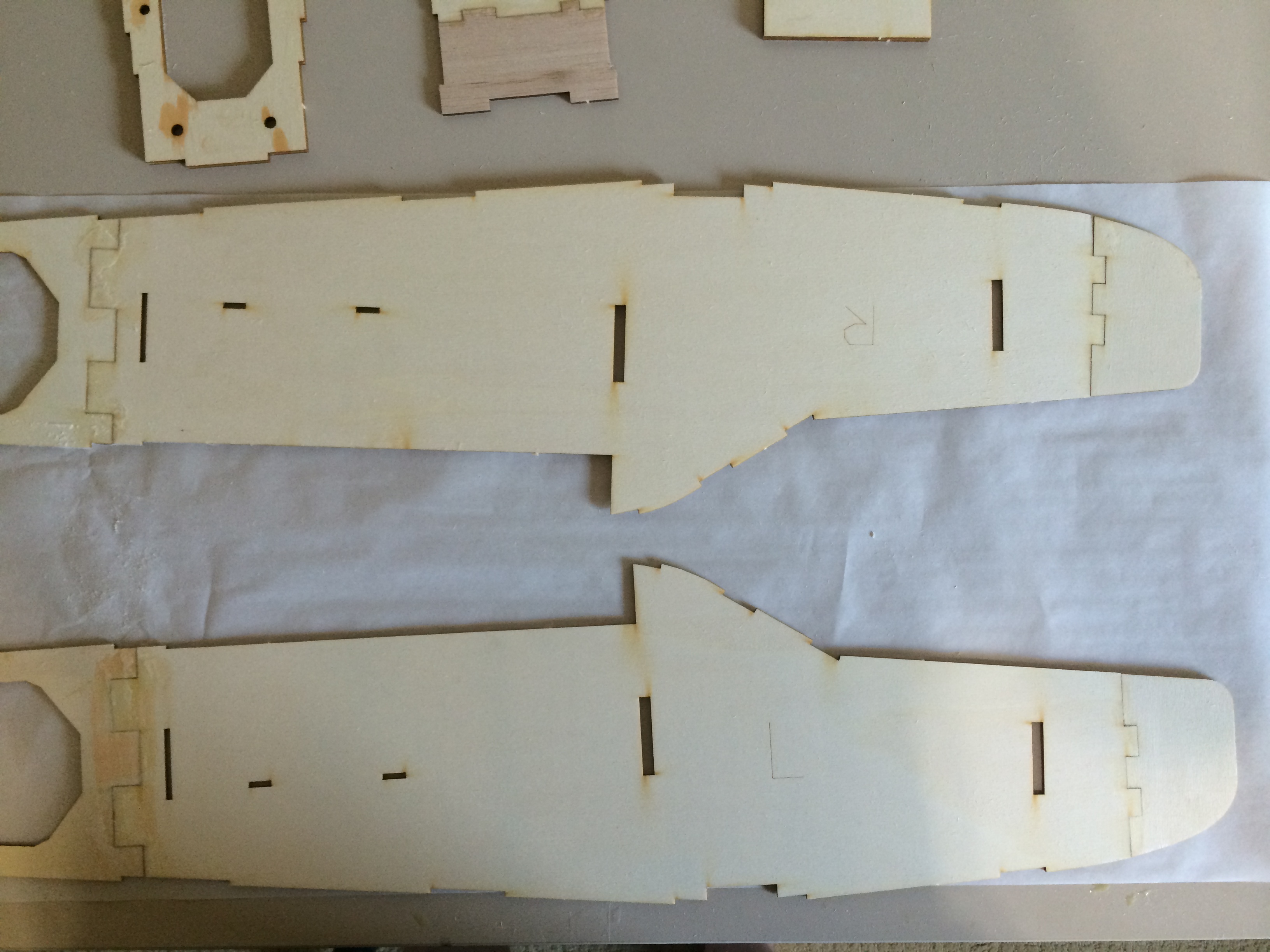

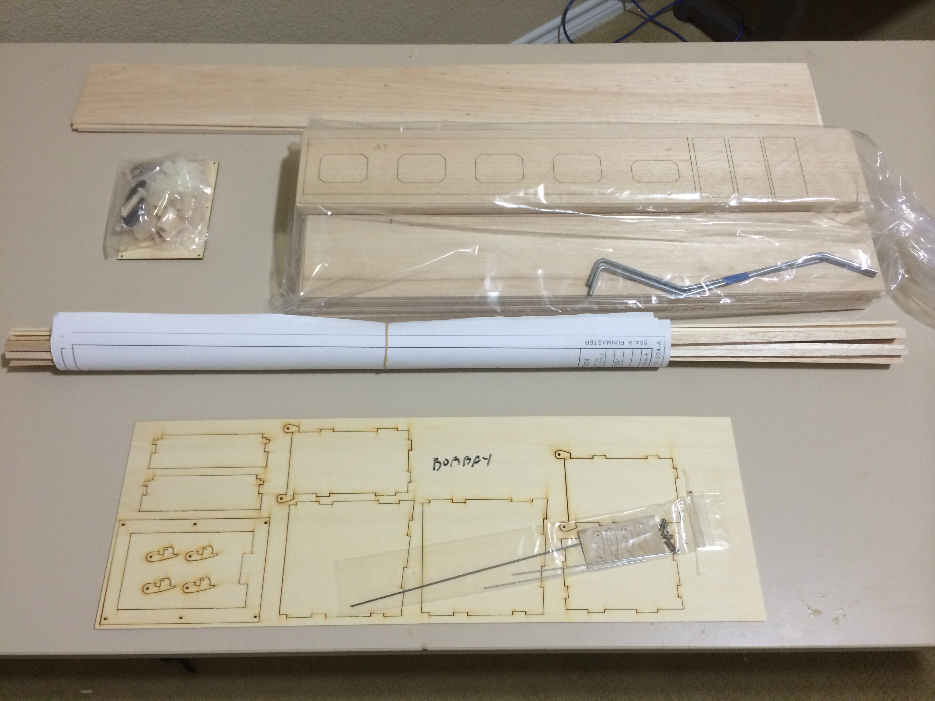

I have been looking to try my hand at a kit for a while and I have also been looking for a high wing .60 size sport plane with crow flap capability. I came across the FunMaster 72 from Alien Aircraft in both Model Aviation Magazine and Model Airplane News over the last several months and it seemed to fit the bill for both marks. So last week I ordered it and I am embarking on the build.
One of my other requirements is that this airplane must also be able to fly off water using floats, so I am also going to be adding the capability to quickly mount floats to the plane. I am also going to be building and installing the internal bomb bay module.
The kit arrived yesterday and I quickly started unpacking, organizing and preparing for the build. You can see from the pictures, it came well packed, with good laser cut wood. The plans are full size and clear to understand. The instruction book is available for download on their website which I find very nice because they can update it and provide higher resolution pictures if you have questions. The only item I found that I didn't like so far was that the tail wheel wire does not come prebent into shape. That is something I will need to do as part of the build. While that is certainly minor, it seems to me that it would be something very easy for them to do.
I hope you enjoy following this build as much as I believe I am going to enjoy building this. My goal is to maiden the plane in 5 weeks. As I get going, I will post more about the specs for the engine (it will be glow to lower risk of damage from float flying), servos, and other accessories. Stay tuned.
Josh

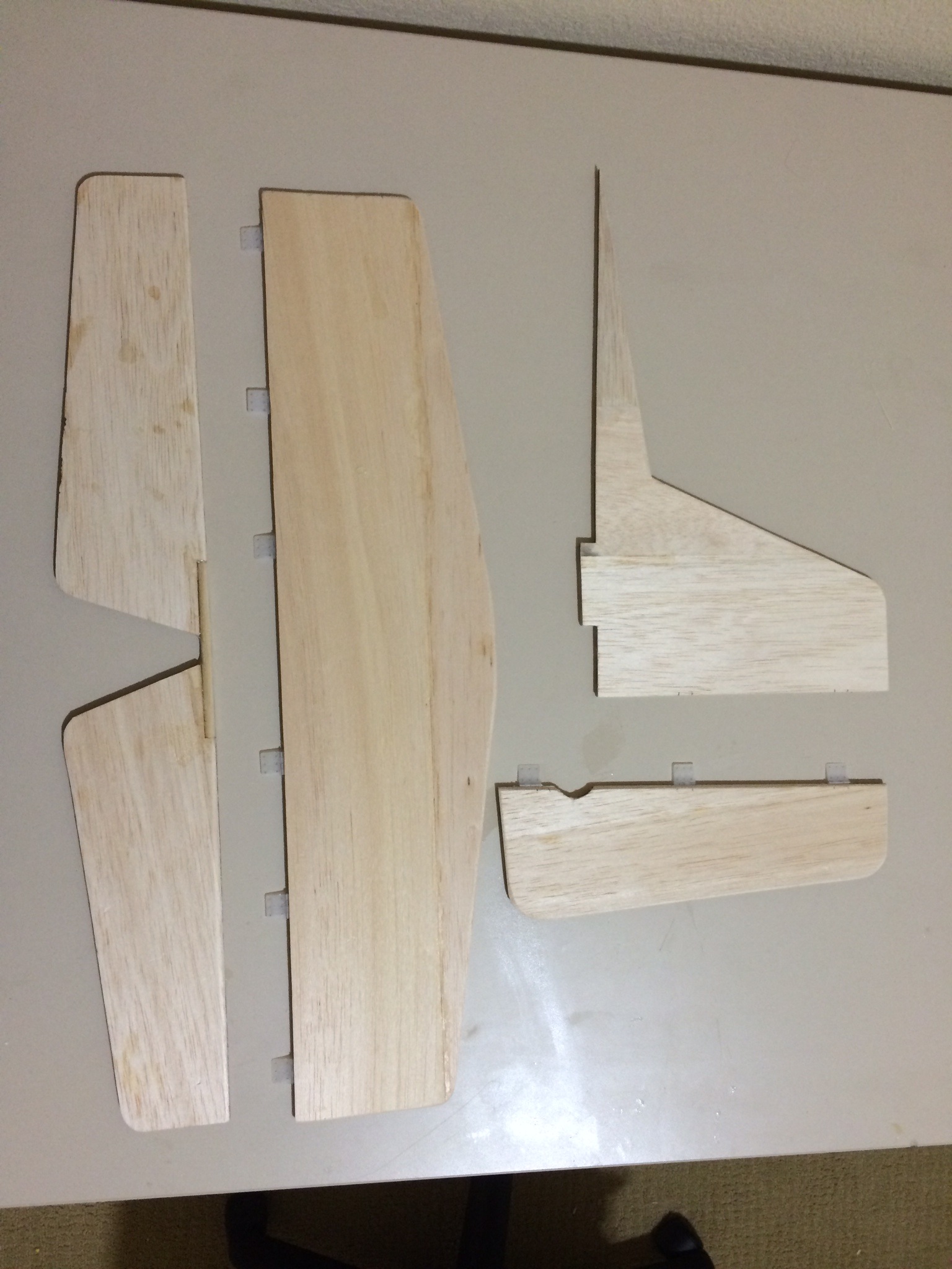

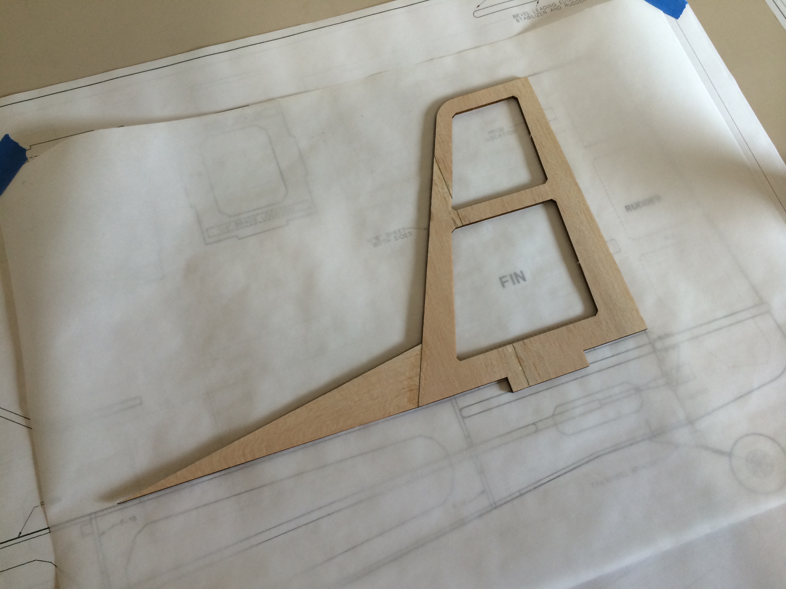

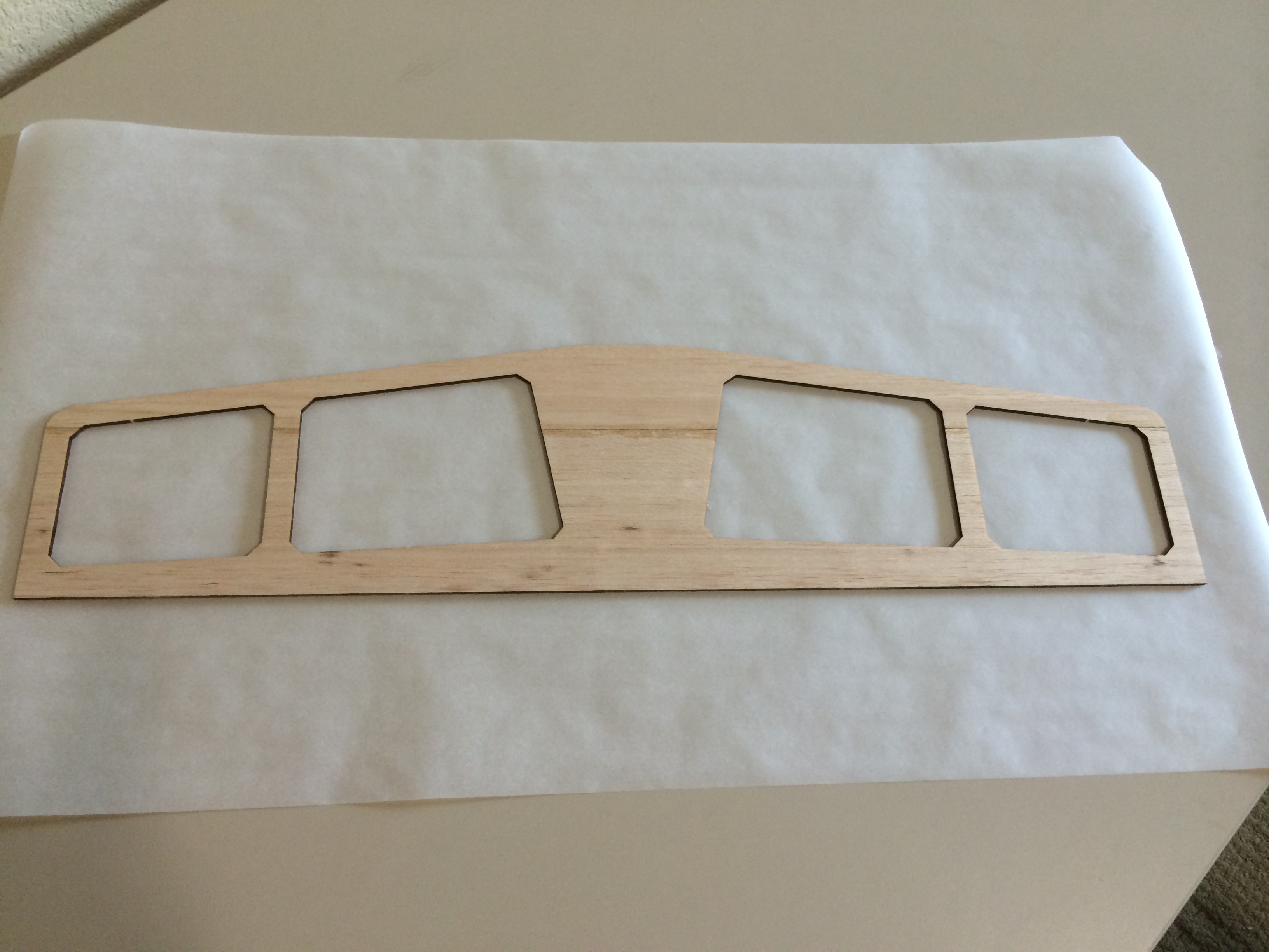

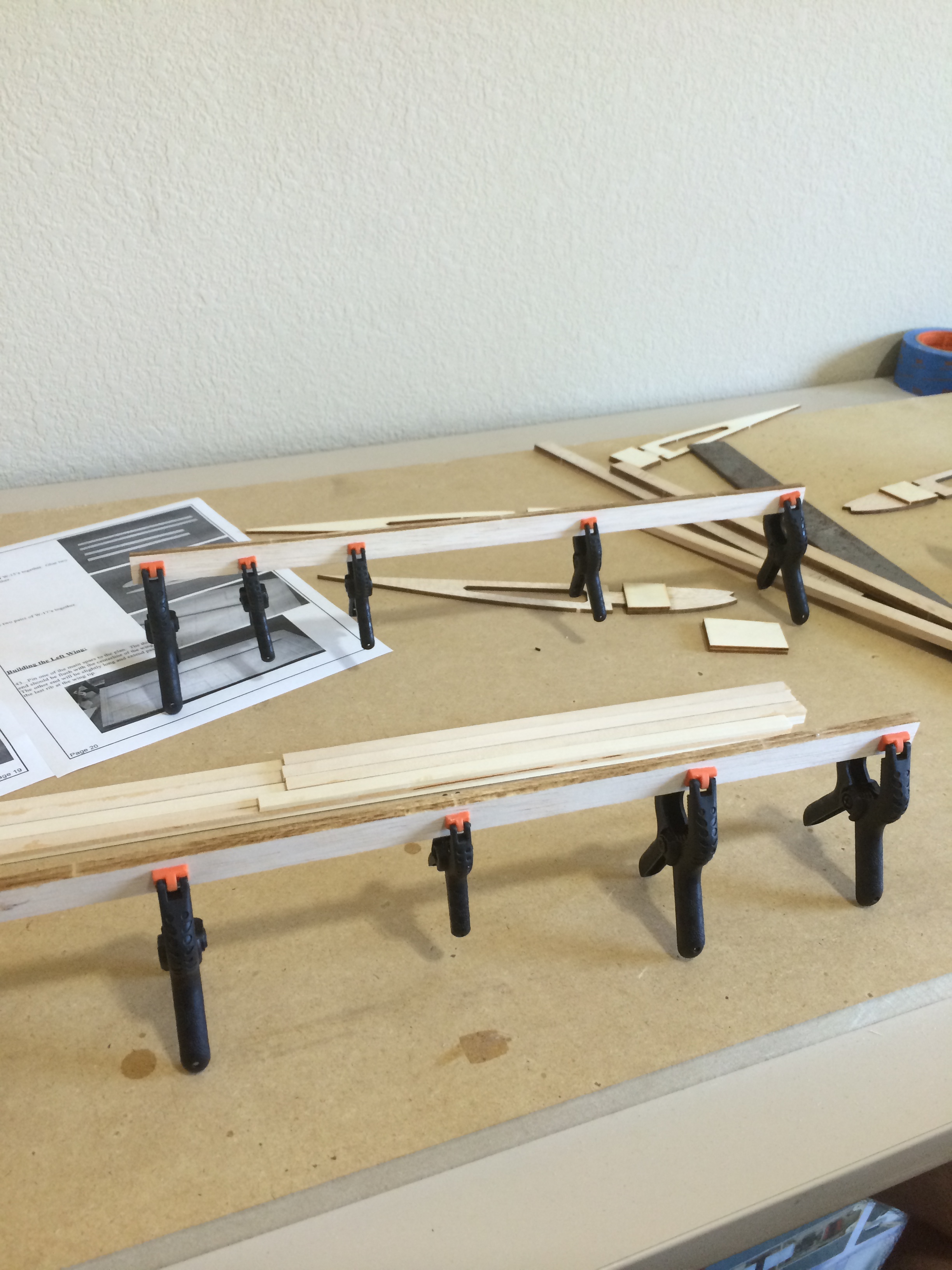

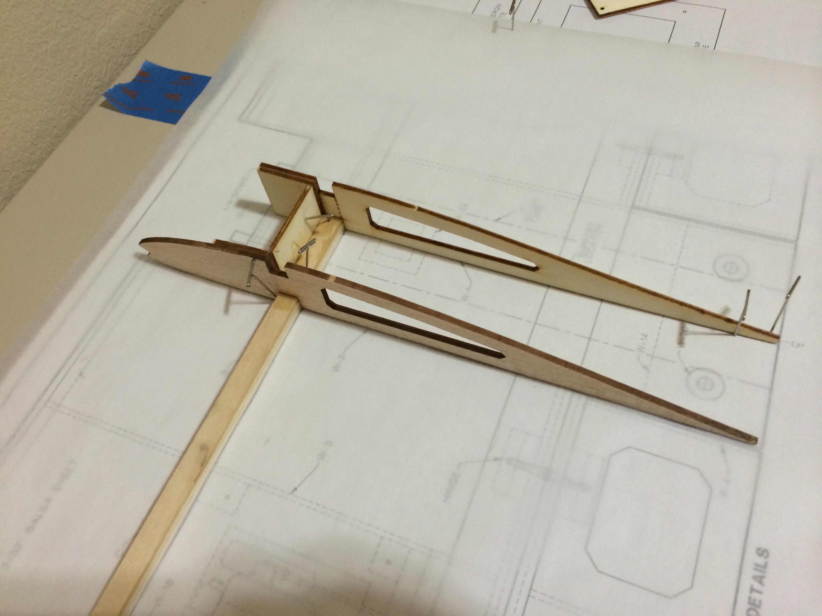

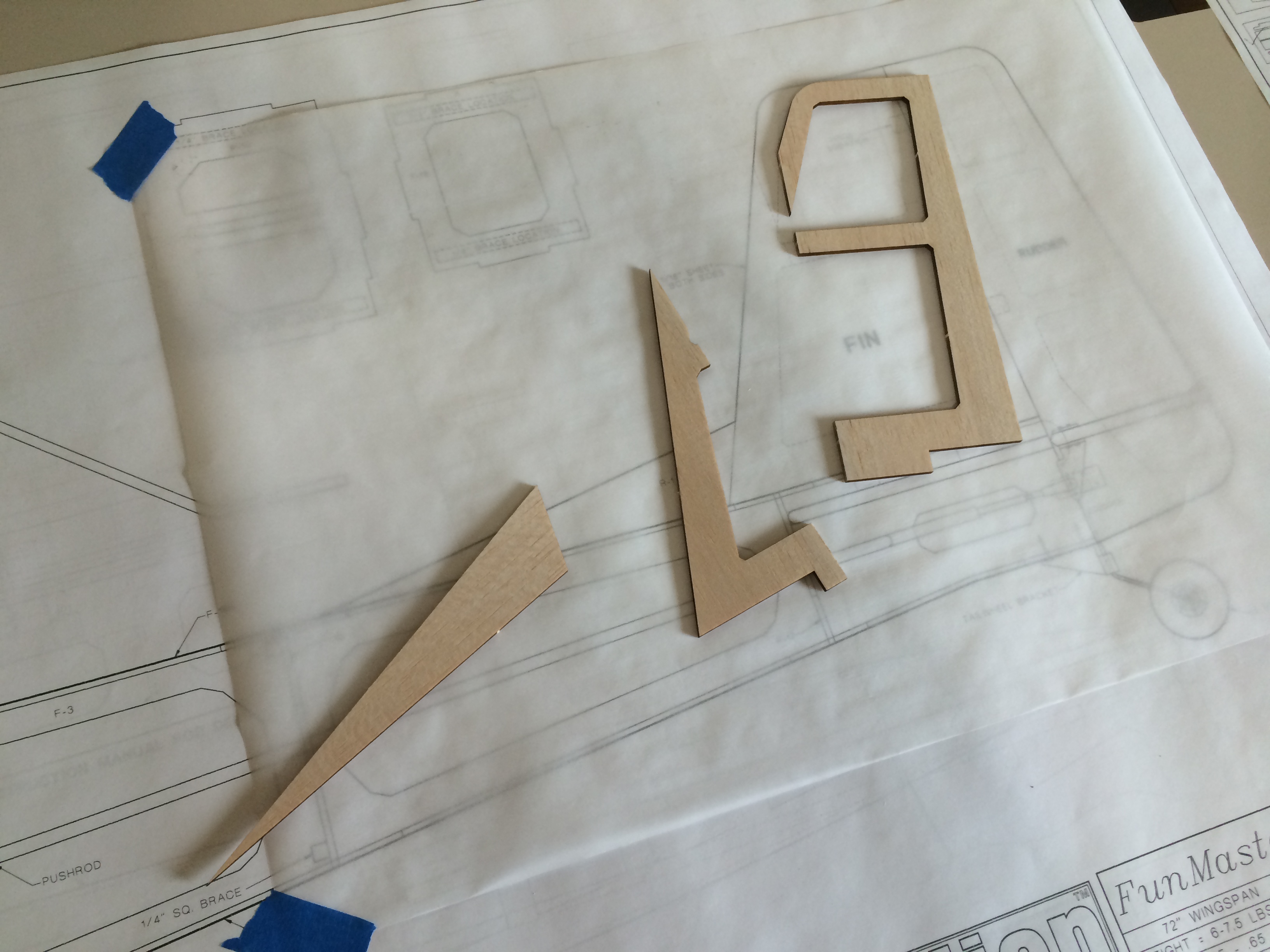

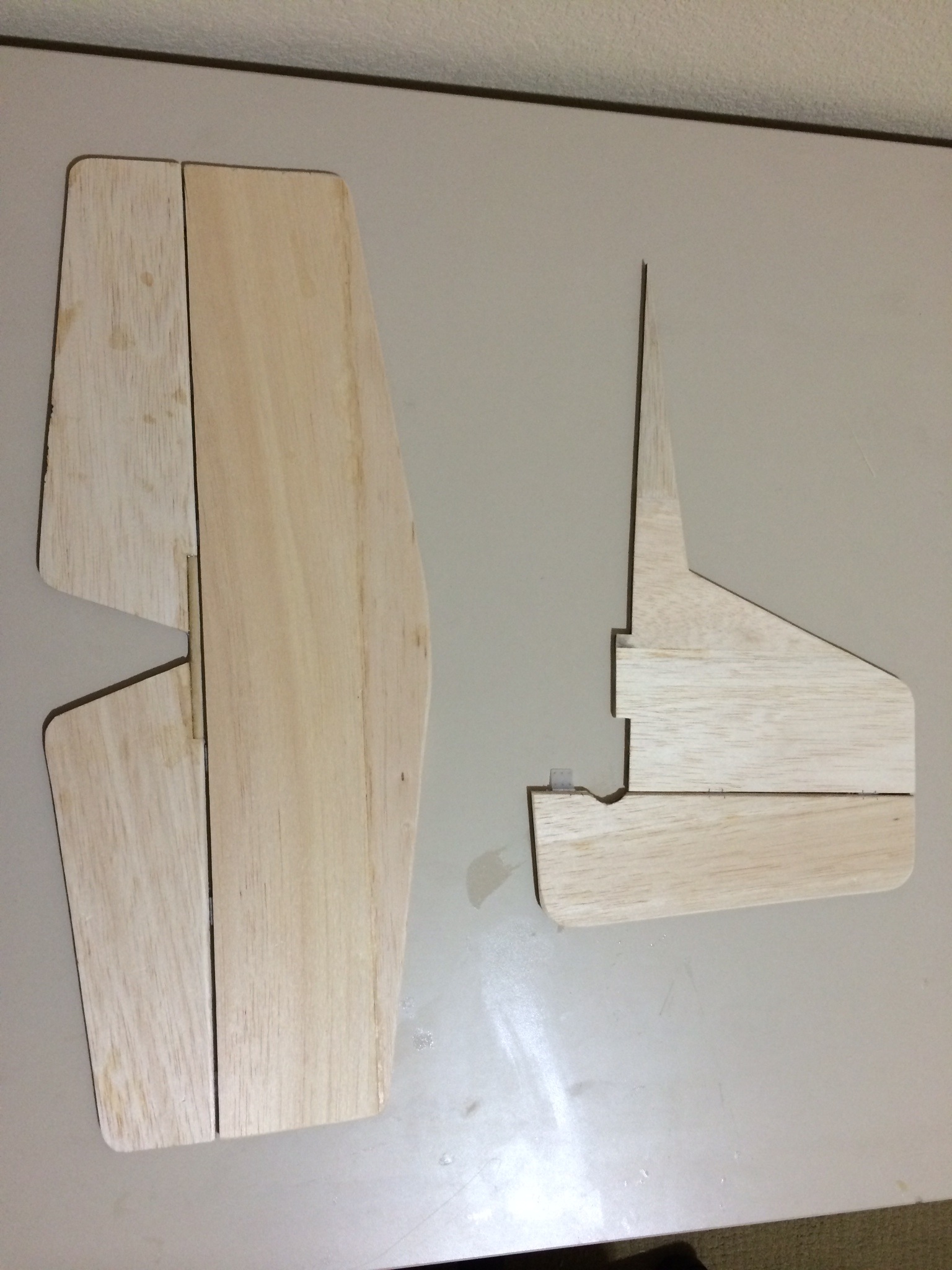

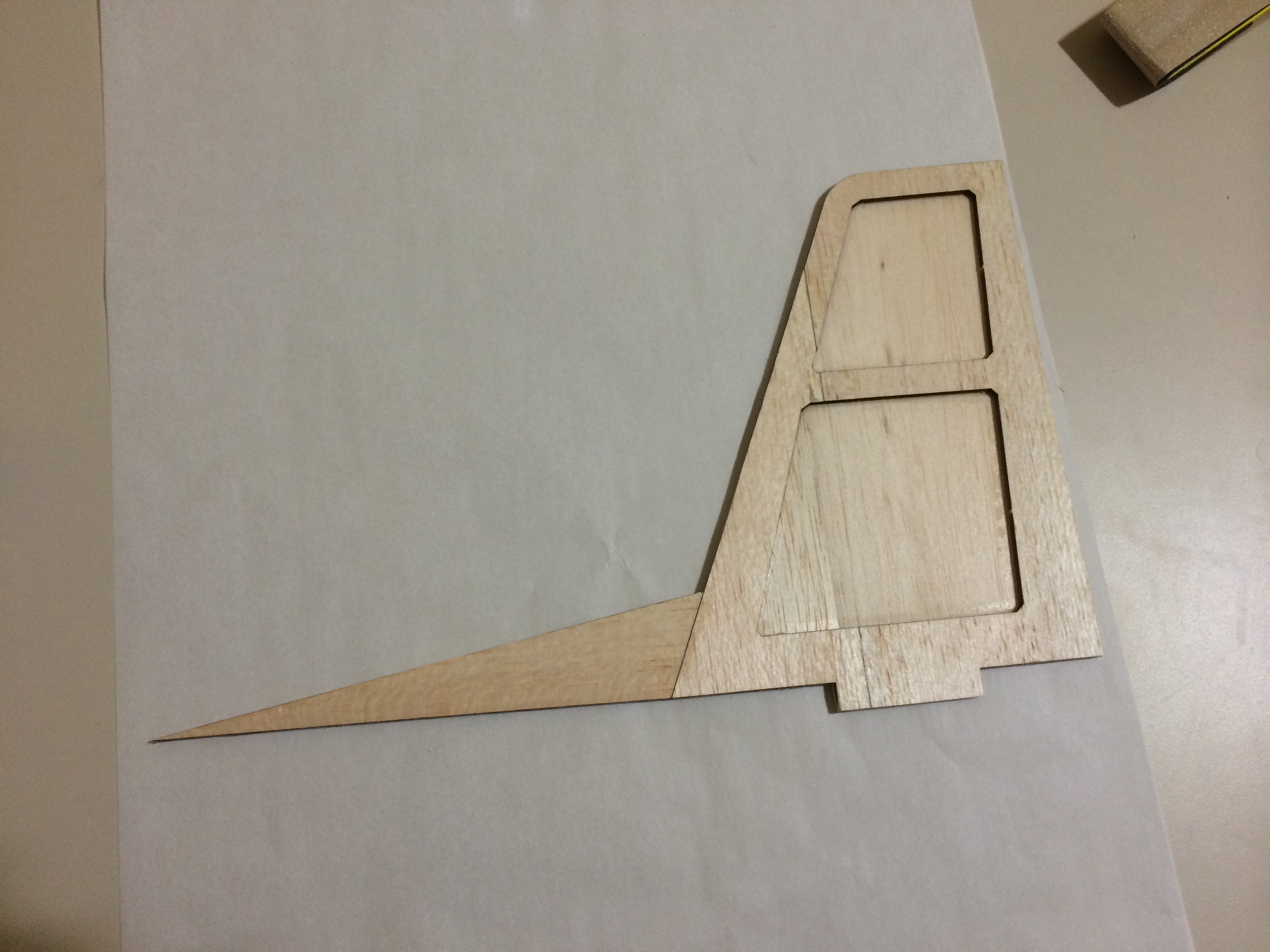

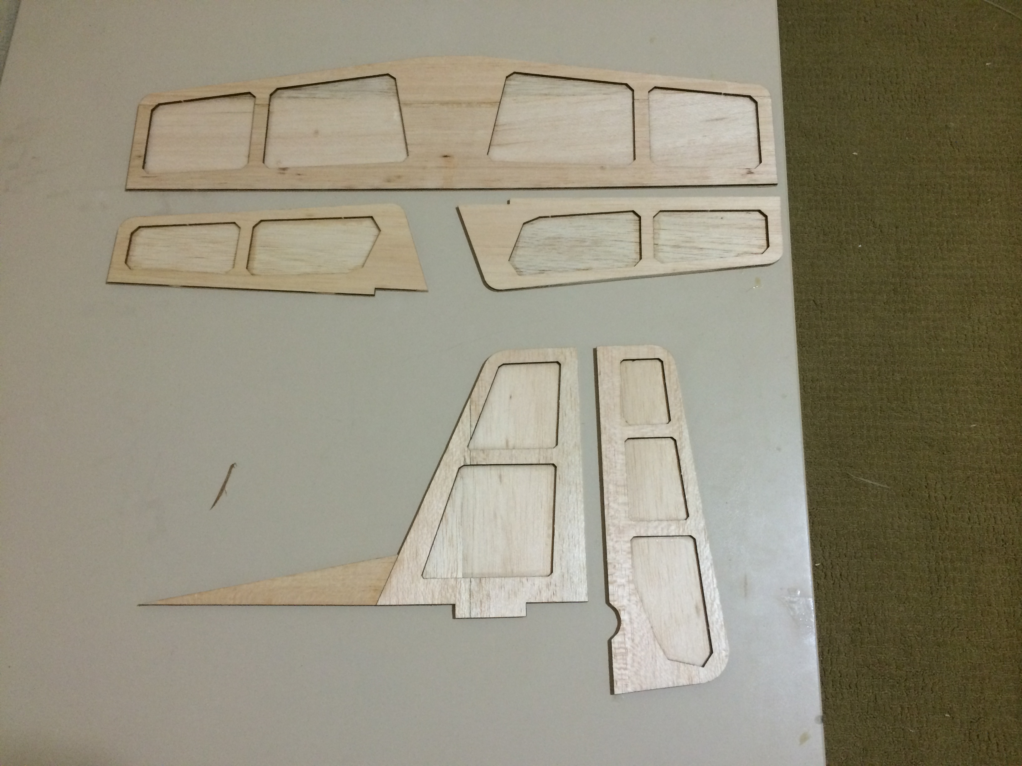

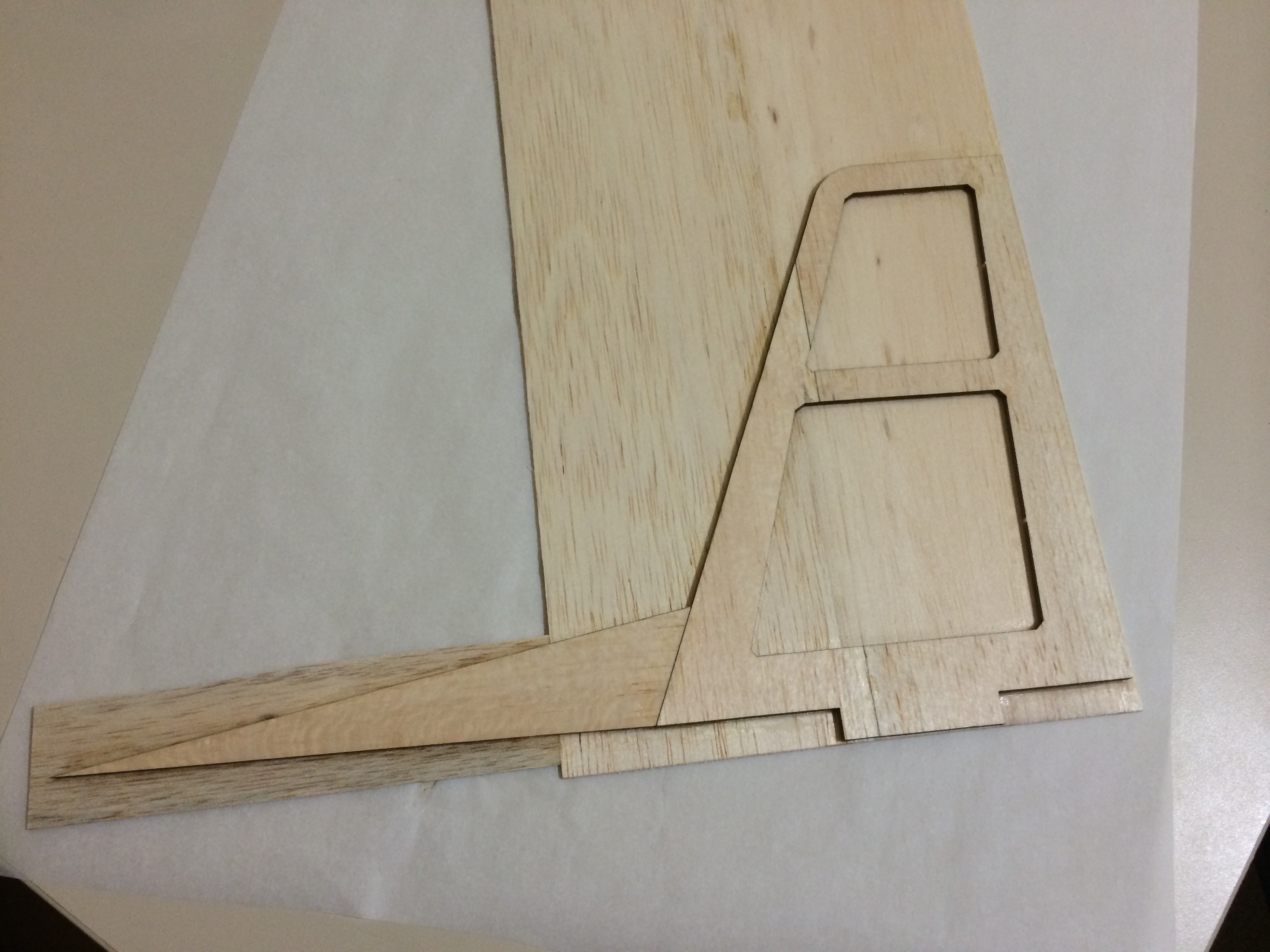

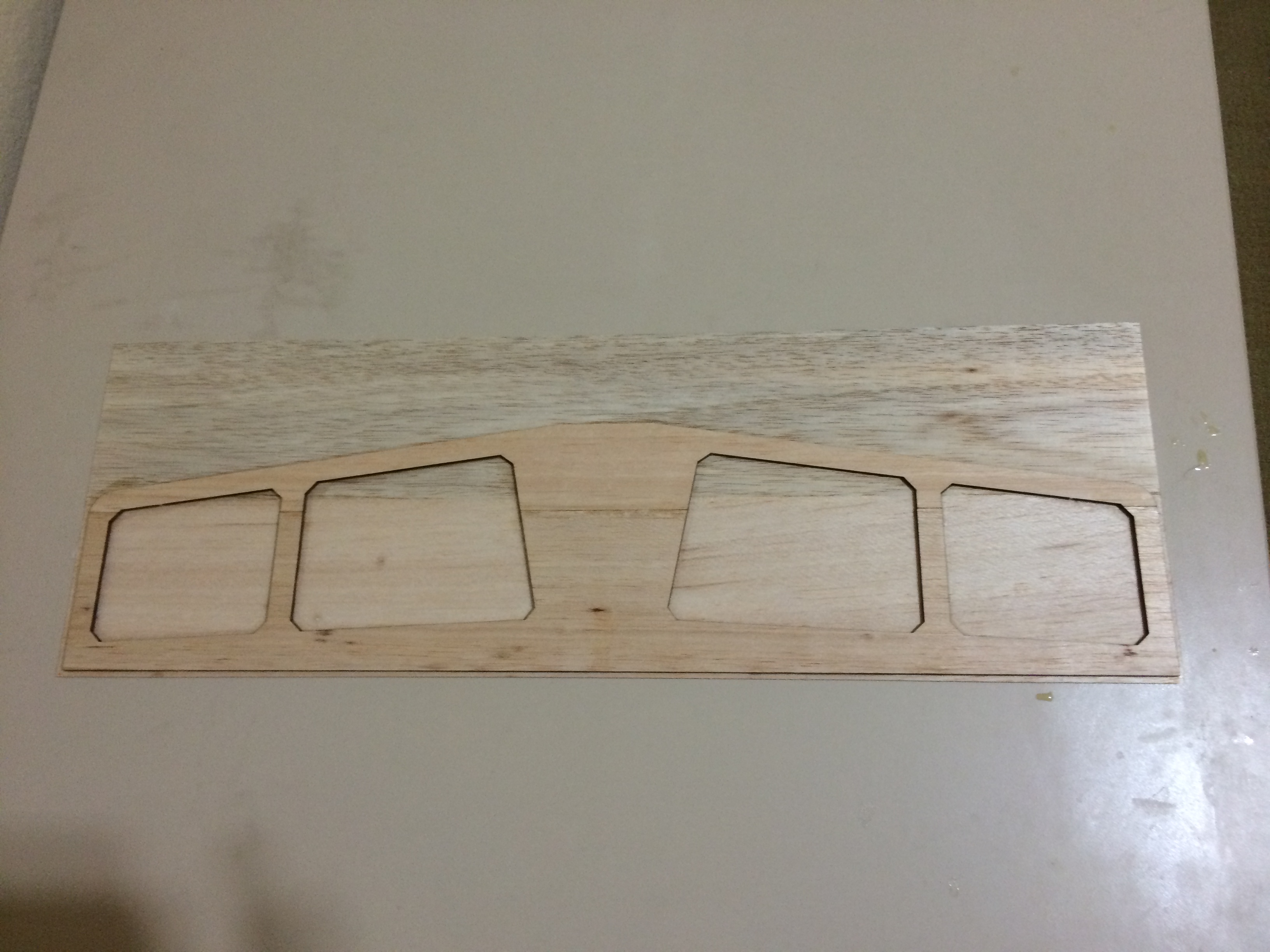

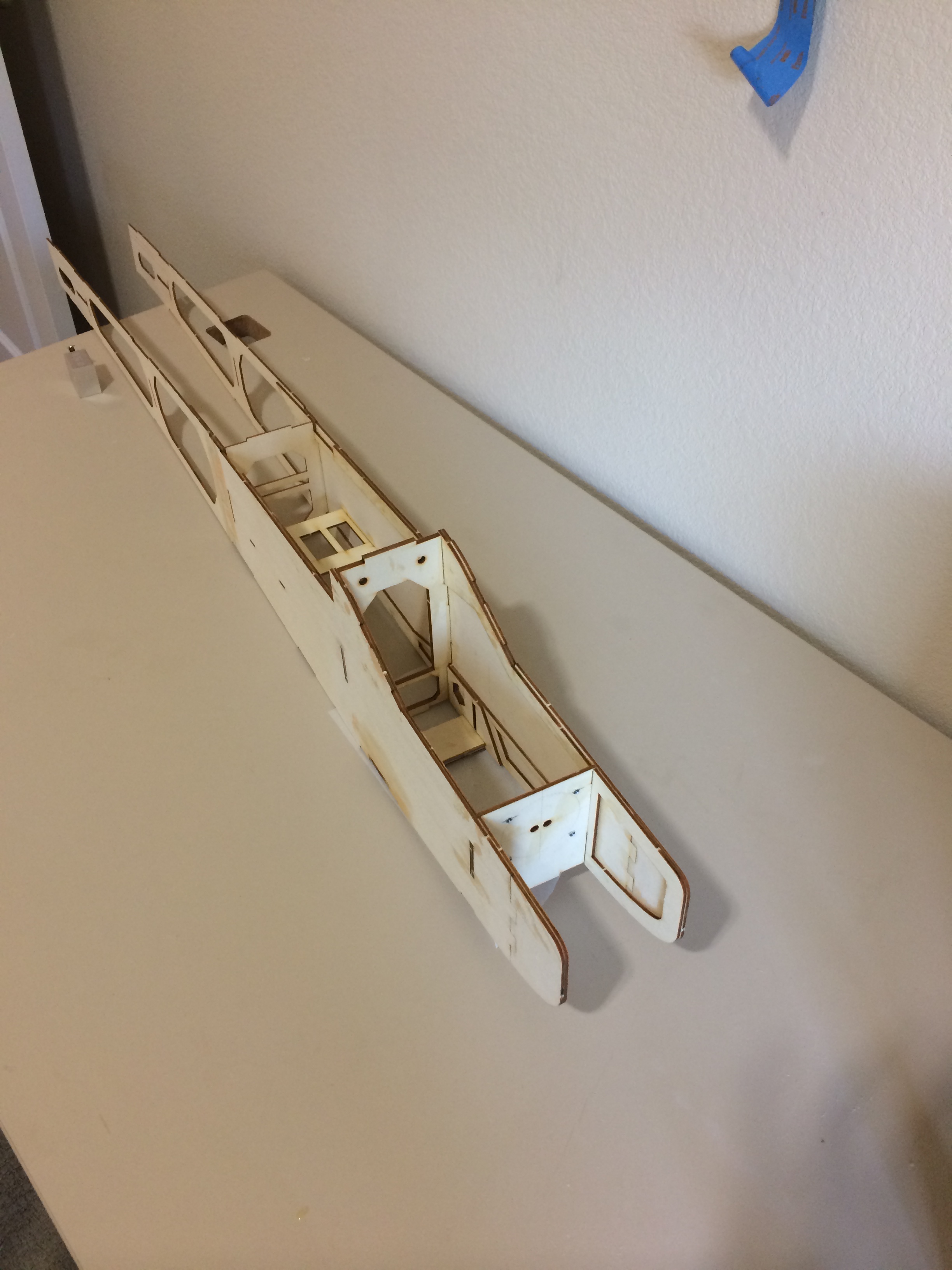

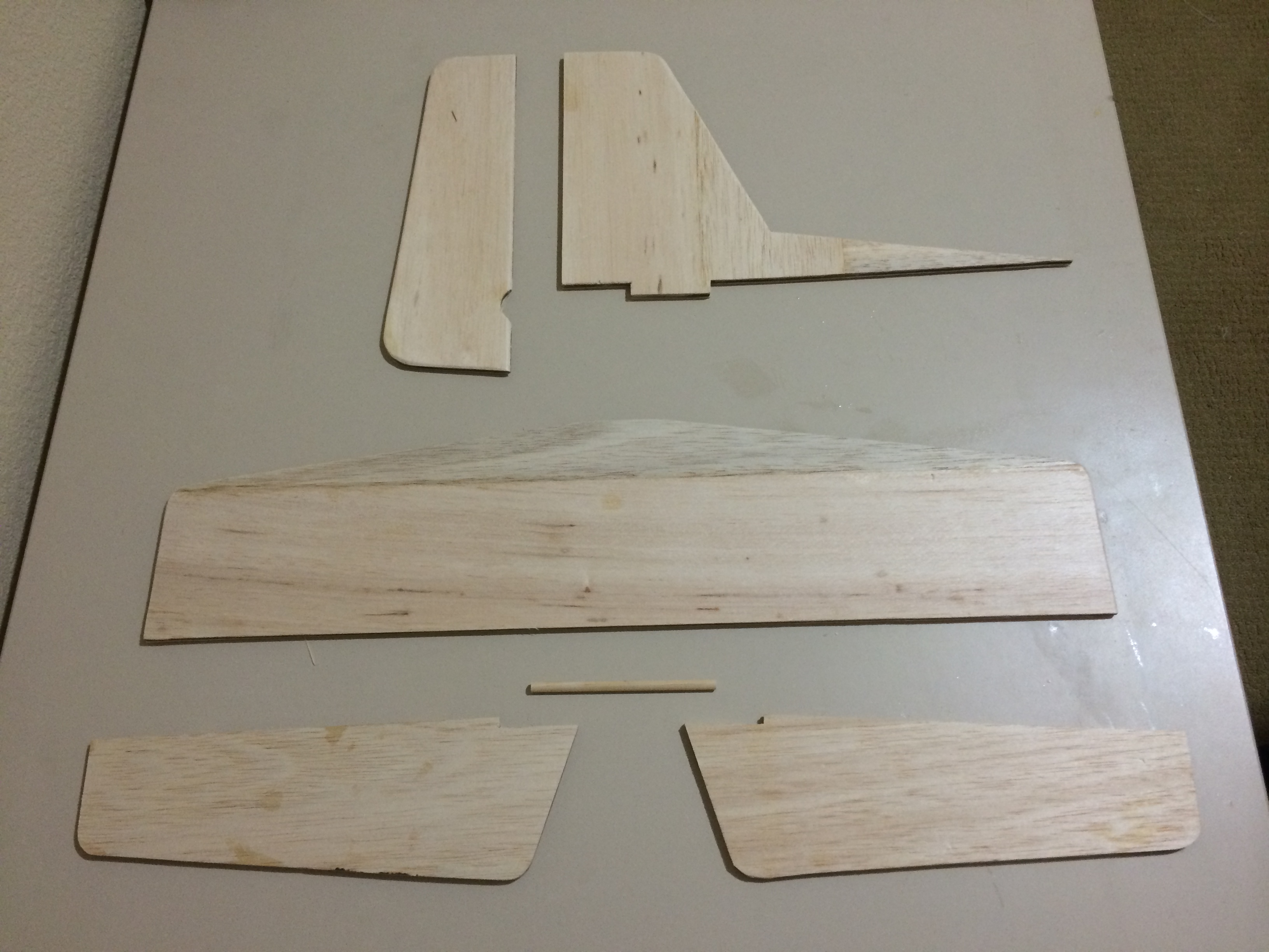

Spent some time on the build and I have nearly completed the tail feathers. So far, it has been very straight forward. Just some simple gluing and light sanding. The only observation I would make is that it would be nice for them to include some kind of template to help lay out the sheeting to keep it down to the 7 sheets they provided. I ended up using an extra sheet of balsa I had to make all the pieces fit easily because I couldn't quite get the jig saw puzzle solved of how to maximize the usage and minimize the waste of the balsa sheeting. Very minor problem though and someone that has built kits before could probably solve the problem very easily. I also used a scrap piece of balsa turned 90 degrees for the vertical fin to easily sheet the extended length that part R-1 adds to the structure. If you look at the picture associated with step 6 in the manual, you can see something similar was done but it was not pointed out in the text.
My plan is to start the fuselage tomorrow night and if all goes well and time doesn't get away from me, I hope to get most of that structure done by the end of the weekend.

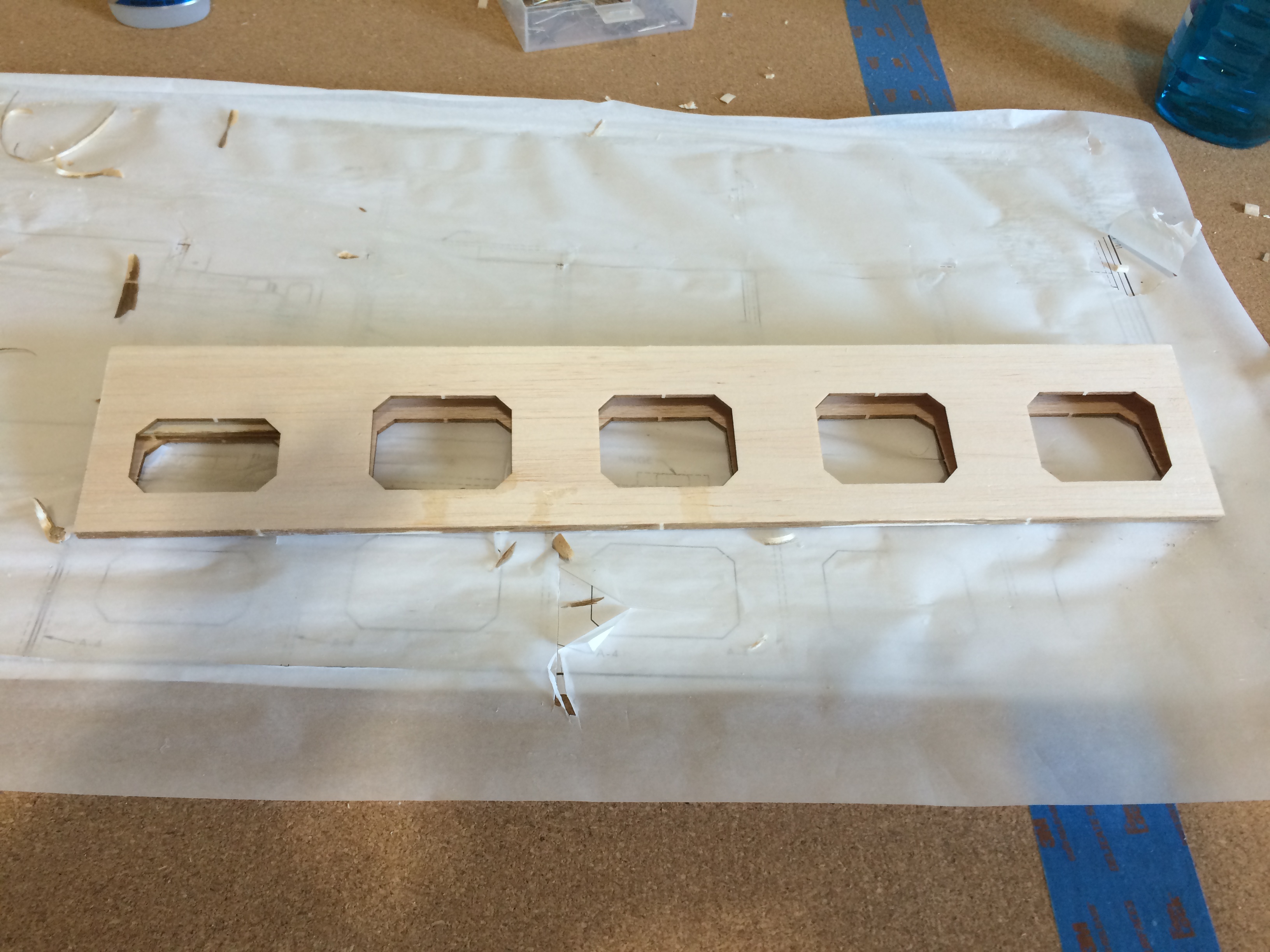

Finally got some more work in on the Funmaster. Tail is completely finished and I started some of the initial work on the fuse. I hope to get a good start on it today. All things considered the build is going well so far and I am happy with the results. Pictures of the fuselage will come as a get a little more done on it.

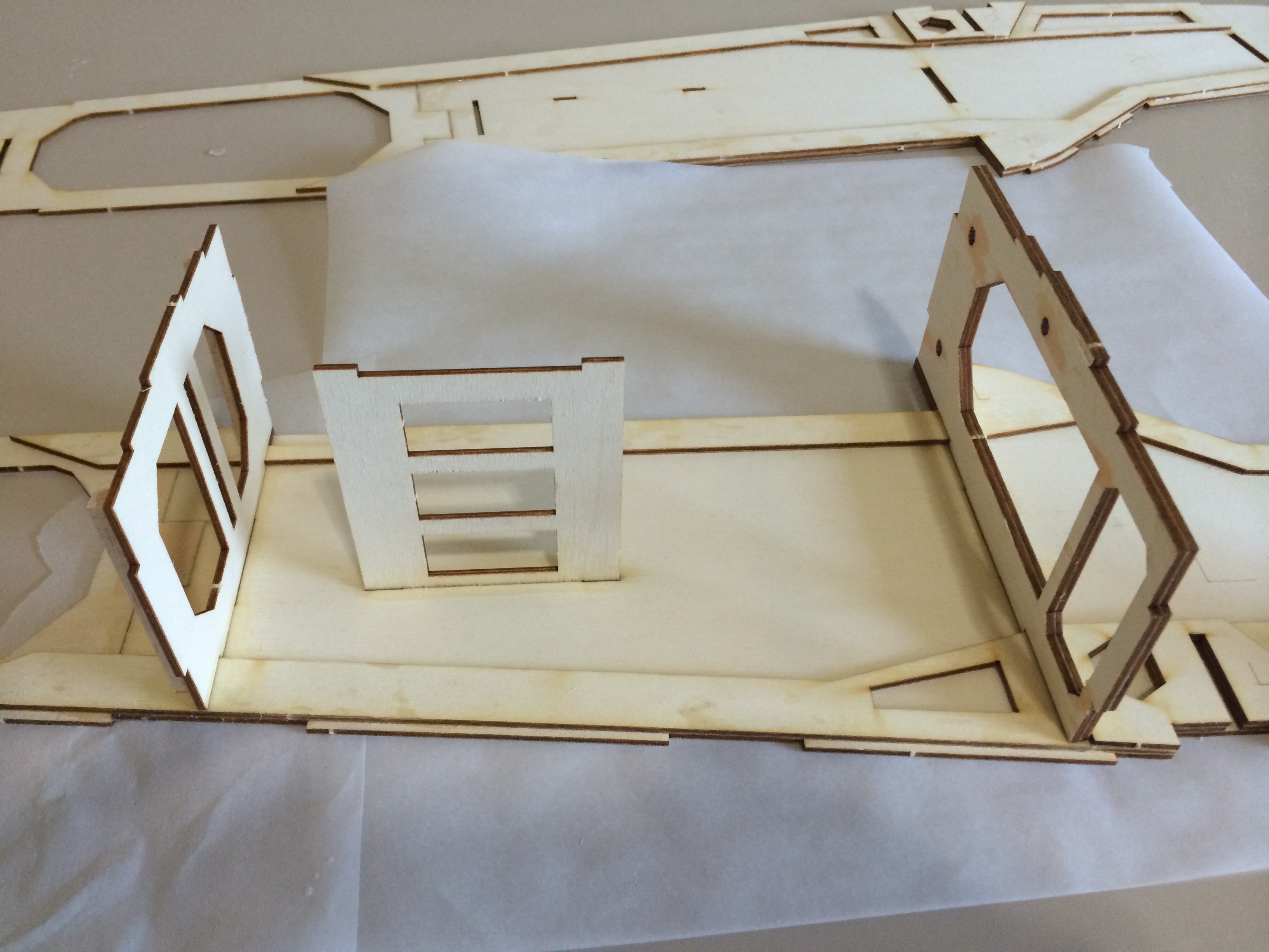

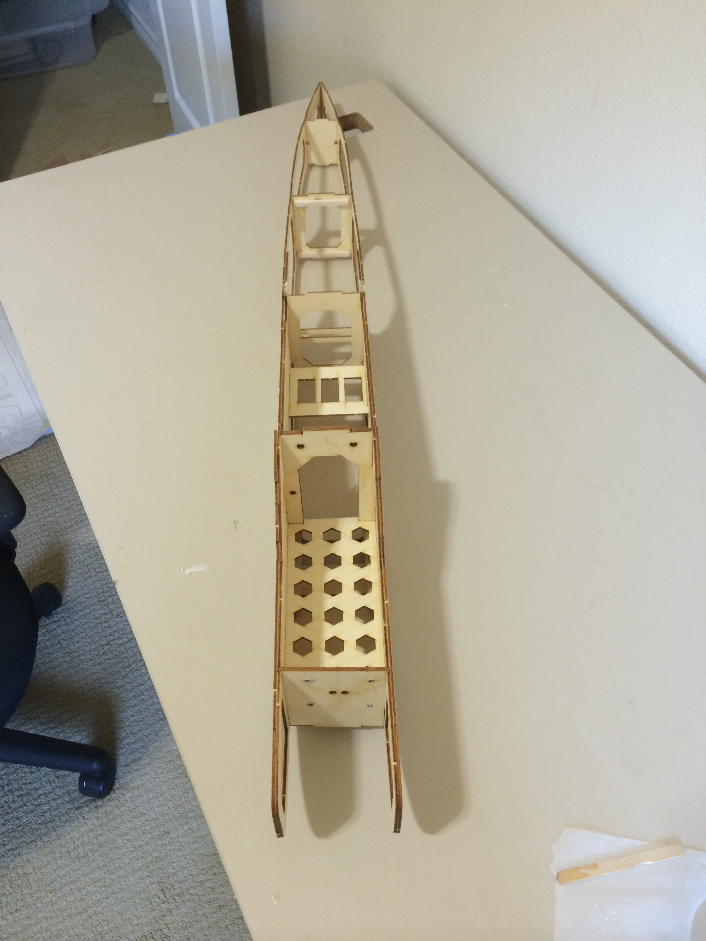

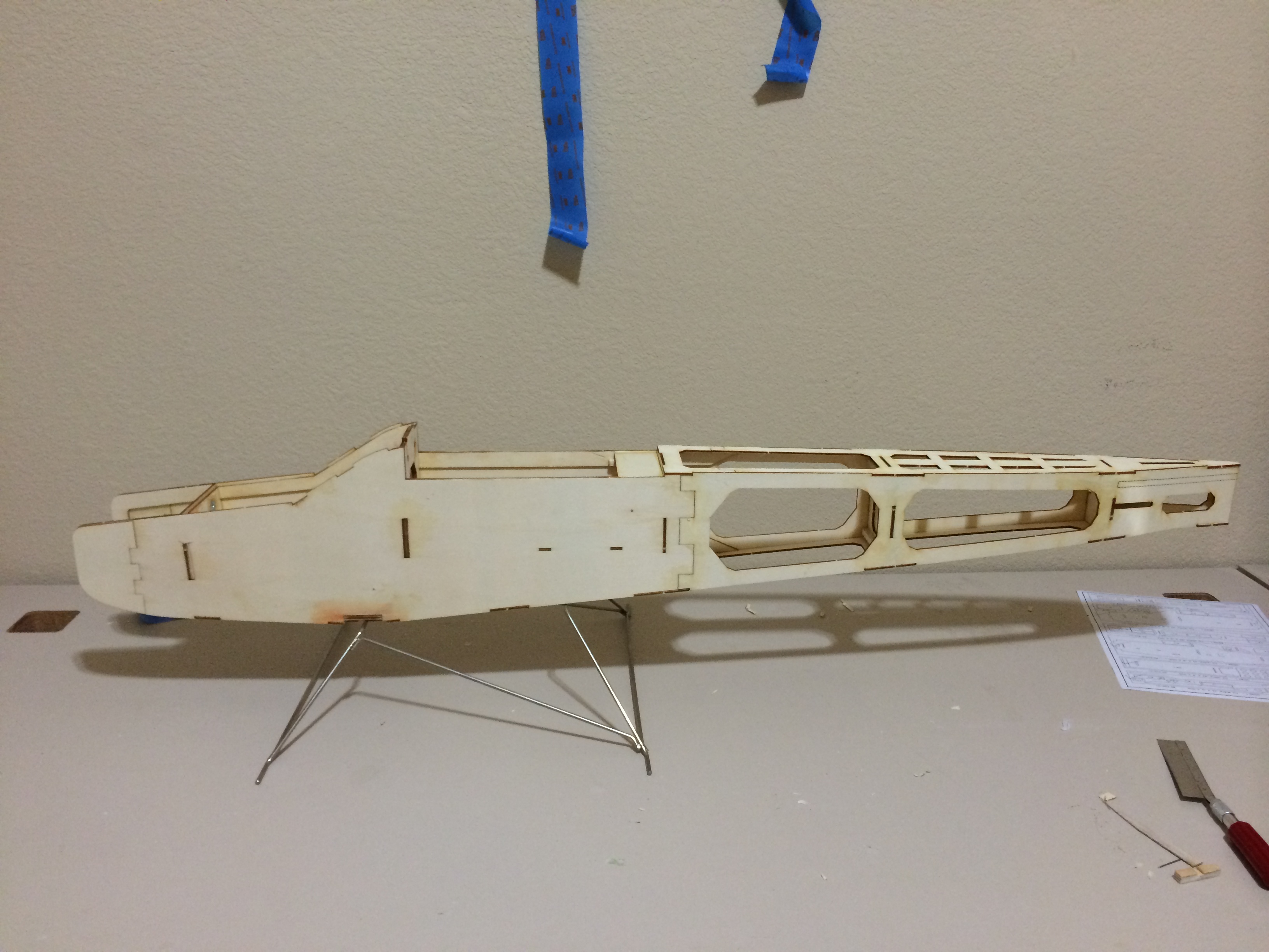

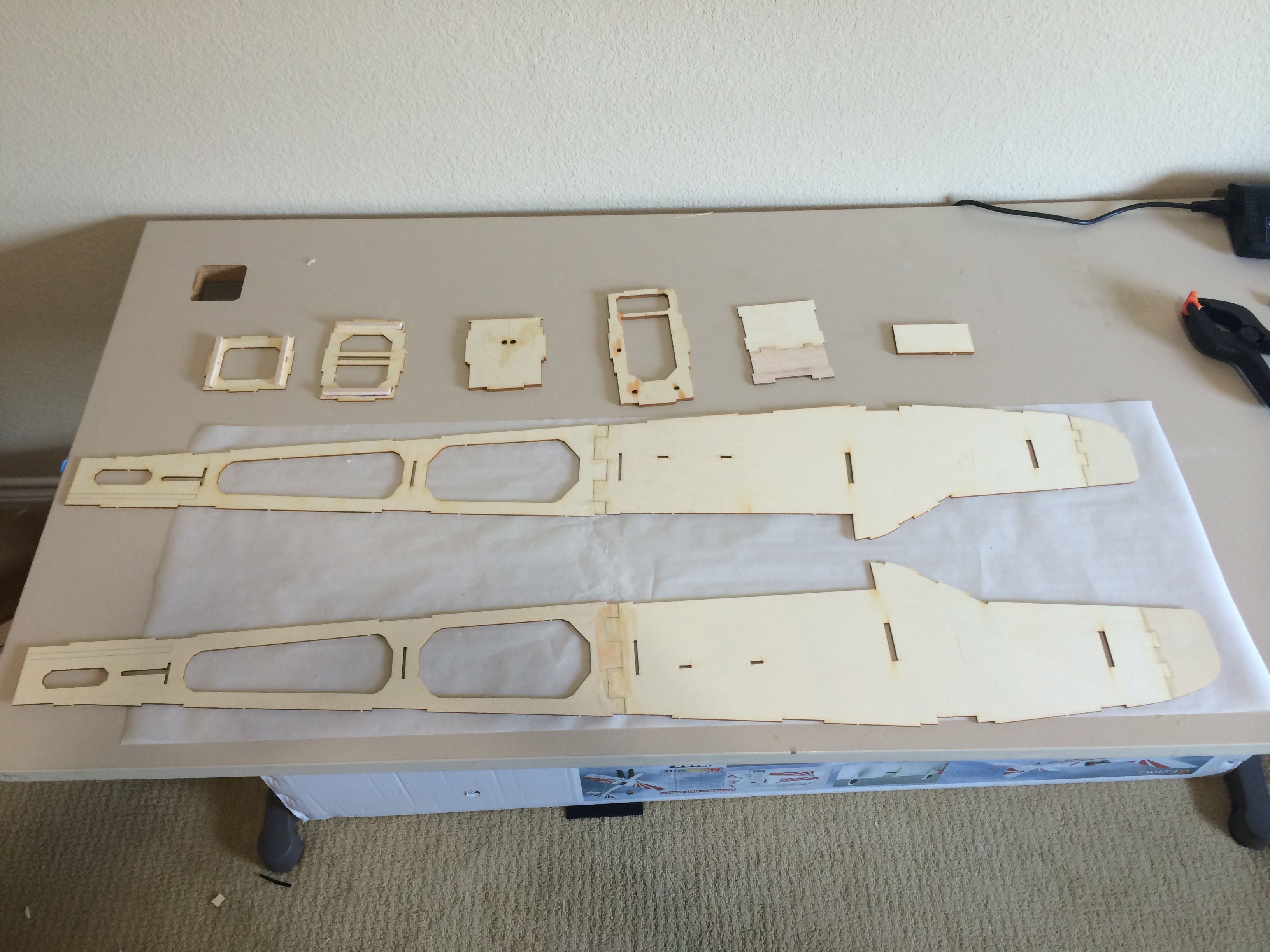

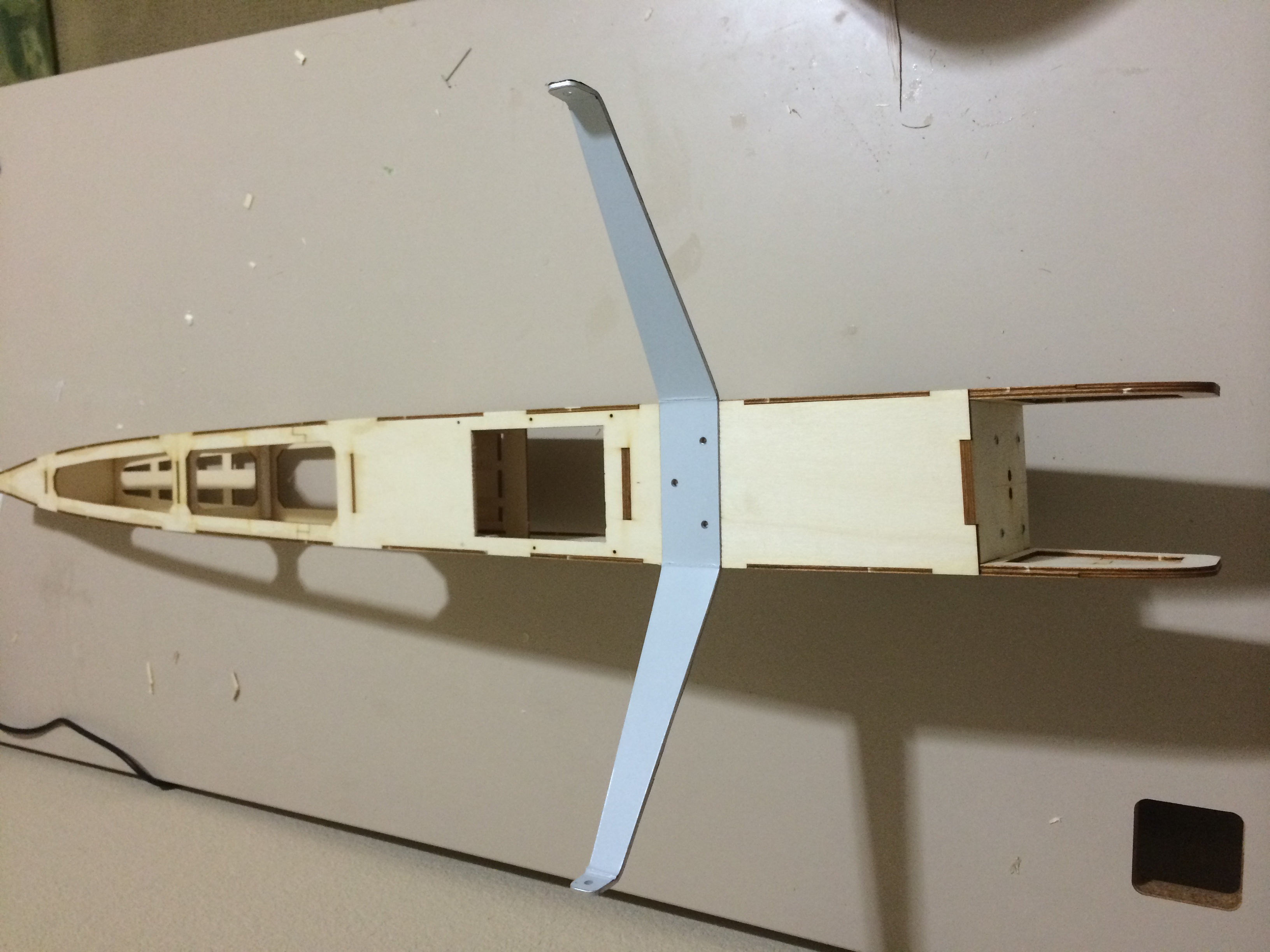

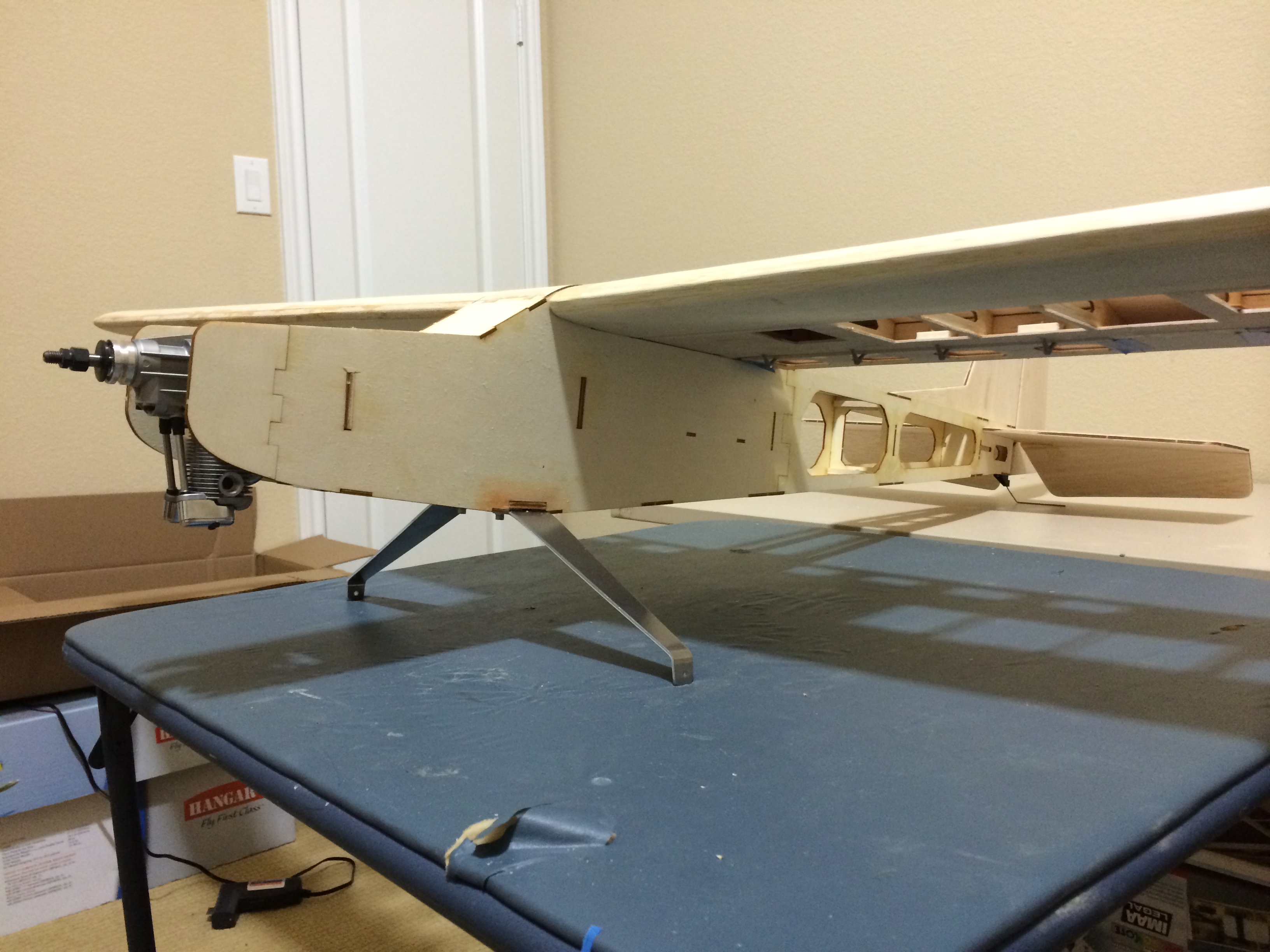

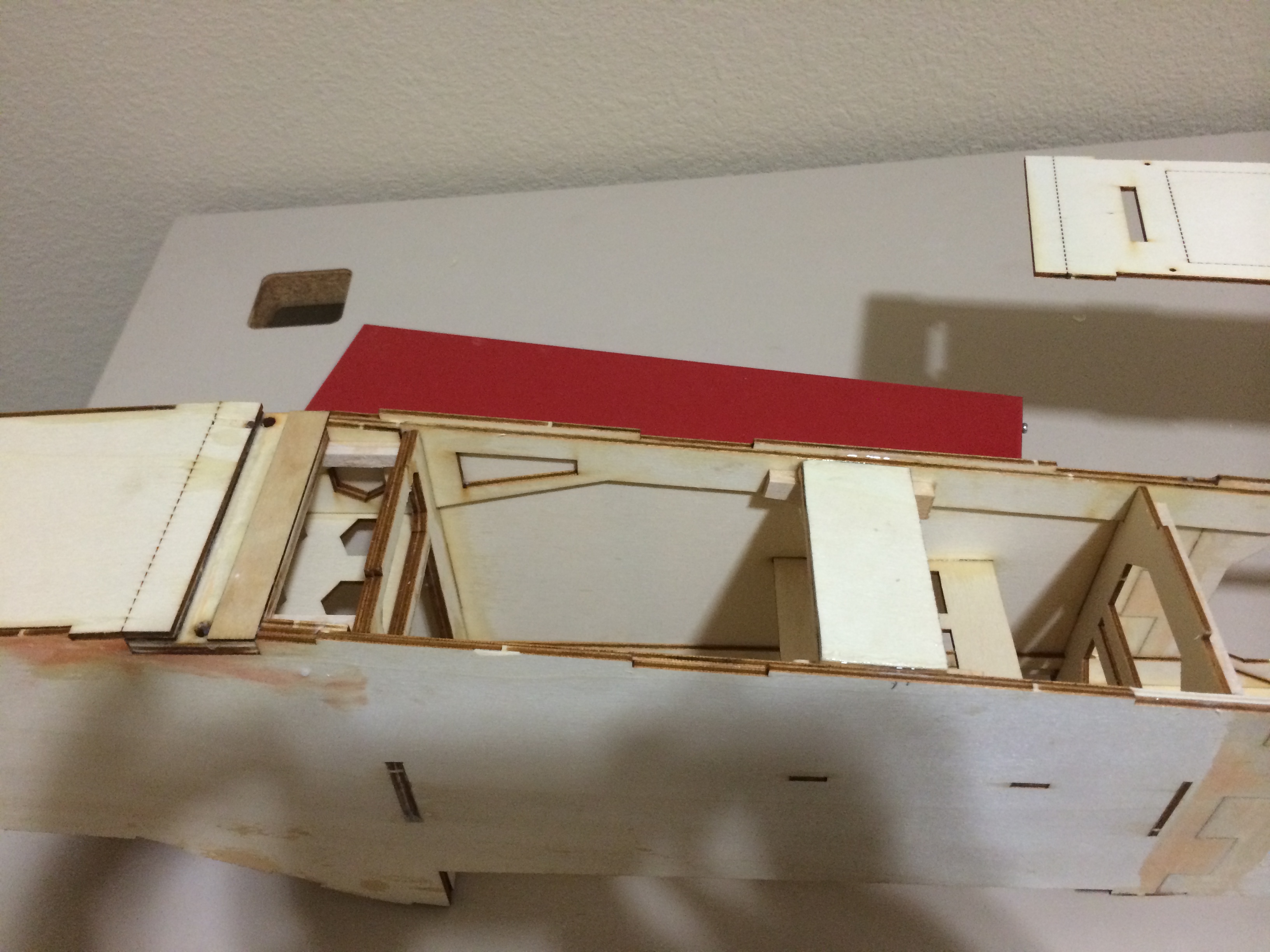

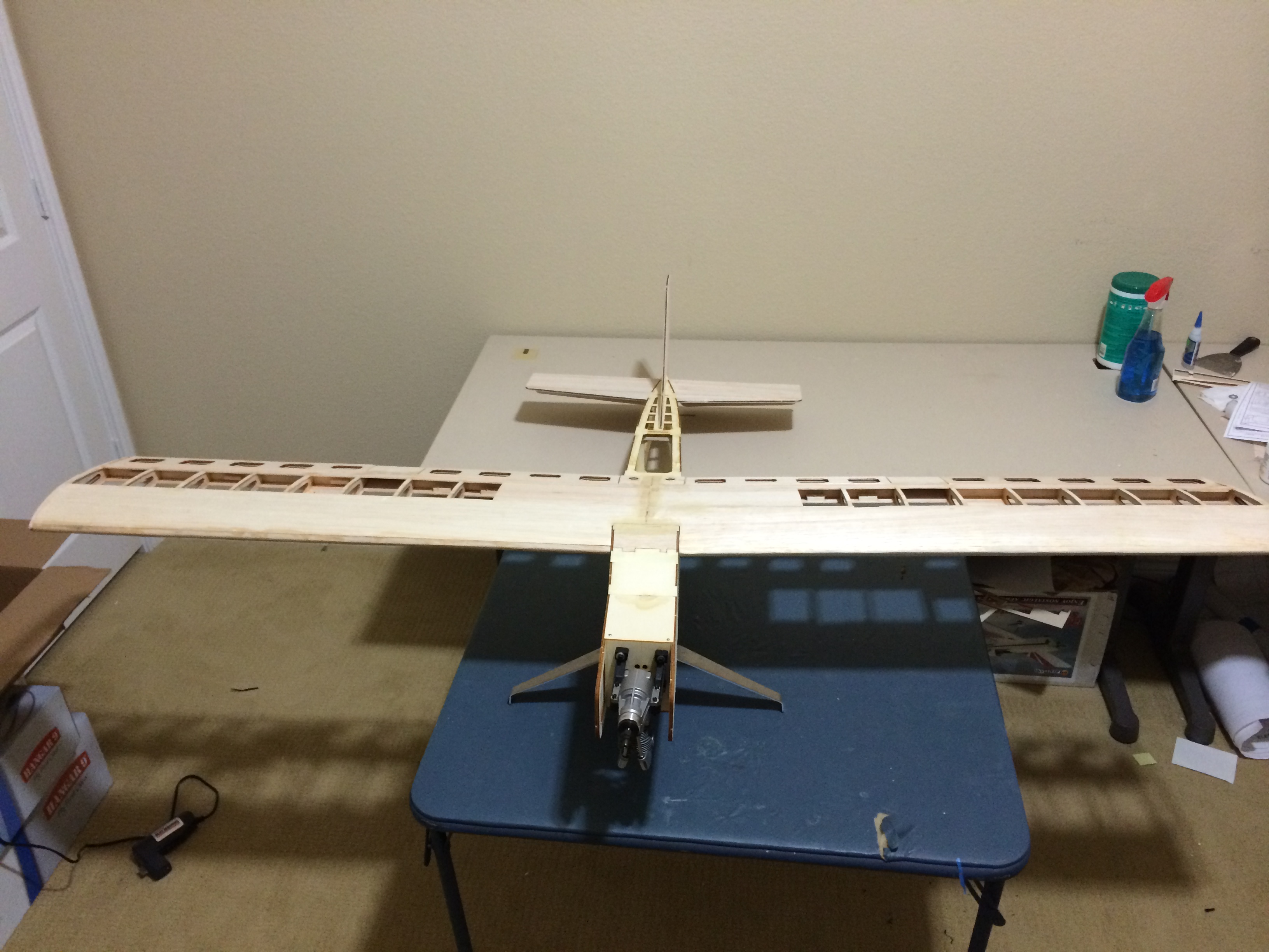

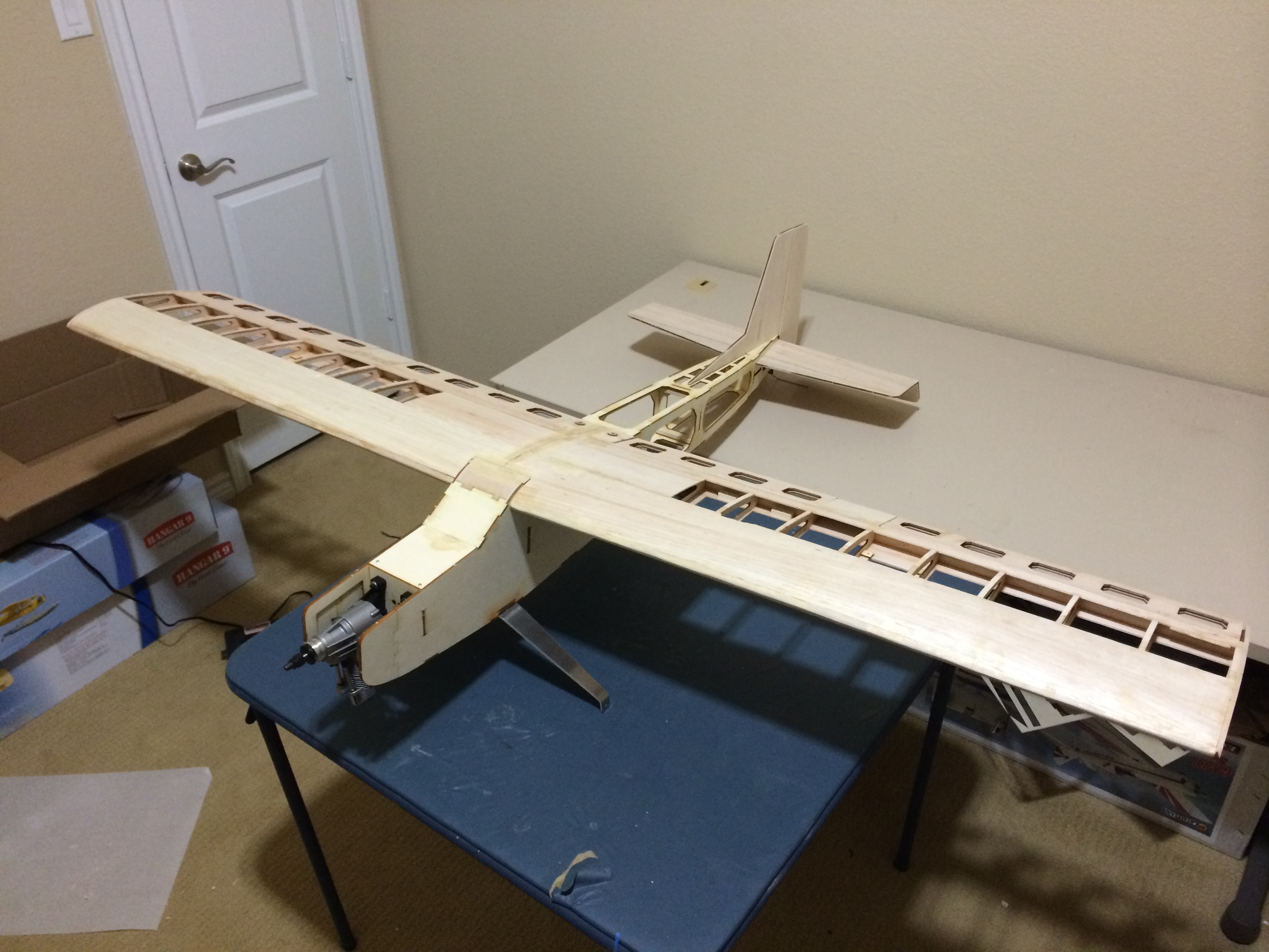

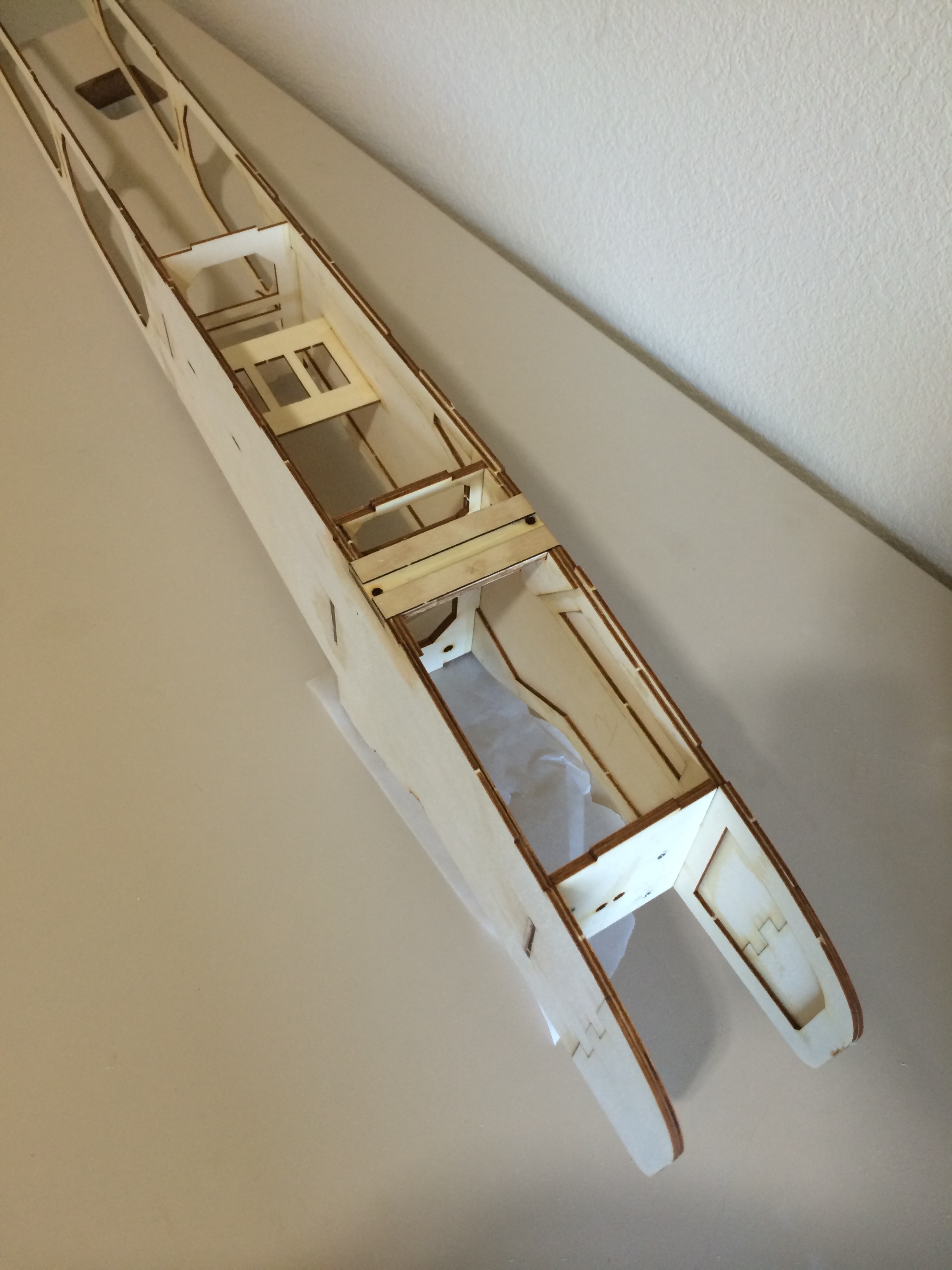

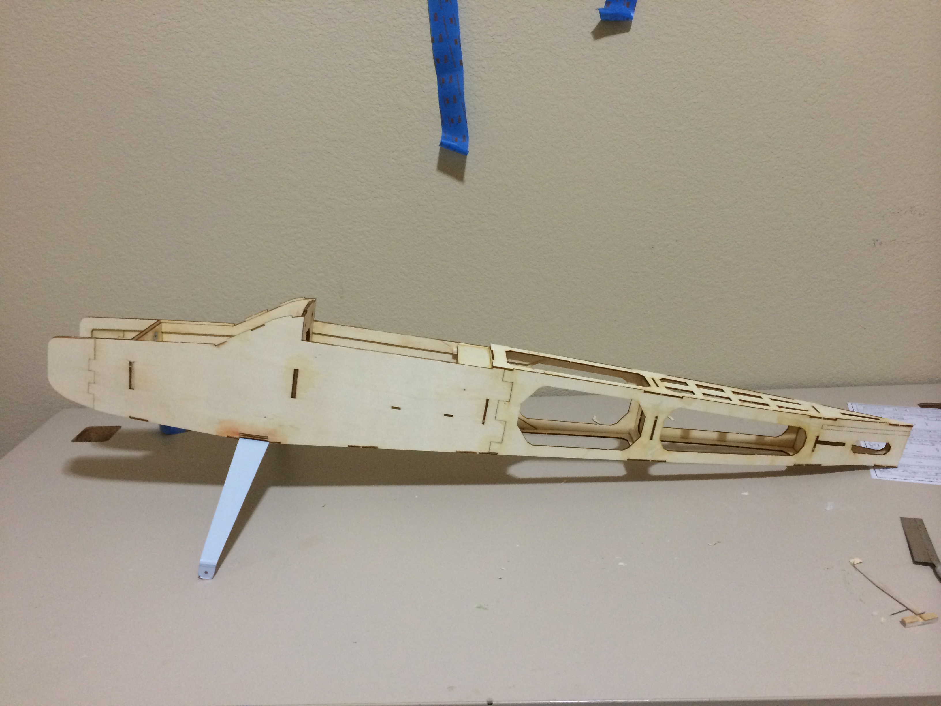

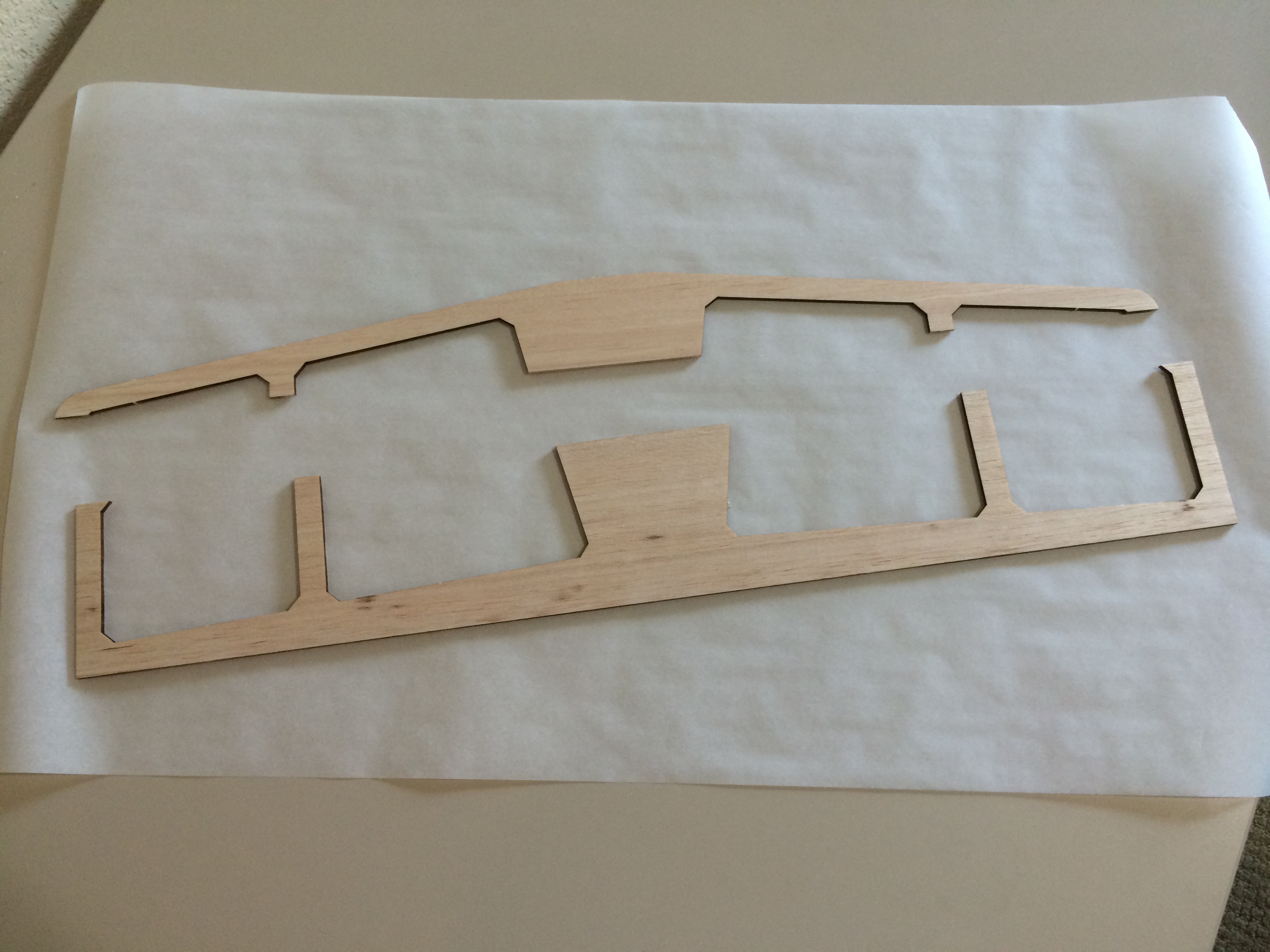

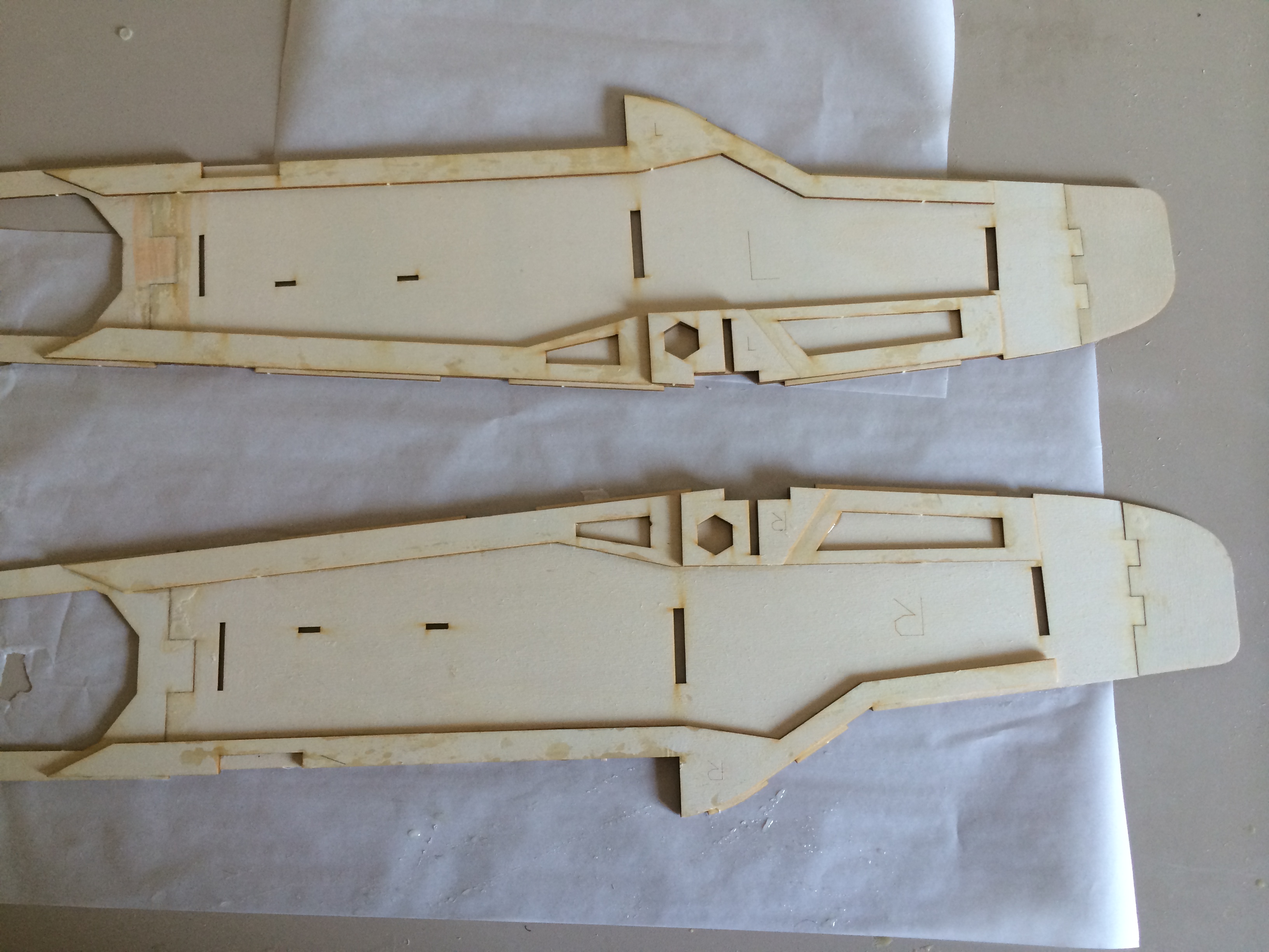

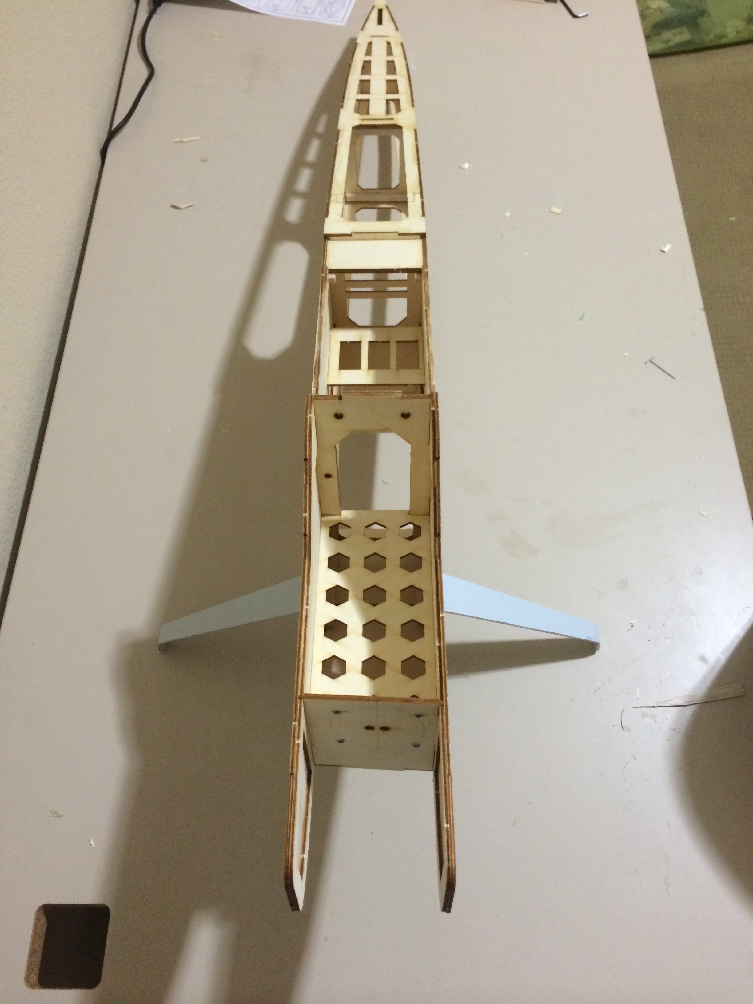

Well, this weekend proved to be very fruitful. I have the fuselage completed and I am ready to start on the wings. This kit really is an easy build. I have been very impressed. A few things you will notice as you walk through the pictures. First, I installed an extra gear mounting block where the back mount will go for the float bracket. I also am going to be using an aftermarket set of landing gear instead of the music wire ones that come with the kit. There is nothing wrong with those, I just prefer to use the stamped aluminum type of gear over bent music wire. I did leave the gear retainers though so I can use them to mount the floats. All together, I couldn't be happier. At the pace things are going, My goal is to have the plane together by labor day weekend and to maiden it then. The only thing I am still waiting on are the waterproof servos I ordered for the wings and the covering. Both should be in this week so it looks like things are going nicely.

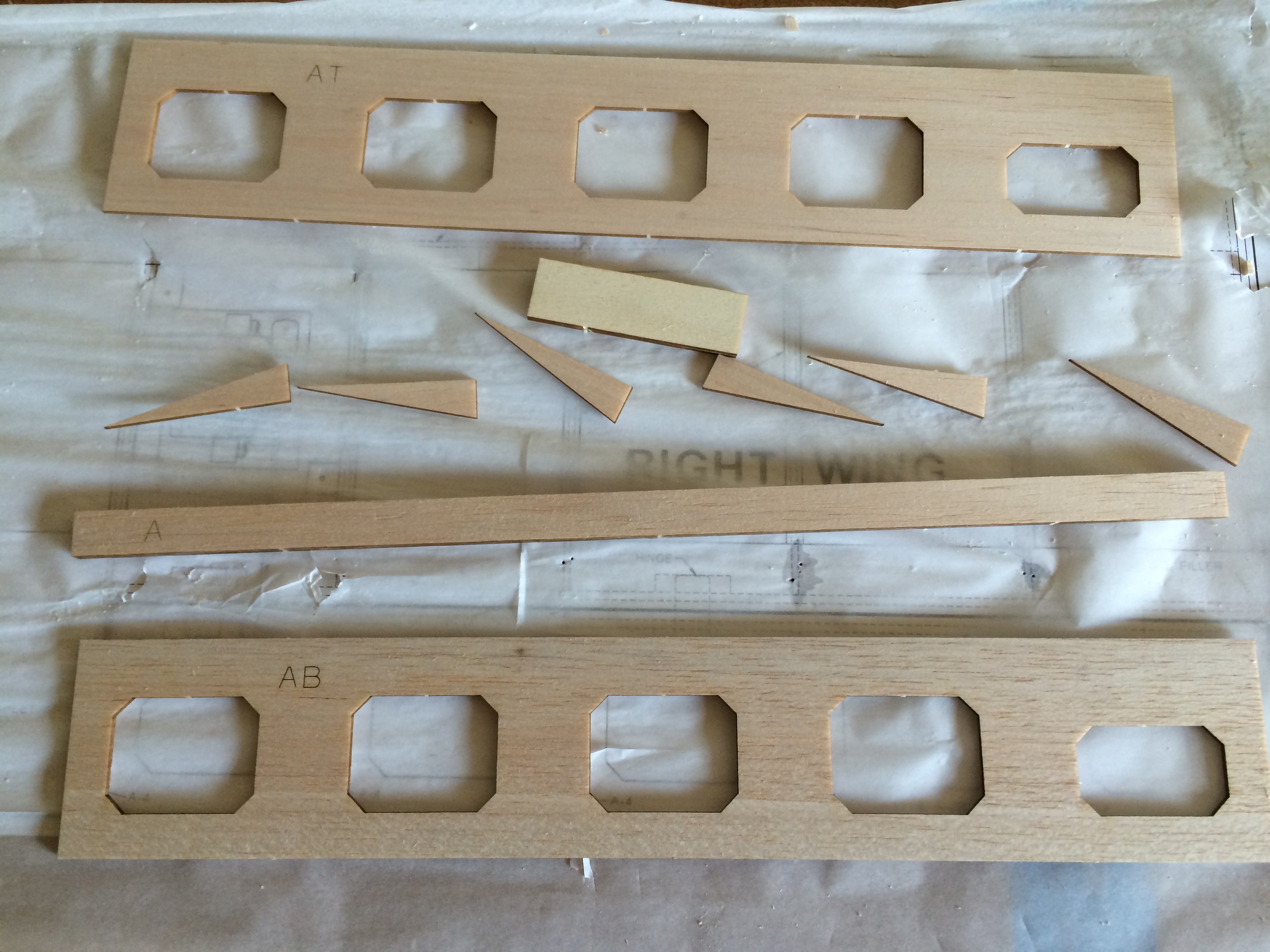

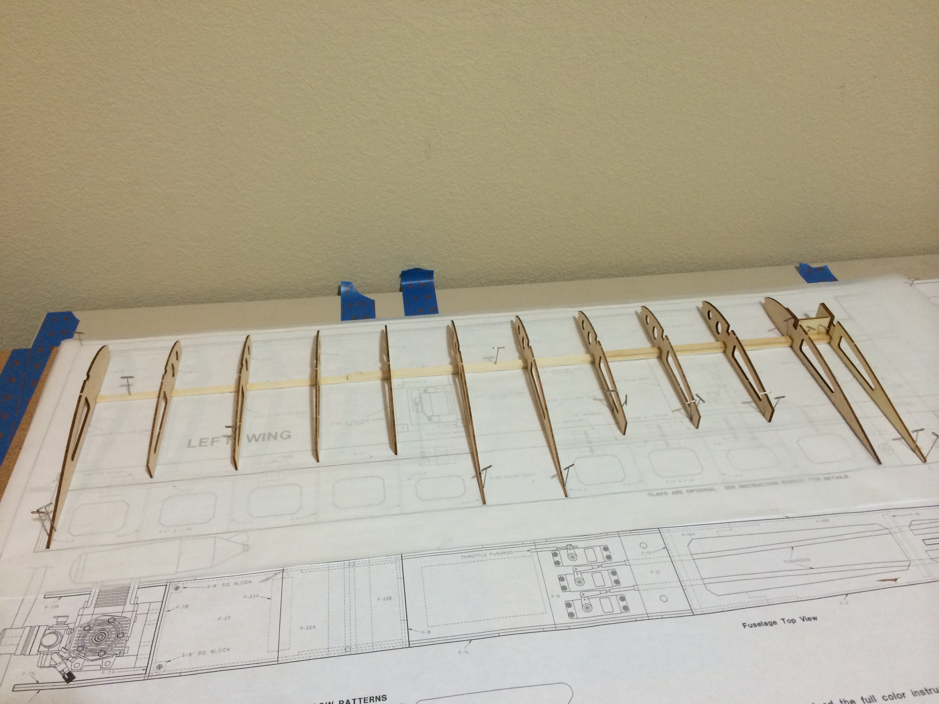

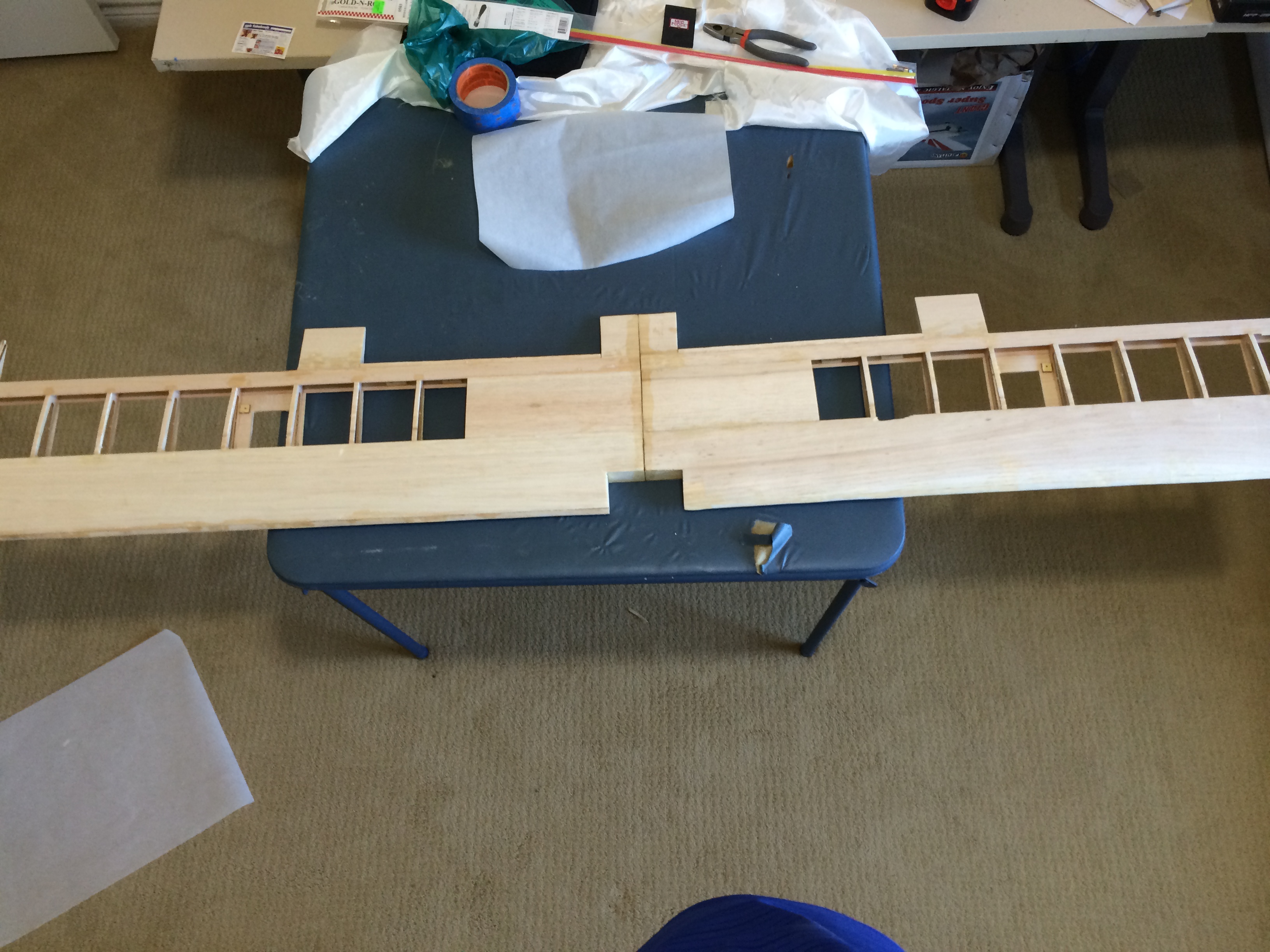

Old 08-25-2014 | 01:38 PM
Joined: Sep 2012
Posts: 54
From: Frisco, TX

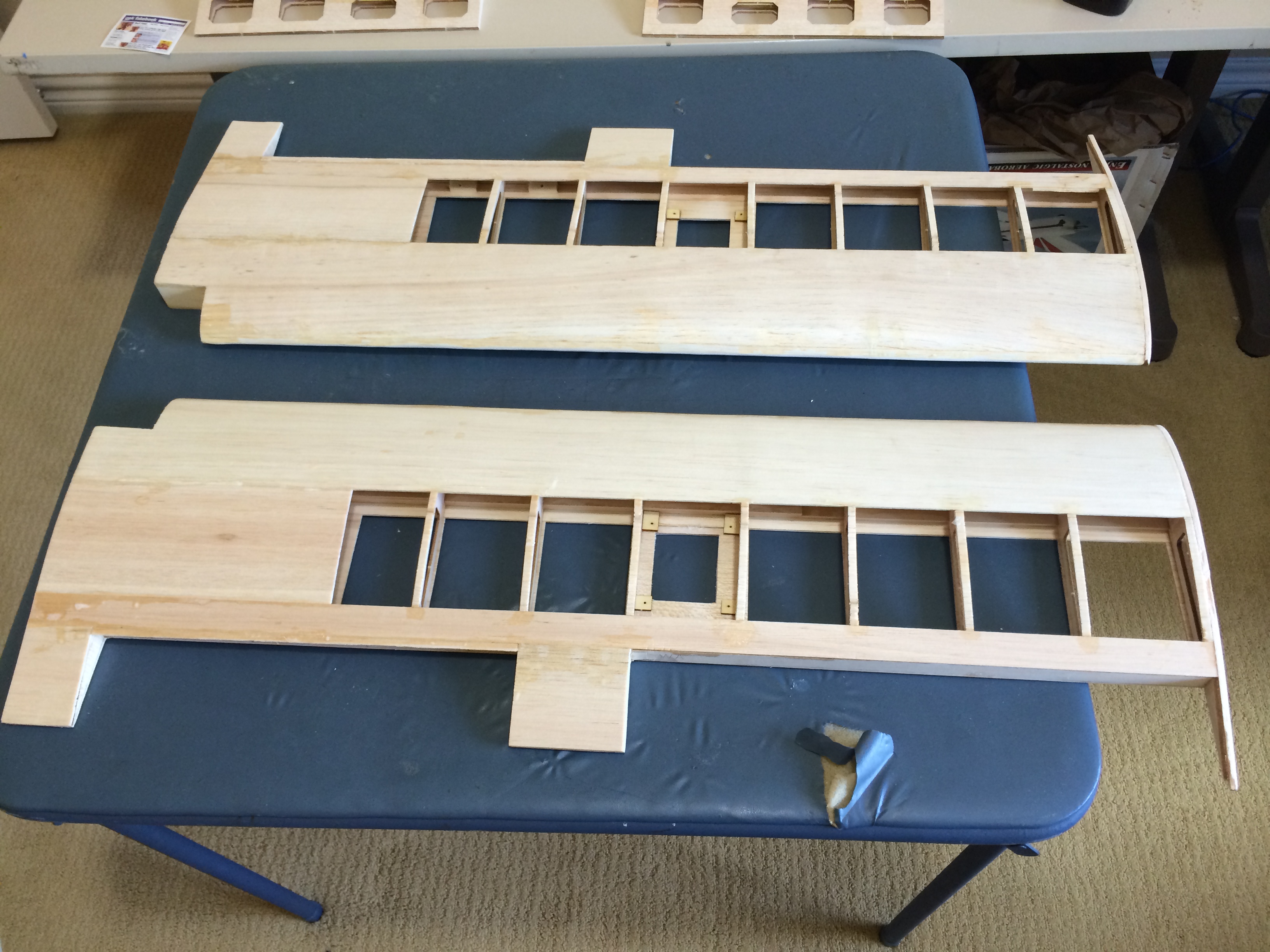

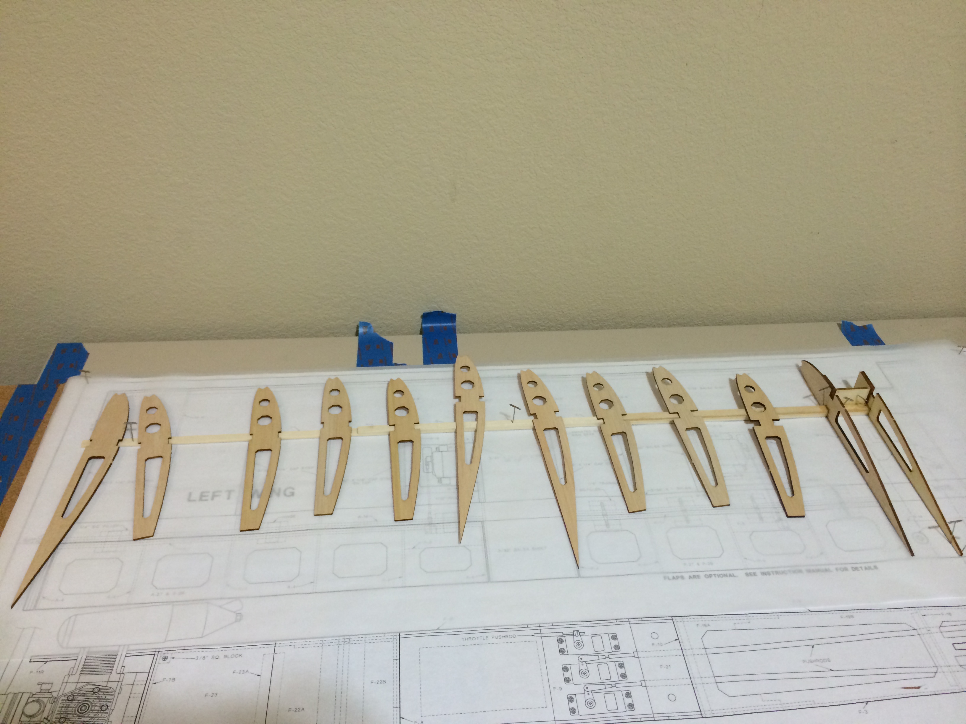

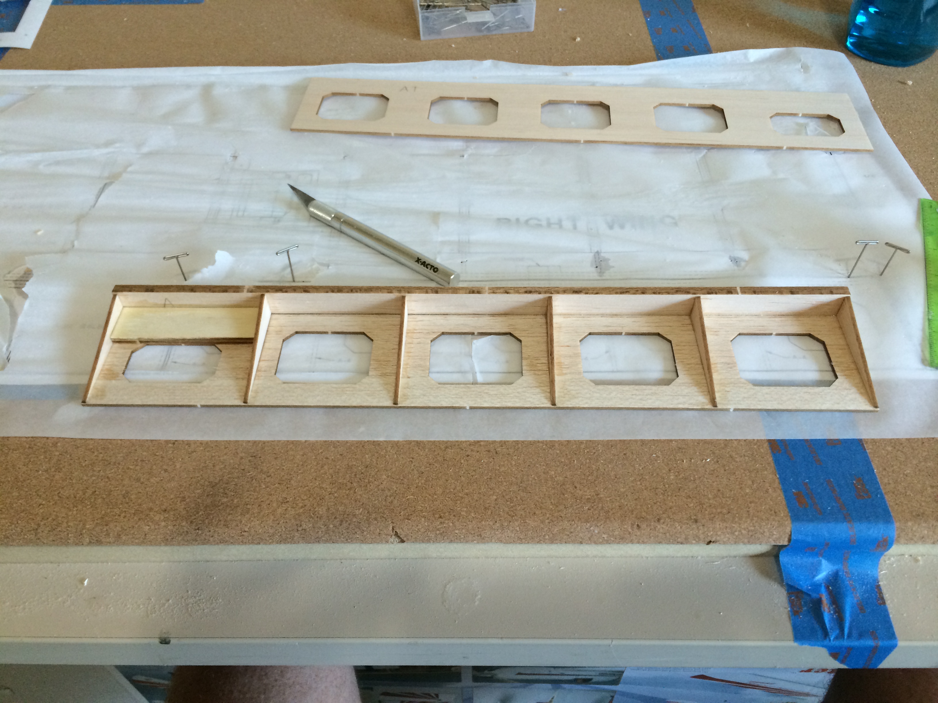

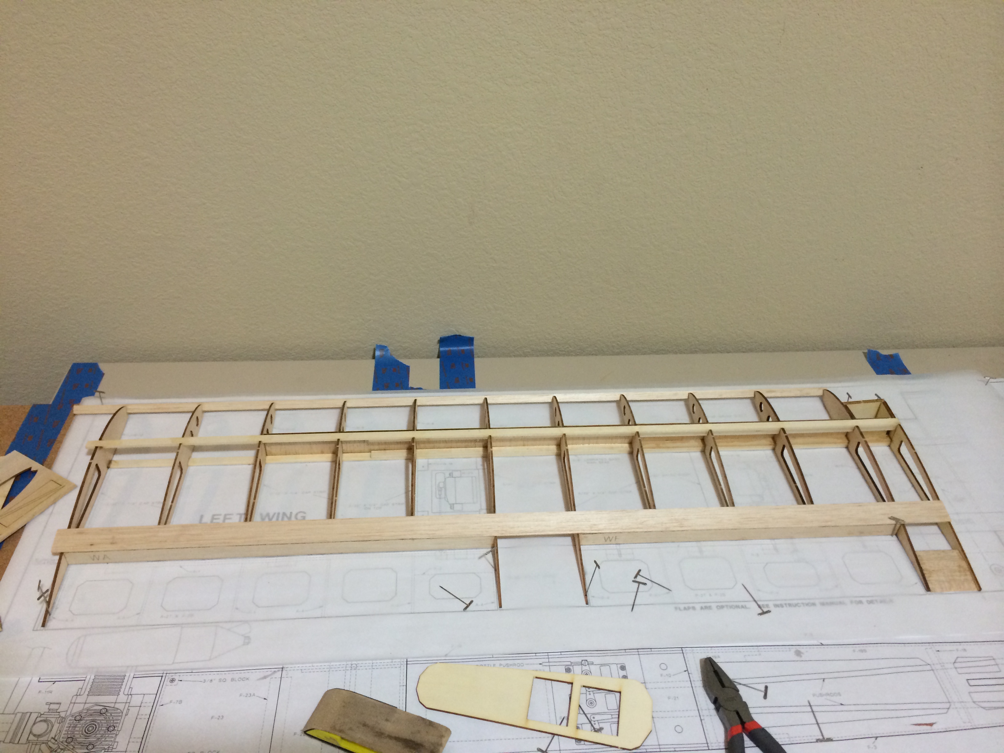

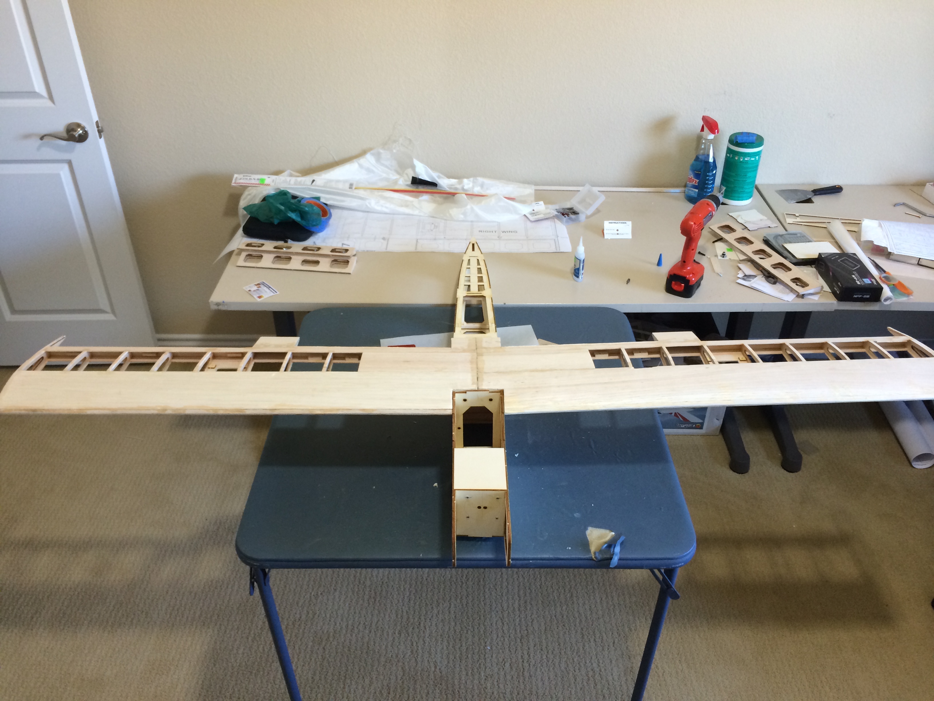

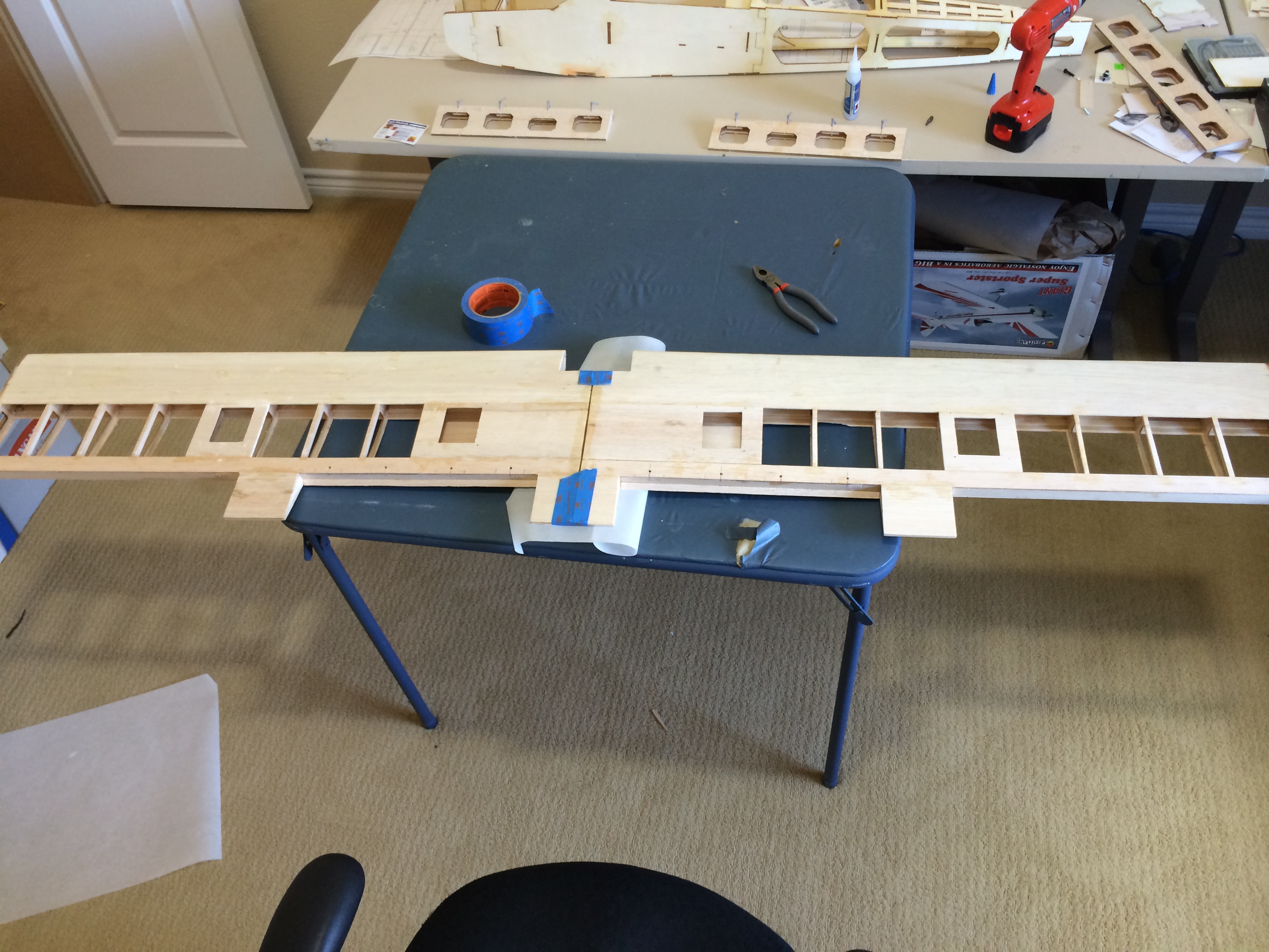

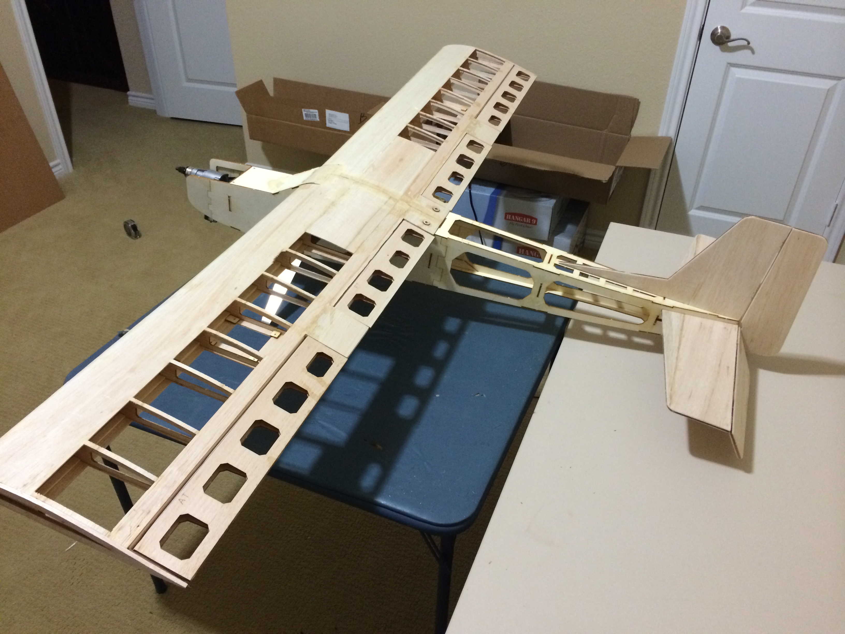

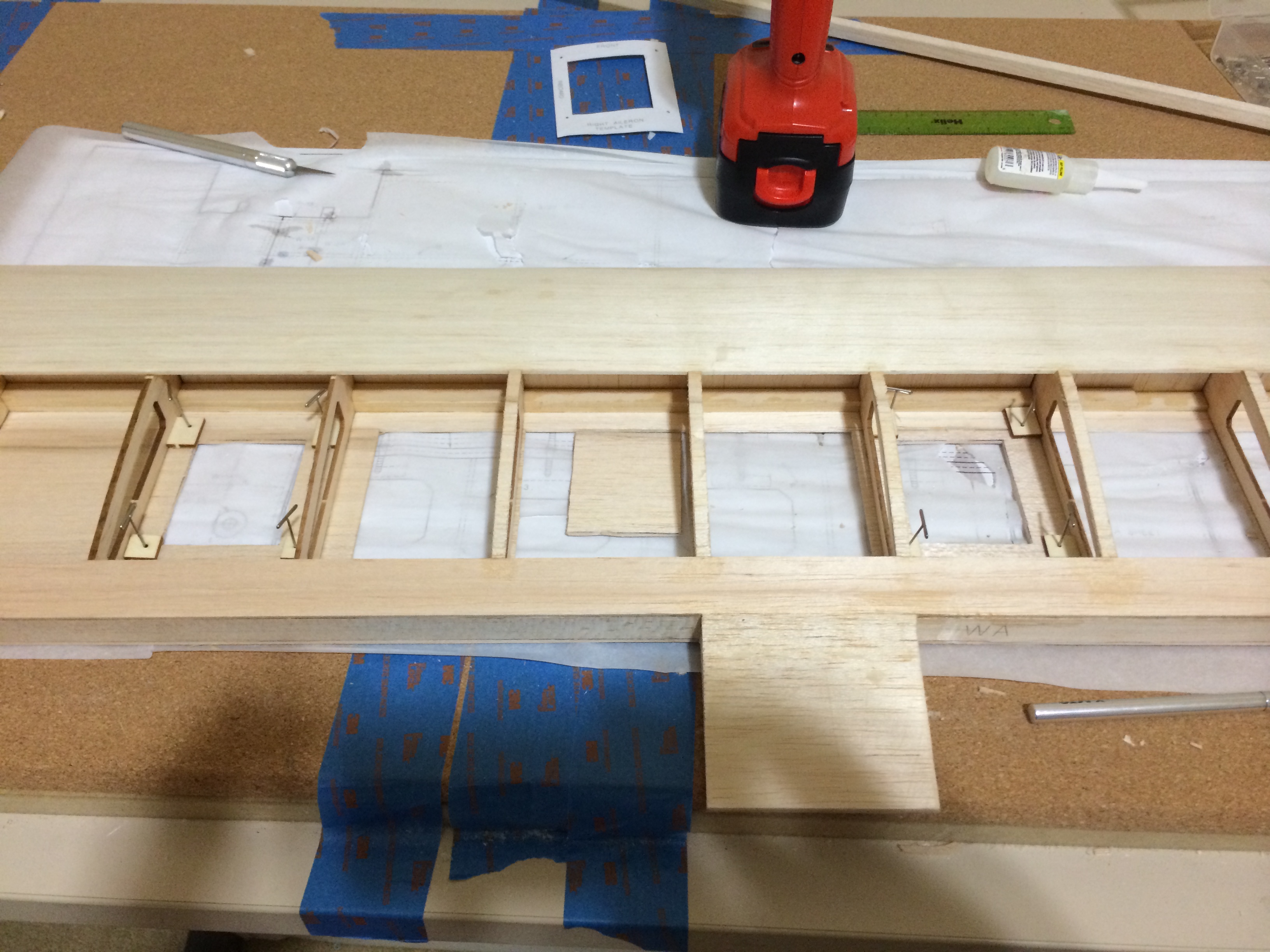

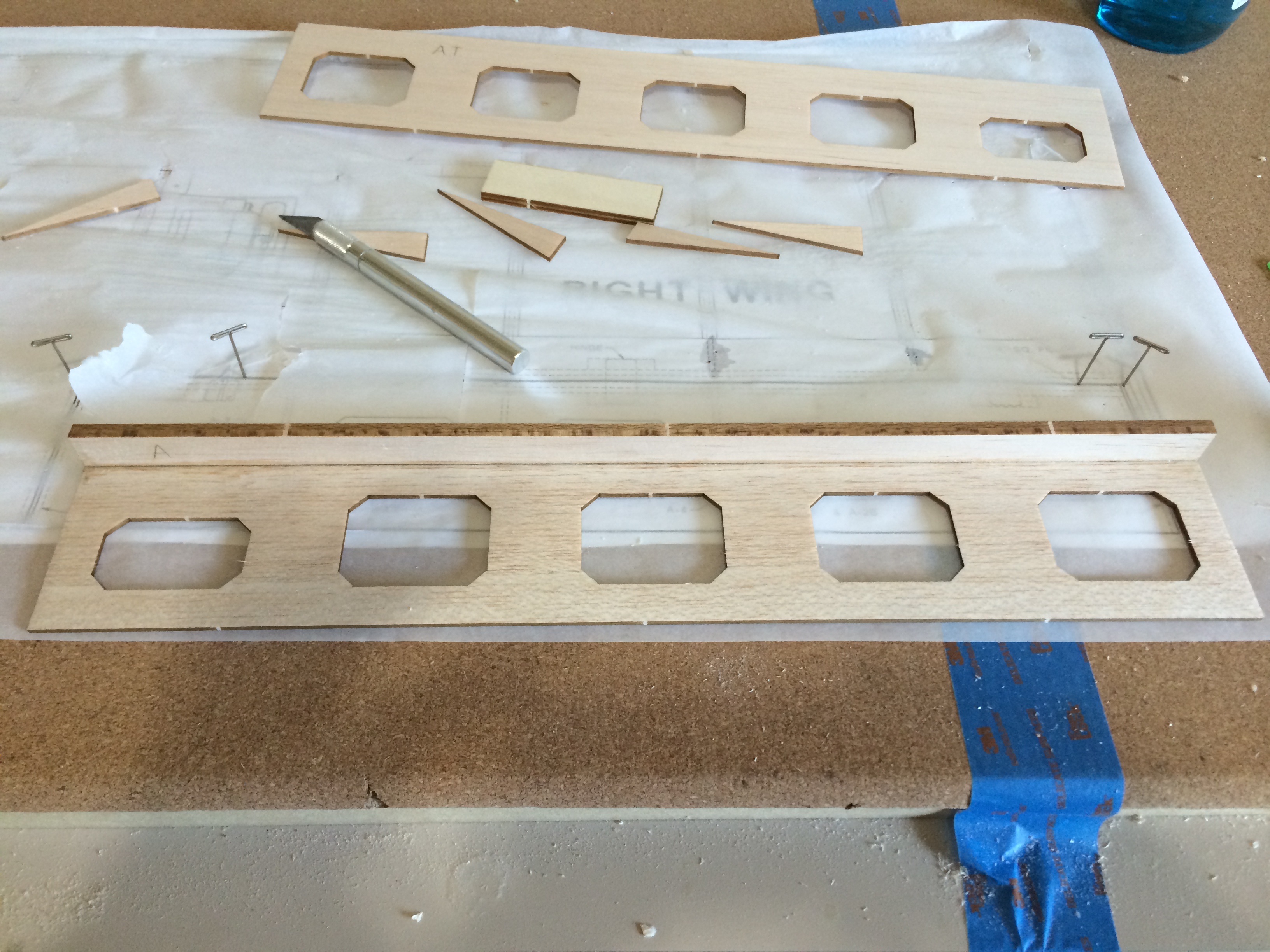

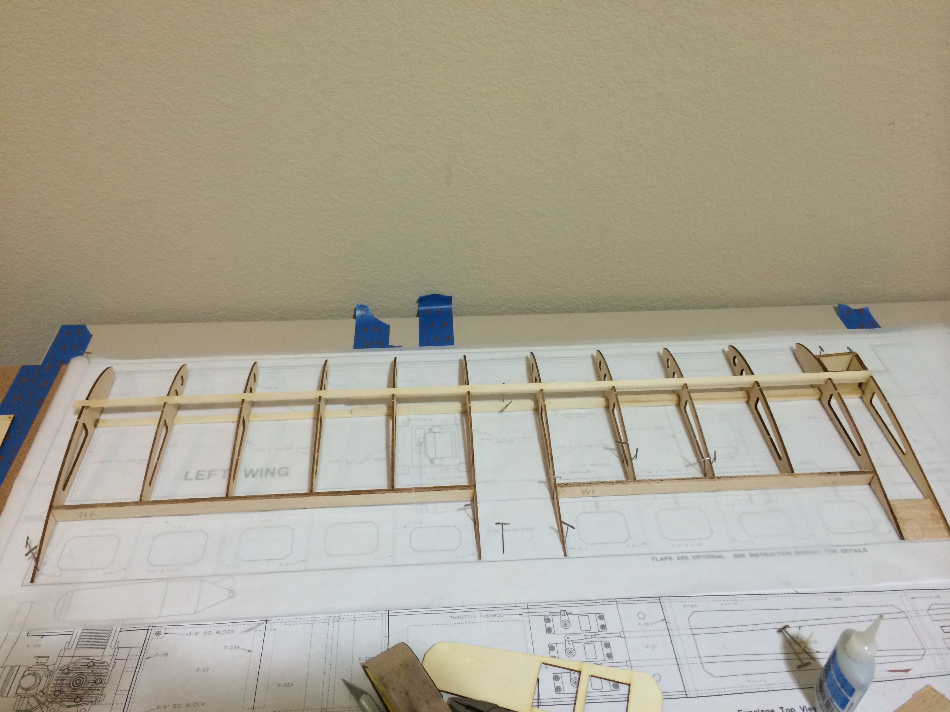

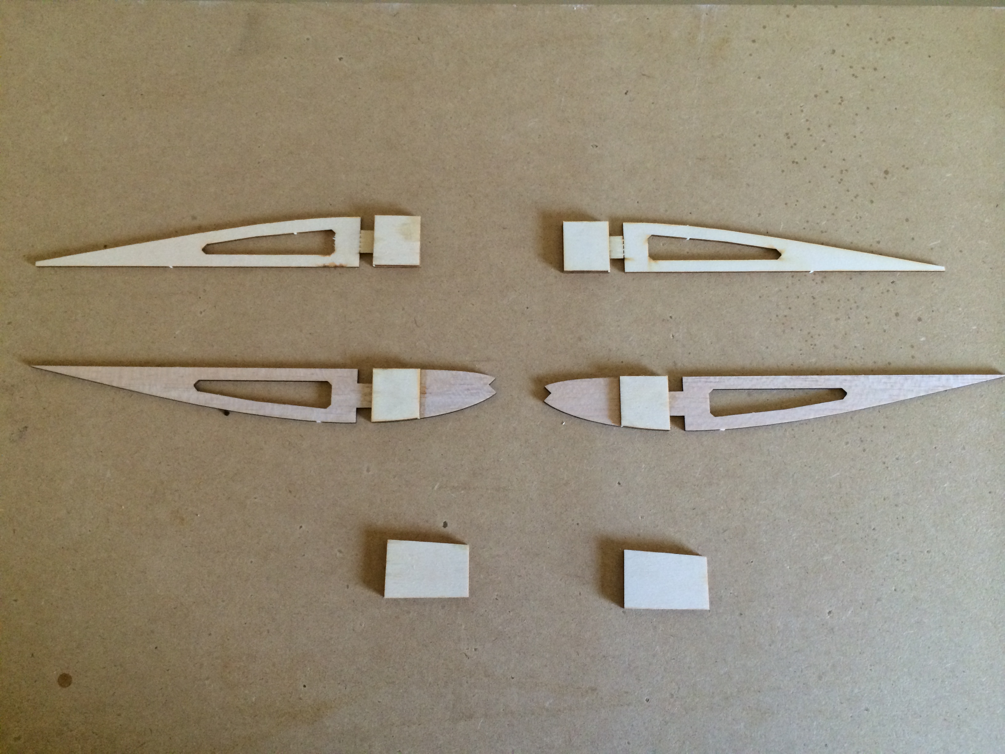

This weekend produced great results. Both wings are now complete and they are joined together. Both flaps and both ailerons are done. I am in the process right now of getting the final assemblies done. I have not been doing as good a job at taking pictures as I would have liked to have been, but below is what I have. In other good news, the servos made it in today, so I now have everything I need to finish. My goal is to maiden Saturday morning and I am definitely on track to make it.
I am impressed with the ease of this build. It is certainly a great (re)introduction into kit building. I can't wait to see how well this thing flies.

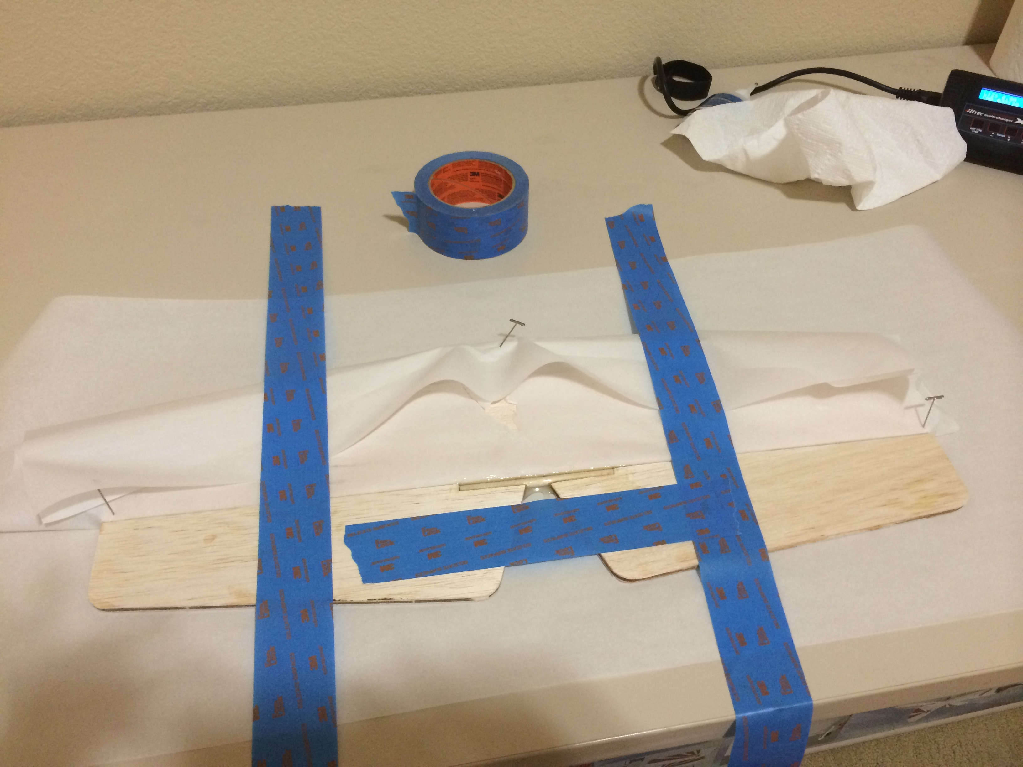

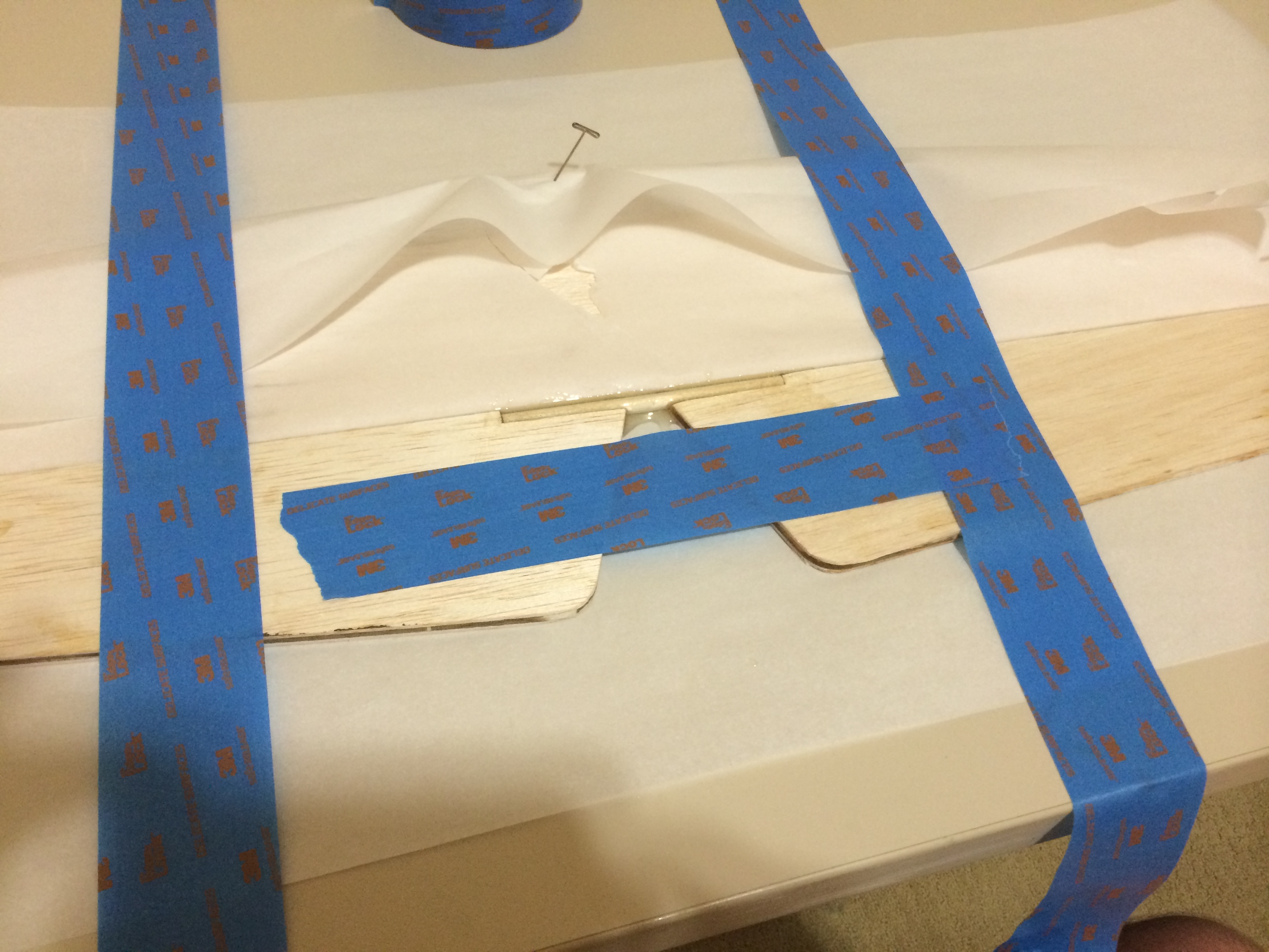

The process of covering the plane is continuing. I have the flaps, ailerons, horizontal and vertical stabs, rudder, and half of the wing done. My goal is to finish the wing tonight and then I should have some pictures to show.
I am going to delay the maiden though to Monday. My wife reminded me that she won't be in town this weekend and my maiden flight track record when she is not in attendance is abysmal at best. ;-) I guess my planes like her in the audience. Or maybe subconsciously I do.

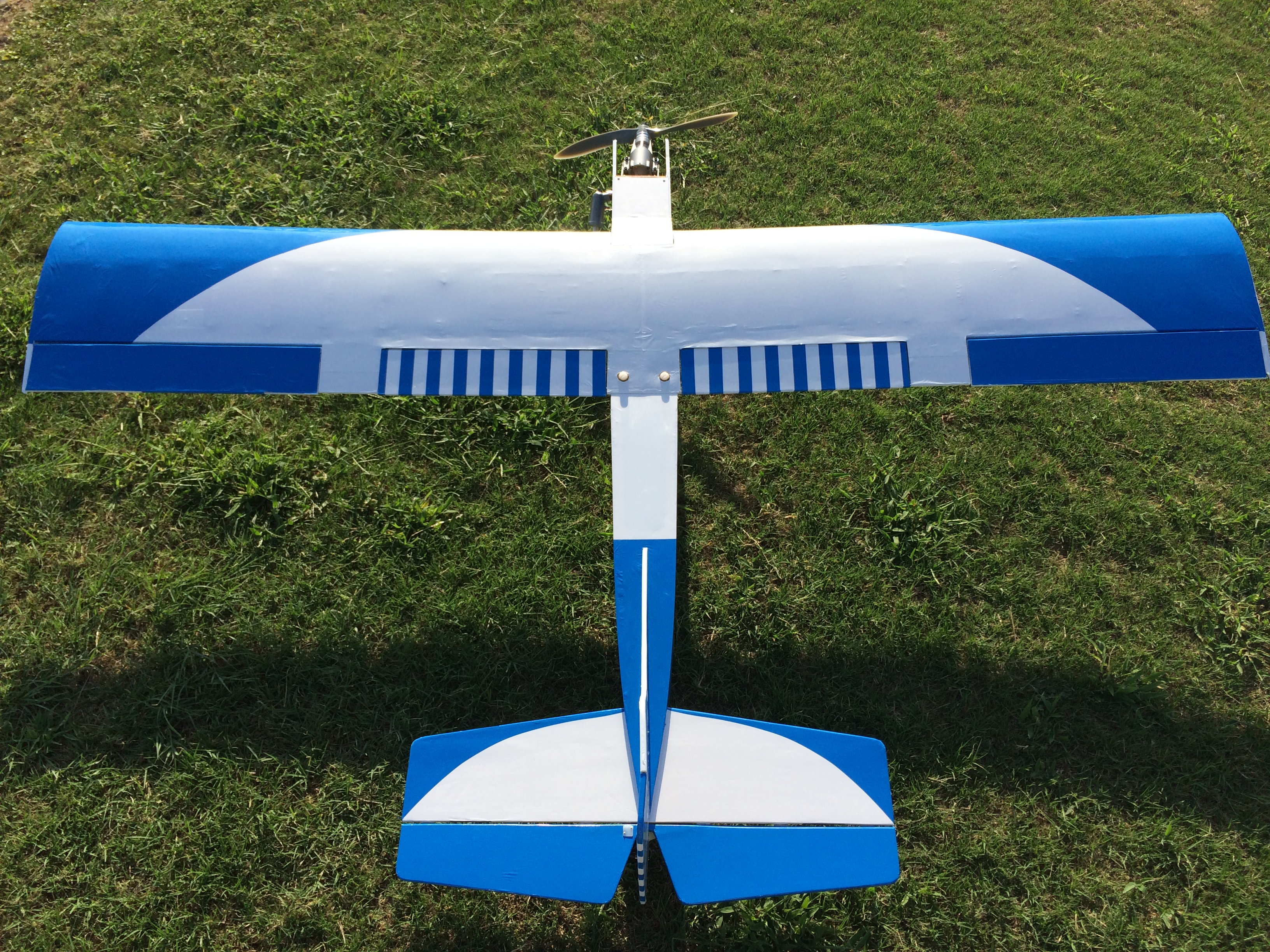

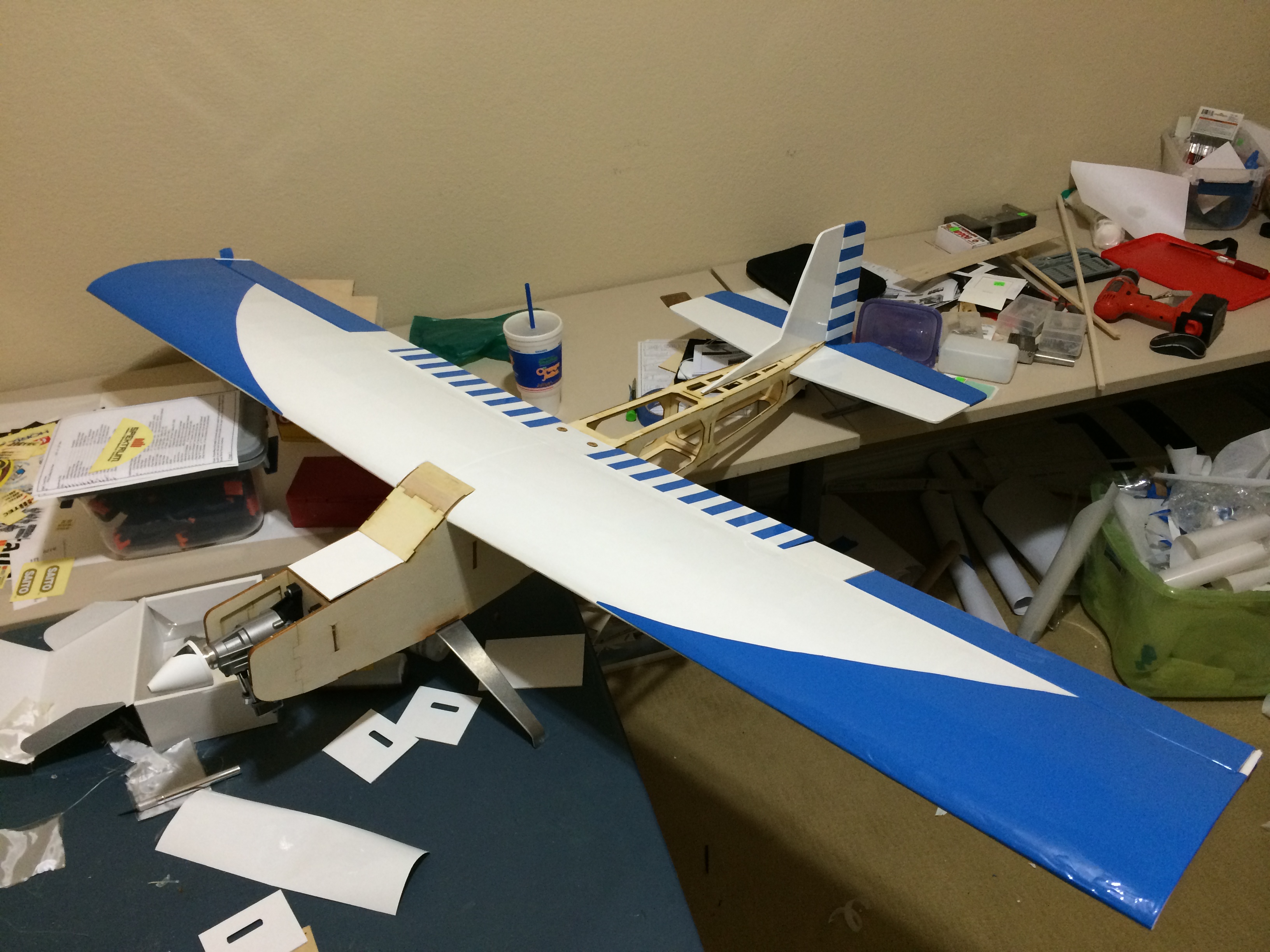

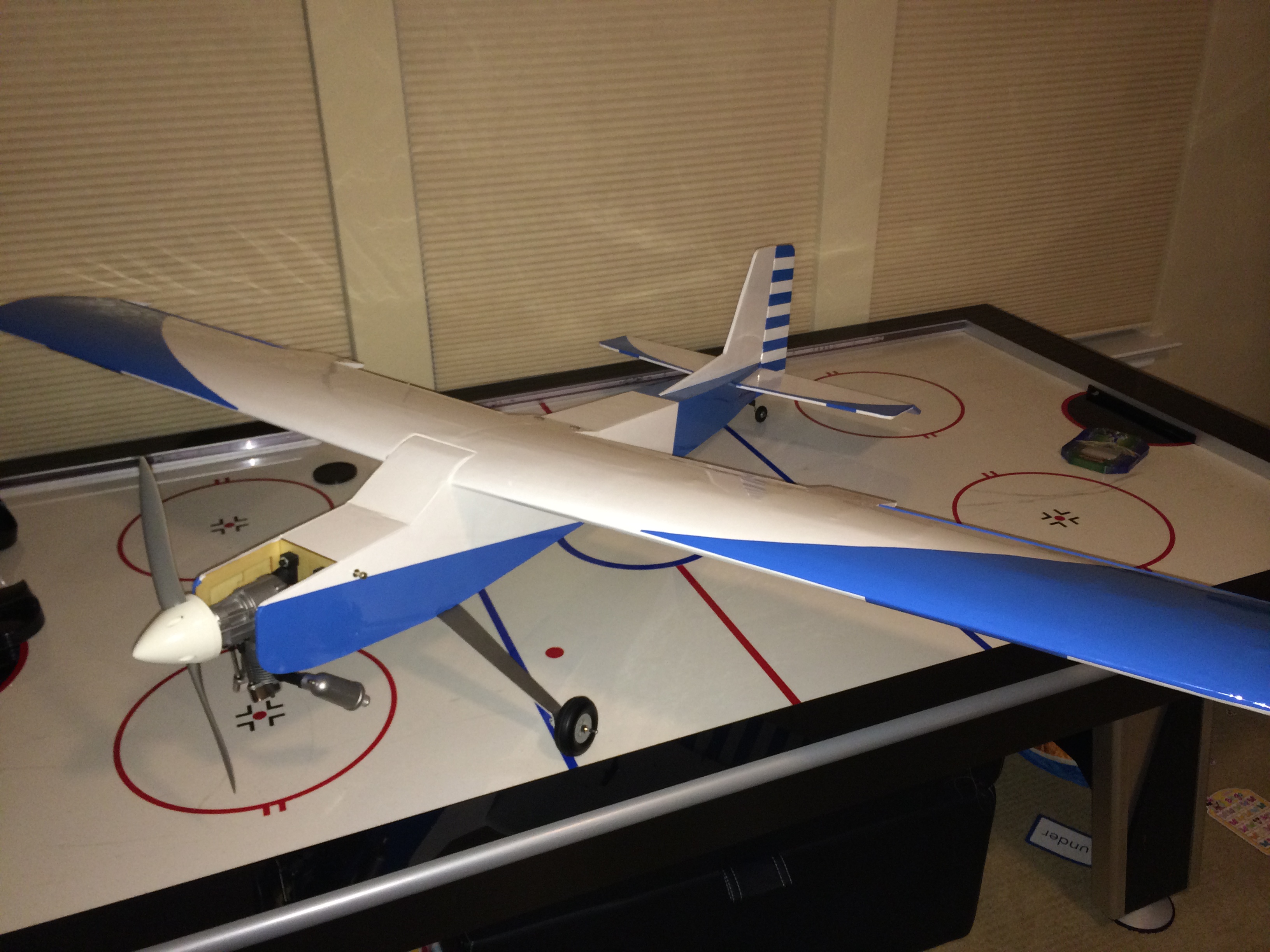

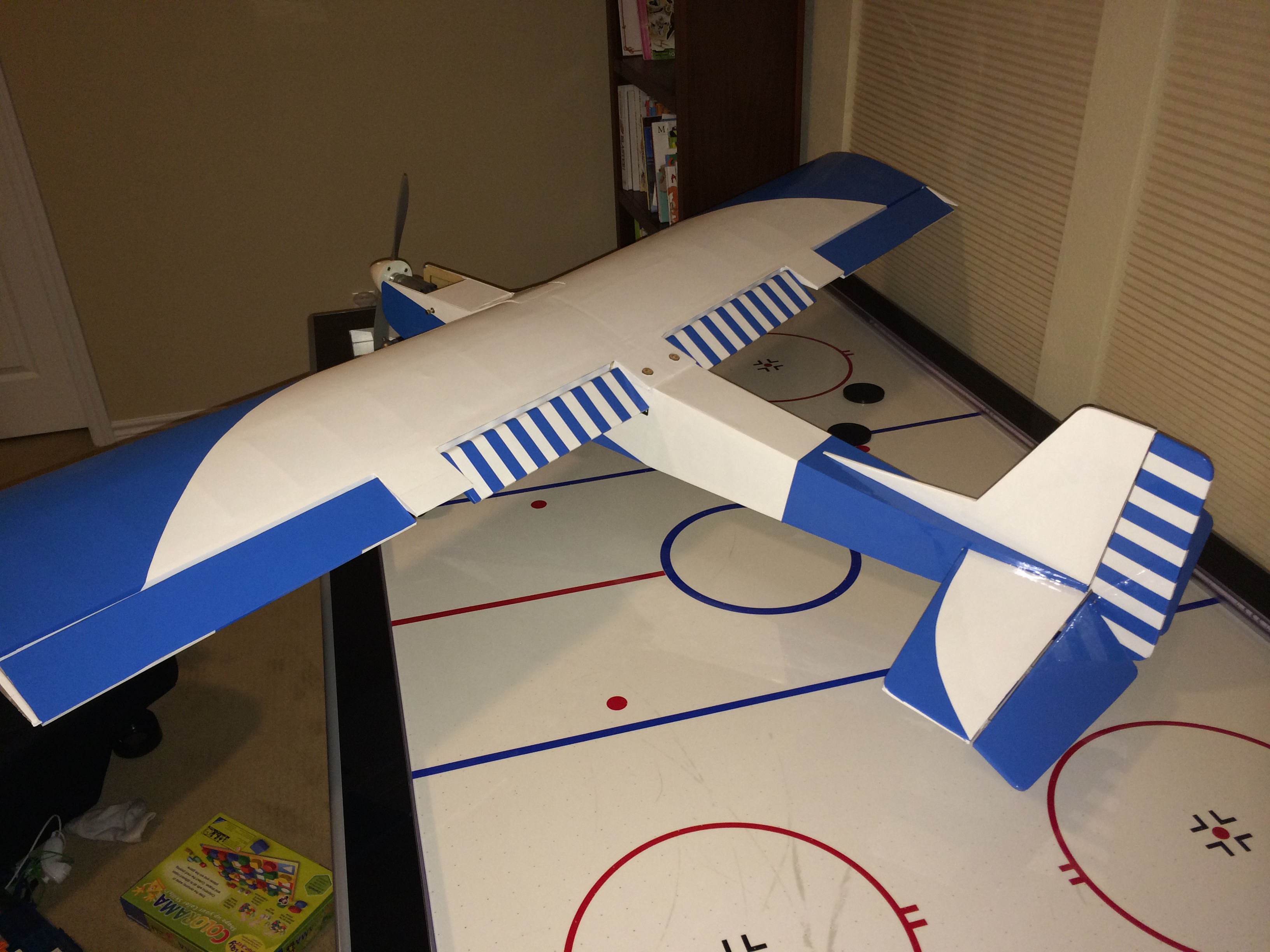

So here is the first look at the covering design. It certainly isn't finished and seeing as to how this is the first design I have done and the first full covering job I have done in FOREVER, I think it is coming together nicely. Still more accents to do and obviously the fuse still needs to be done, but I am pretty happy with the results so far.

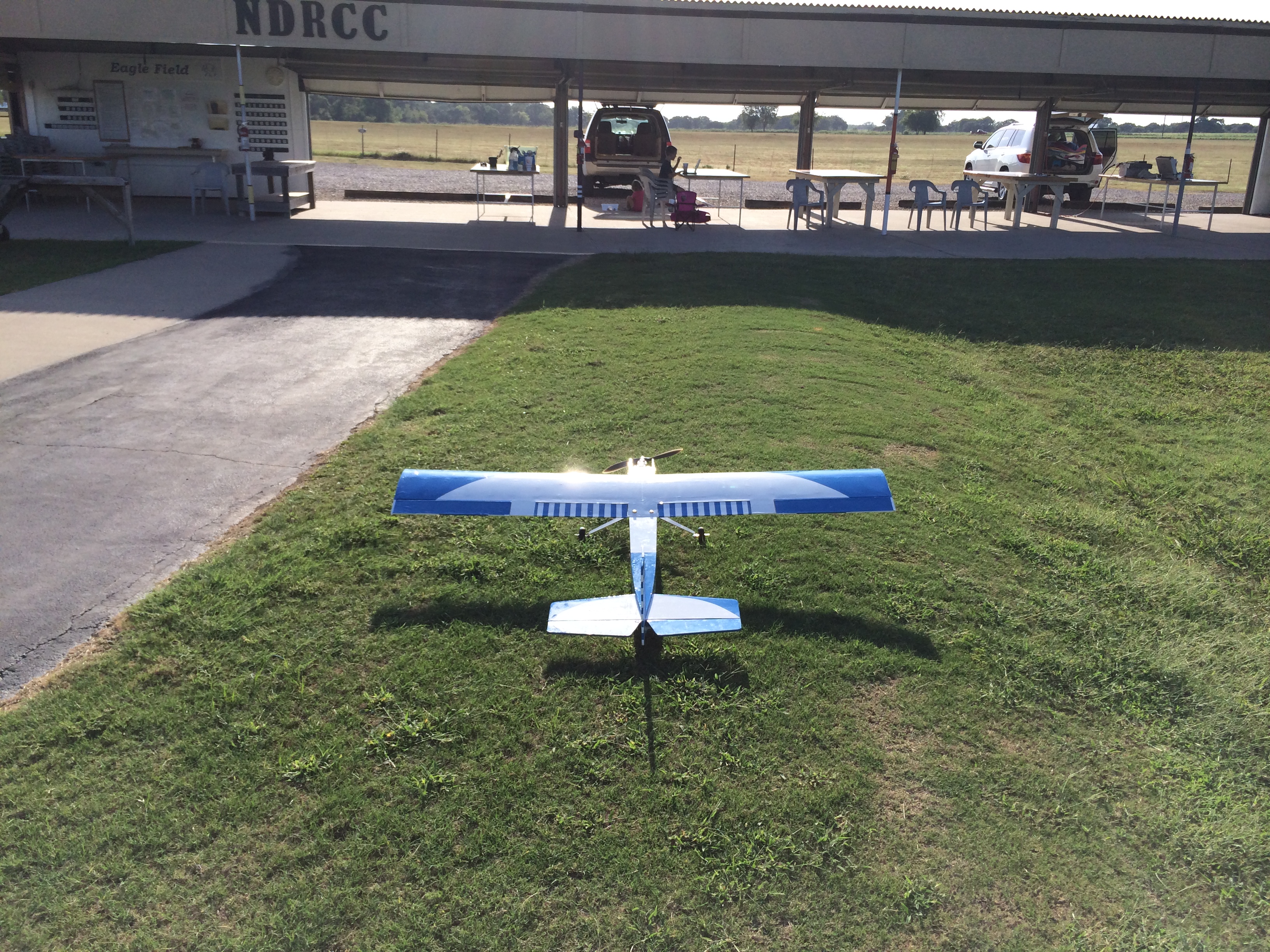

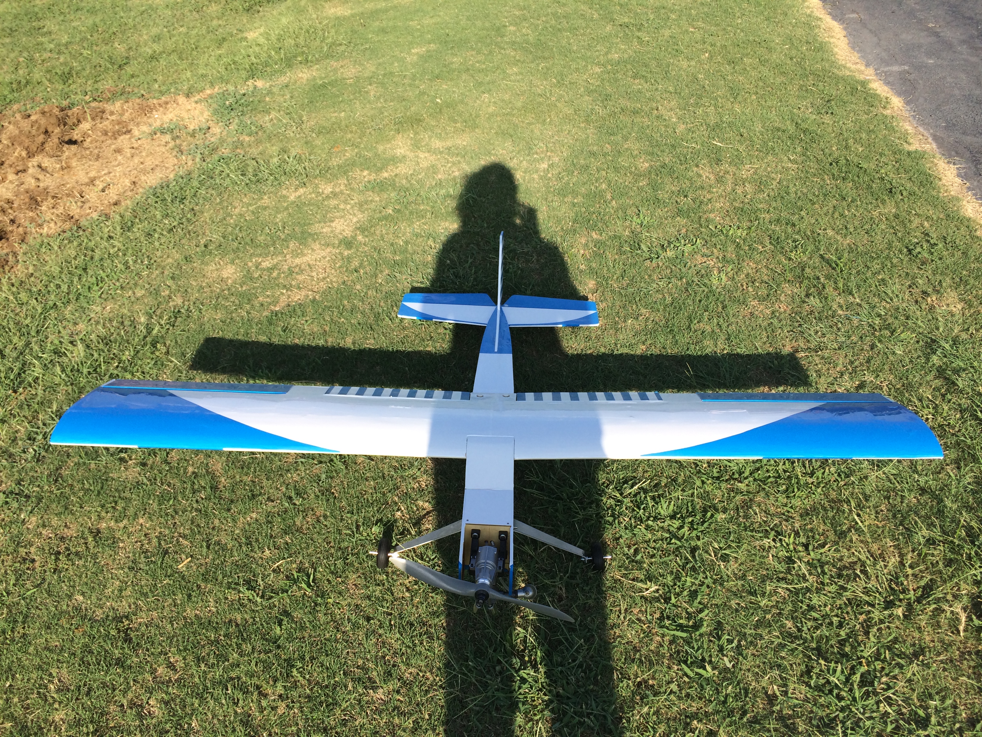

IT'S FINISHED!!!!!!! I will have picture later but I am just too excited to not post that. It has been crazy, ridiculous hours To get this thing done over the last few days but it's done. I still need to get some time on the engine, but I am still going to try and maiden this evening, wind permitting. It is currently at 20mph and while I will fly in that, doing a maiden in that isn't something I am fond of doing. If it drops to 15 I'm in, otherwise I will push it a day or two.
Mother Nature is in control now.
josh
Old 09-01-2014 | 04:06 PM
Joined: Sep 2012
Posts: 54
From: Frisco, TX

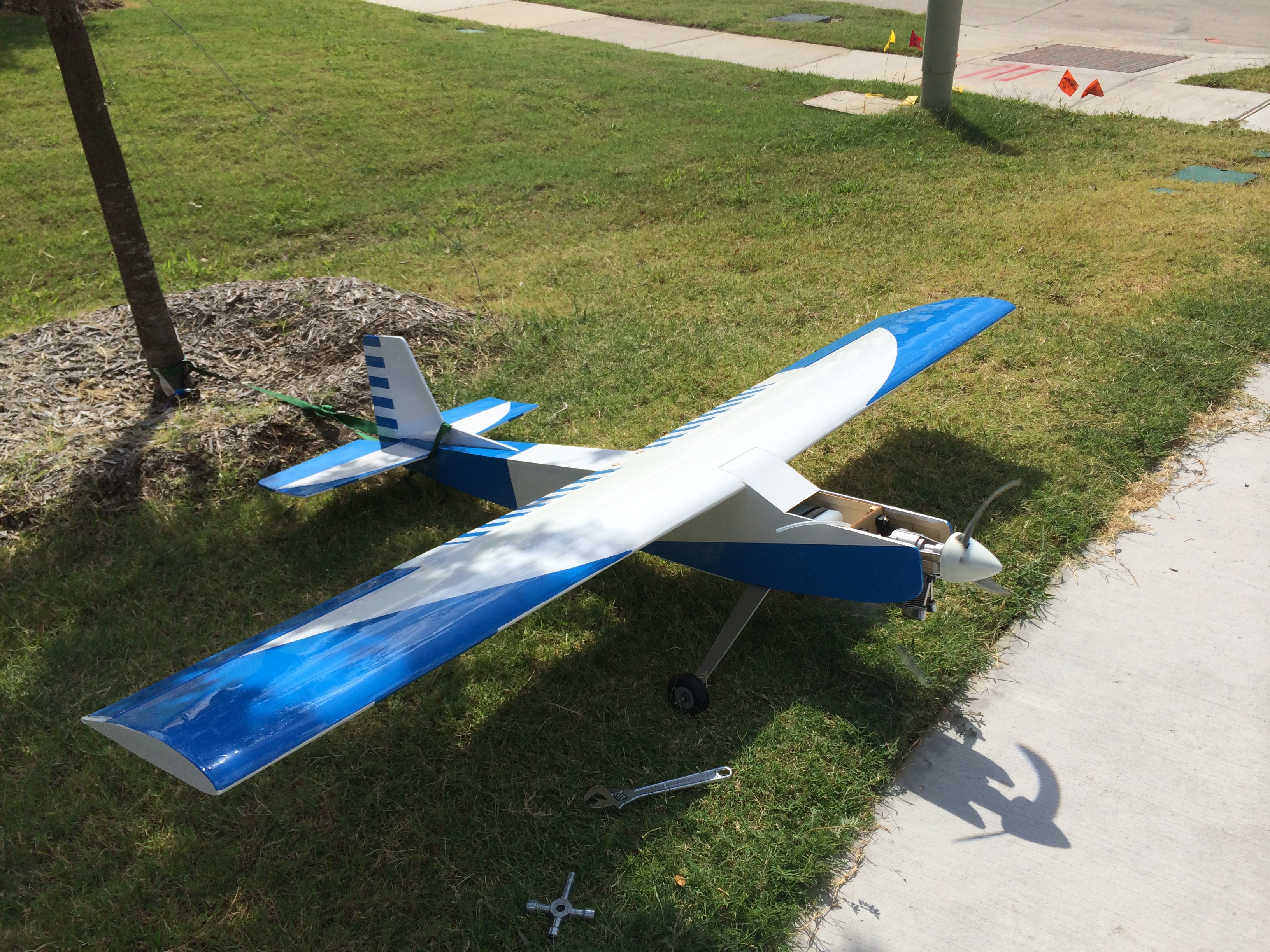

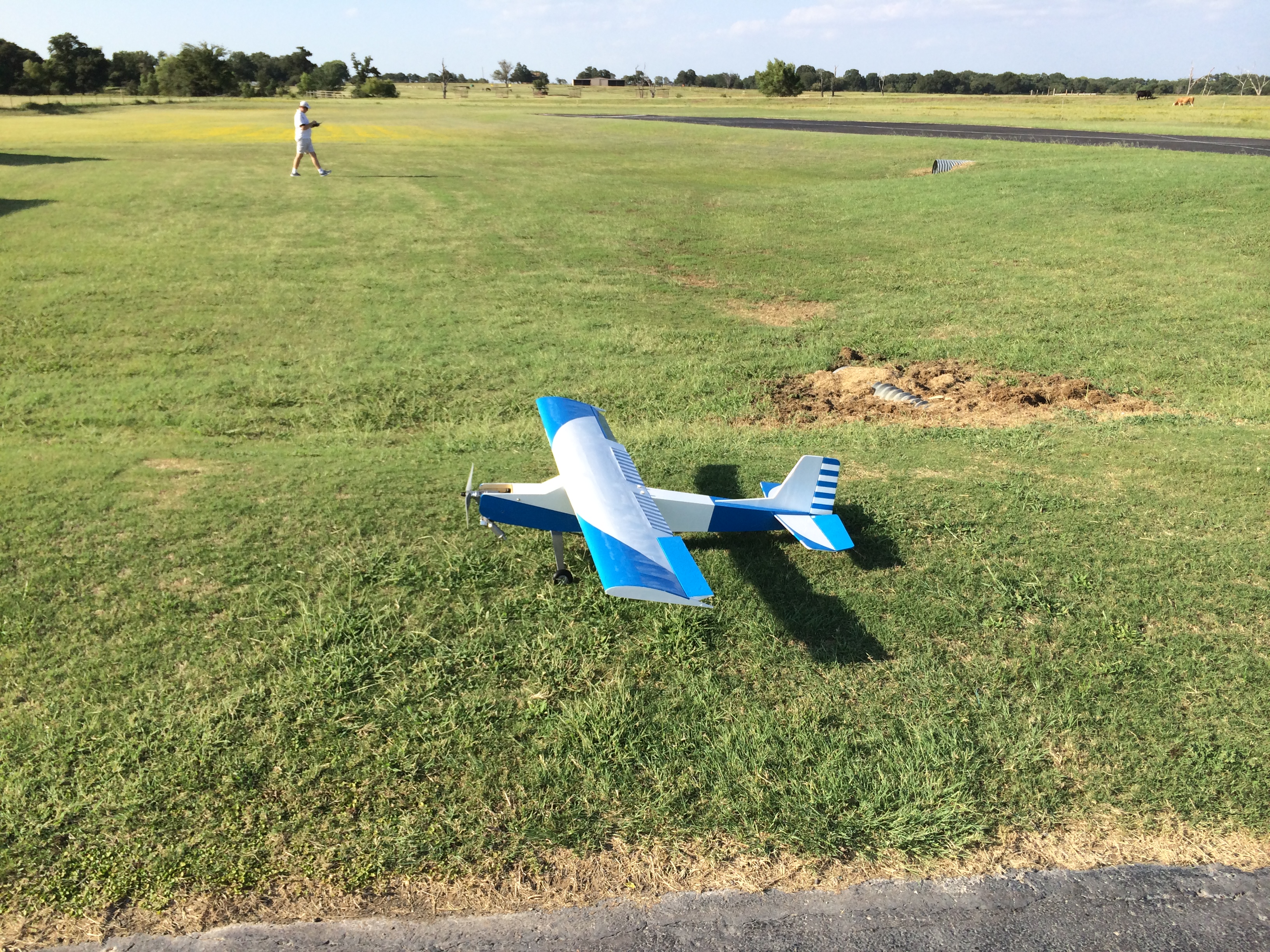

IT FLIES!!!!! And it flies well. I am leaving the field now and I will upload the video tonight after the kiddos are in bed. I will say this, even in a 15mph wind that was gusting to 18 or 20, it's a good flying plane. Can't wait to take it out when the winds are calmer.

I do have some more work to do on the plane still but I am excited that it has now actually flown. My to do list includes finishing out the trim scheme and placing logos and stickers on the covering. I need to build the bomb bay and install it. I need to get the floats together that will go on the plane and then test mount them. I also need to replace the spinner. I have long used Tru-Turn spinners and for some reason, I decided to use an extra plastic one I had laying around. Dumb move on my part as the spinner broke on me at the field. So I will be ordering a Tru-Turn spinner tomorrow. But most importantly, I need to just fly this thing.
As for its flight characteristics, I simply couldn't be happier. The plane balanced perfectly, both longitudinally and laterally without the need for any weight. I was amazed!!!! The engine has plenty of power for the plane but it doesn't feel over powered to me. Take off was quick (15-20 mph wind helps but I was still surprised) and the climb out was true. It took a bit of down elevator trim, but that was the only trim adjustment I needed to get straight level flight. The flaps really slowed things down too. In fact, at full flaps, I was able to get the plane to fly backwards in the wind. I am running a lot of flaps in the full down position, so I under estimated the amount of elevator I needed to mix in but that was easily corrected after landing.
As you see in the video, landing was a bit tricky with the winds up as the huge wing just loved to float. On a calmer day and with some expo dialed in (I didn't have any in for the maiden to get a feel for the controls), I fully expect that it will make for a much smoother landing.
All in all, I have to say this plane is a winner. If you are looking for a 60 size plane that is fun and easy to fly, is durable and is tailored to exactly how you want it, this is it. I will keep posting on here as I make changes to the plane and keep breaking it in. Our club also has a float fly in a few weeks, so I will be able to tell you how it performs off water soon too. I am looking forward to it. Thanks again, and thanks to my wife for the good karma and for shooting the video. Also, here are some pics of the finished plane, during the engine break in and just prior to the maiden.

That was fun, being color blind those aren't my color choices and I had to really look hard to see it even on your approaches but once it was over the runway I saw it very well.
Great flying plane and a well designed kit. I would keep it as a top choice if I ever build another trainer.
I was really impressed with how fun it is with the flaps down. I think you really have a winner!! Nice Job!!
