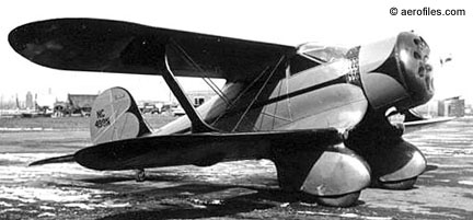

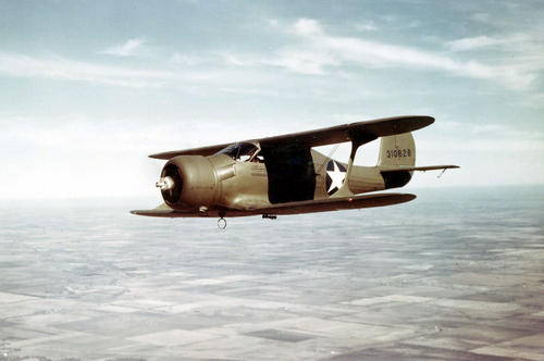

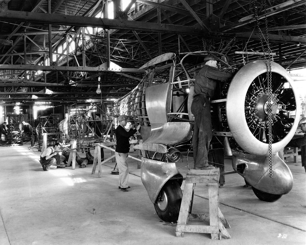

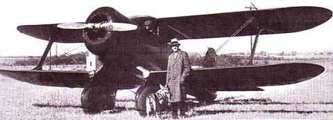

You guys might consider a non-retractable version of the Staggerwing. They did exist, a number were built.

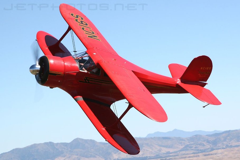

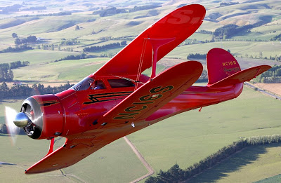

I was actually thinking about that, but a Beech Model 17 in flight with its gear up is one of the sweetest looking planes ever!
