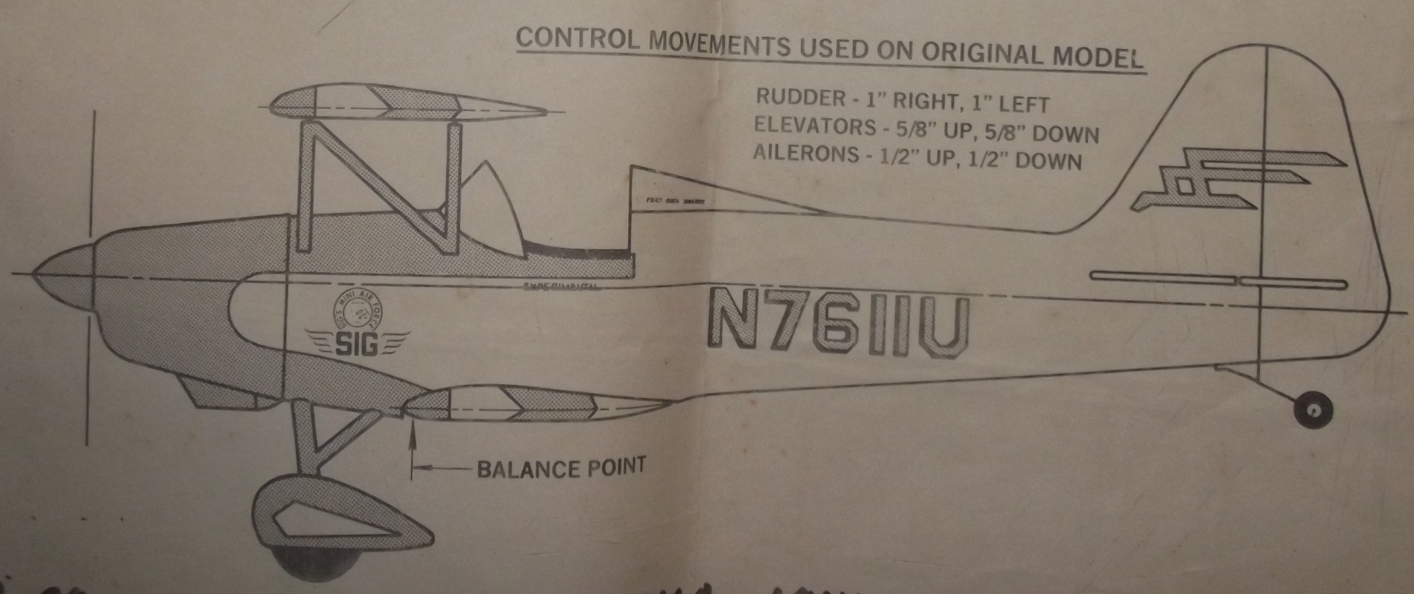

Finally going to try and fly my Miniplane this summer. I've lost my blue prints and cannot find the spec's for control throw's. Anybody have these available? Any help would be greatly appreciated.

Well better late than never. I went and dug up my book and plans.
Turns out Sig put that info on the plans.
RUDDER 1" EACH WAY
ELEVATORS 5/8" EACH WAY
AILERONS 1/2" BOTH WAYS
