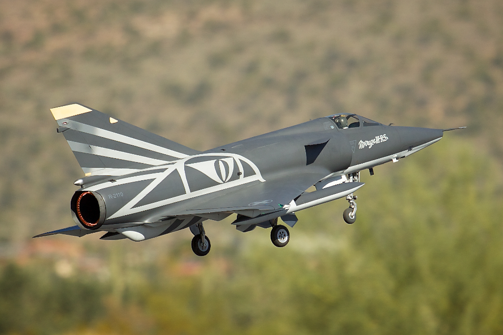

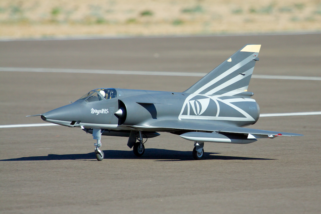

Sounds like a shame the JHH Mirage was a bad kit. Ive seen this one fly at several events over the years here in Arizona. Pretty sure the plane is owned and flown by the son of owner of JHH. Flys nice. This one is electric power.
Couple photos I took from the events.

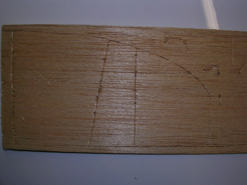

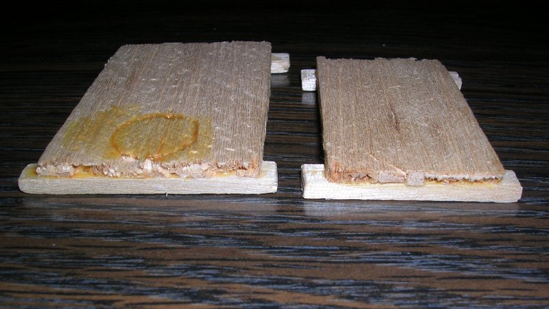

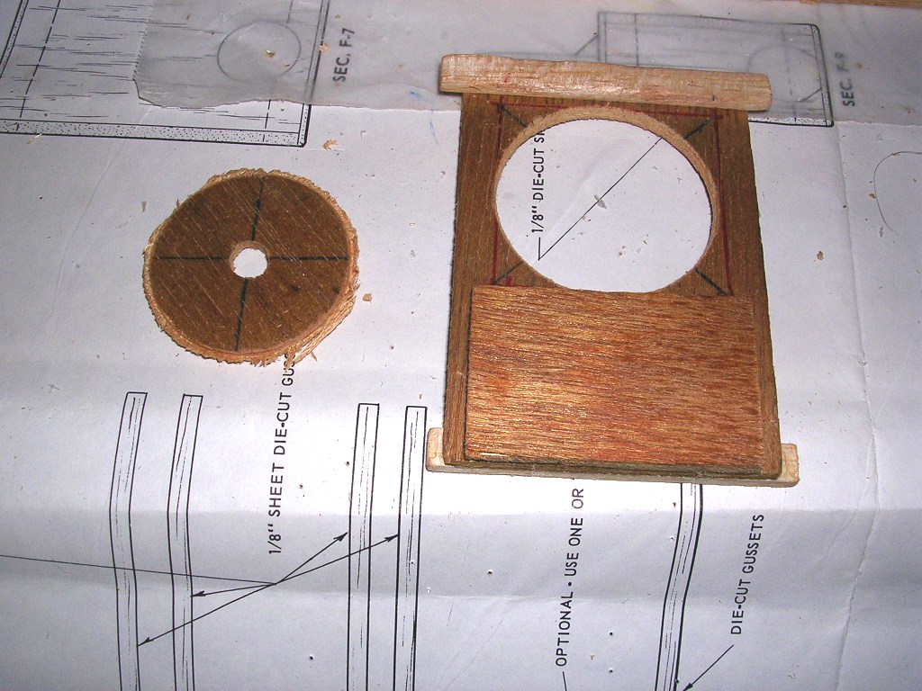

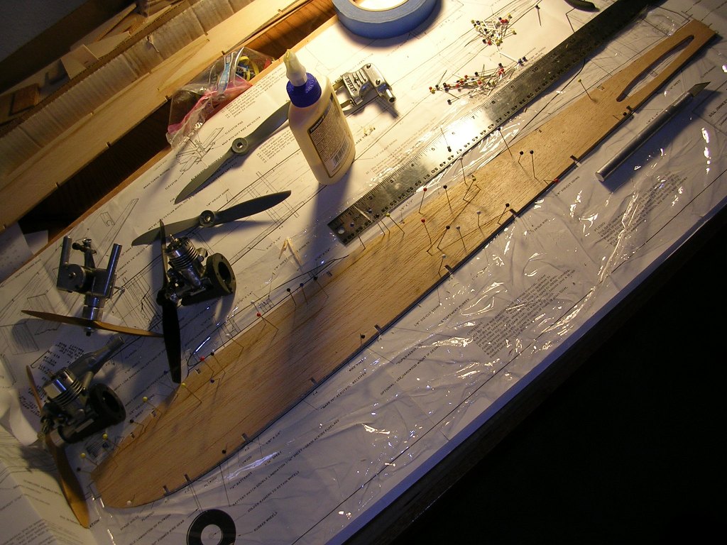

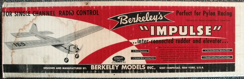

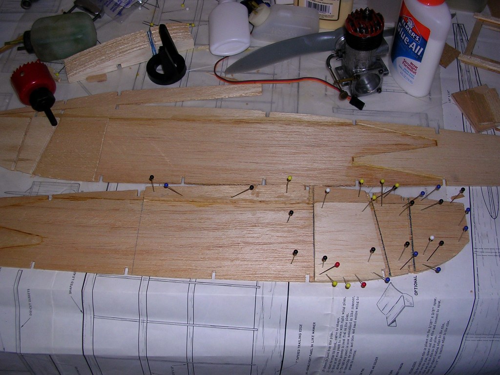

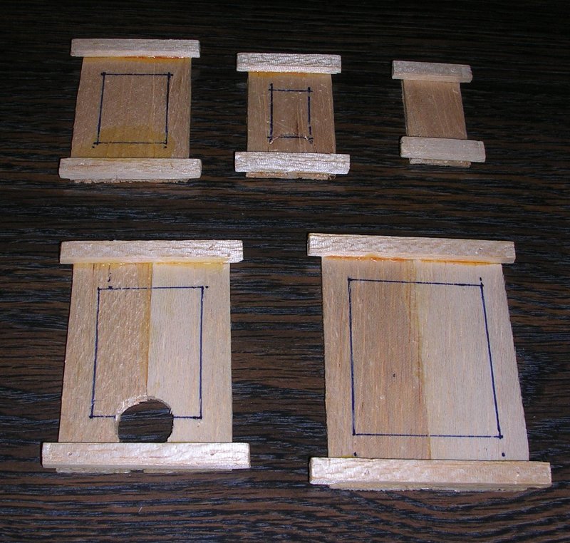

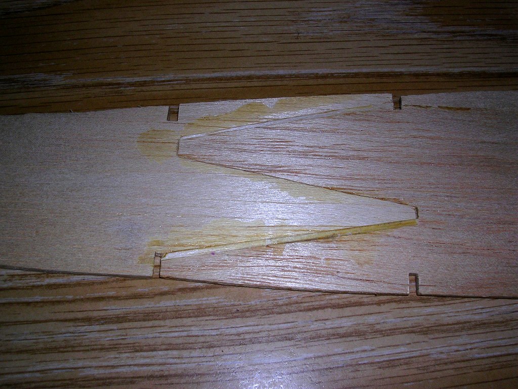

Love the Berkeley clean and accurate die cutting. Here is some of the die crushed balsa from my recent 1959 Berkeley Impulse kit build.
Fuselage formers were just a plain rectangle, so I did a little interior trimming to lose weight.
I had to trim as much as 3/8 inch from fuselage side pieces just to get them to fit. In this case I trimmed too much so I had to shim back to make it fit. Fuselage was cut accuracy was poor. Accuracy of nose former widths was slightly off, so when I was done found that I had insufficient space to mount either Enya .09-III TV (preferred) or A.C. Gilbert .11 Thunderhead sideport (2nd preferred. Gilbert is a side port engine like the Fox .09 Rocket shown in the plans.) Nose cowl cheek sides at the front were pinched too close. Finally, a friend sent me a 1966 OS Max .10R/C with muffler, which with the legacy aluminum T-mounts will fit.
Our modern laser cut balsa sheets has certainly spoiled us.
