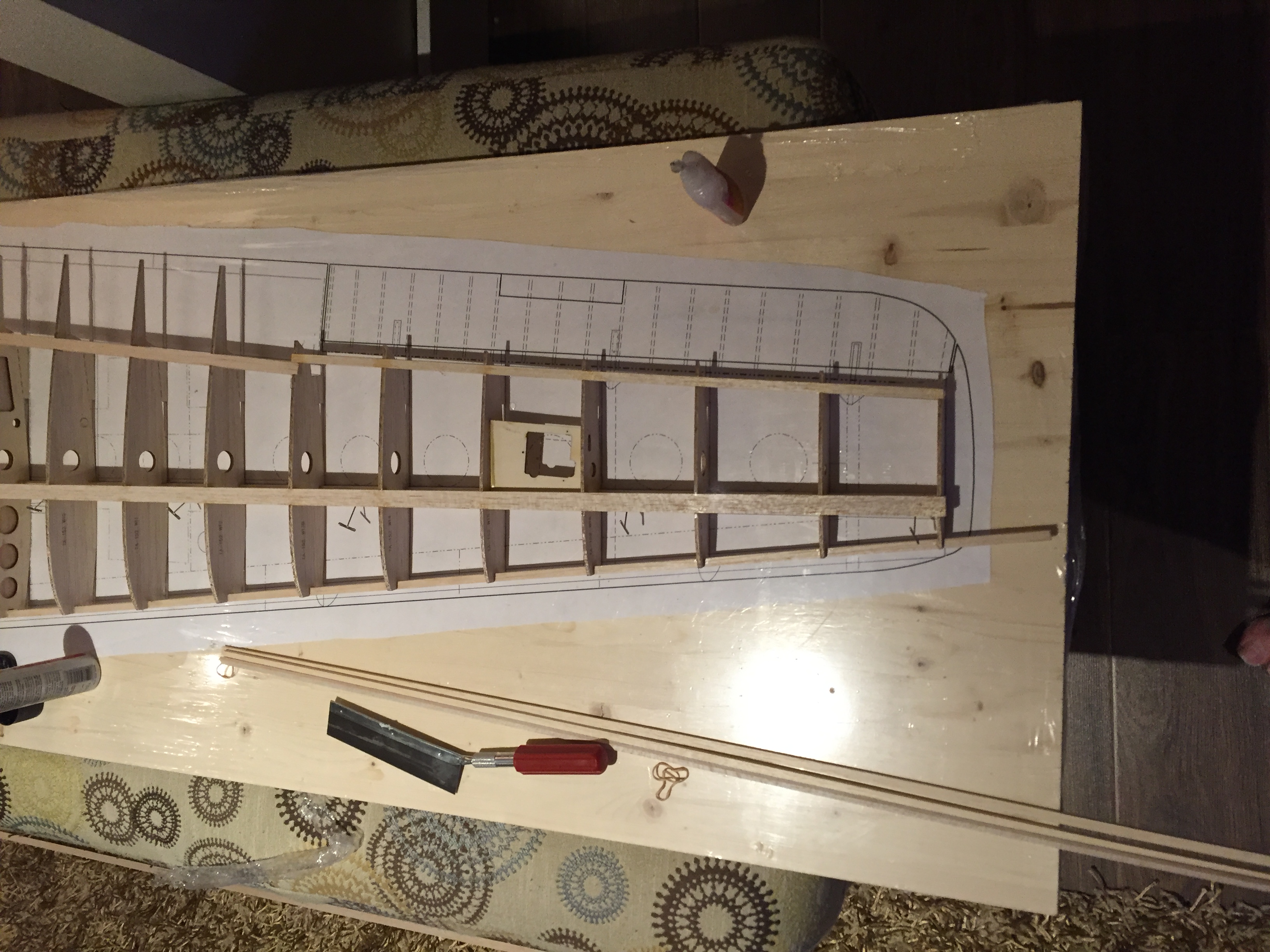

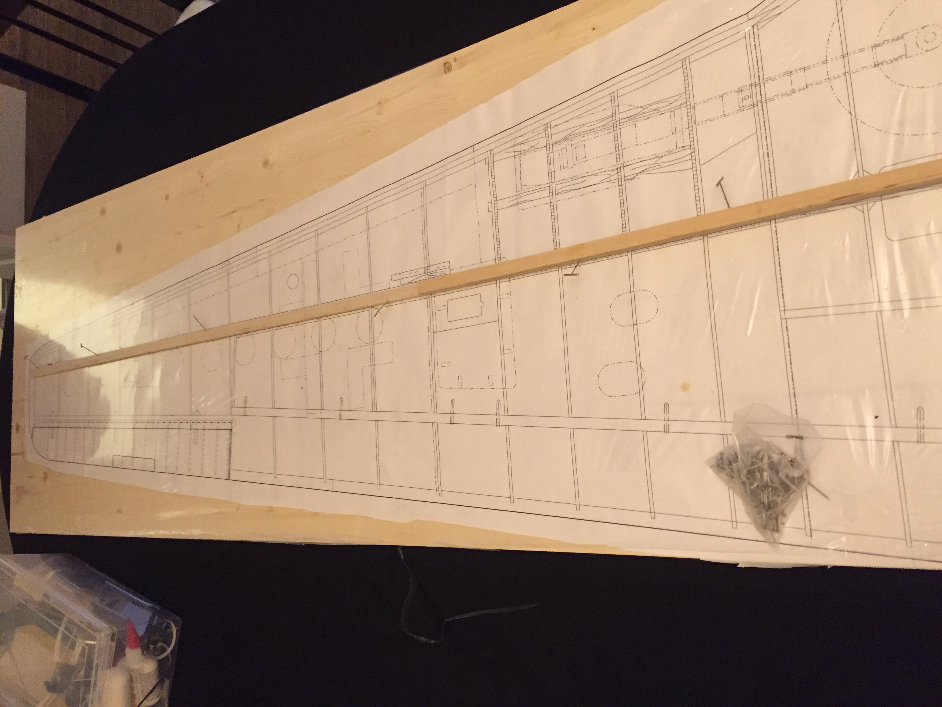

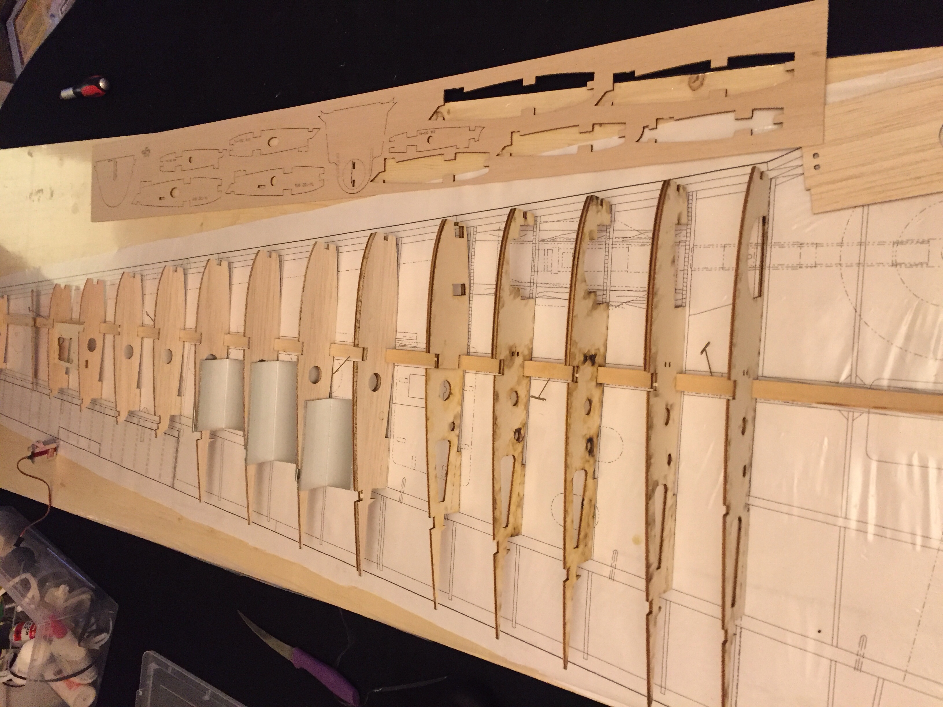

Hi guys this is my first kit to build I would appreciate any comments and ideas thanks

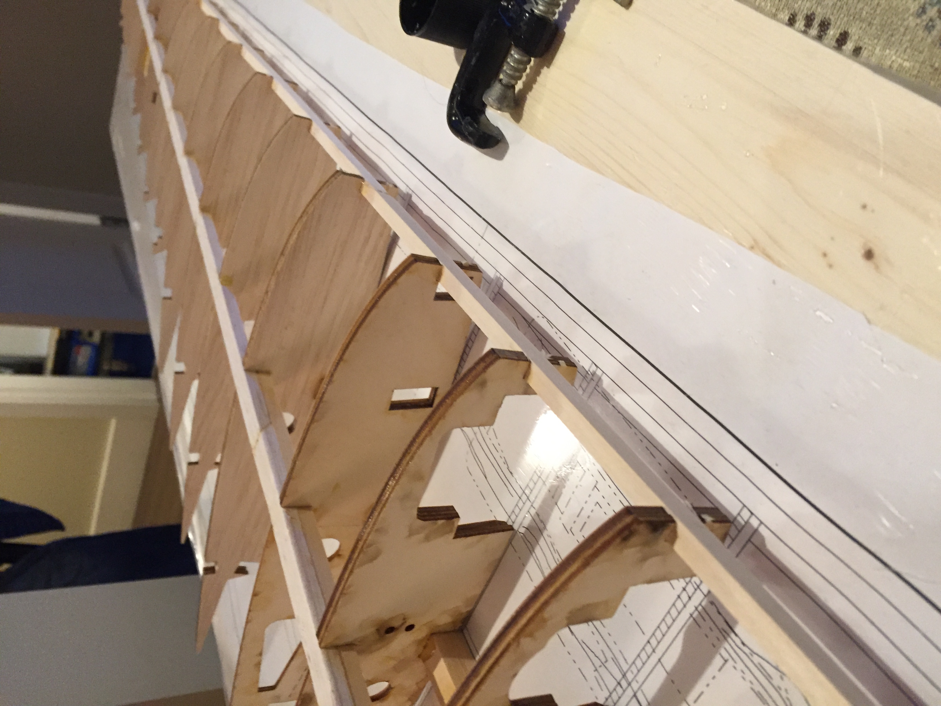

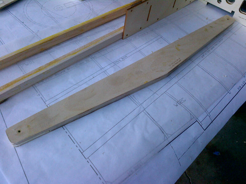

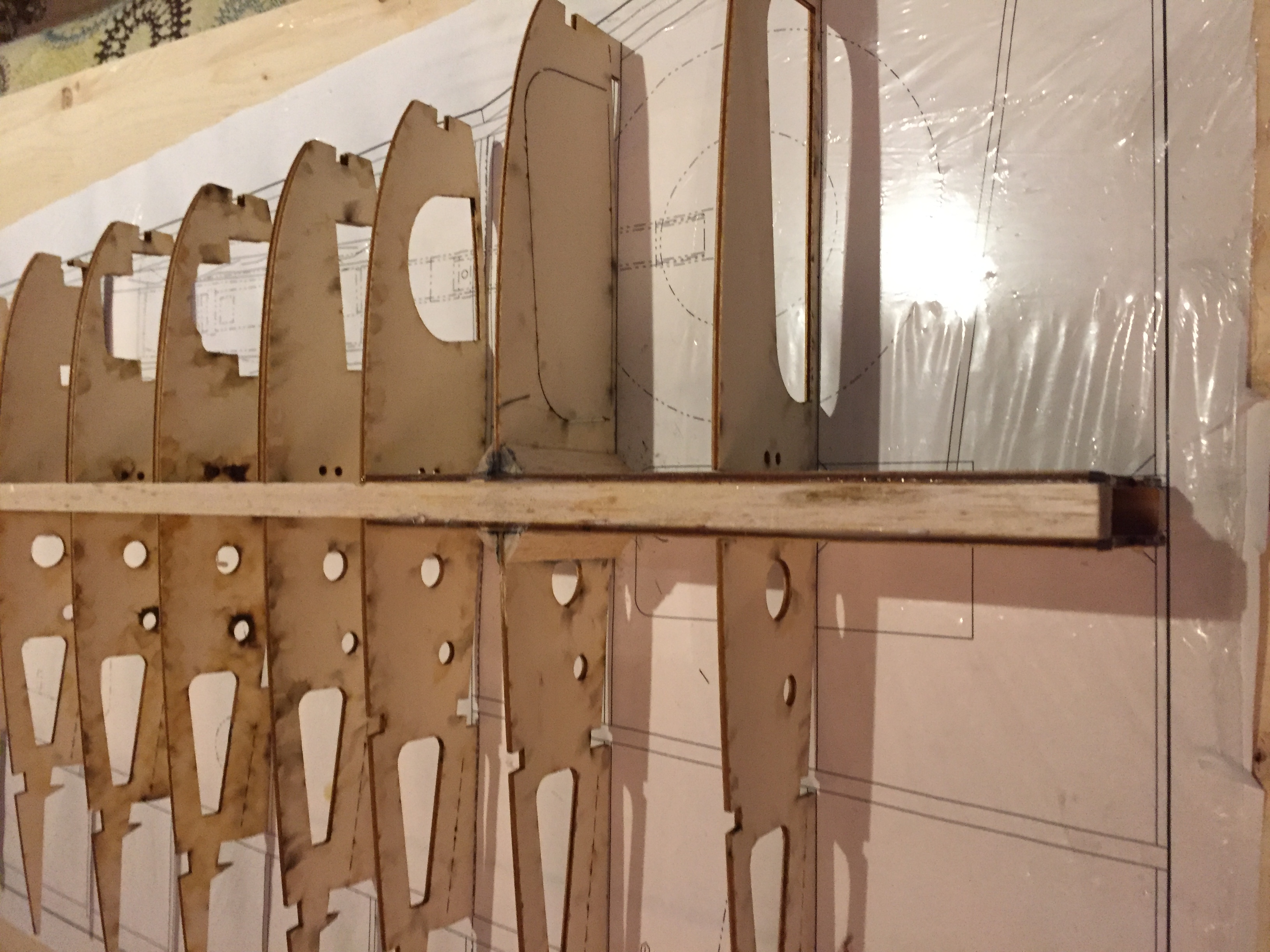

Now time for top main spar
ID:	2127956   Click image for larger version

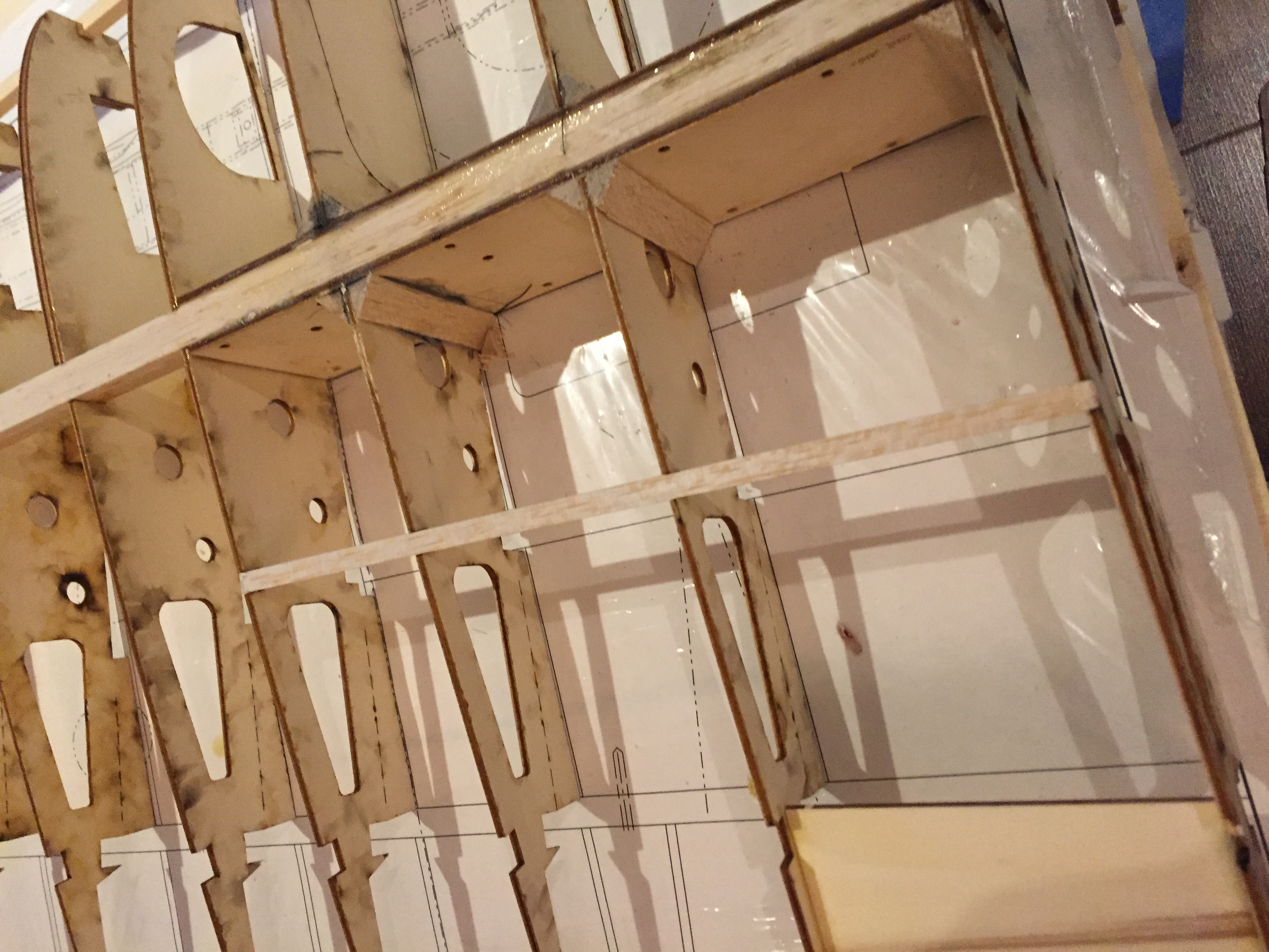

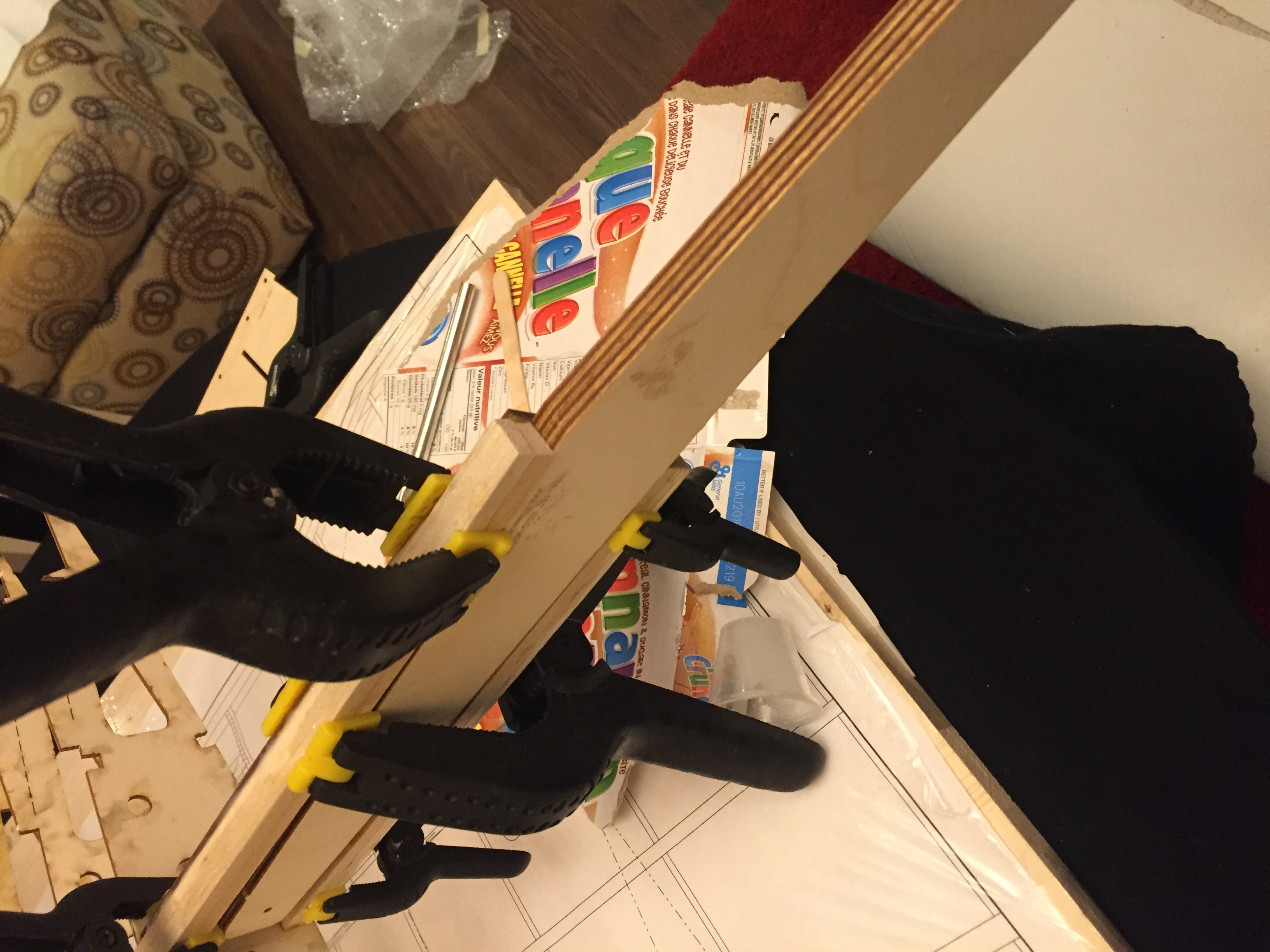

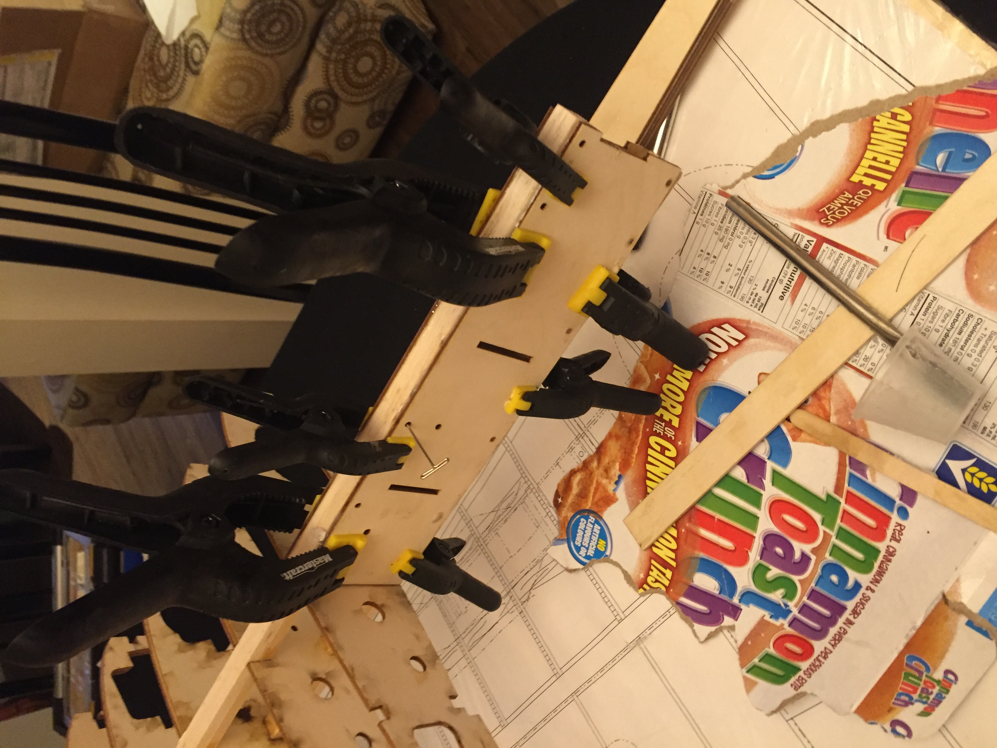

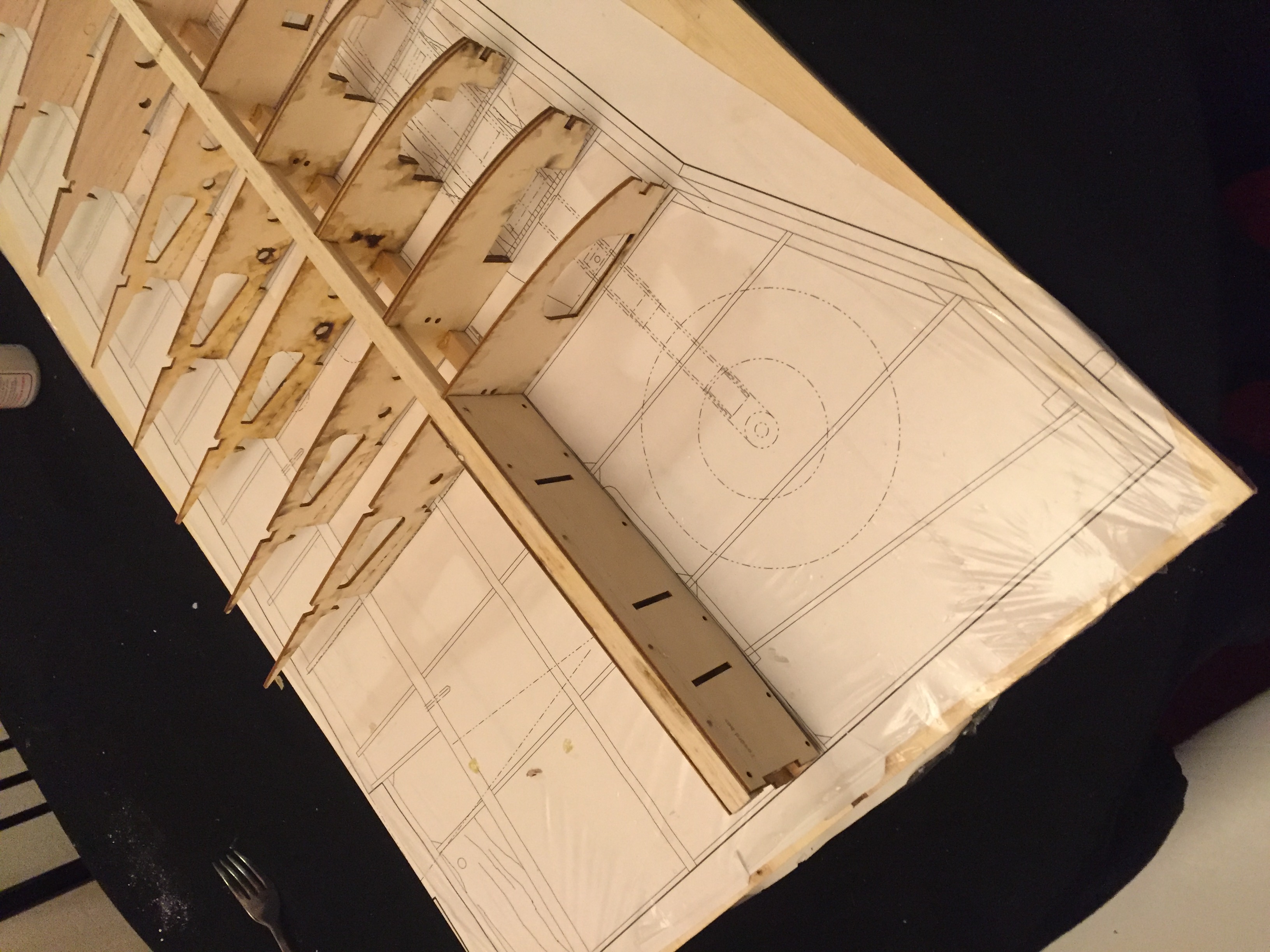

Now I just finished the wing joiner box it is ready for first 3 ribs
ID:	2127970   Click image for larger version
ID:	2127971   Click image for larger version
ID:	2127972   Click image for larger version
ID:	2127973   Click image for larger version
ID:	2127974   Click image for larger version

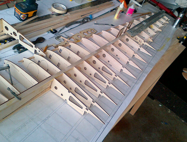

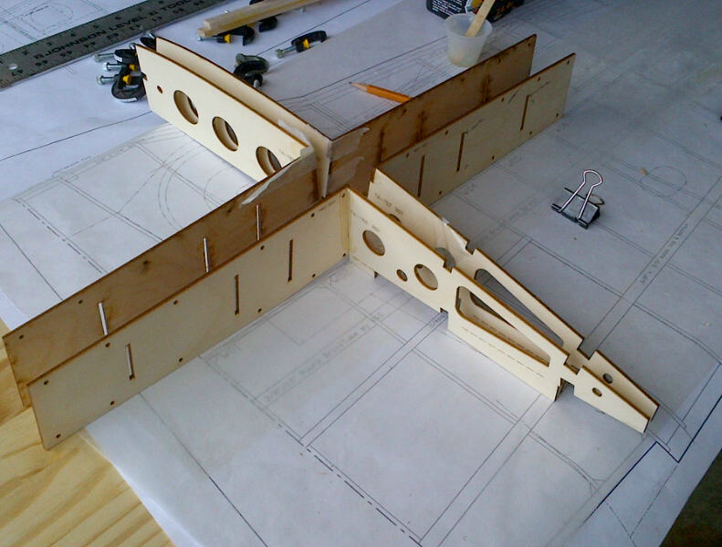

Serkan,
good progress on the wing.
A couple of things: I would post instead on the Warbird forum thread, since they may be more people with questions and answers about large scale warbirds. http://www.rcuniverse.com/forum/rc-w...ta-152-h1.html
That is were the original prototype build was posted.
Also, you suppose to put together the wing and wing wing joiner box while flat on the table if I remember correctly.
Thank you for posting,
JG

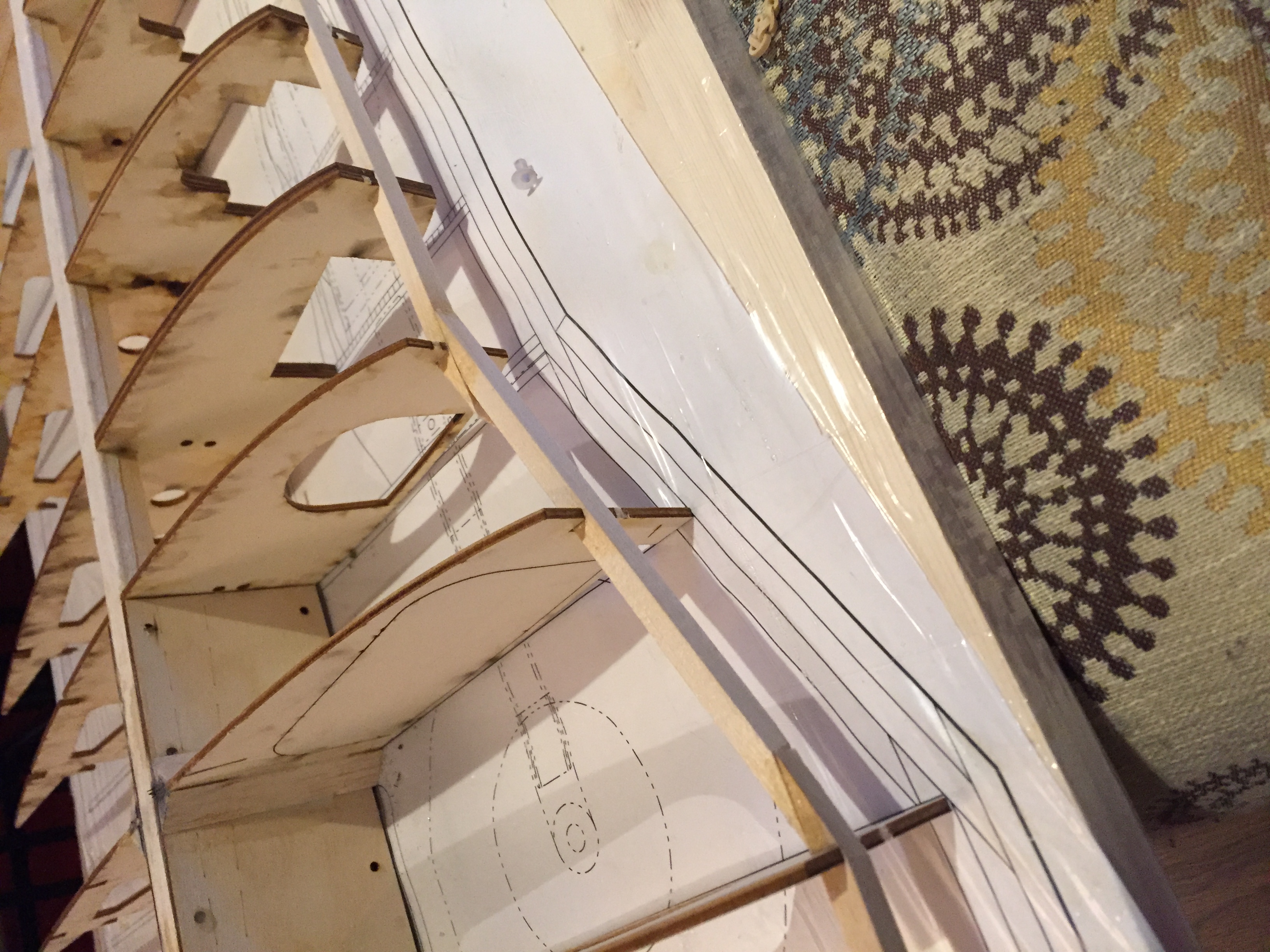

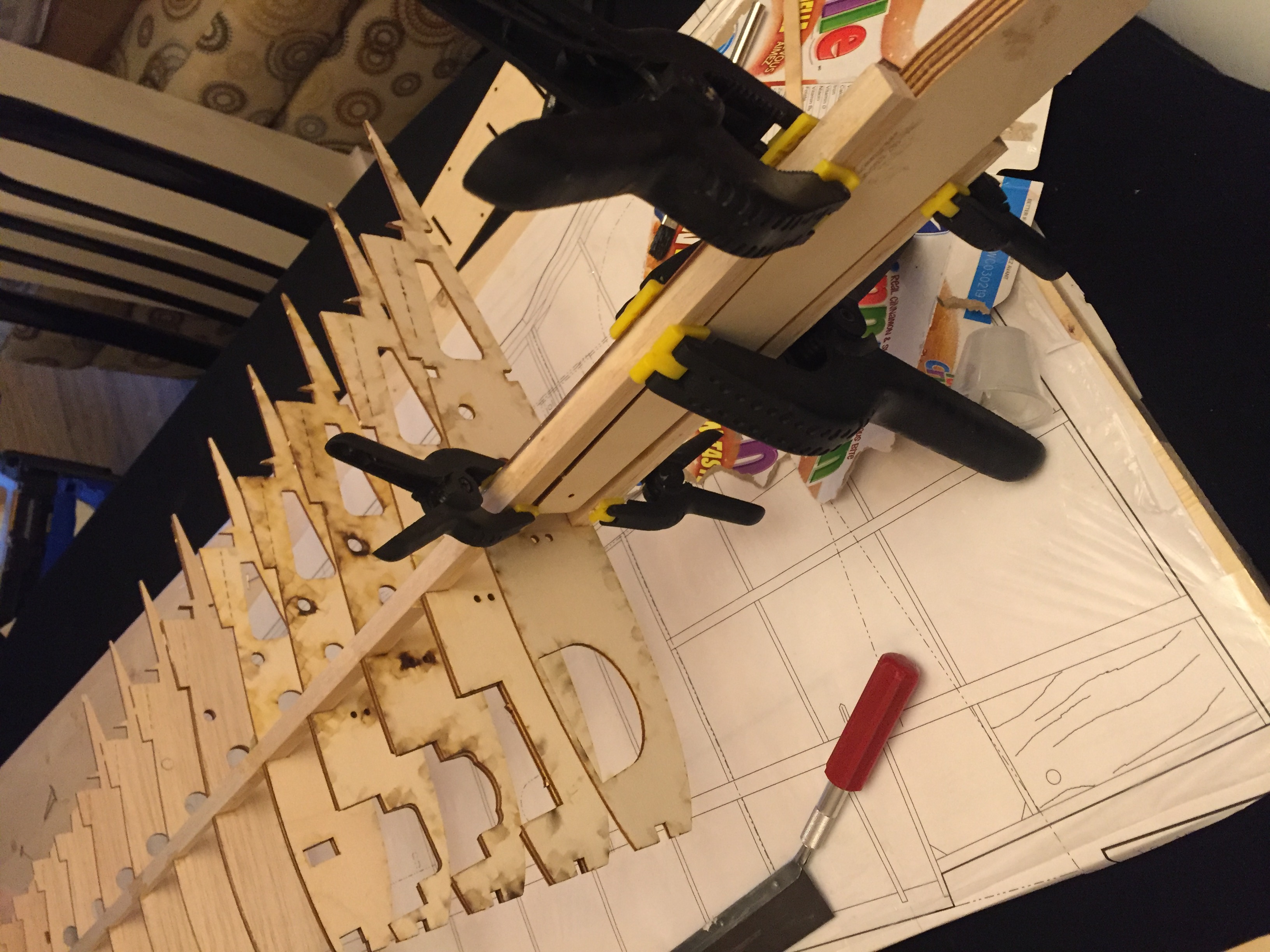

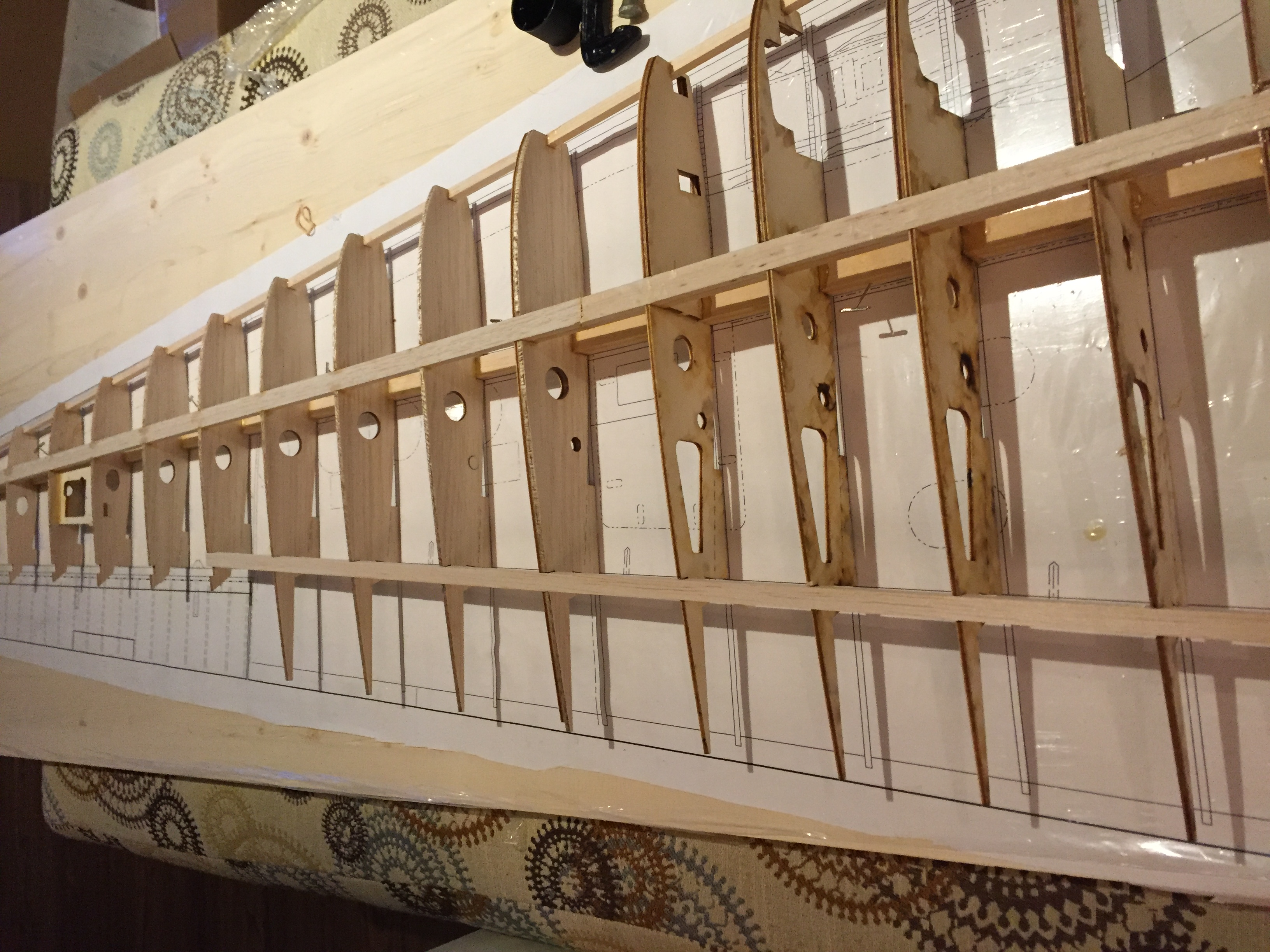

The first 3 ribs glued to wing joiner box with balsa triangles
ID:	2128096   Click image for larger version
ID:	2128097   Click image for larger version

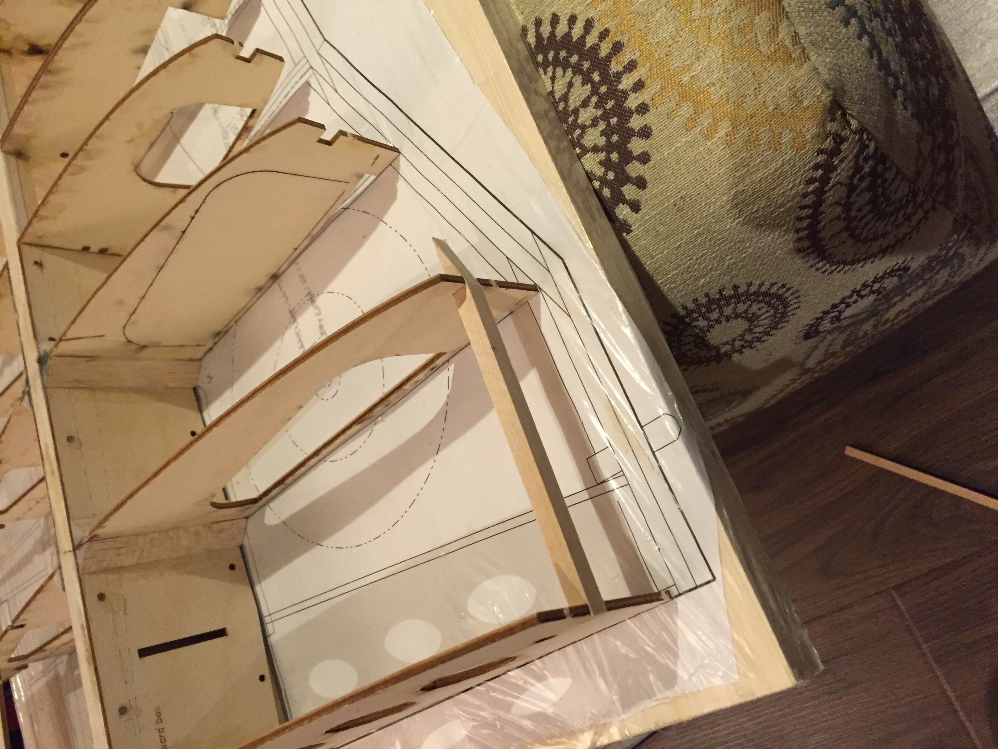

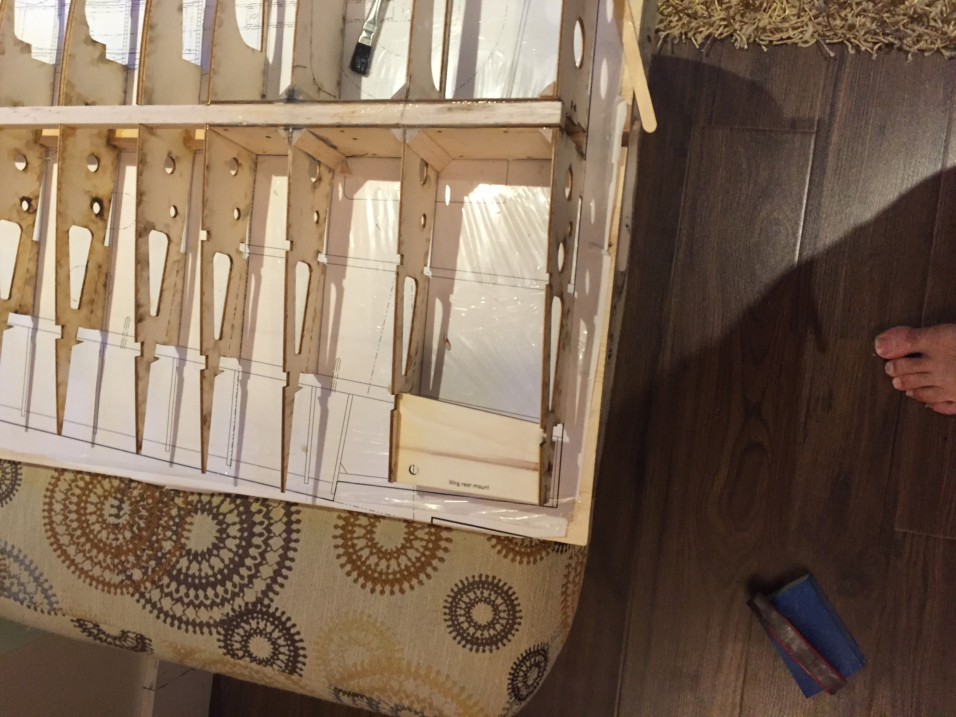

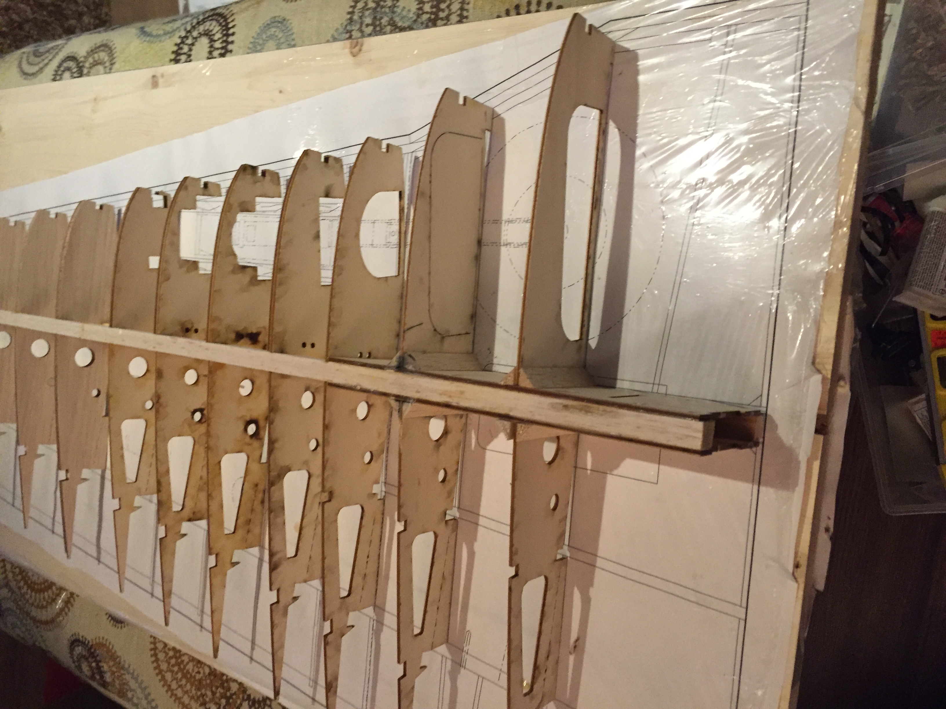

Wing rear mount and front spar glued to the ribs
ID:	2128099   Click image for larger version
ID:	2128100   Click image for larger version
ID:	2128101   Click image for larger version

Looks good, what glue are you using on the ribs and spars? the wing joiner box?
JG
Old 10-28-2015 | 07:58 PM
Joined: Jan 2011
Posts: 64
From: RICHMOND, BC, CANADA
Ribs and spars little bit ca for holding to the ribs then superphatic glue for the wing joiner box 30 minutes epoxy mixed with milled fibreglass

Rear spars finished
