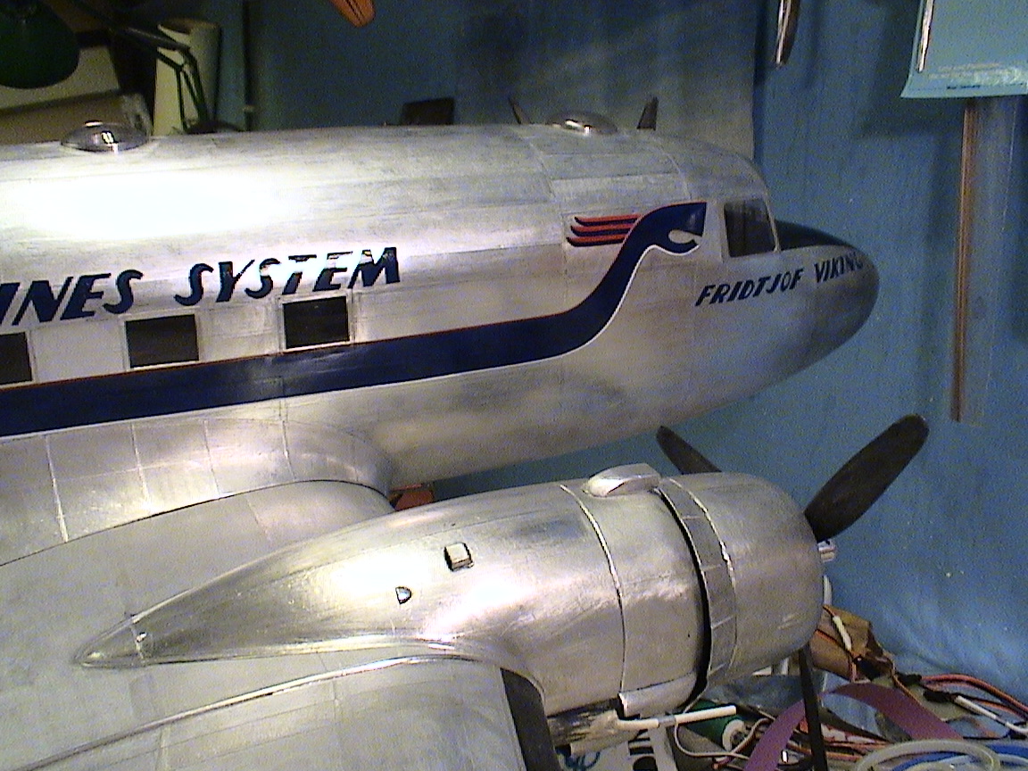

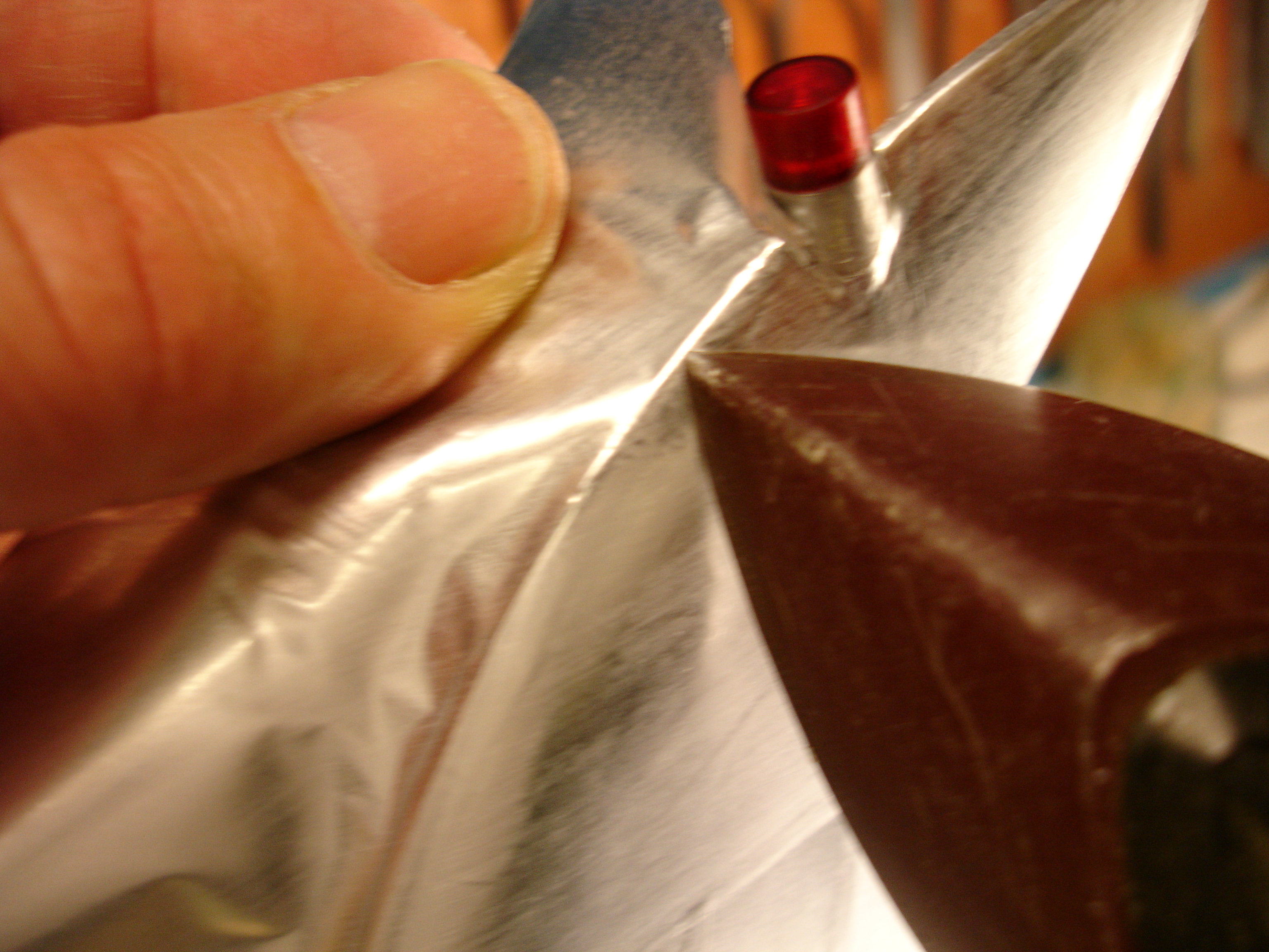

Hi!

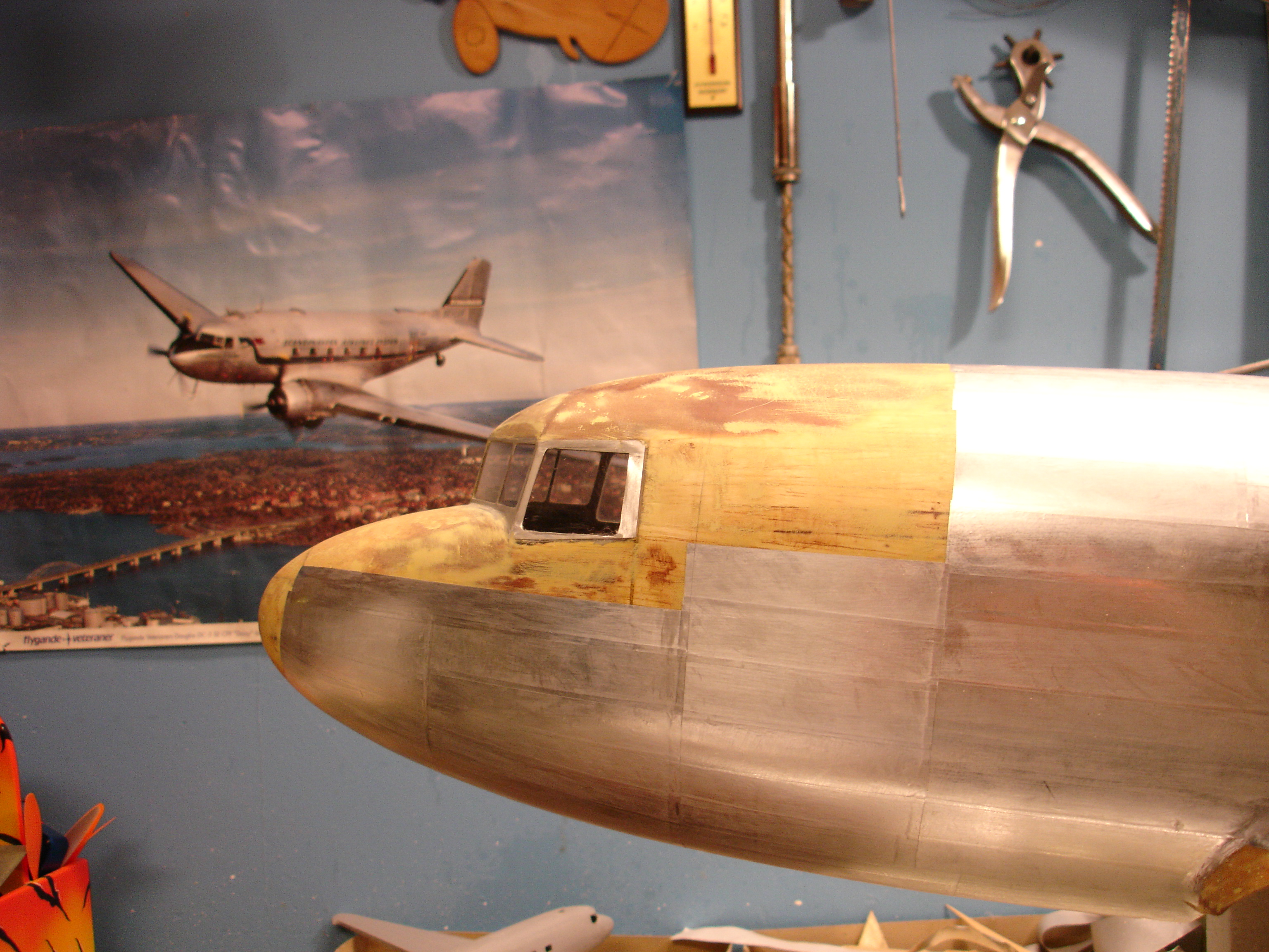

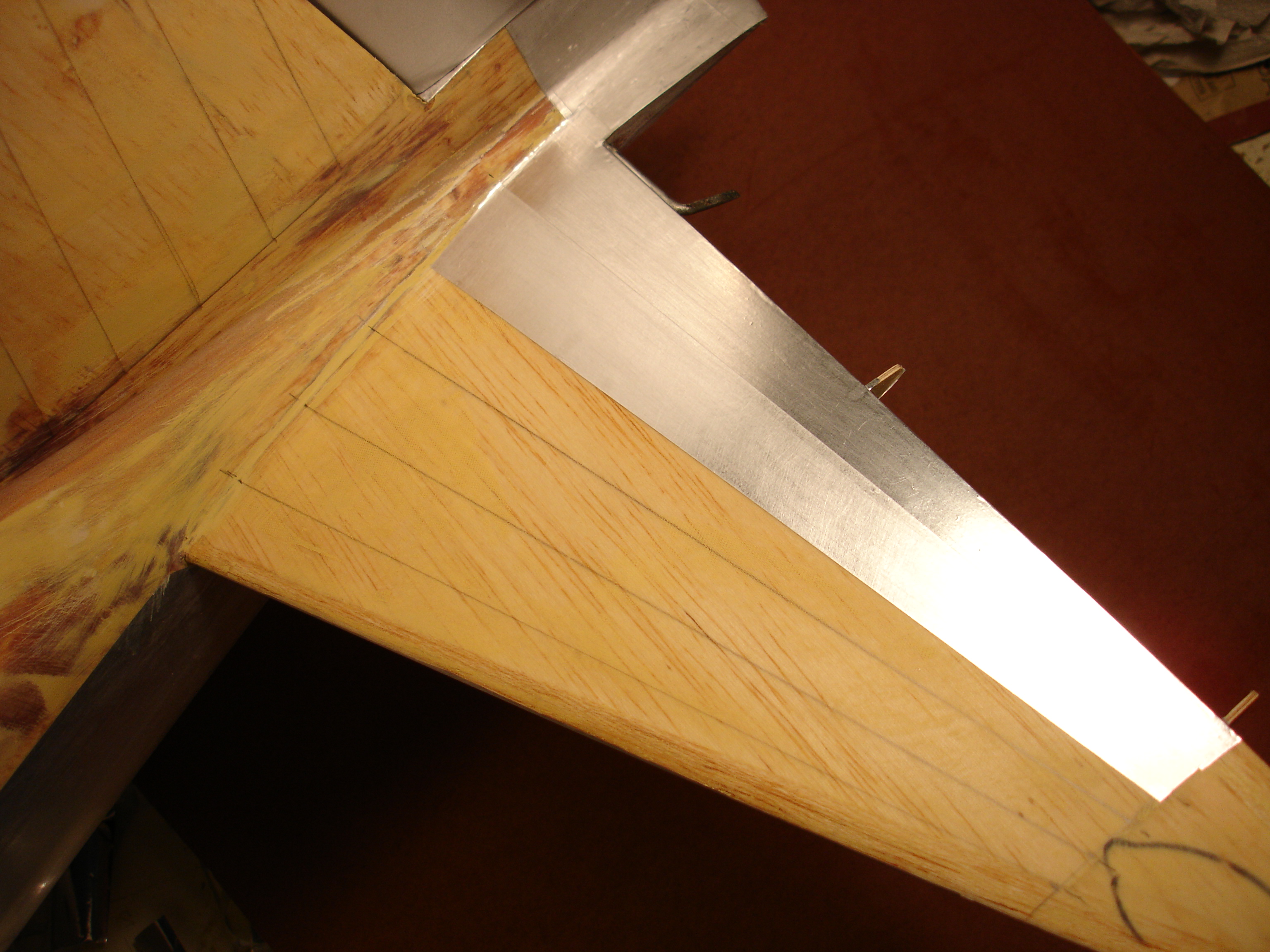

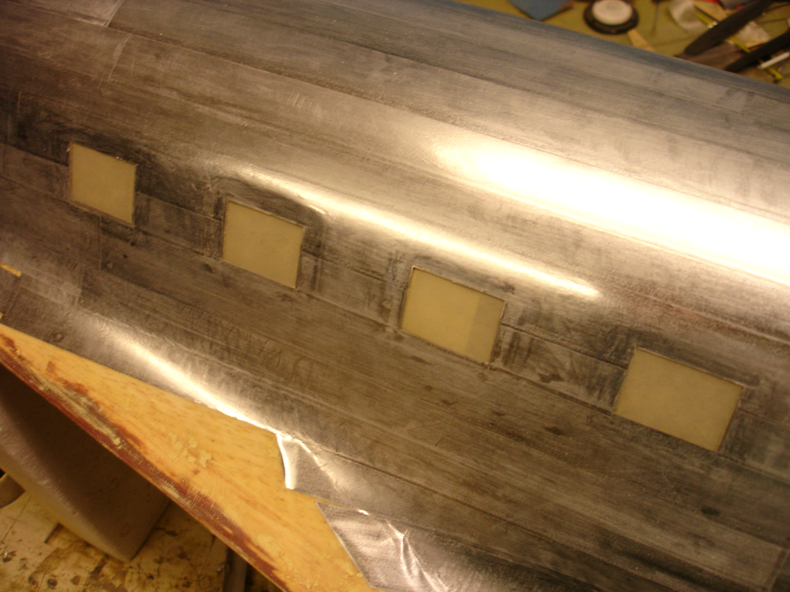

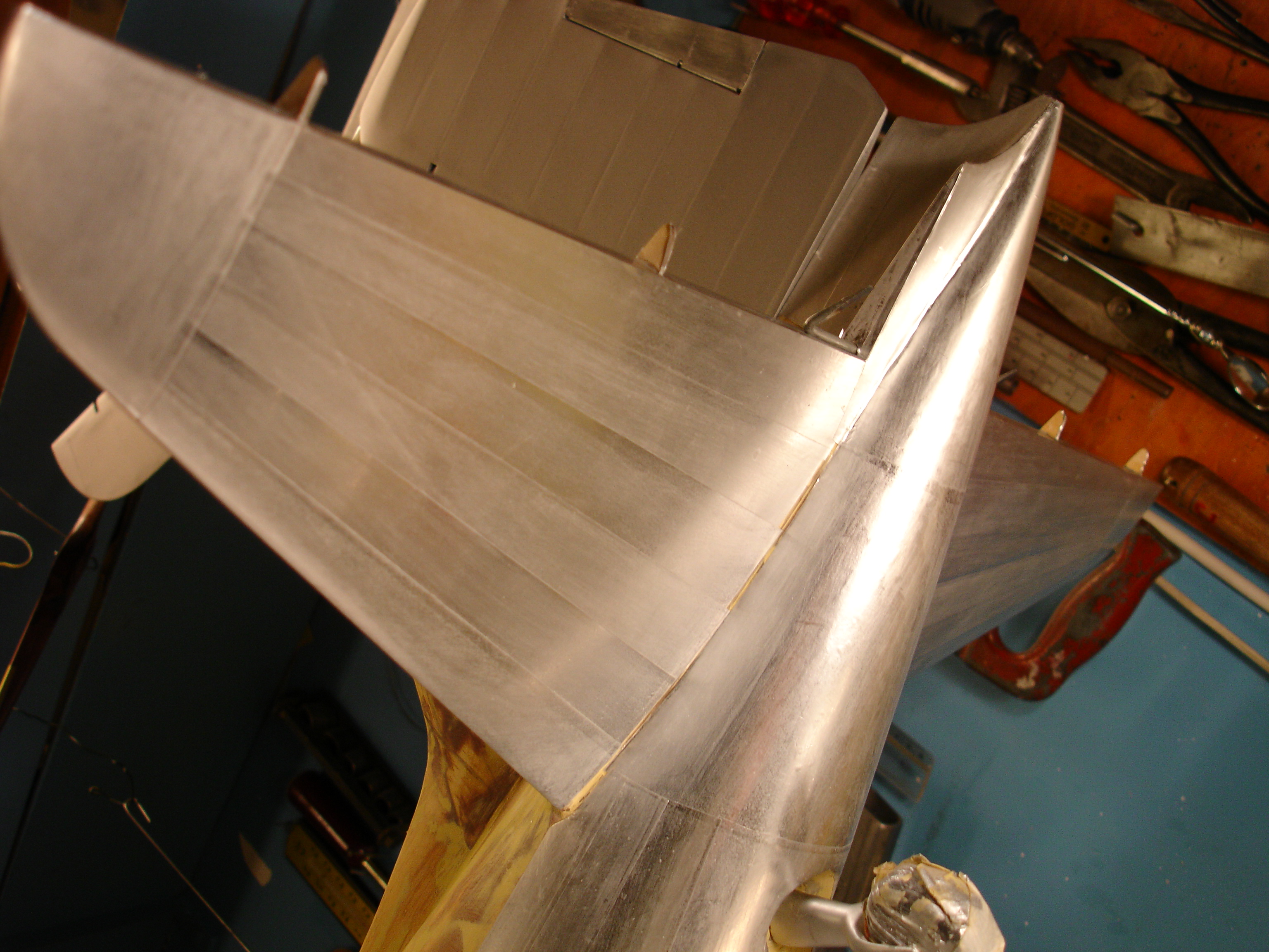

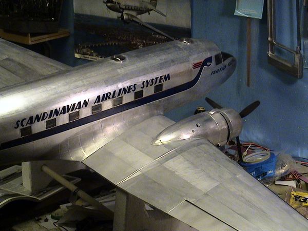

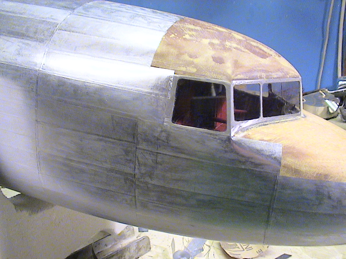

First of all the P-47 in 1/7 scale is rather small if you want to cover it using Flite-metal (Duct tape) as it will probably be rather heavy and as it is your first build I would recommend using chrome Oracover wet sanded on a piece of glass instead. Using that technic will get a much lighter model that will fly better and land slower (and probably last longer...).

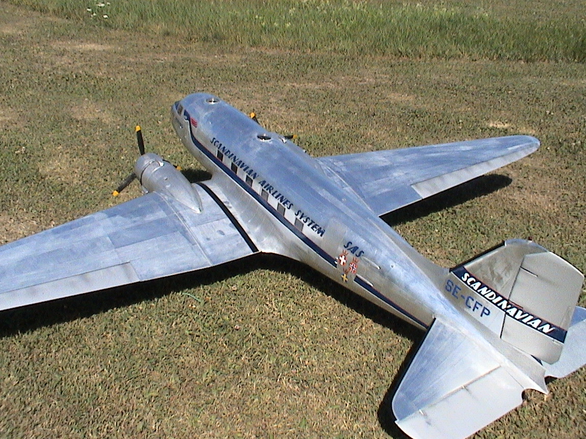

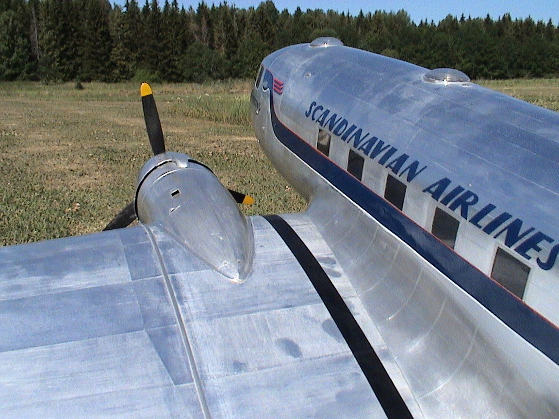

The only way to use duct tape or (Flite metal) is to cover the surface with 24-30 hour epoxy and 25 gram glass fiber weav or (not as good) polyester resin as his gives a hard surface and then filler.Filling dents is done with brown micro balloons and 24 hour epoxy.
But I would not recommend this metod for a small ,1,7m span fighter plane as the weight is going to be to high. A much better metod is to sacrifice perfect scale looks and just aim for good fly-ability and using Oracover and do as I showed with my DC-3. Wet sanding pieces of chrome Oracover on a glass surface ,sanding with 1200 wet sand paper. Plastic film (Oracover) is much lighter than duct tape (Flite metal).The only places I have used duct tape is on the engine cowlings as the surface is much too sadel shaped and on the side rudder where I have used Oratex (same as Solartex but a little better).

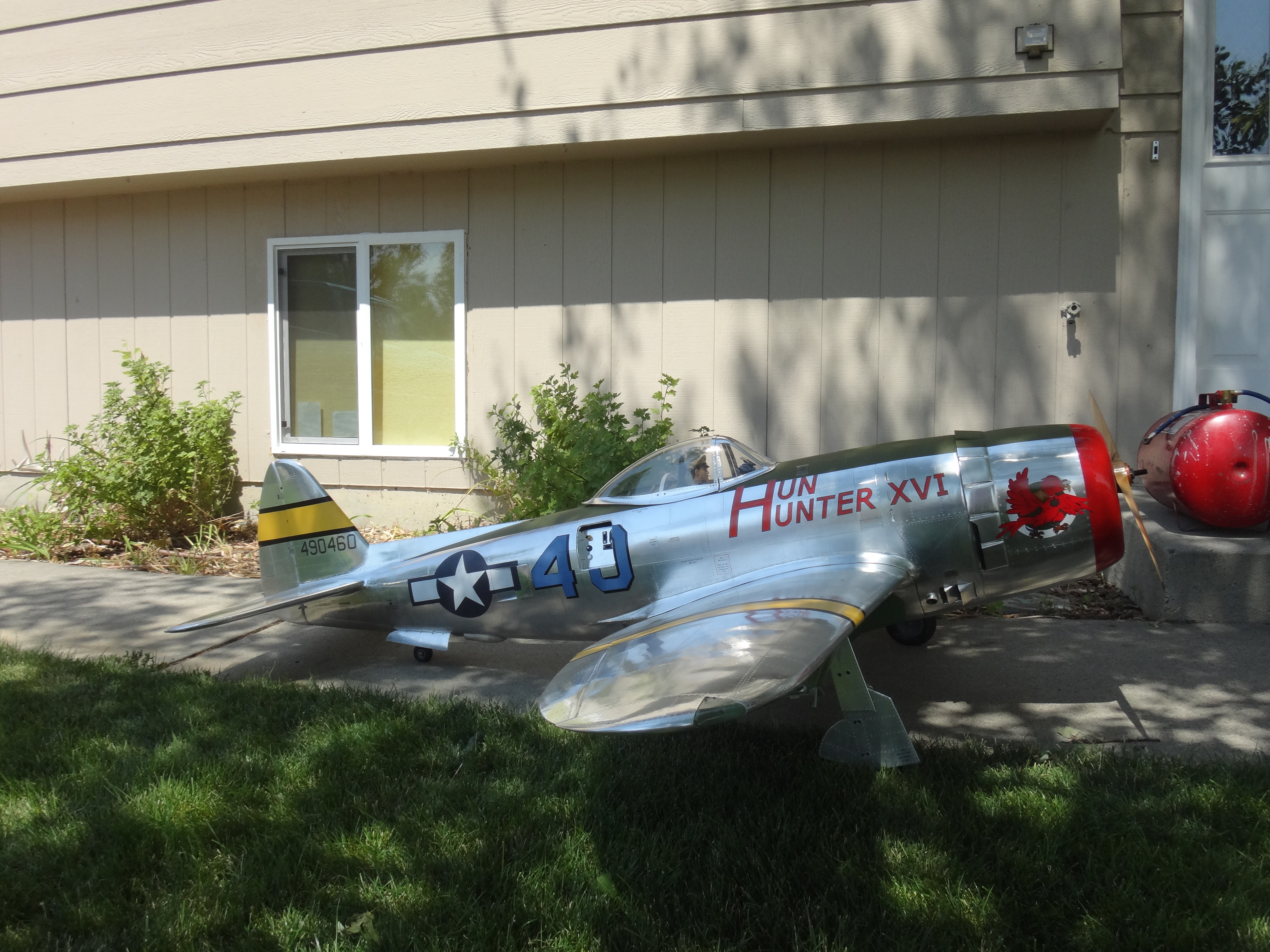

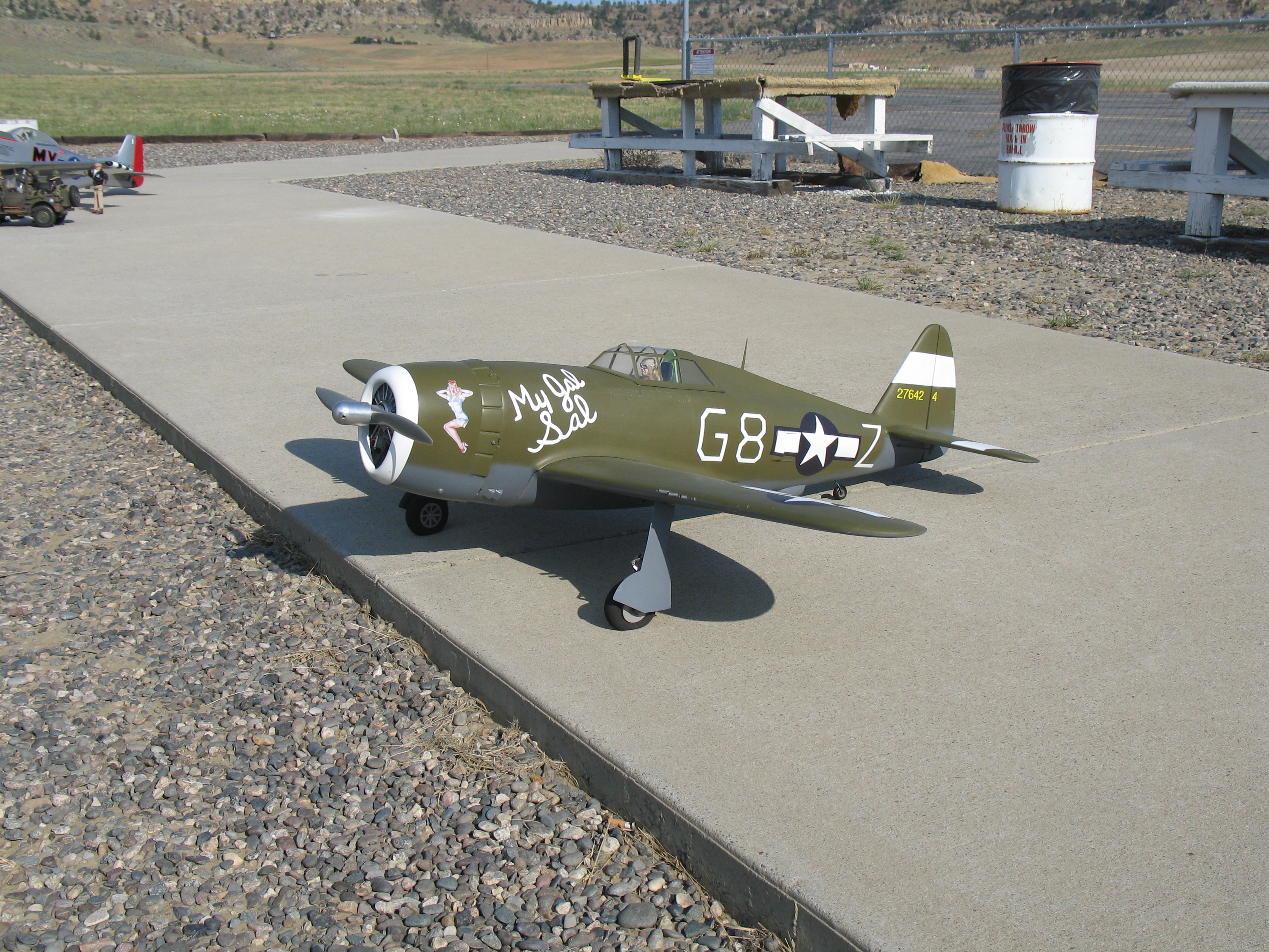

I am not trying to step on any toes here but please stop misleading the OP, Flight metal is not duct tape, it is simply flight metal covering. about .0015" thick with a supper adhesive applied to the foil.
I have both the 1/8 scale and the GS P-47. Both are glassed with .5oz cloth and epoxy resin. the 1/8th scale is painted the GS has flight metal. To the OP I want to say there might be a small weight gain with FM. but maybe only a few ounces. The scale look FM provides has no equal if a bare look is what your after.
Finishing epoxy resin will cure in about 2 hours, and can be easily sanded, any weave that is showing can be filled with spray can primer. I have used this system for over 20 years, makes a base for finishing the model.
