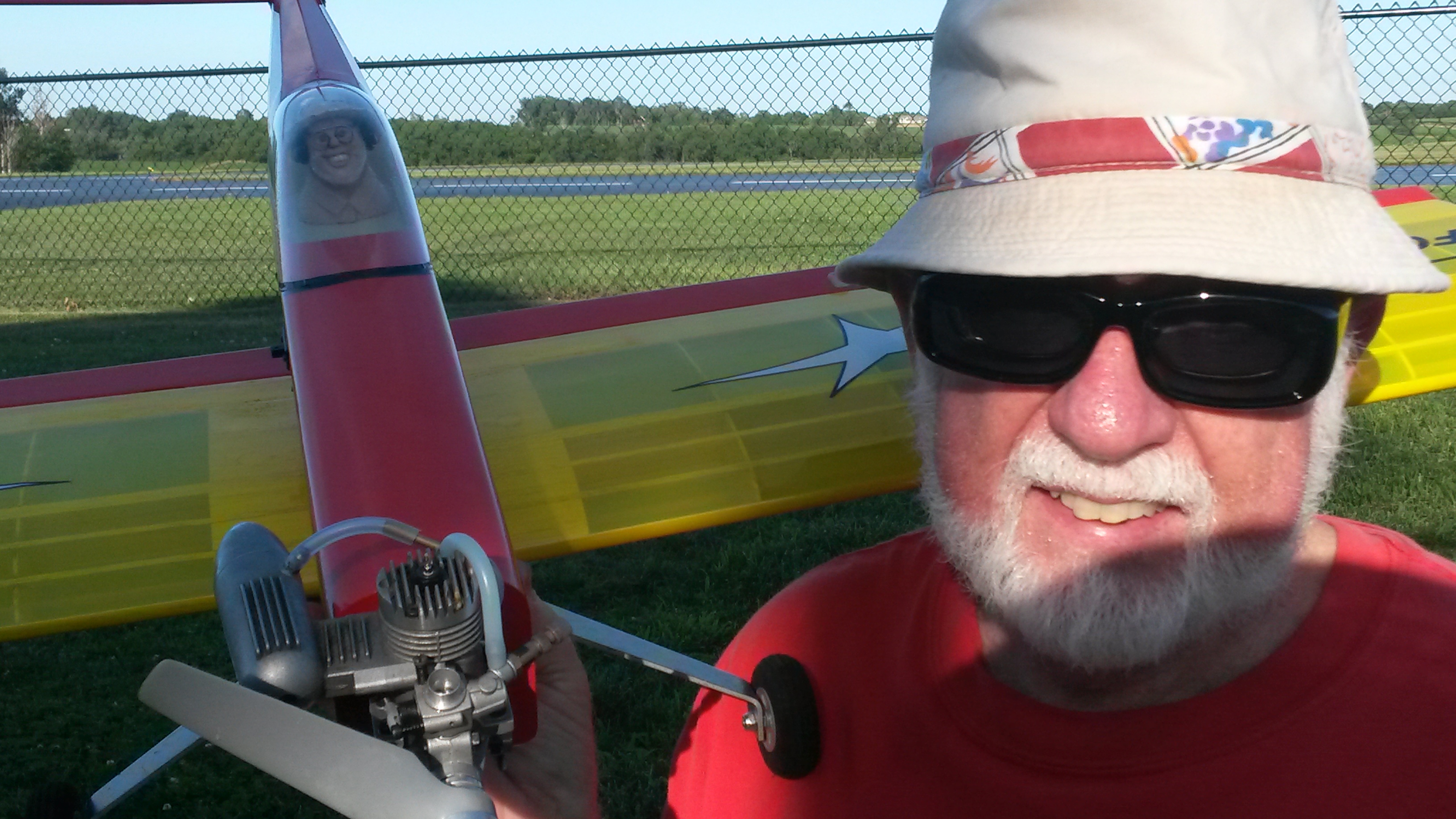

jeffie8696's Avatar
Joined: May 2007
Posts: 5,299
From: Muscatine, IA
Default My flying instructor Bruce, and Mini Bruce
Old 07-11-2016 | 07:36 PM
Joined: Dec 2002
Posts: 17
From: Davenport, IA
Did you build your second 4Star20,or buy it? I sold one at the Davenport swap meet that had a Thunder Tiger 25 and HS-81 servos and looked very similar to the one in the photo.
Old 07-11-2016 | 08:29 PM
jeffie8696's Avatar
Joined: May 2007
Posts: 5,299
From: Muscatine, IA
Thats the one I couldnt hand you the money fast enough to get ! And you see why . I gifted it to Bruce after the maiden.
