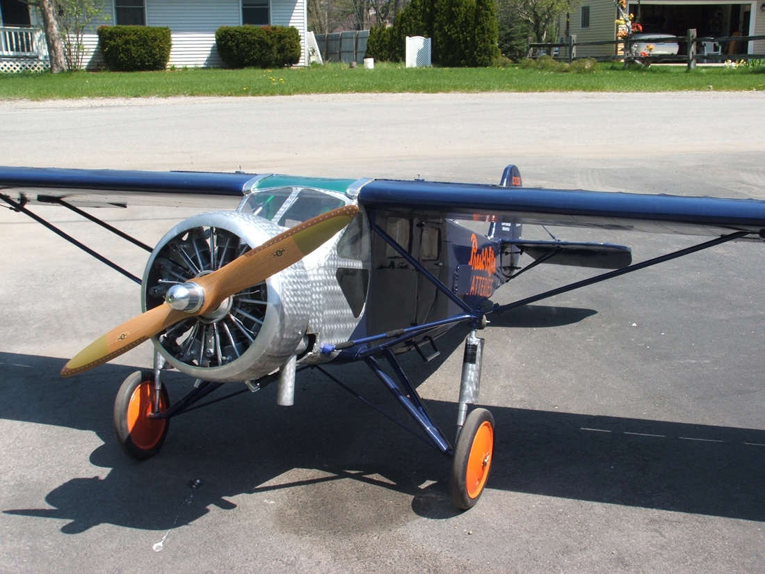

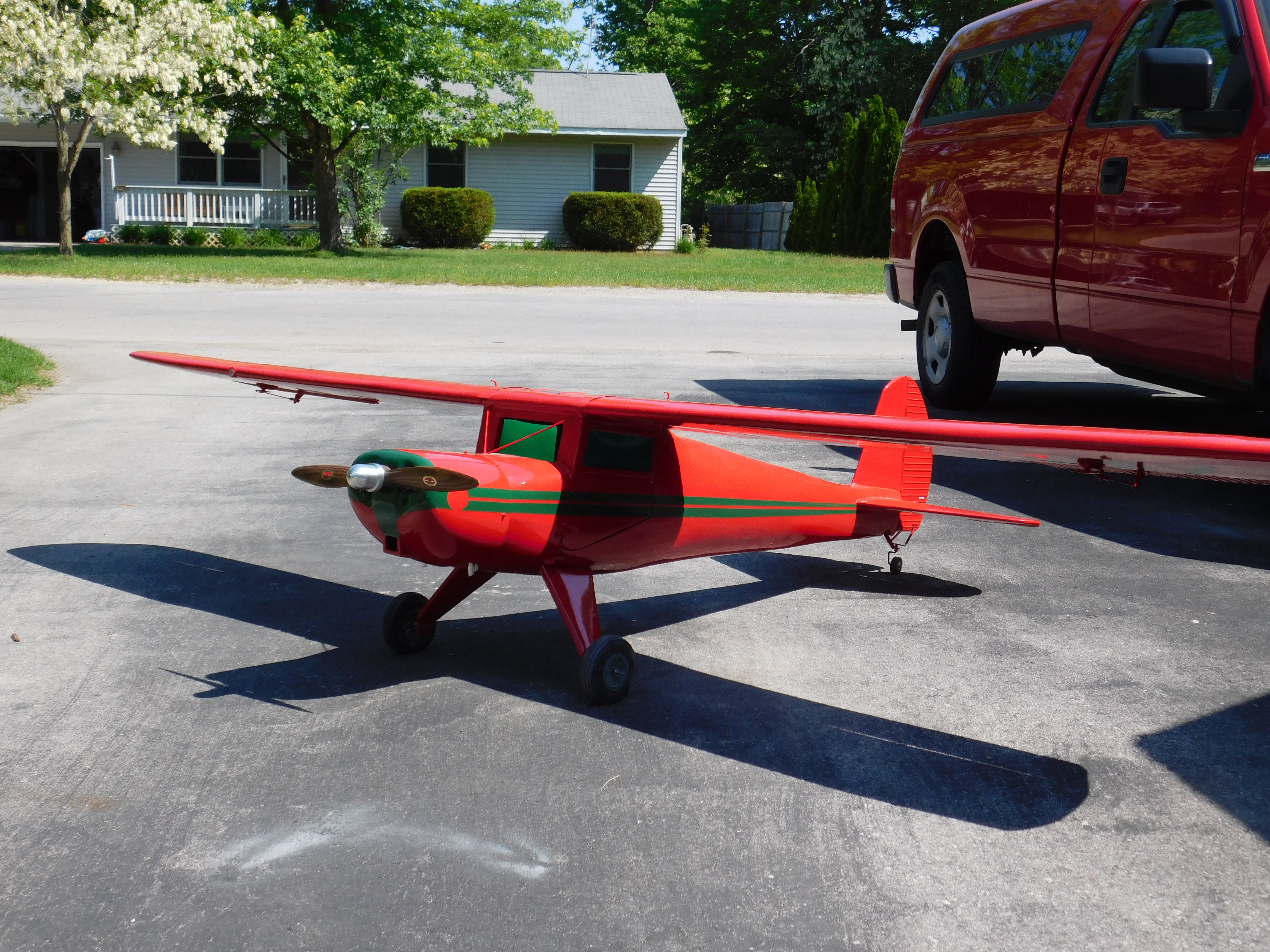

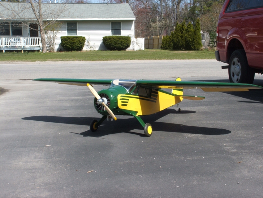

Like Check 6, I go to 320 grit.
I spray my airframes with Aqua Net hair spray for a little added adhesion enhancement.
I use just enough heat to let the Solartex adhere.
