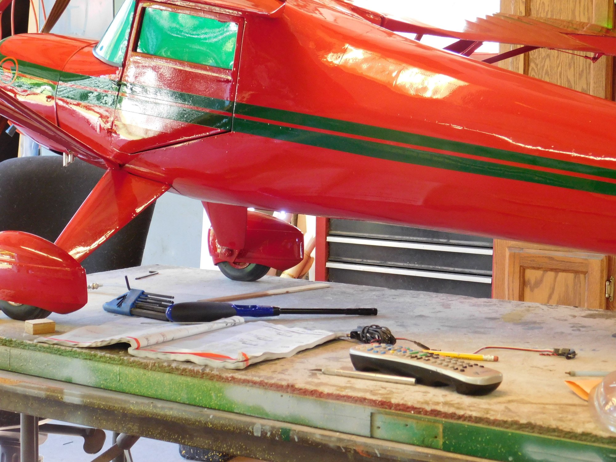

My favorite paint to spray is an epoxy paint made by Klass Kote. It is impervious to all types of fuels and has great leveling qualities. It's not cheap, but nothing really good is. Here's a shot of my Ryan-STA that I painted using Klass Kote.

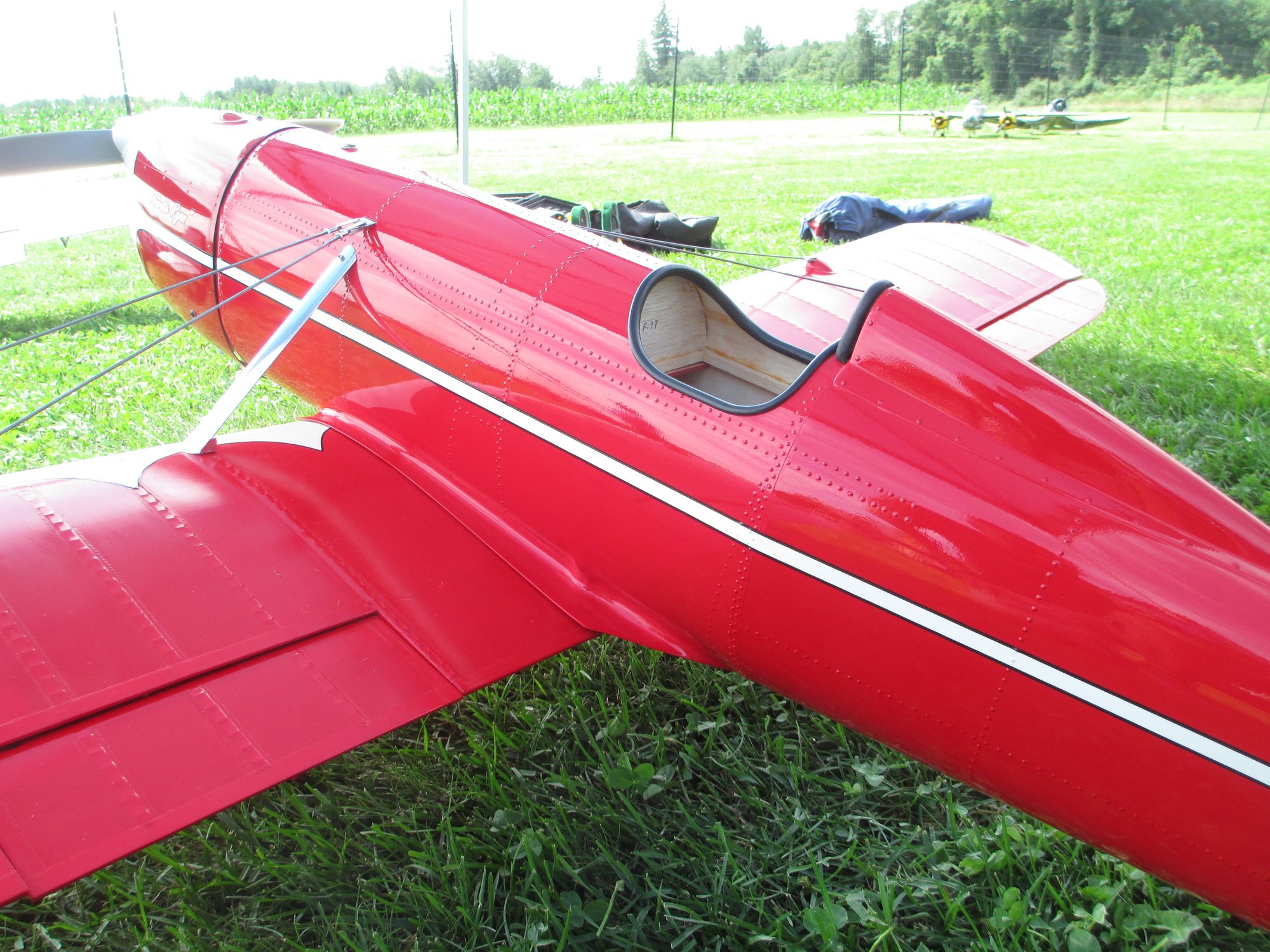

As VJ illustrated, epoxy works well, and doesn't require a clear coat. Although I have use 2 part automotive systems, these days I prefer the simplicity of aerosol Rustoleum and a clear coat of polyurethane.
2 part automotive paint
Rustoleum and polyuretnane from aerosol cans

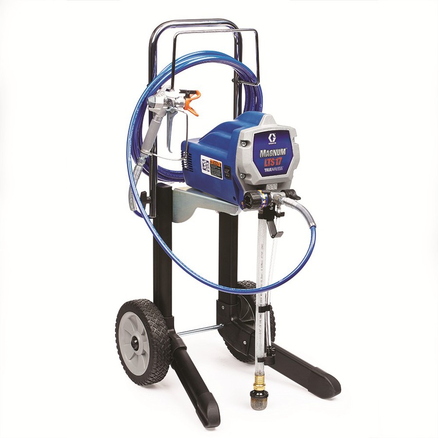

mgnostic has it right. Painting houses and painting RC airplanes; definitely different processes using different equipment. Airless sprayer for the house. I painted a 3-2 single story down in Florida, solo. Pressure washing, masking and prepping for painting was the most time consuming. Spraying the house was the easy part. Cleaning an airless sprayer is not too bad if using latex.

I want to learn about spray systems and I want to purchase some equipment. I am beginning to learn that I need two systems. One for modeling and one for house painting. I really like the idea of having a pressurized air tank in the shop. I own a Paasche compresser and gun. I see online that Paasche sells a small tank. Will be looking into that. I not sure of the Paasche upper limit yet. I know Paasche is designed for teeny tiny stuff and my gun produces an extremely fine spray. I am also thinking of looking into a system a little larger than a Paasche. I am not sure I am sold on airless for the home painting. Lots of negative reviews online.
For painting a house you want something on this scale. They are kind of pricey hence my suggestion of renting one. If you aren't happy with it take it back and try something else. This is one task where you get what you pay for. In particular you want something with a ceramic nozzle. It seems that good quality house paint is actually somewhat abrasive and will wear our a plain metal nozzle. The hand held "Power Sprayer" guns have their uses but once you go beyond spraying interior walls you are just wasting your time.
