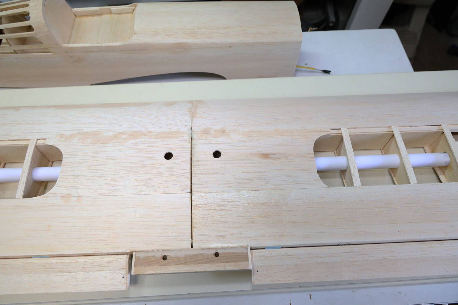

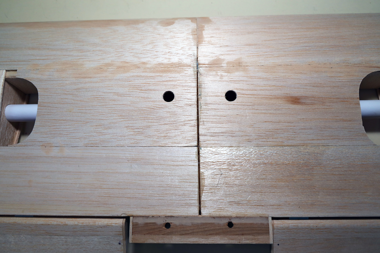

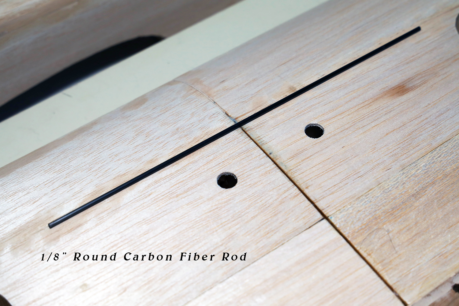

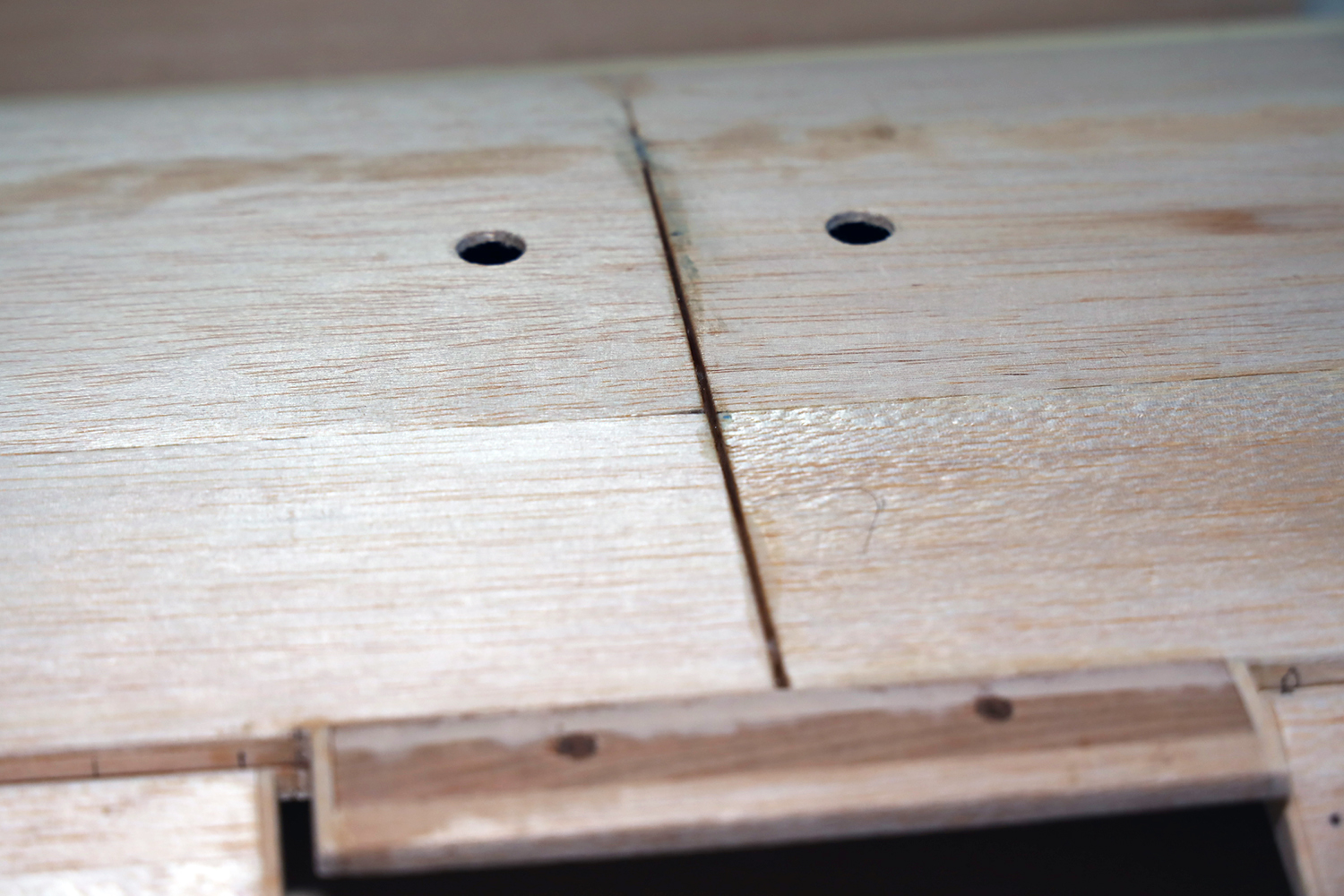

After joining (epoxying) together the wing halves, a near 1/16 inch gap occurred. I took a precaution to prohibit that, but something must have slid over night.
I am uncertain that a layer of 1 ounce fiberglass cloth would prevent the wings from folding on the maiden flight. Looking for ideas to solve this.
I found that I had two 1/8 inch by 12 inch lengths of C-F rod that might be the solution. But, I wonder if I would be weakening the wing structure further by cutting grooves on top and bottom side spars.
What do you think about my idea, or what do you think I should do?
I posted this in RCG also so as to get your reponse too.
Thanks.

Fill the gap with a paste of cabosil and epoxy resin and then while still wet, apply a layer of your 1oz cloth out about 1" past the fuselage sides followed by another 3" wide strip. Your center section will be bulletproof and your fuselage sides won't dent the wing sheeting.

OK. Here's what I am understanding you are recommending:
"apply a layer of your 1oz cloth out about 1" past the fuselage sides"
So, my first layer of cloth is wider than the fuse sides. For example, if my fuse width is 3 inches, then I am laying down a 5 inch width first. Si?
"followed by another 3" wide strip"
After that cures, I lay down a 3 inch width over the 5 inch width? Si, o No?
I will hold off until I hear from you. And, thanks for being the first to reply. Much appreciated.
Lupe in San Antonio
Old 07-02-2019 | 04:31 AM
CHassan's Avatar
My Feedback: (13)
Joined: Aug 2002
Posts: 1,318
Received 2 Likes on 1 Post
From: MainevilleOH
Of course you want to fill in the gap with epoxy thickened with..... speed said Cabosil, I've used something like that (fine powdered silica.) I've also used milled fiberglass and balsa sanding dust.
Then lay down the 5", and follow up with the 3".
I generally just do the one layer and often it is no more than 2" wide. However, do it speed's way an you will indeed have a very strong wing that you don't have to worry about.

Sorry for the late return, looks like everyone is on the same page. Only thing I want to add is to do everything in one step. Fill the gap, lay down the 5" strip then the 3" strip. Blot out any excess resin with paper towel and let cure.

Anyways. I did exactly what speedracerntrixie (man, that's a long user name) suggested. In the post above you say to do it in "one step". Funny thing is that I did exactly just that several hours ago.
Just went out in the garage..er..building shop to check the wing. I feel a high level of confidence that my issue has been resolved. Of course, the proof is in the pudding. Maiden flight is about a few weeks from now for my short kit, a Super Sportster 61. Last time I built anything was about 1999.

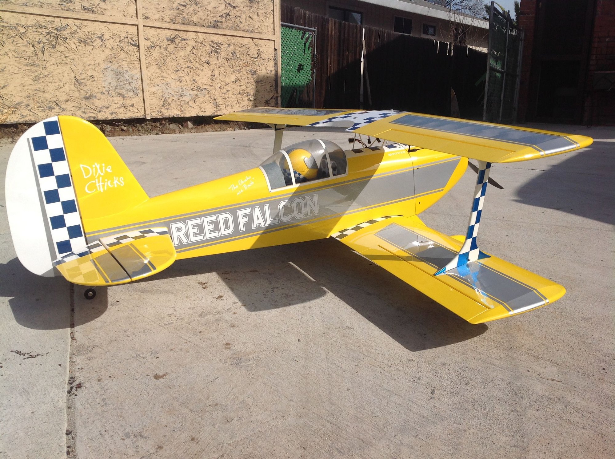

I like the Reed Falcon graphics scheme. Large checkerboard adds a lot to its looks. That will help during inflight orientation. I am scheduled for a vision exam this month.
I was planning on using yellow as the base color with red & blue accents.
If you don't mind, I'd like to borrow your biplane's classy scheme. Really looks sharp and unique.

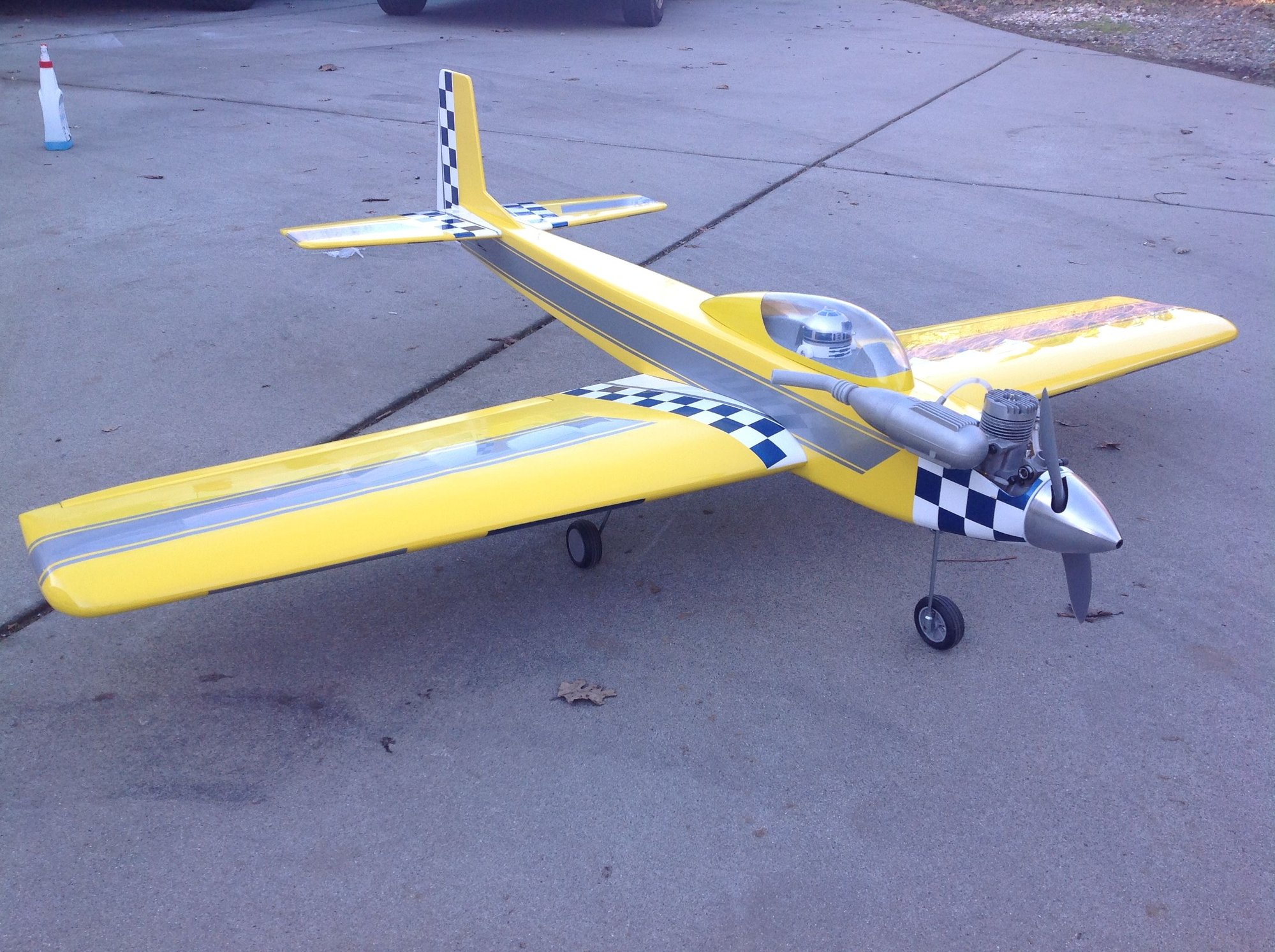

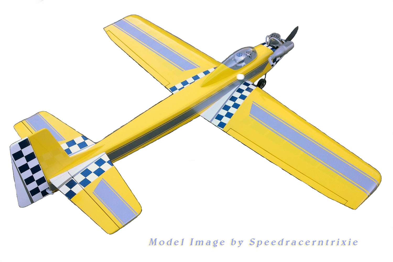

In that case, a picture of the Super Kaos I tried the scheme on first may help. I haven done any threads specifically on Monokote. There are really only a few key points besides getting some practice. The biggest key is to get the wood as dust free a possible prior to application. I finish sand with 400 grit and then dust off with some old dark color T shirts. You will be amazed at how much wood dust comes off and that it takes at least 6 dustings until you see no dust on the T shirt. That's the reason for the dark color. The next thing to remember is to apply in such a manner that you won't need much shrink. When doing wings, pull it tight as you iron onto the LE and TE. Work from one end to the other making sure you get all the air out from underneath. Any trapped air will become bubbles/wrinkles later. Now for a little trick. When applying Monokote over Monokote, use Windex with ammonia. Spray the Windex down, place your peice of trim and then squeegee the Windex out with a balsa squeegee. Let it set overnight and then iron down with the iron set to medium heat. Just takes a little practice.

Wow. Beautifully done SK. Outstanding, eye-catching scheme that certainly draws attention when it comes into the pits.
I like the straight-lined, easy-to-cut graphics that would make this part of the build easier for me. Thanks for the pic.
In a Sig 4Star build thread, VincentJ mentions blasting the frame work with compressed air to remove hidden dust. Your black T-shirt idea goes a step further. Never thought of that. Man, how things have advanced since I last built a plane.

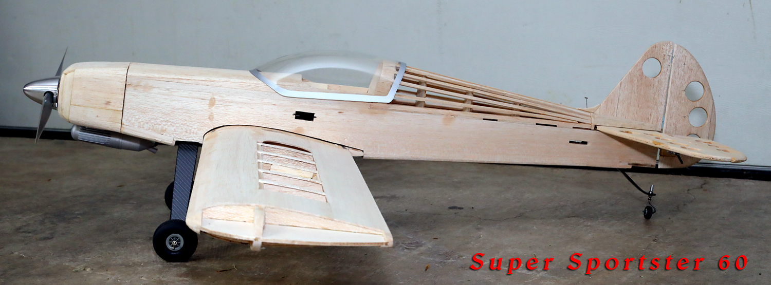

This is what I am working on for about 3 months. A BalsaWorkbench short kit of the Super Sportster 60. Without the pointy nose it was designed with.
A lot of mods and small mistakes along the way, but there's no turning back, just solve the problem and keep on going.
Well, gotta go to Lowes to get my list fulfilled.

Default Super Kaos Graphics Scheme
Speed, I hope you don't mind, but to keep from coming back to this image in RCU, I did a little editing on it. This will serve as a reference for me when I'm plotting/cutting out the graphics. I forget the small details.
Note: Fear not, I do not plan on making any money on your image. Once done, I will dispose of the image.
My finished work will not be as perfect as yours appears. But, practice makes perfect.
