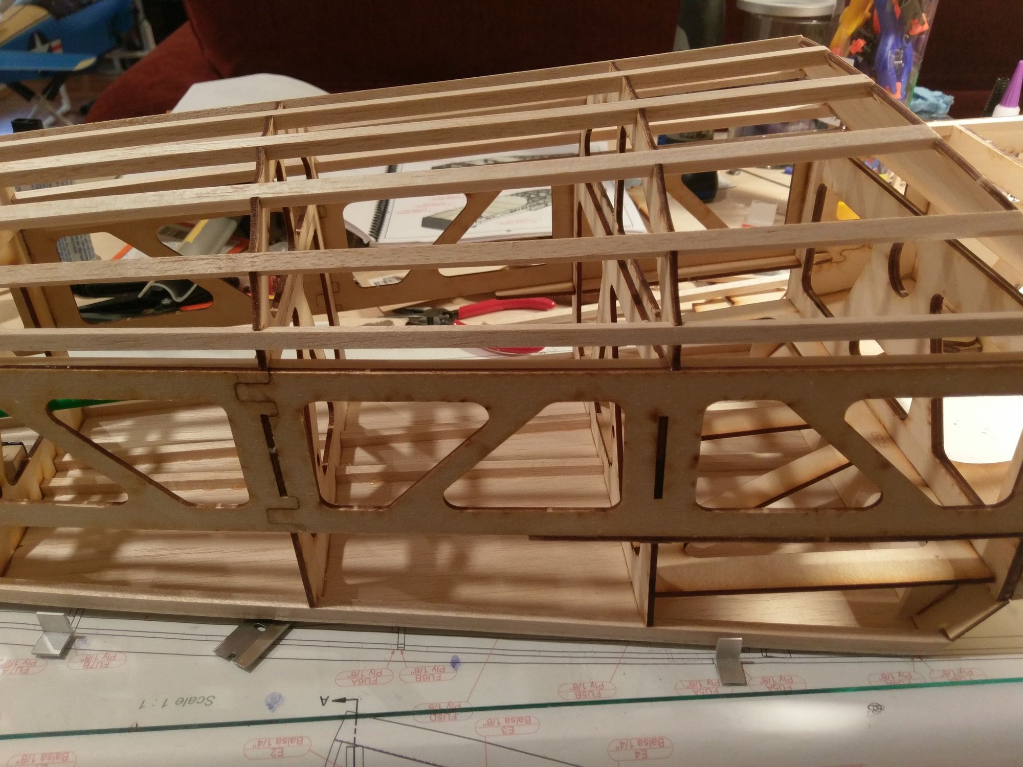

Fuselage:

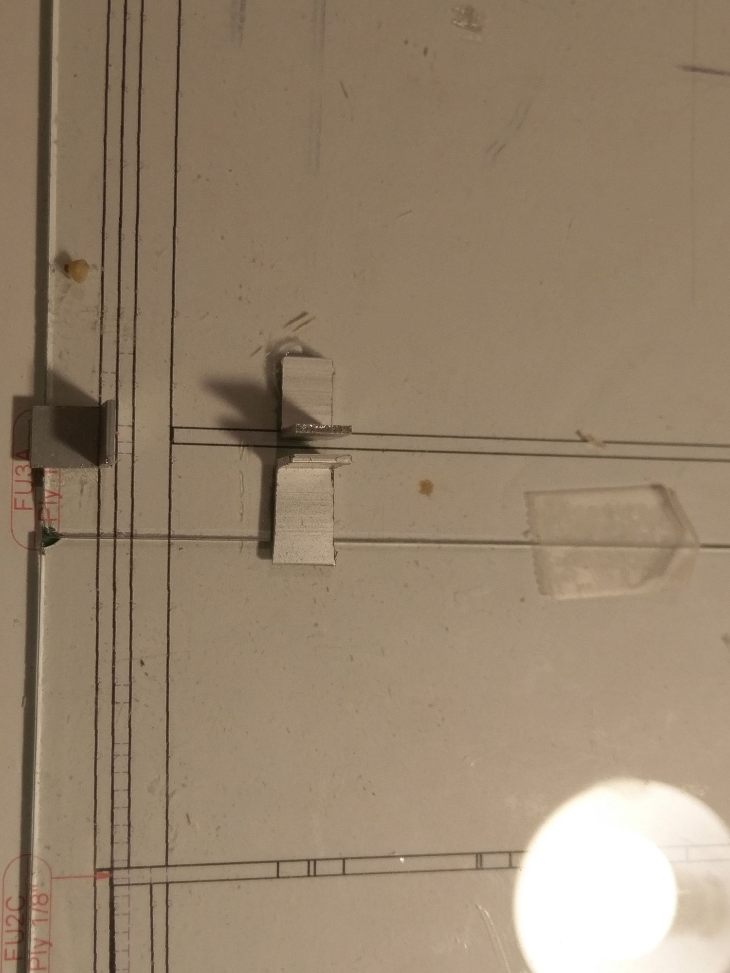

Full size plans
Aluminum L brackets attached to glass with CA
Closeup of interlocking tabs - fuse was removed from the table after completion. Hence lack of contact with the aluminum brackets.
Top rear section of fuselage-lifted from the table after completion

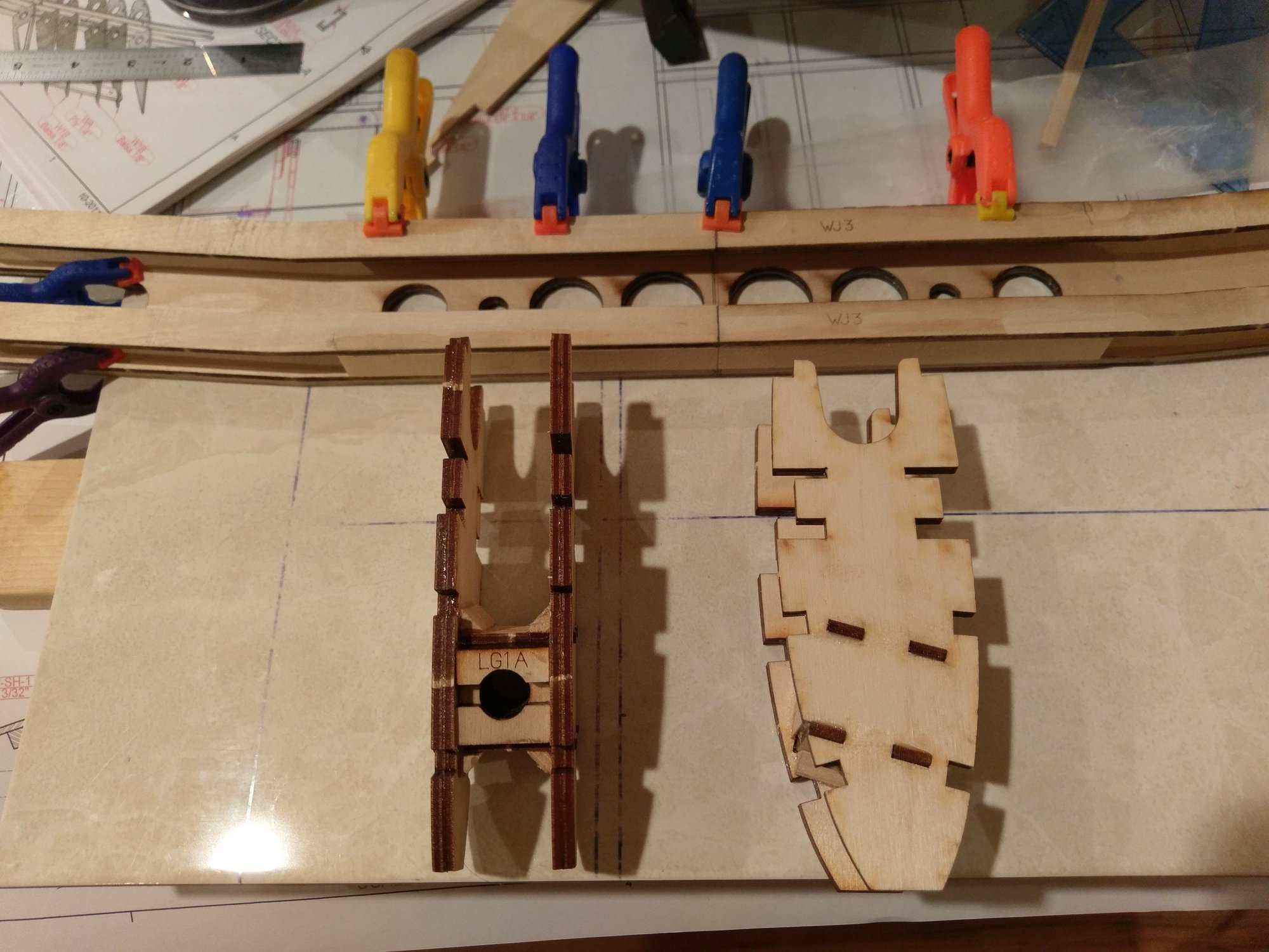

The laser cutting is generally excellent, and the parts interlock snugly with minimal to no gaps. Speaking of fit, that is a revelation in this kit, especially the fuselage. The interlocking tabs allow for easy framing of the wide fuselage. I build with a glass sheet on the plans. This makes for a very flat smooth surface. For this build I used small aluminum 90 degree angles pieces to hold the formers in place. These can be easily tacked to table with CA, and then knocked off. A few wipes of a scraper blade and the glass is clean again.

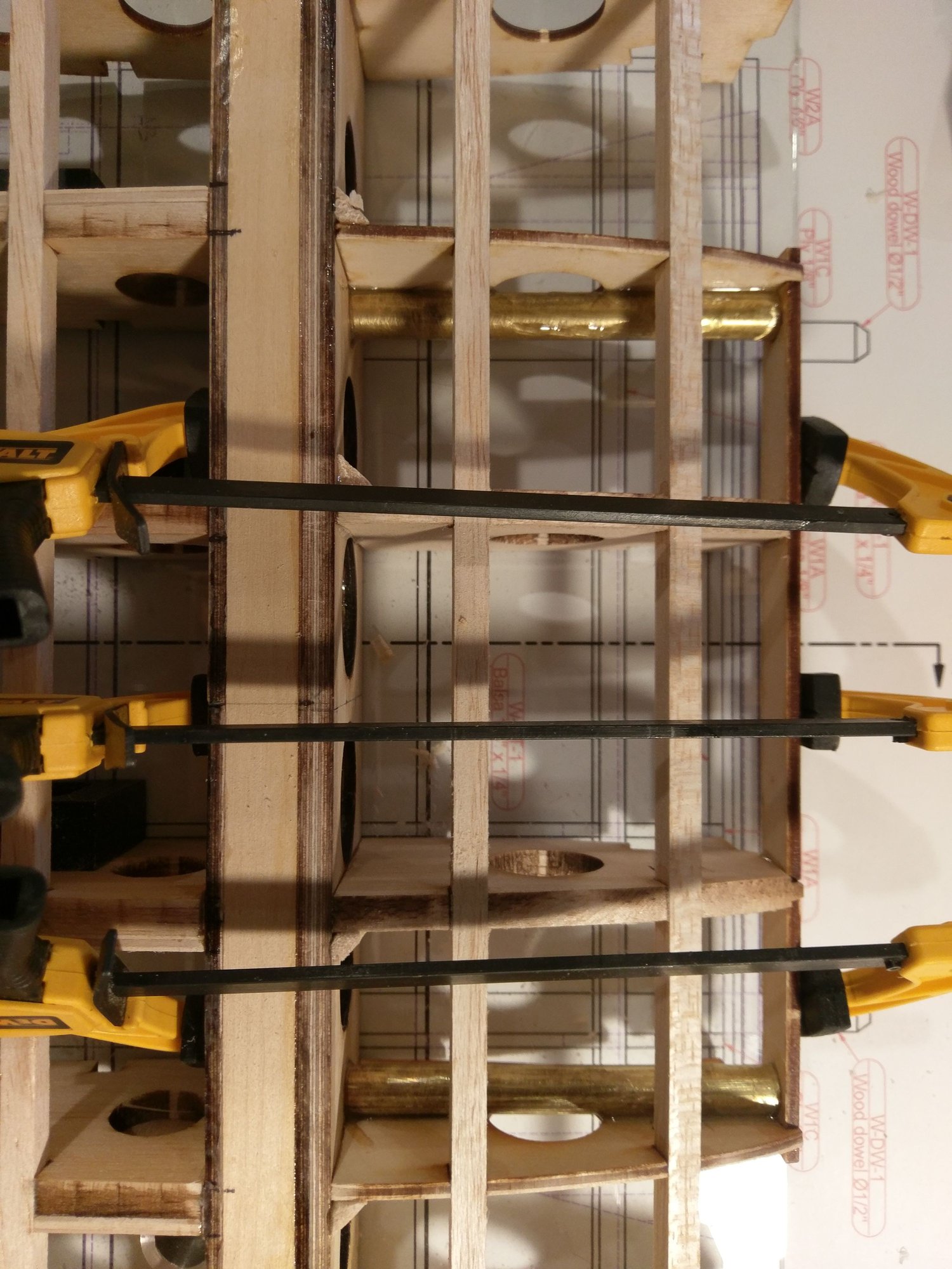

Wings.
The panels build differently from other kits I've put together in that the spar does not lay flat on the build table. It must curve up to meet the slots in the ribs, and being hard wood, I thought it best to steam and bend the spars to the correct angle before installation. I steam bent the upper and lower on the same jig so they would be symmetrical. This way, they naturally fit into place and minimize the chance of any warping afterwards. Following the sheeting, the panel sat evenly on all all the build tabs - nice and true.

Center beam. All 5 layer ply made for a very stiff structure. Landing gear mounts are a sub-assembly.
I installed brass tubes so that the 3/8 dowels would be removable. A solder #2 wood screw on the end cap allows the dowel to be twisted in.

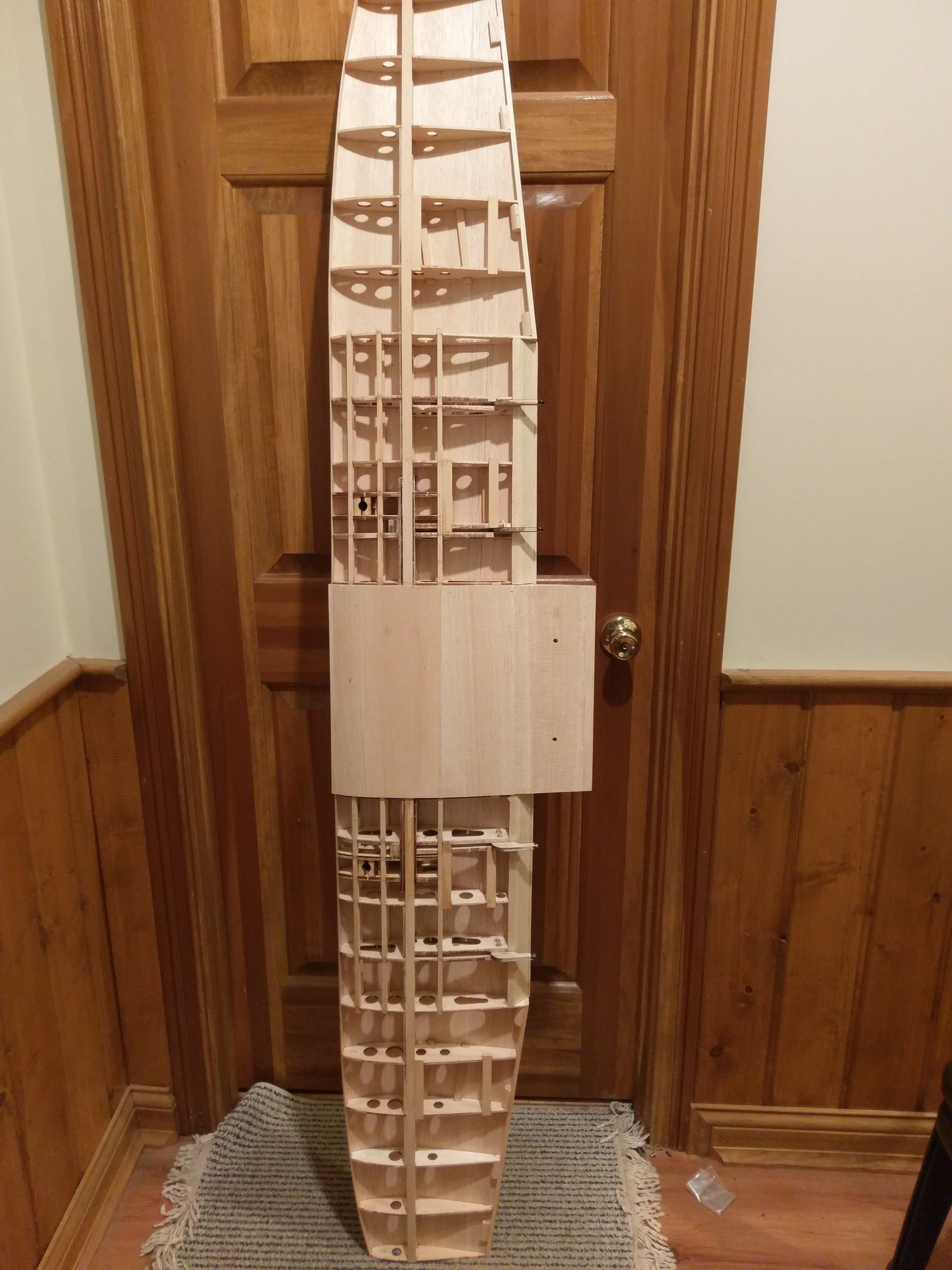

Assembly of center section.

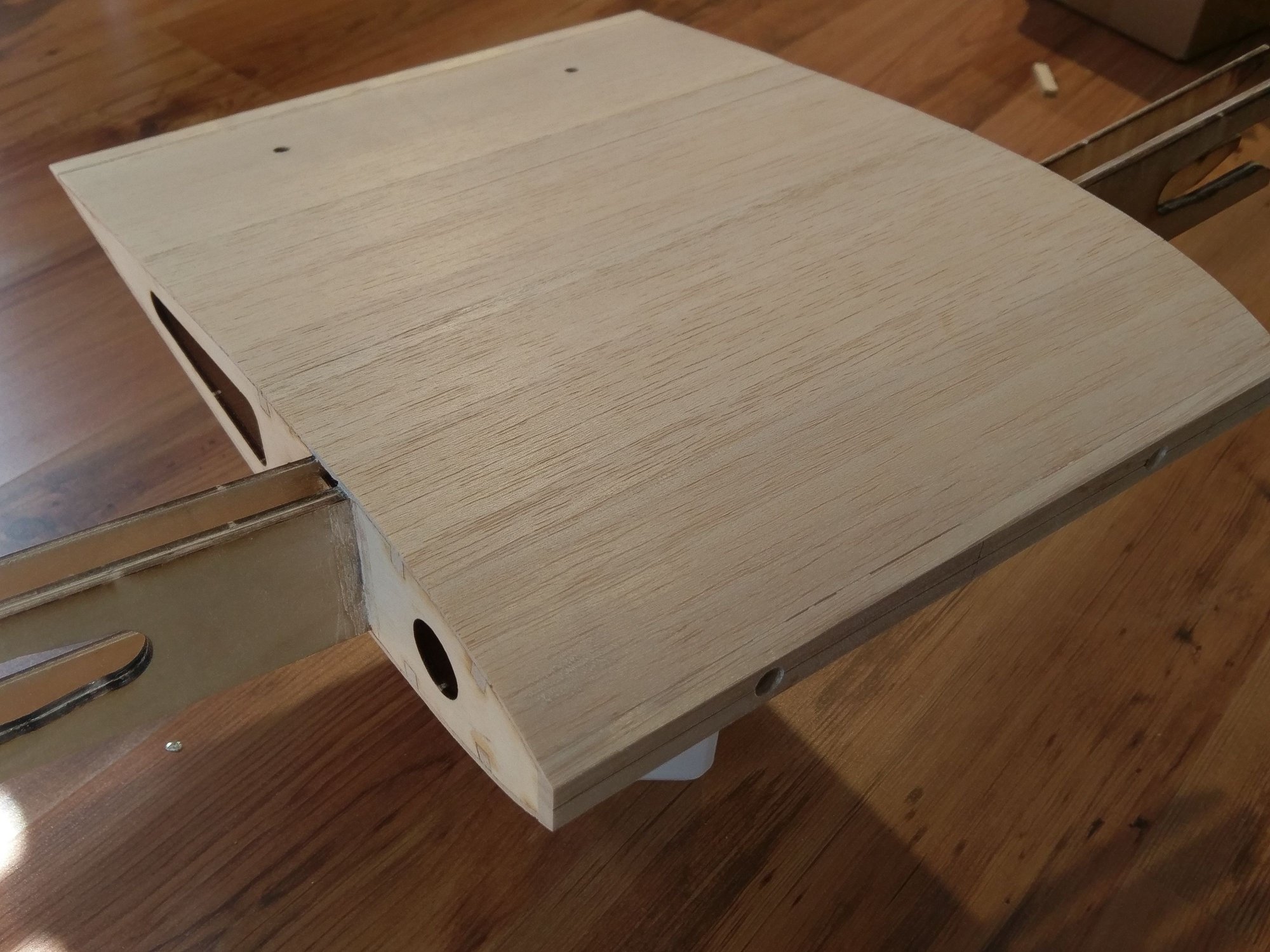

Sheeted center section
While the ribs have tabs, one steam bend in the main spars allowed them to be fitted without pressure.
Assembly of the wing panels.
More wing panel construction.
Lots of days later, and all three sections aligned nicely and were epoxied in place. Yes, it's a one piece wing. Not ideal for transportation.

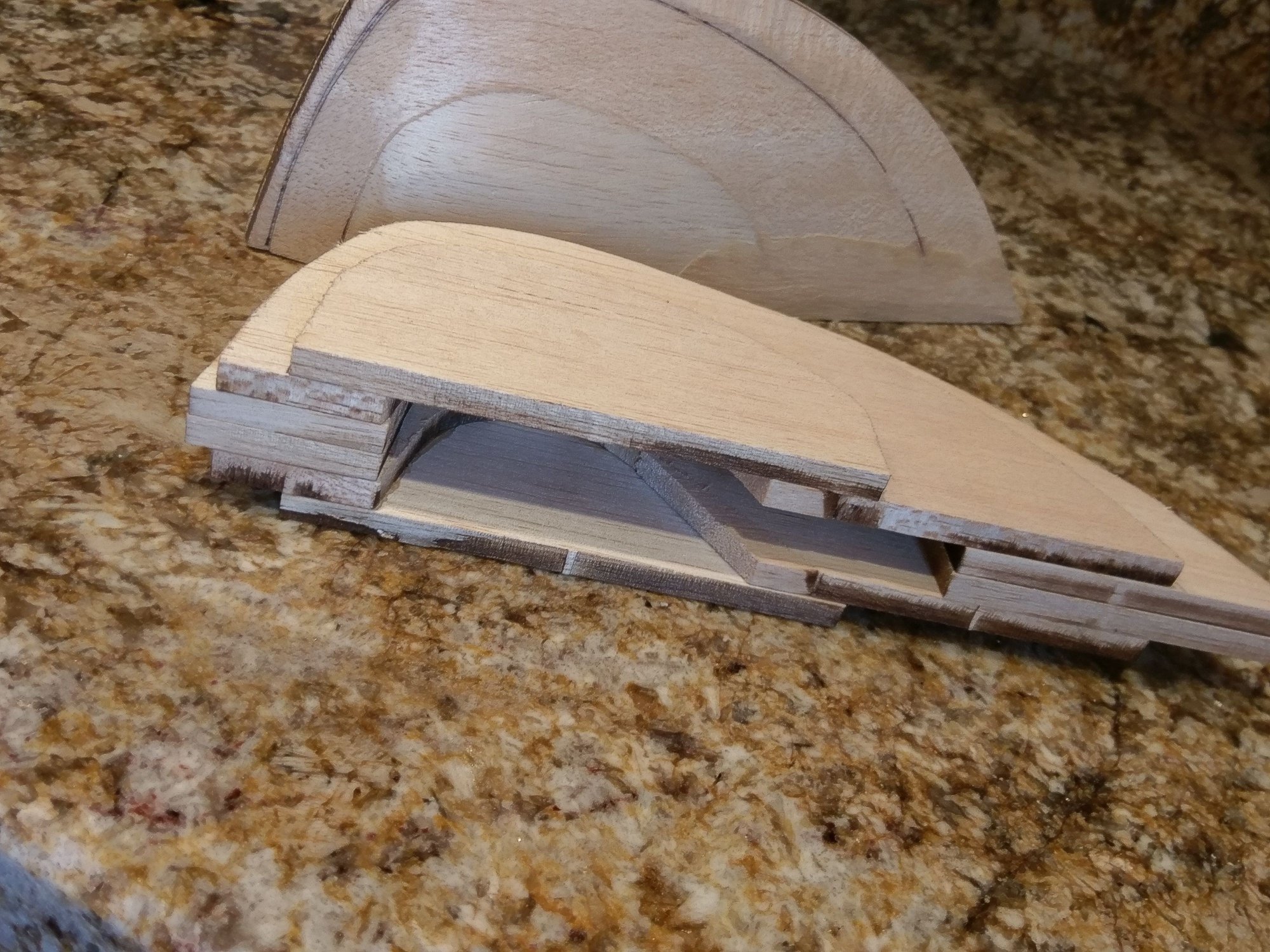

My first experience with hollow, laminated wing tips. This was actually great for installing the wing tip lights.

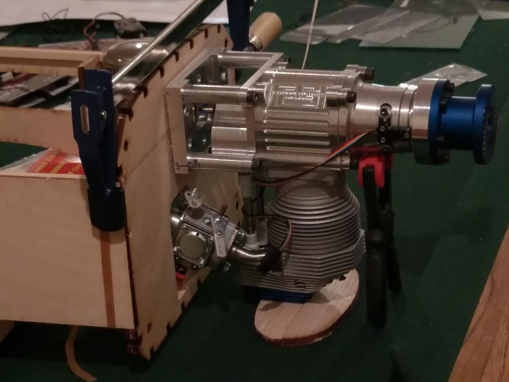

Engine

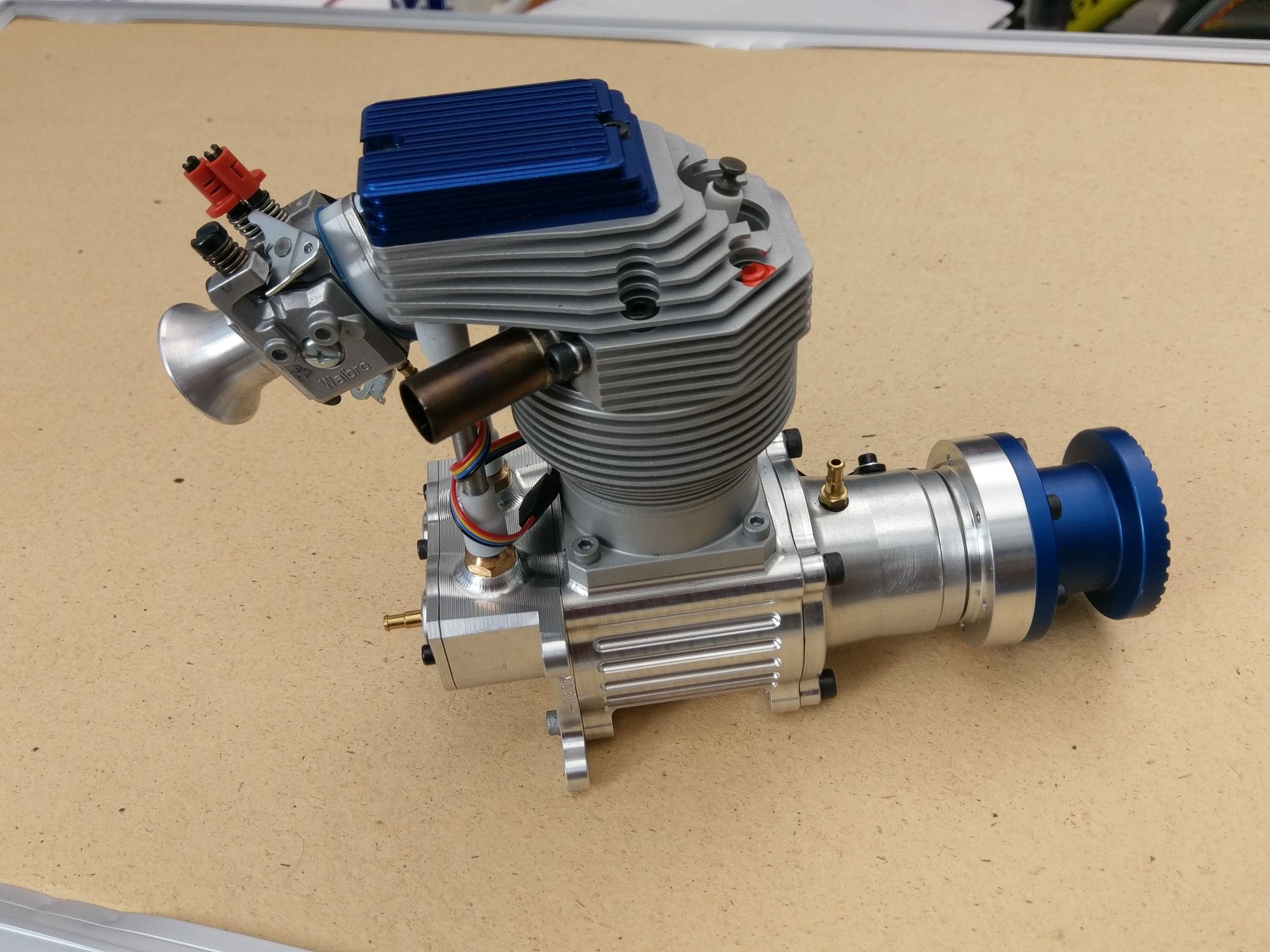

I had been wanting to purchase a Kolm for sometime, and finally managed to get one. I think it is the most beautifully made RC engine I've ever seen. To get the correct down and right thrust angles, I machined an aluminum mounting plate with standoffs. This way the standoffs sit square with the mounting lugs of the engine. With limited space in the cowl, I decided to place the muffler behind the firewall. The muffler was custom built by Zimmermann in Germany. They were very helpful. A 20 mm stainless
The twin cam Kolm 50
Aluminum mounting plate with 3 deg down, 2 deg right thrust.
Mounted in the firewall
Corner blocks to strengthen the firewall joint
Placement of the muffler
Path of the flex connecting pipe
flex line from Toni Clarke will connect the header to the muffler. I thought I'd include the resources in case someone needed such parts for a build.

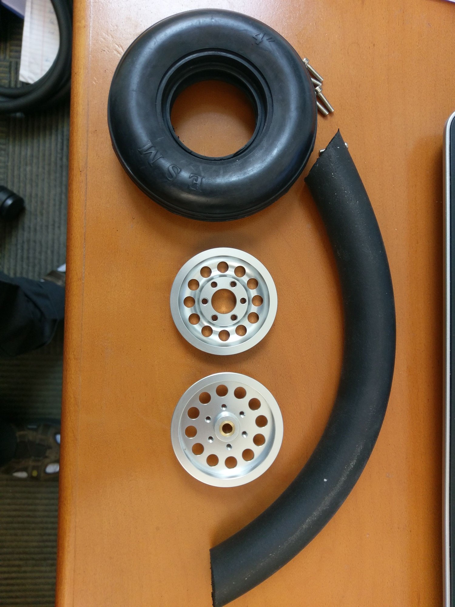

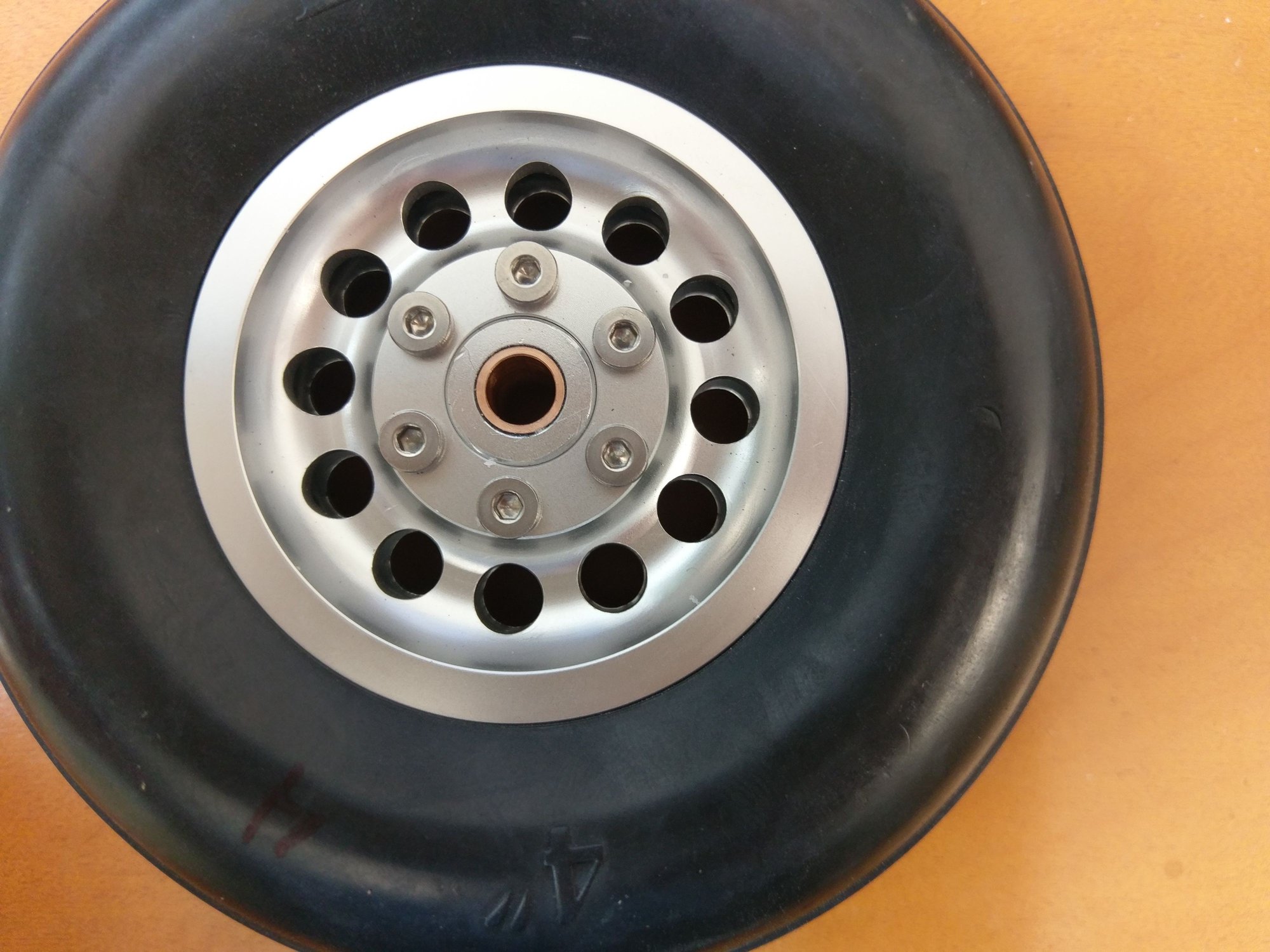

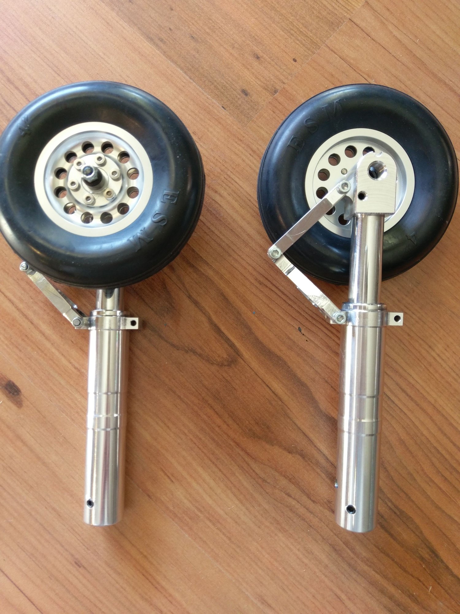

Wheels and lights: I wanted to use a nice looking set of wheels and I was a little put off by the price of the Robarts. I found a set on Aliexpress, and though I'm a little about the quality of such stuff, their reasonable price made the risk acceptable. The machining on the assembled wheels proved to be excellent, but they were rock hard. They came apart fully, so a length of closed cell neoprene hollow cord from Mcmaster in place of the original dense foam, made the wheels perfectly compliant.

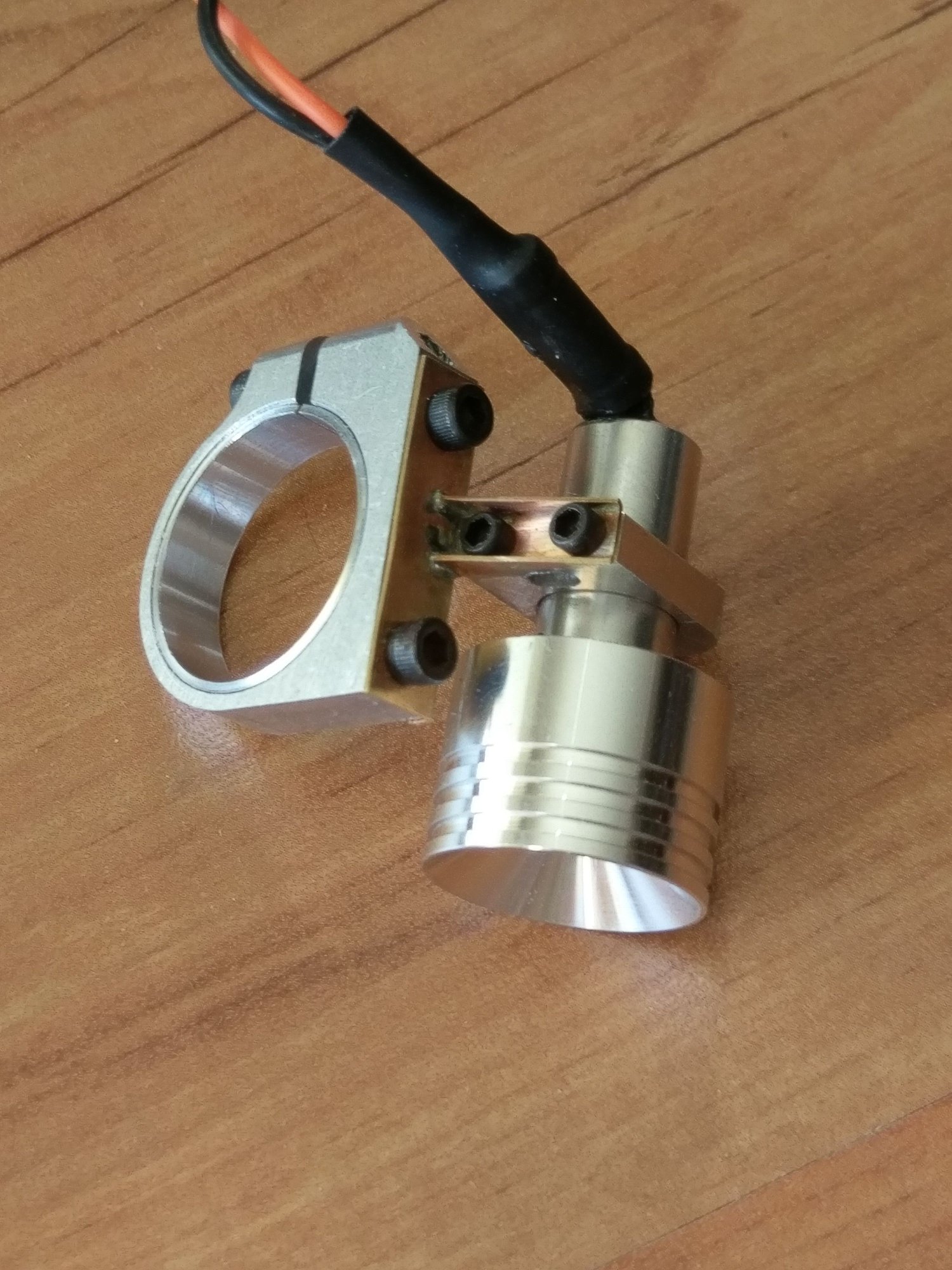

This is the first time I've installed lights. They were acquired from unilight.at in Austria, although I think Dreamworks is now an authorized retailer. I made some brass brackets for the lights to fit around the struts. At 4W with a reflector, they are very bright. The controller is very small and has several pre-programmed options/patterns.
I've not found any struts in the past that featured proper damping. The Robart and Prolink are just spring action. So I sourced these from Eurokitshop in Italy. They are fully machined, and have internal oil damping. The company actually adjusted the spring rate to match the projected weight of the CAP. They are wonderfully smooth with zero play.
Cut rectangular brass tube and silver solder = landing light mounting brackets
Landing lights with clamps
New lower durometer closed cell neoprene foam inserts
Assembled wheel with new bronze bushing reamed to 6mm
Oil damped struts
Oil damped struts
