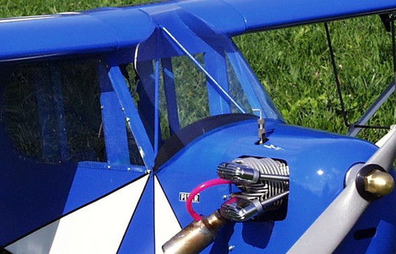

Old 09-30-2003 | 08:16 AM
LuvBipes's Avatar
Posts: 1,252
From: Gainesville, FL
Default RE: Sig 1/4 Clipped Cub (Which engine?)
With the Saito 150 I had to use a brass "heavy spinner hub" and place the battery all the way forward, up against the firewall under the fuel tank, to get it to balance. Didn't have to add any weight though.
If you're more comfortable w/ 2-strokes, by all means get the OS. Mount it inverted and use an inverted pitts-style muffler for a clean set-up. After experimenting w/ several props, I've found the APC 18X8 gives the best overall performance on the OS 160.
For a full review I wrote a while back on the Sig clipped wing Cub, go to: http://webpages.charter.net/rcfu/Kit.../SigCWCub.html

Old 09-30-2003 | 10:09 PM
Joined: Jul 2003
Posts: 43
From: Alberta, Canada
Great finishing touches on touches on the cub LoveBipes. Looks some extra work put into some detail around the cabin windows. Your engine weighs the same as the 1.60 FX so this sounds like a good choice, it won't have that scale like sound like your Saito but will definitely have some power, maybe too much, or is there such a thing. I also picked up some tips in your article that I can still apply mine as it is not completed yet. I have scratch built a few birds so I haven't found the cub to bad to build. After seeing those pics of yours makes me want to get mine done. The bad news is everything is packed away right now as I'm about a month away from moving into my new house. The good news is its on 80 acres of land where I will soon have my own private runway to fly on. Thanks again for the tips.

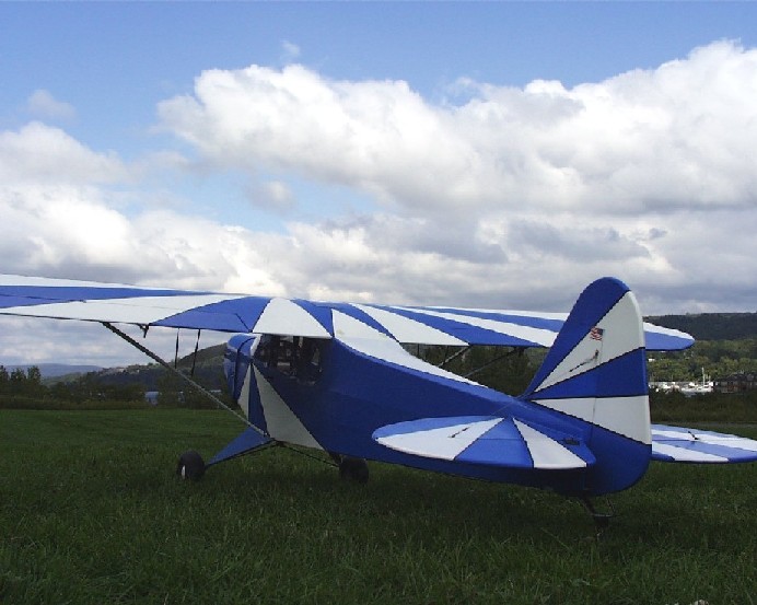

Old 10-01-2003 | 07:48 AM
LuvBipes's Avatar
Posts: 1,252
Yeah, I kind'a had a love/hate relationship w/ the Sig Cub until it was done. Now it's one of my favorite planes. It has about 100 flights on it and has proven top be very sturdy and reliable. It does a very pretty flat spin at full power and full opposite aileron once in the spin. It stops rotation within 1/2 turn by neutralizing ailerons/elevator and reversing rudder.
An interesting thing is that using standard servos (one for each control surface, except rudder) has proven adequate. I fly mainly IMAC/Pattern type planes, so usually push the Cub around quite aggressively, yet the standard servos have been up to the job.
Here are a couple more pics to keep your juices flowing.....
