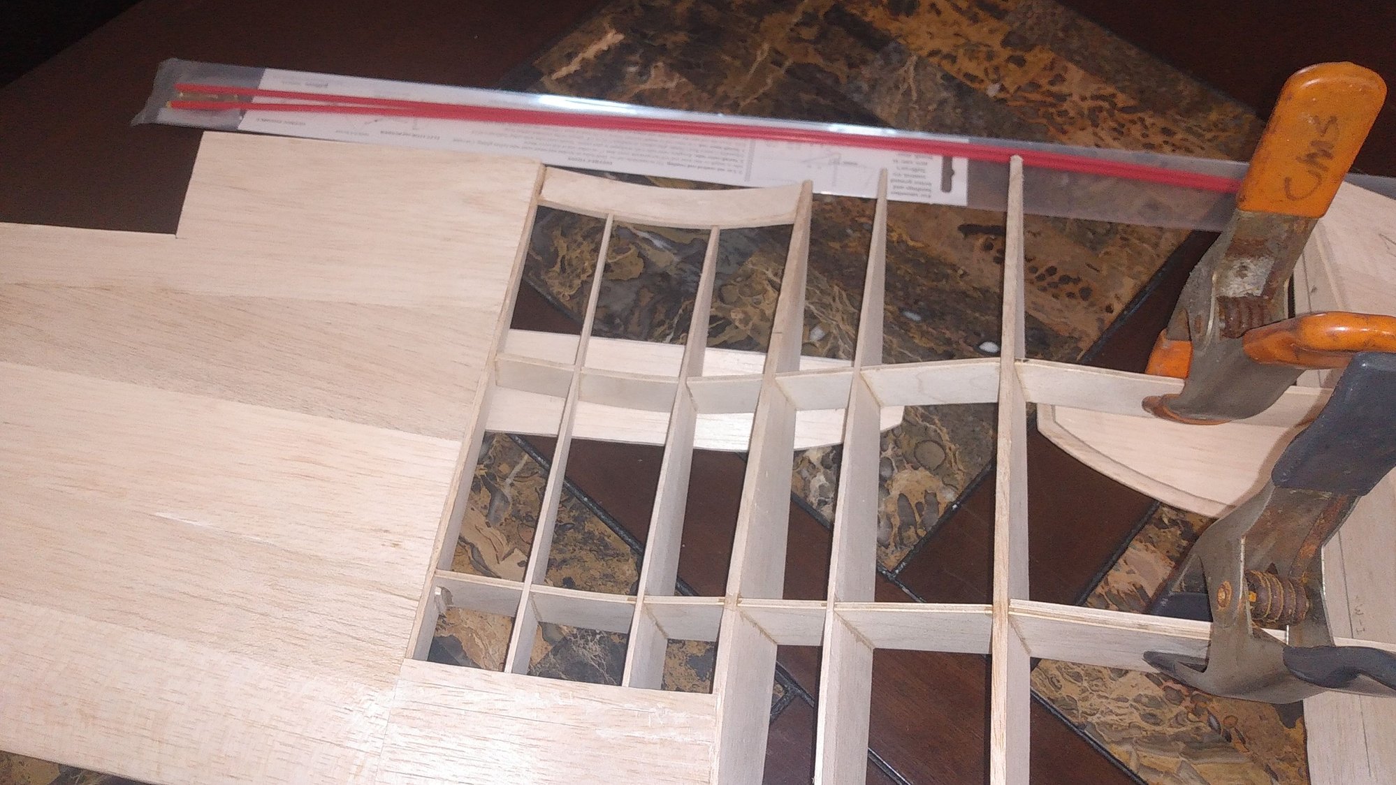

I'm doing a ton of fitting simply for the fact that I'm hand cutting every piece. So far, it's all fit very well, only had to trim a few small areas. The articulating lighted magnifying lamp I got is worth it's weight in gold when using the scroll saw!
Wondering what you all use for fixturing. As far as leveling and squaring the spars and such. I have a piece of 1/4 plate that's unbelievably super flat. I was thinking about tacking a couple pieces of 3/4x3/4 angle as uprights and clamp to them. Then, I could set the dihedral and square off of that.
Does anyone see anything in the pics that I should do differently? What adhesive should I use on the ribs to spar connection? I did use Bob Smith Industries 30 min epoxy for the wing spar splices. Thanks for any help.

I hope it's OK asking questions as I go on this thread because I'm gonna have a few. I'm now working on the ailerons and I'm confused. In the image, the arrow pointing to the left that the words "Cut on this line", to which line is this reeeeeeeeeeeeeeeeeeeeeeeeeeeeeeeeeeeeeerrrrrrrrrrr rrrrrrrrrrrrrrrrrrrrrrrrrrrrrrrrrrrrrrrre referring? I see dotted lines on the plans for the ailerons also but the line locations don't make sense to me. I cannot figure out where to cut.
Cut at the forward dashed line, and bevel the bottom to the aft dashed line. If you look closely at the aileron cross-section, it shows this bevel.
Your craftsmanship looks really good! I hope this helps.
The aileron has to be cut back all the way to front side of W25. Notice in the aileron construction detail that W25 attaches to the ribs after the cut.
Now the front of the loose aileron has to cut back to make room for the leading edge pc W26. This is also shown in the aileron detail section. The front of the aileron will have an angled cut. The two dashed/hidden lines show where to cut the top and bottom of the aileron to achieve the desired angle before glueing leading edge W26
