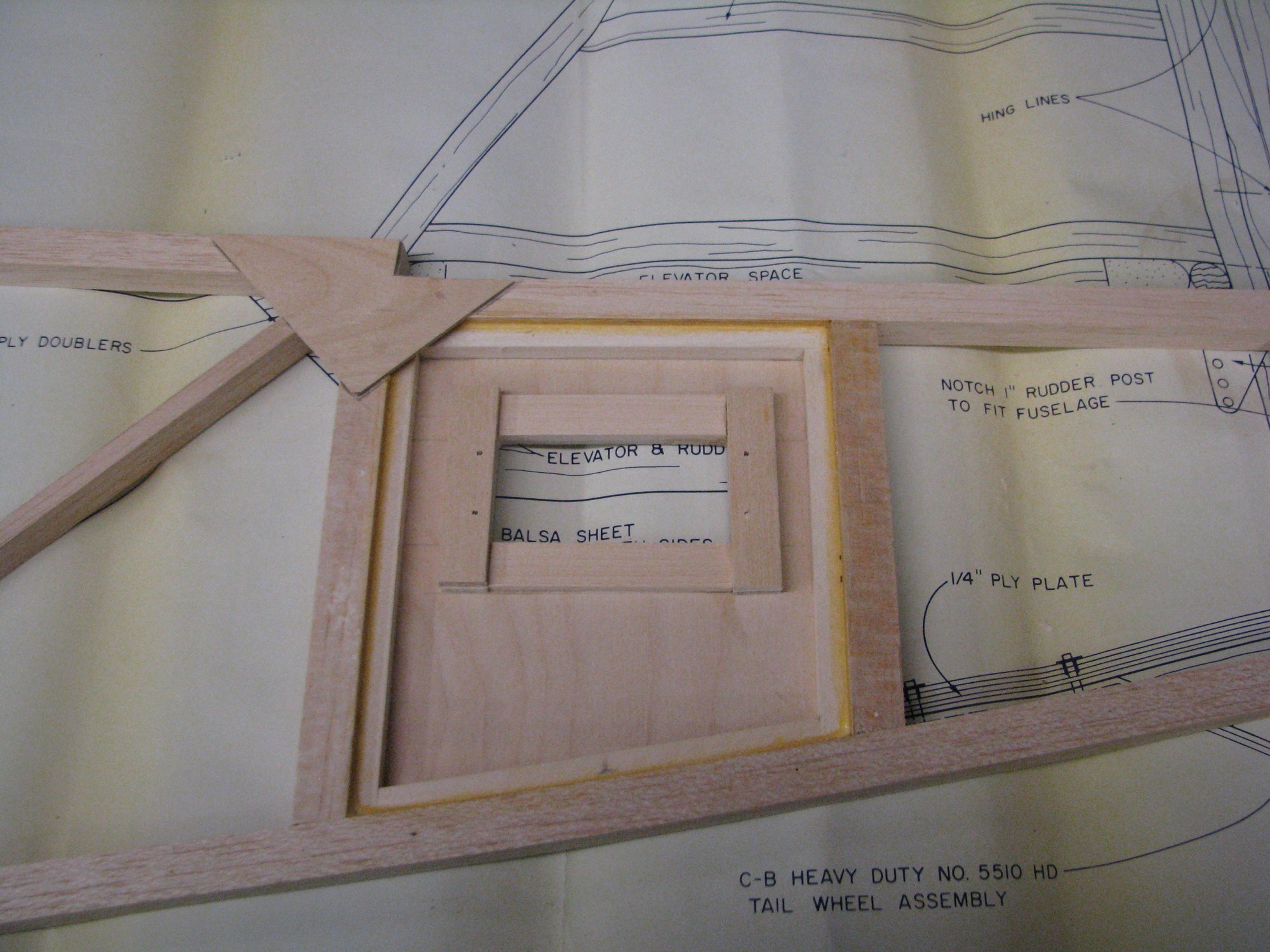

I been working on the fuselage this week. One of the changes I made was to change all the 1/2"x1/2" balsa to plywood around the cabin window's and also the wing saddle was changed to plywood as well. Also added hard wood along the base of the windows. The rear of the fuselage I made plywood servo mount. Everything to cut for the other side of the fuselage but the plywood is warped. Trying to get it flat by running hot water on it and putting weights on it. If that does not work I will have to order new plywood.

All of the extra reinforcement done. The firewall drill out for the OS F240 Gemini.
Sheeting and windshield frame completed.
Starting to look like a Robinhood.
