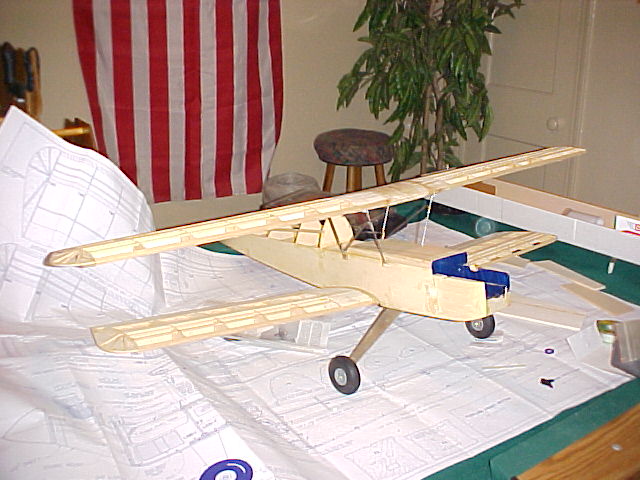

For those interested, a few construction pic's.
ID:	65218   Click image for larger version
