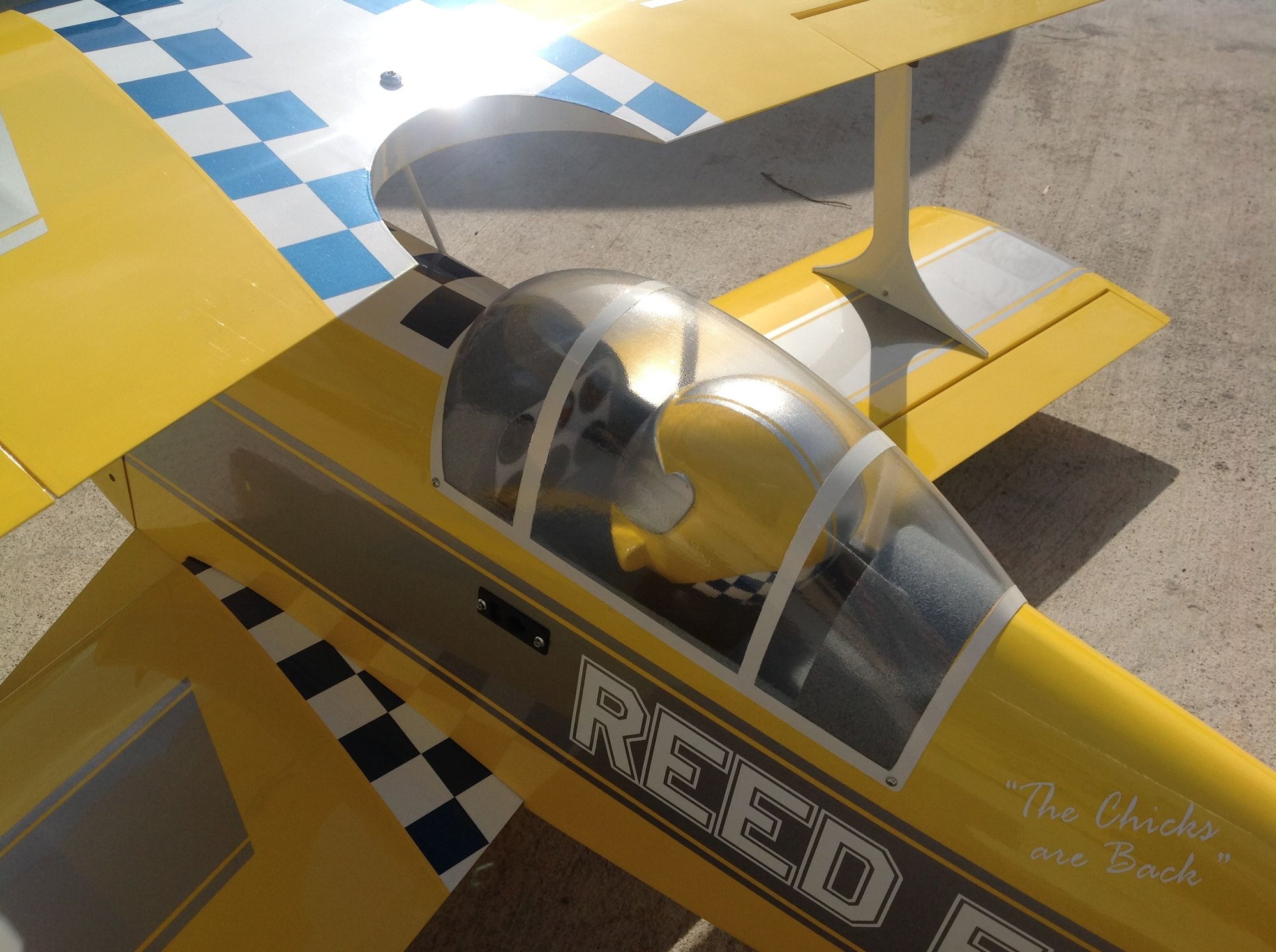

I've been doing it for years. I first glue the canopy in place with canopy glue and then trim the edges with a strip of covering material about 3/8" wide. A trim iron is best for this but a regular sealing iron can be used too. I think this makes a very clean looking installation.
Wow, that is some beautiful work. You should do a video for us mere mortals.....
