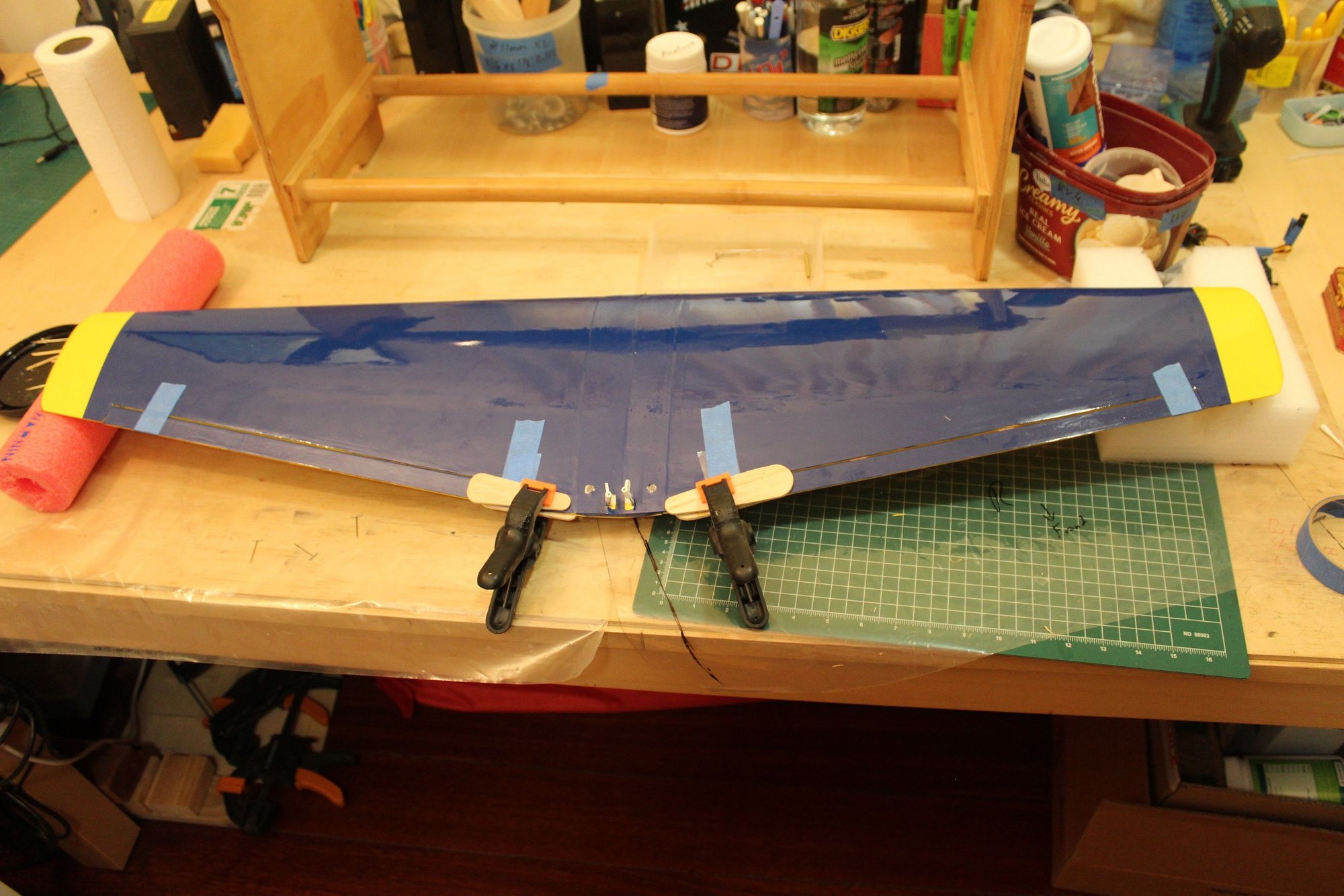

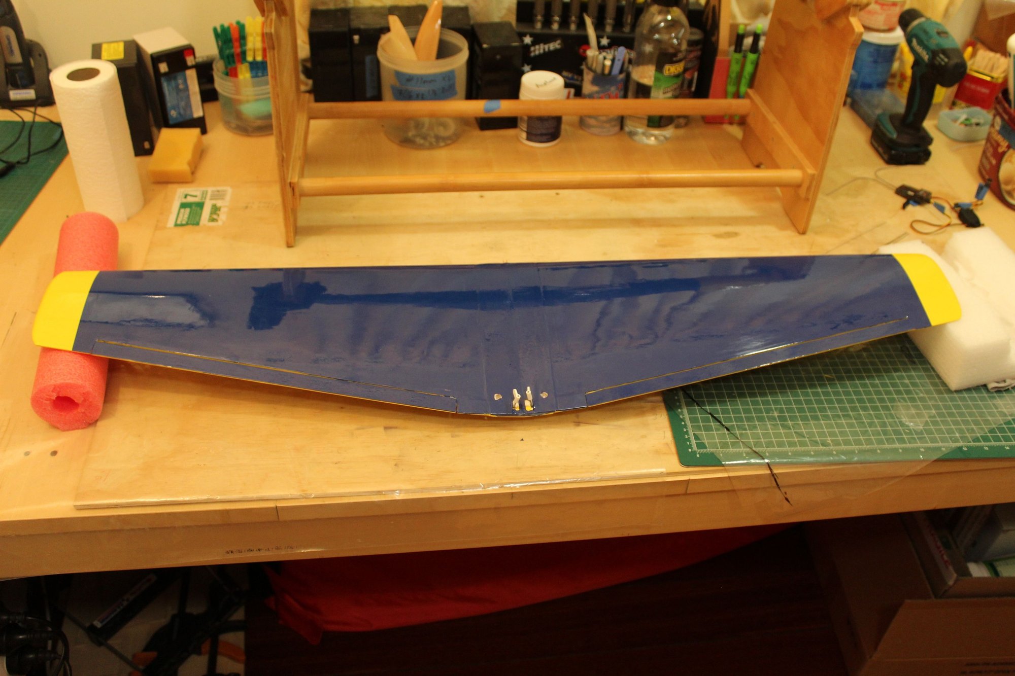

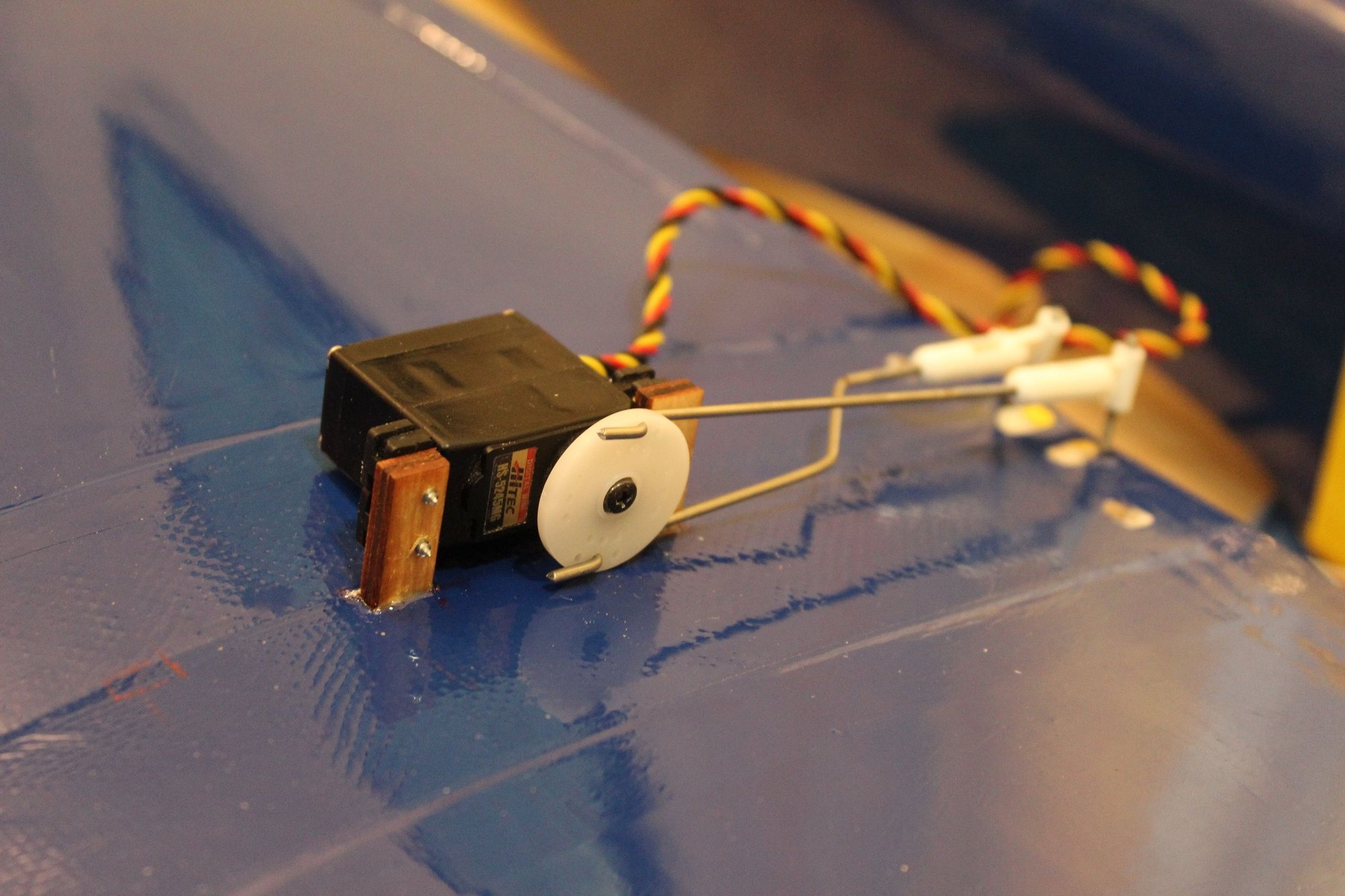

Ailerons

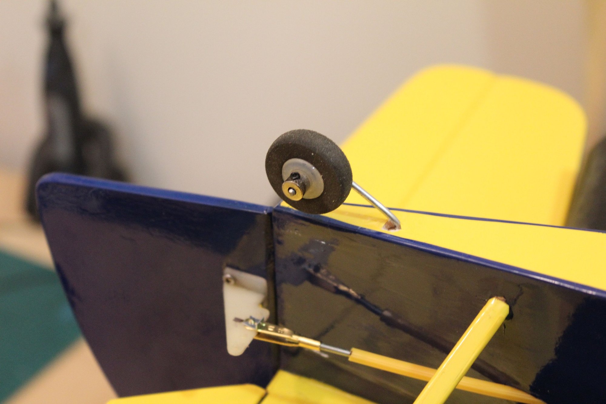

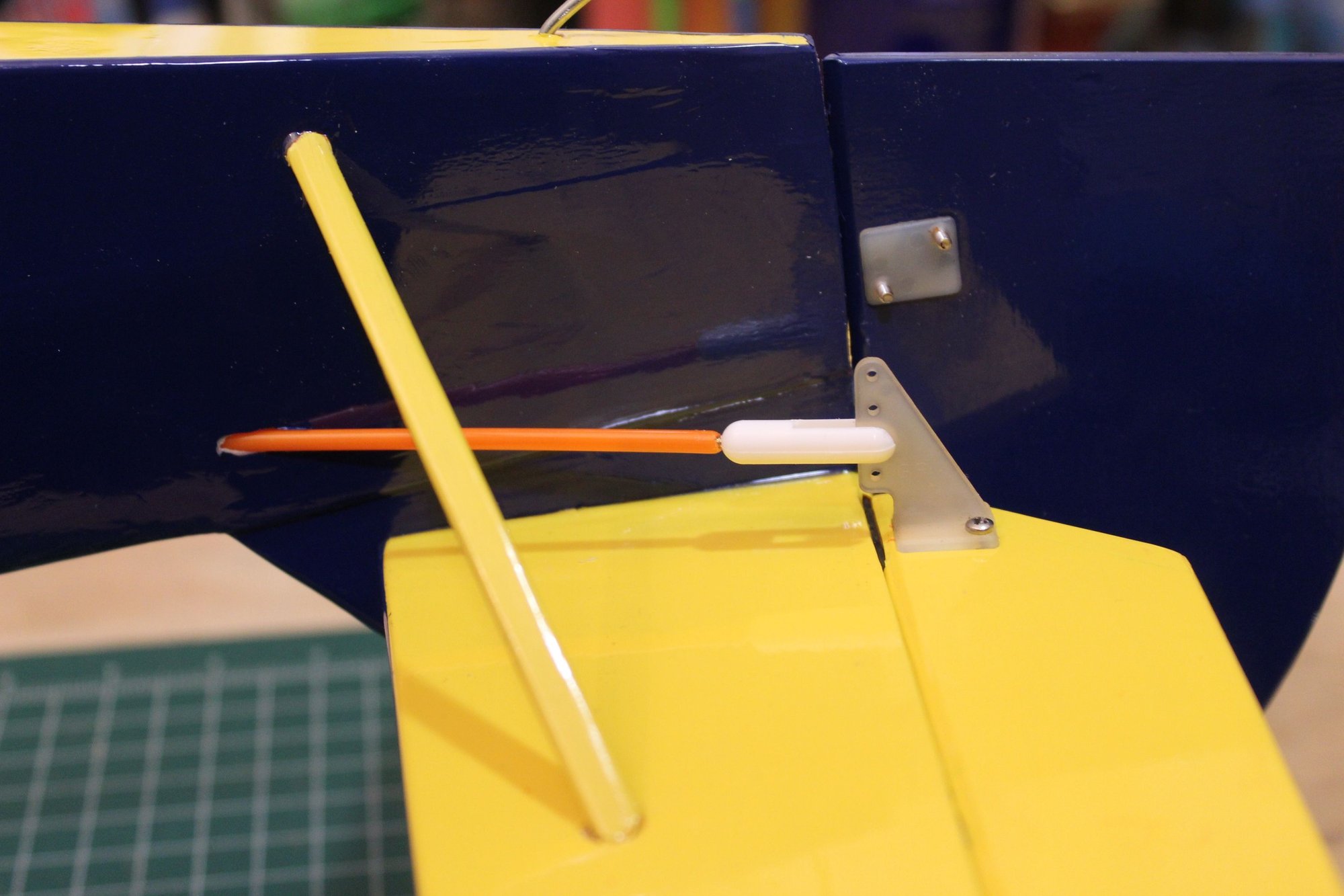

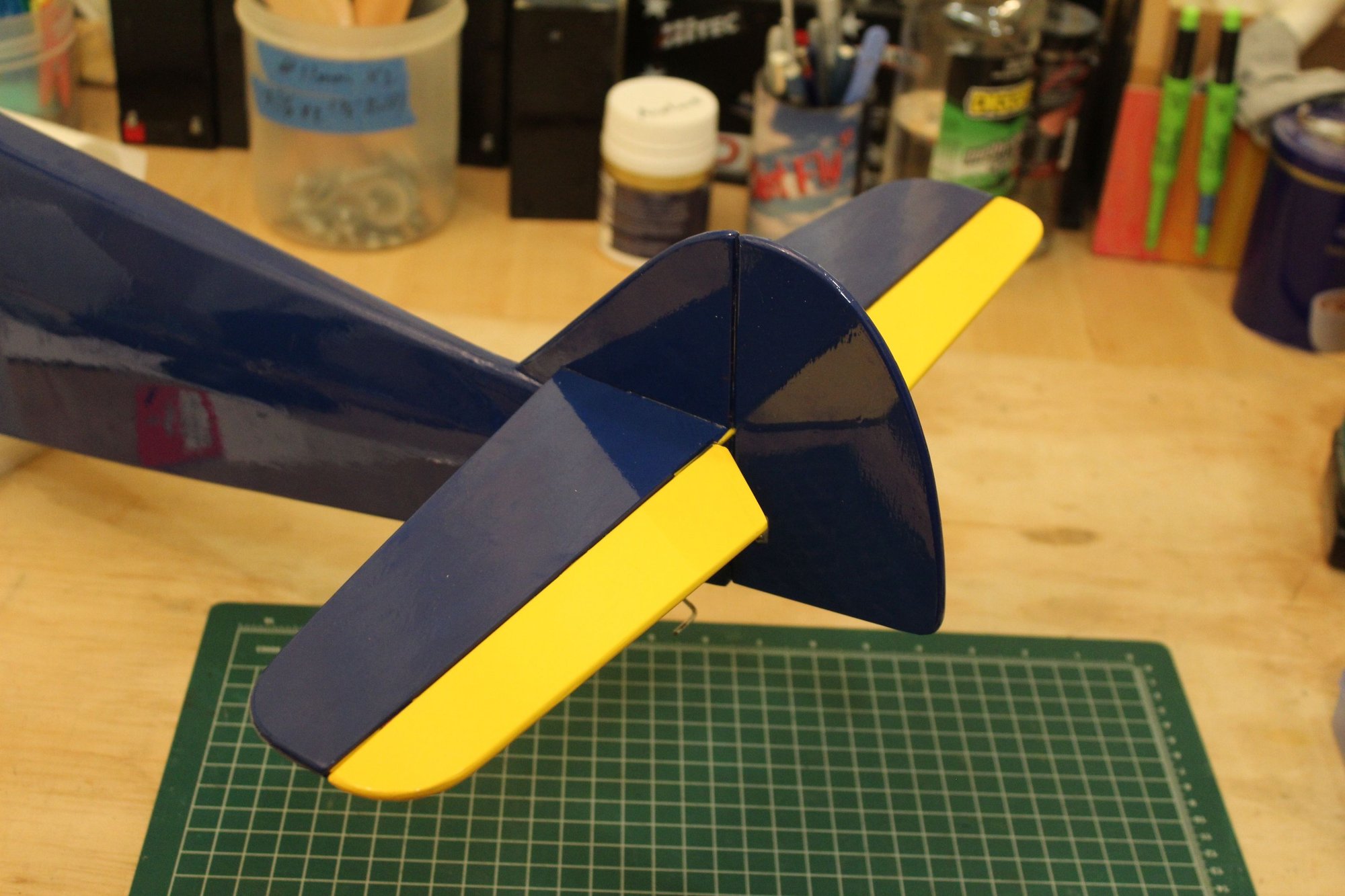

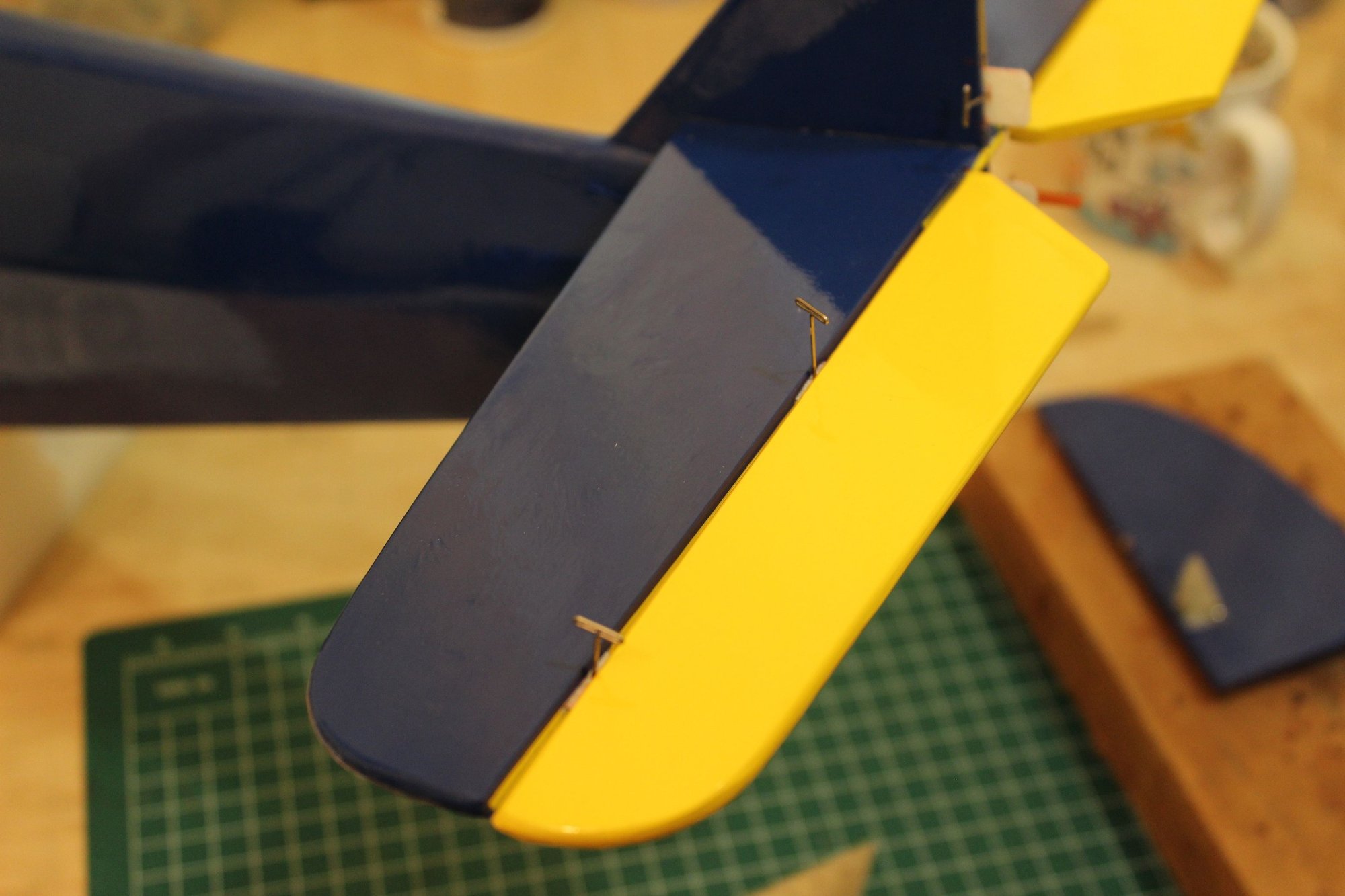

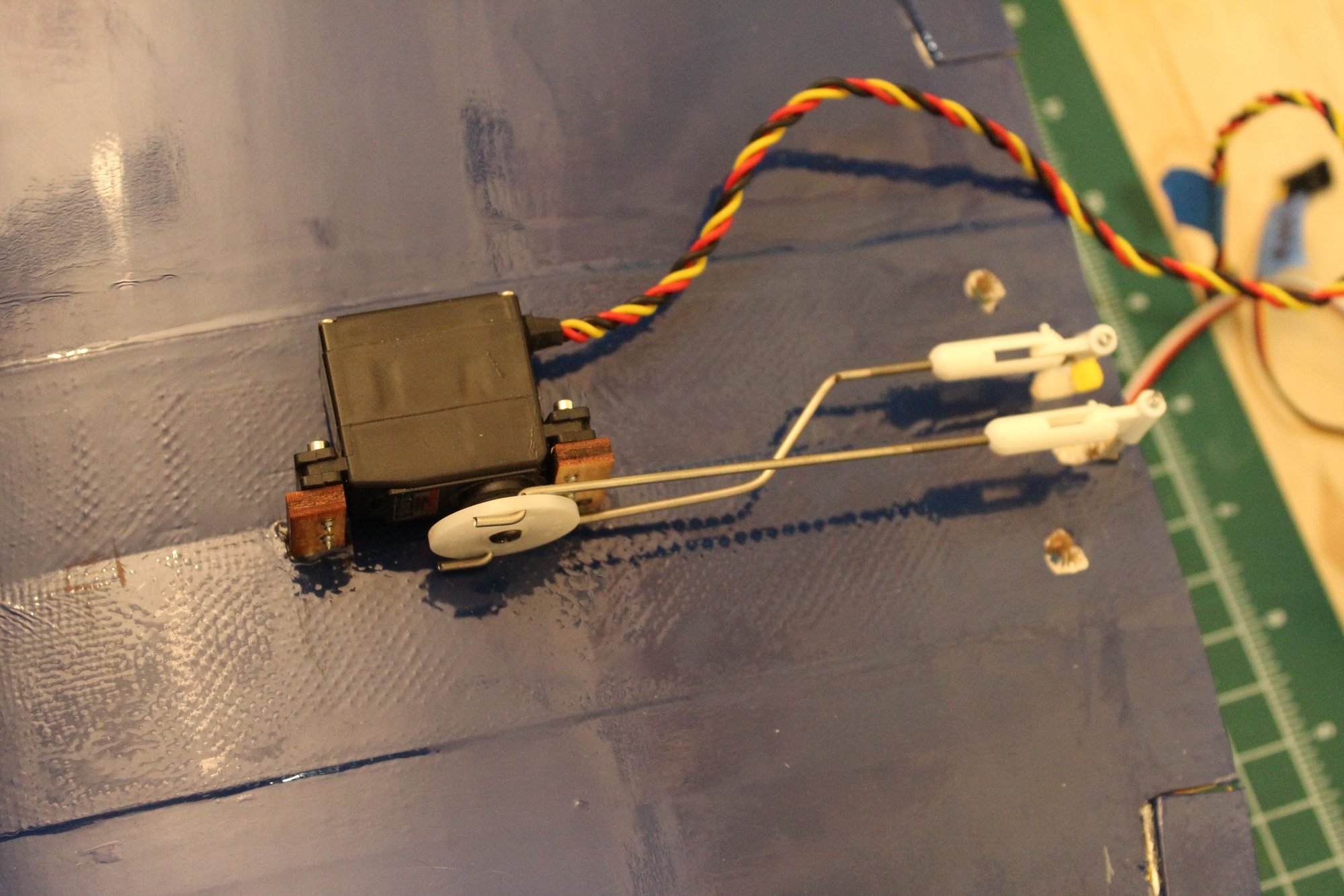

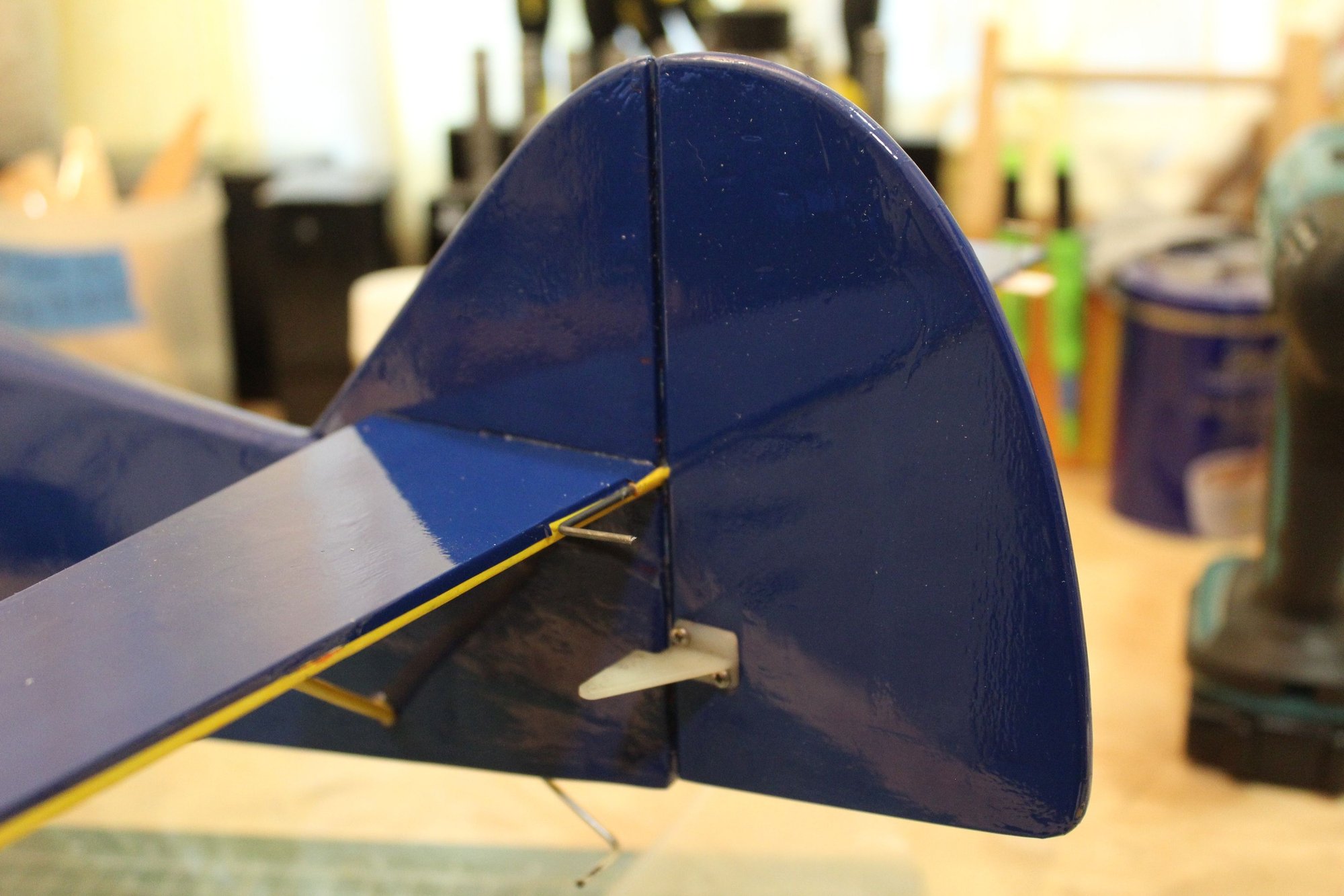

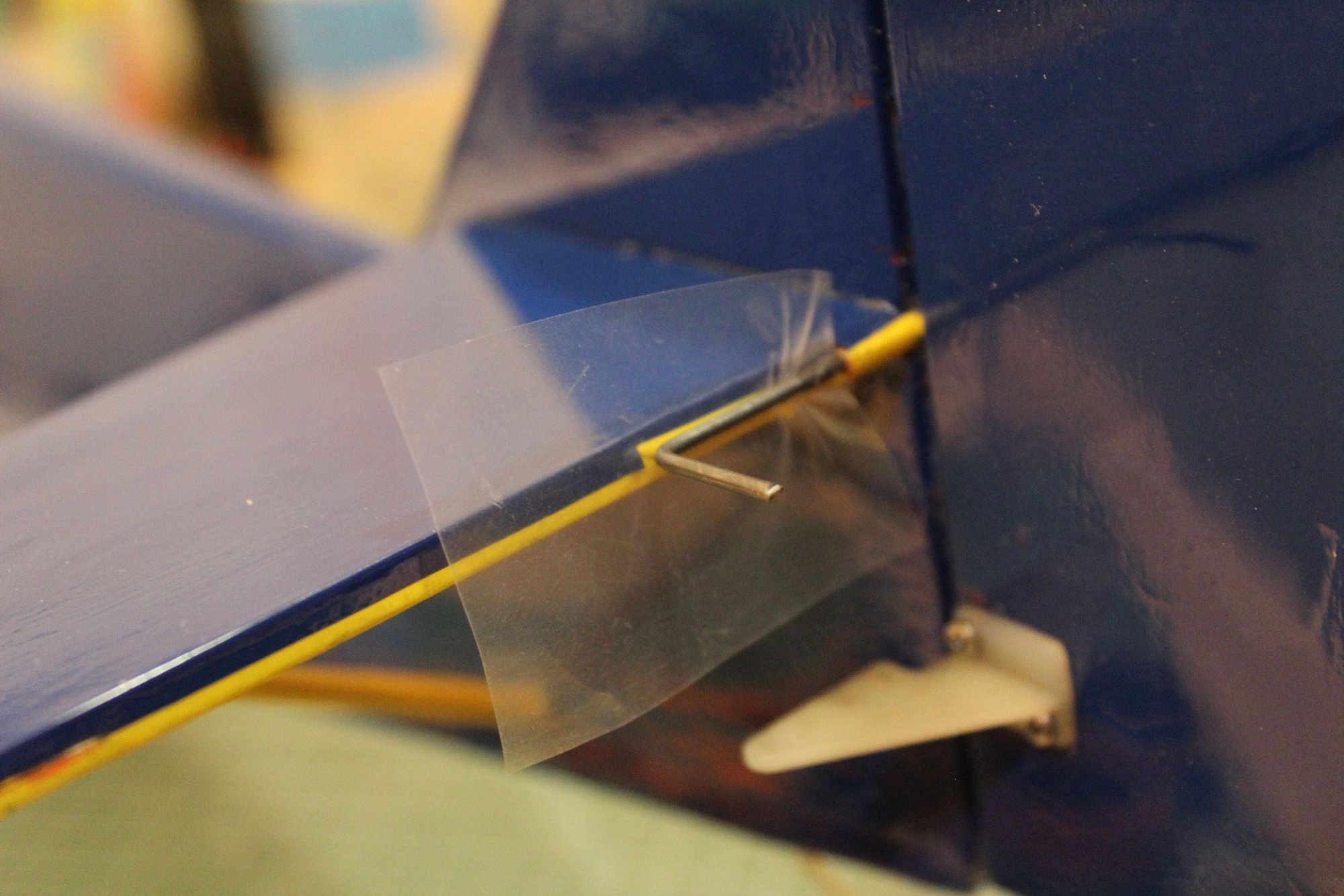

Rudder and elevators

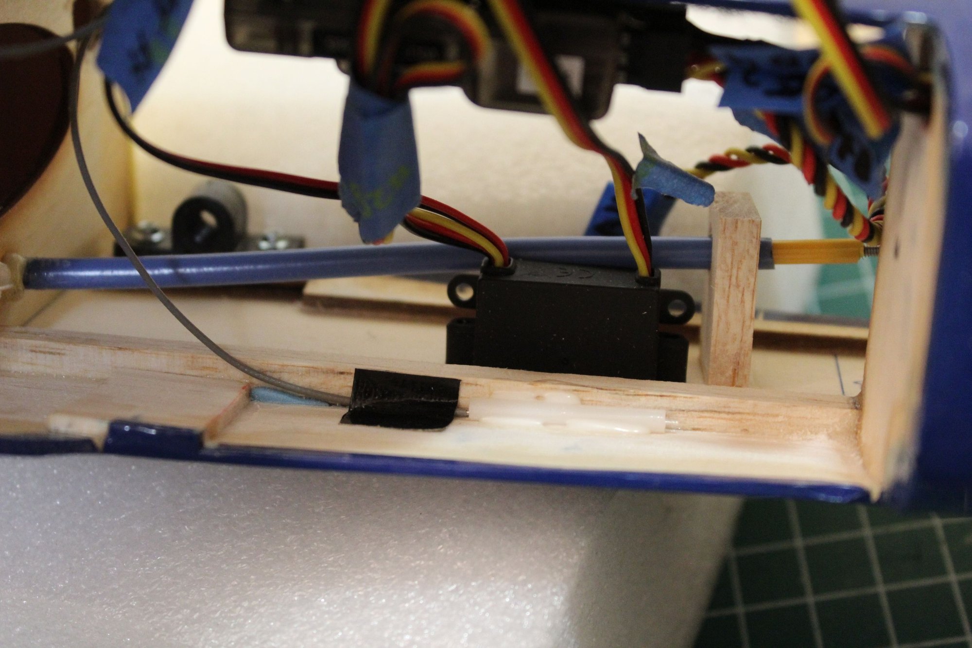

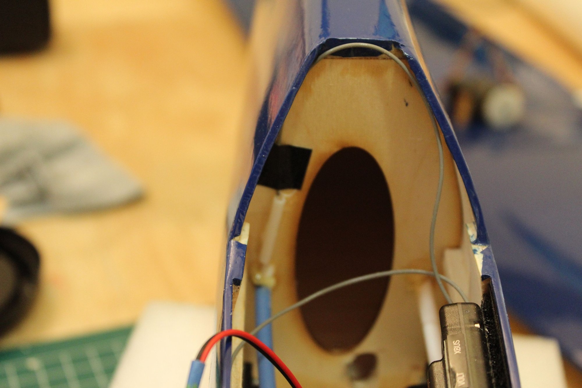

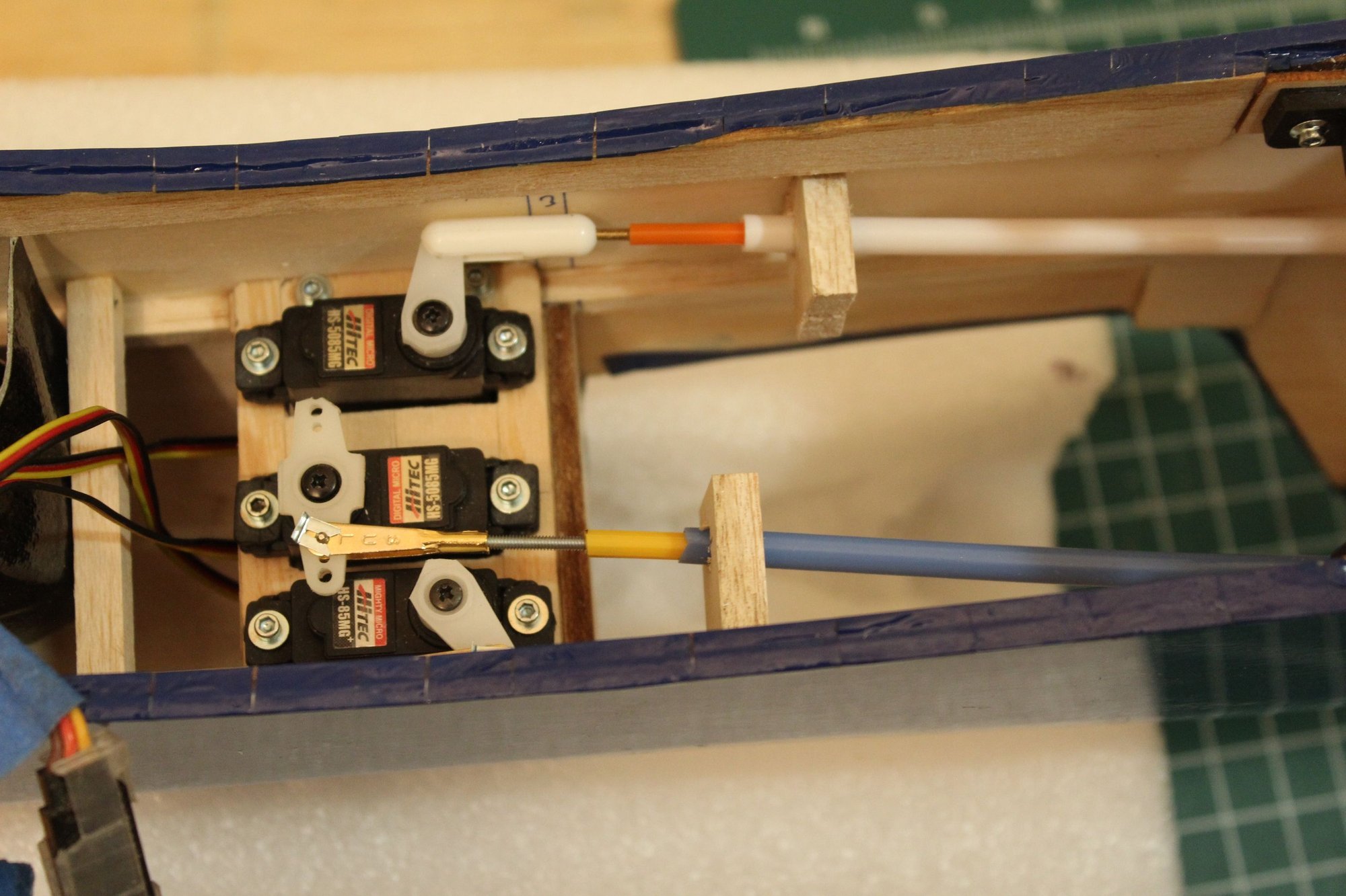

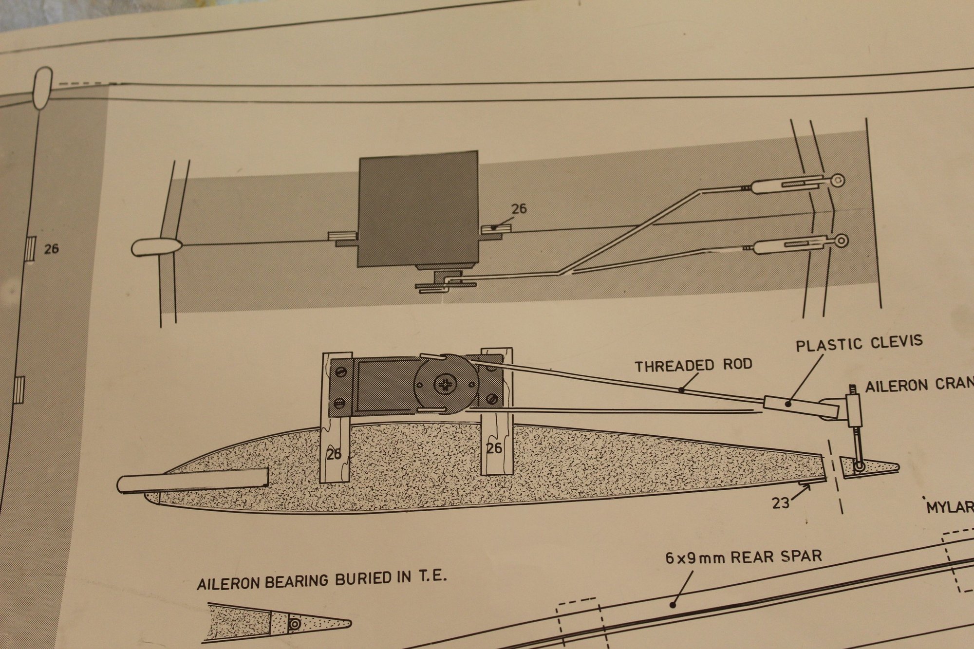

linkages. Note the hole cut into the former in the last photo to allow the aileron control enough movement.

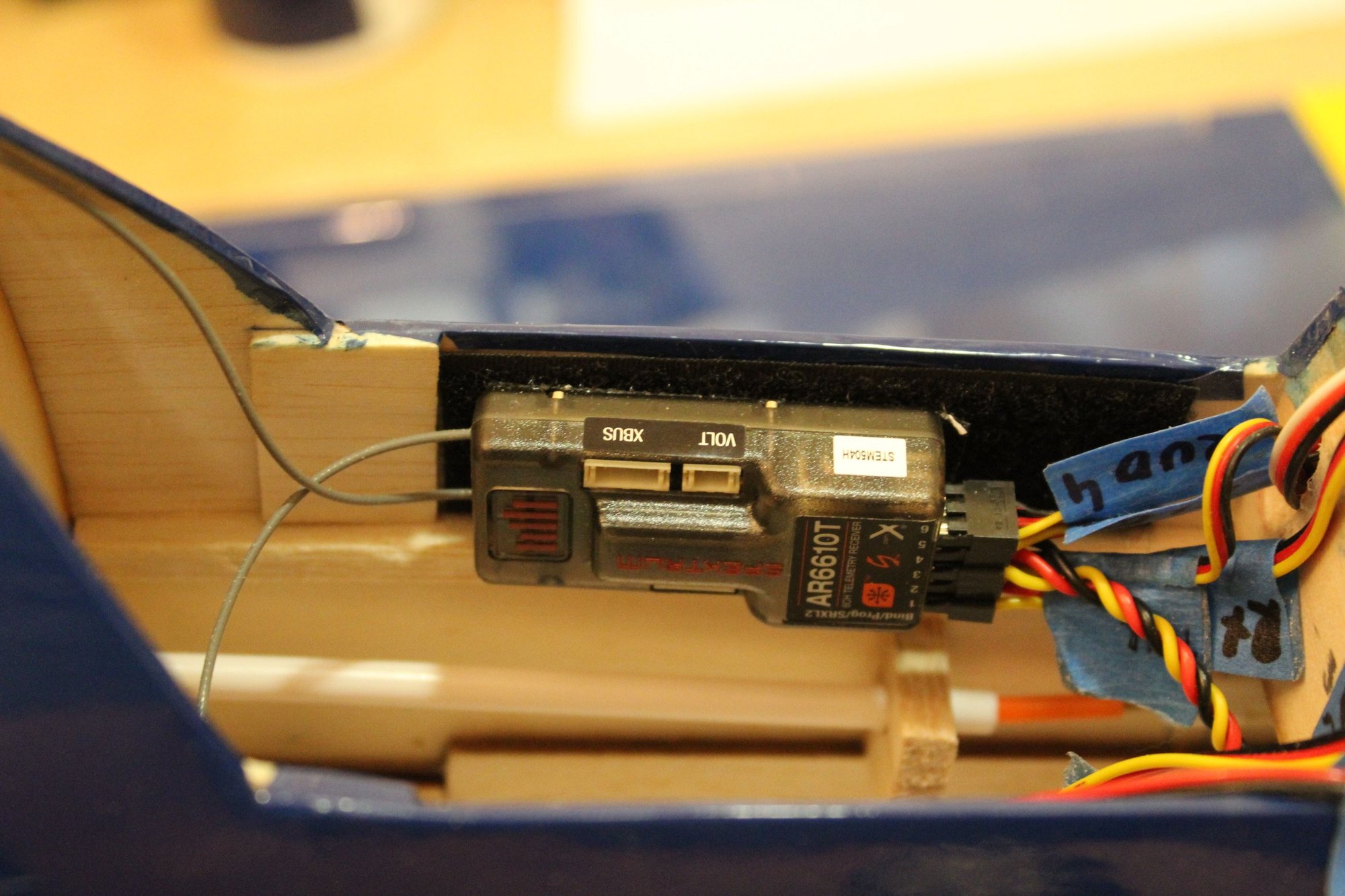

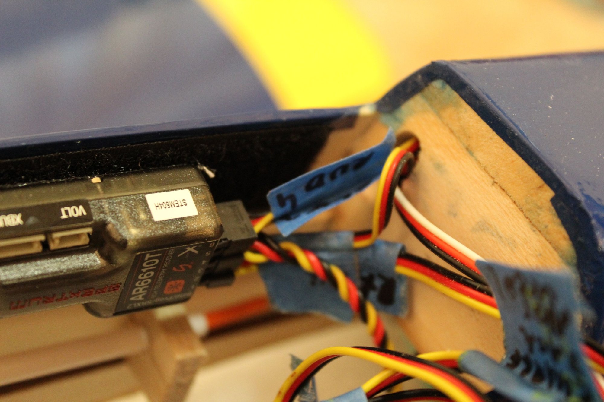

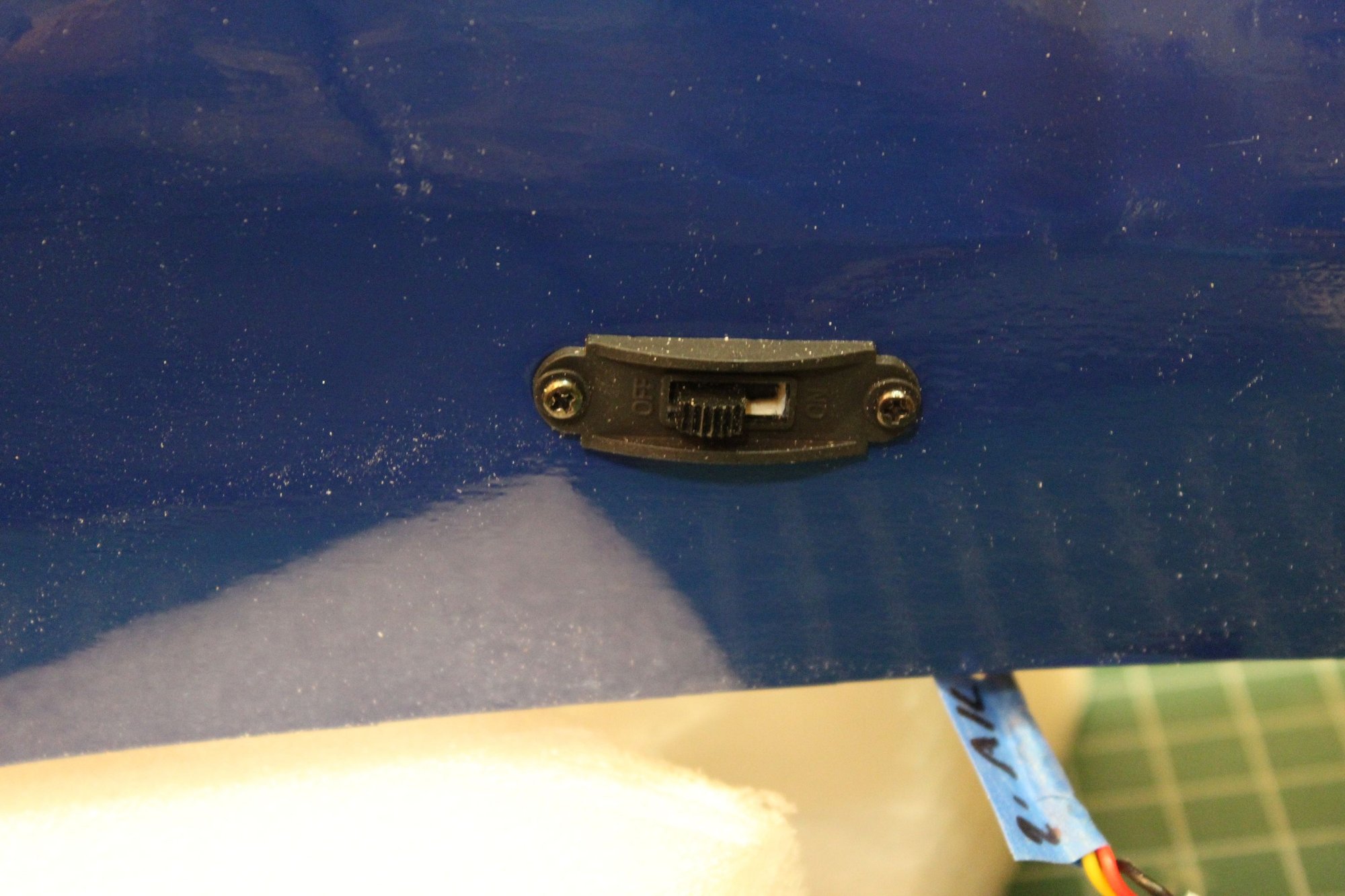

Radio gear

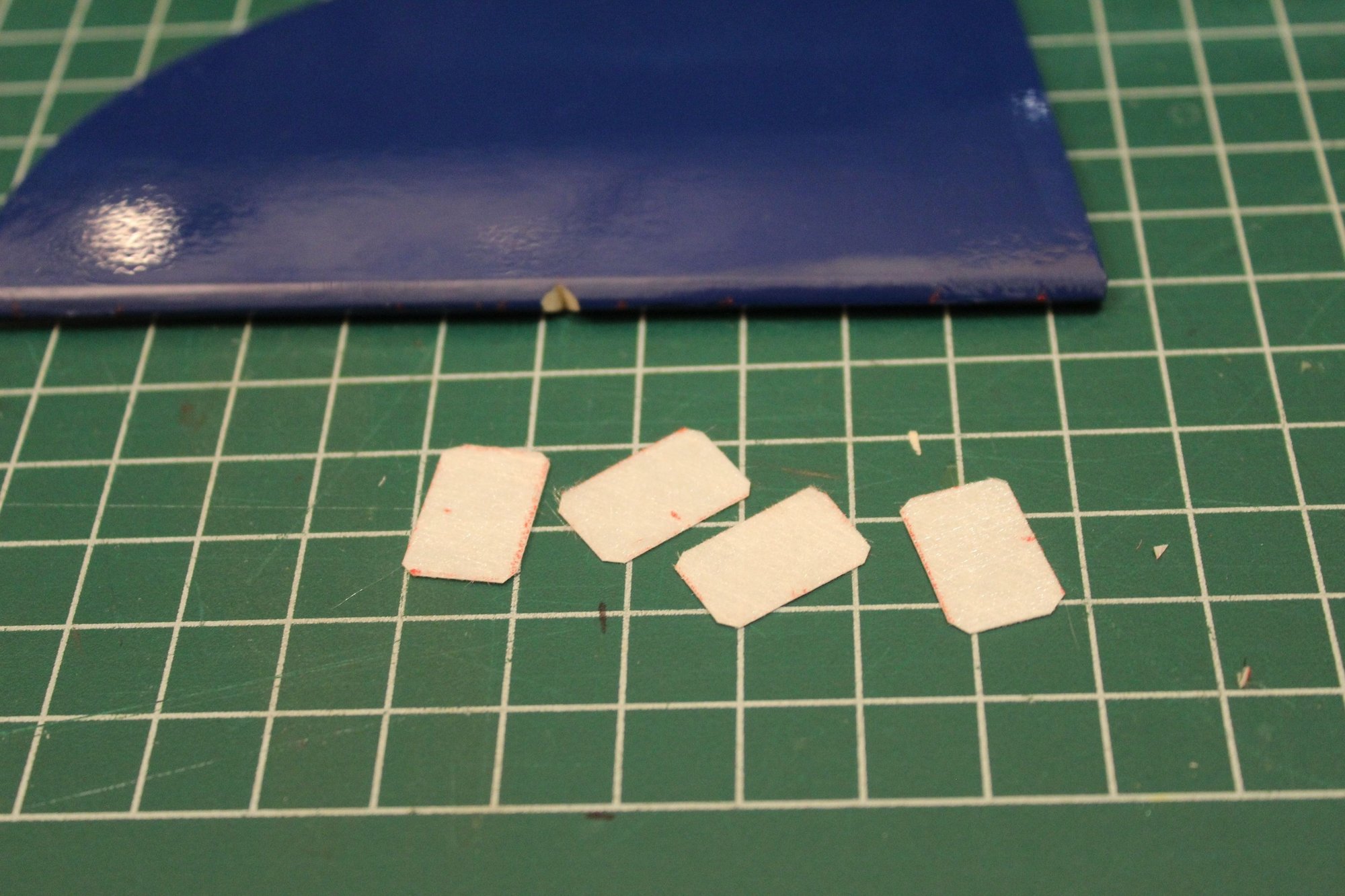

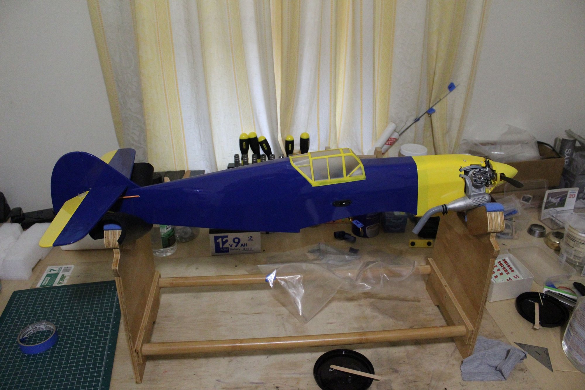

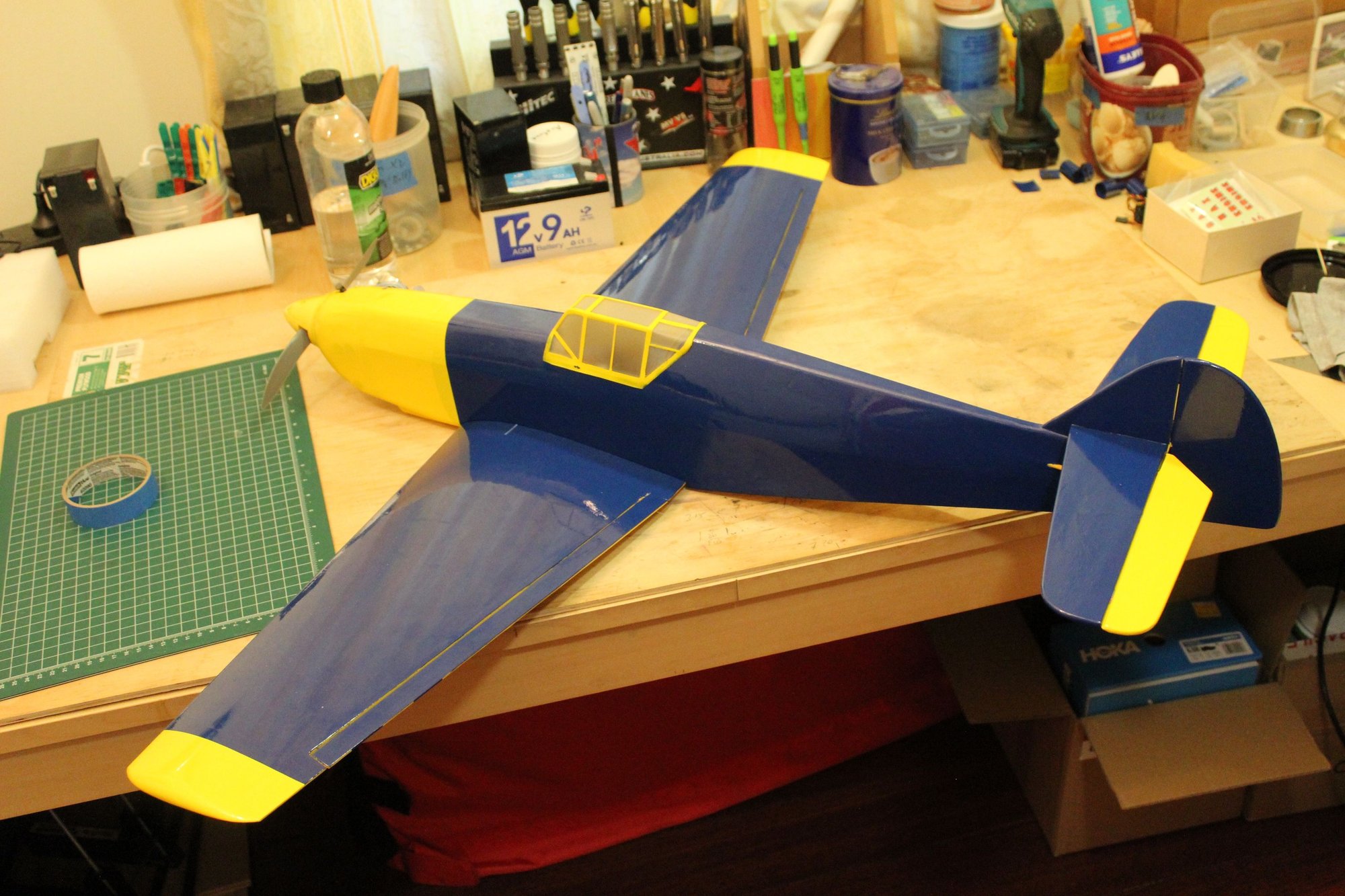

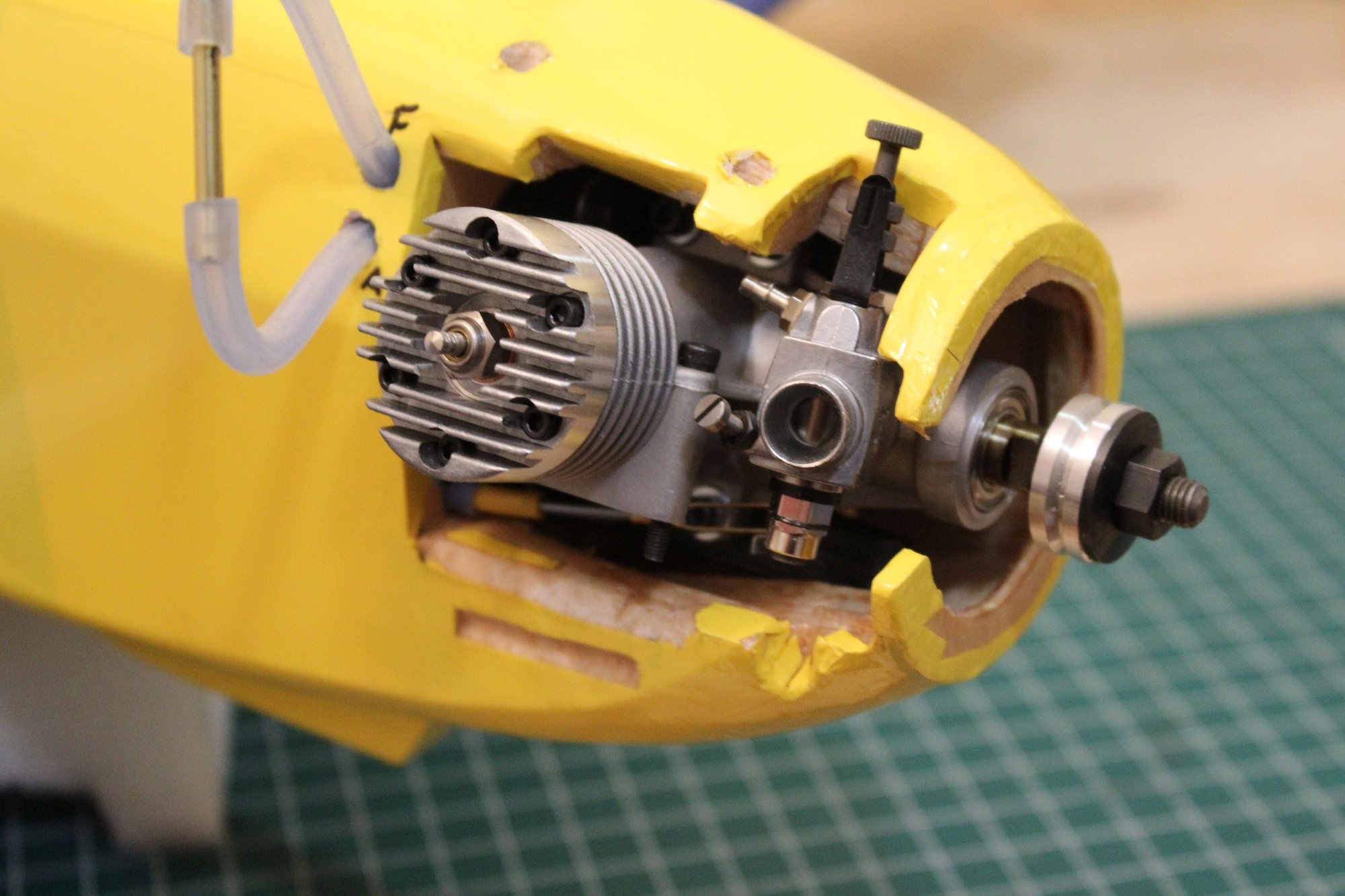

Covering the engine mounting holes, fitting the tail wheel and adding stripes to the bottom of the wing

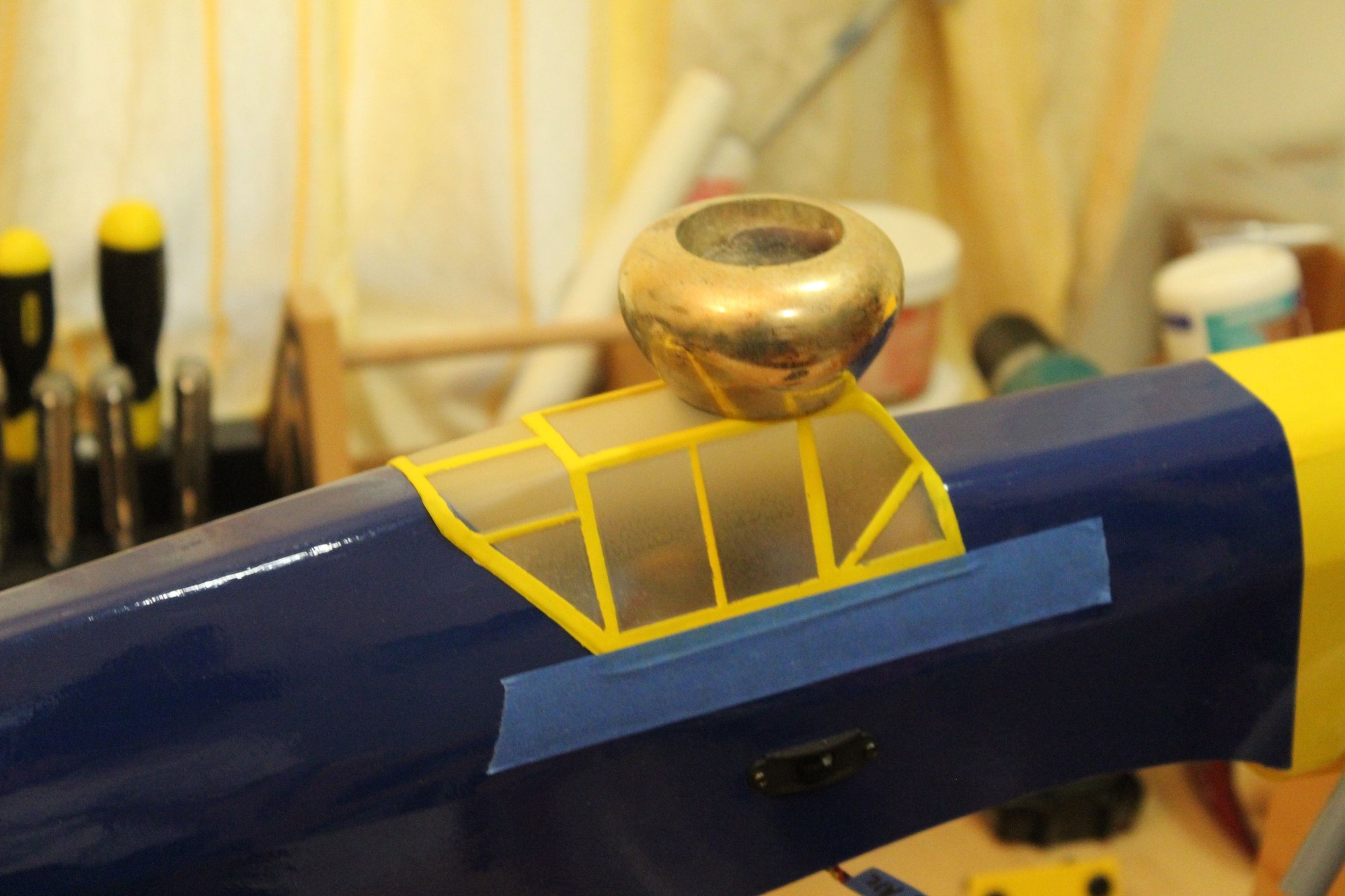

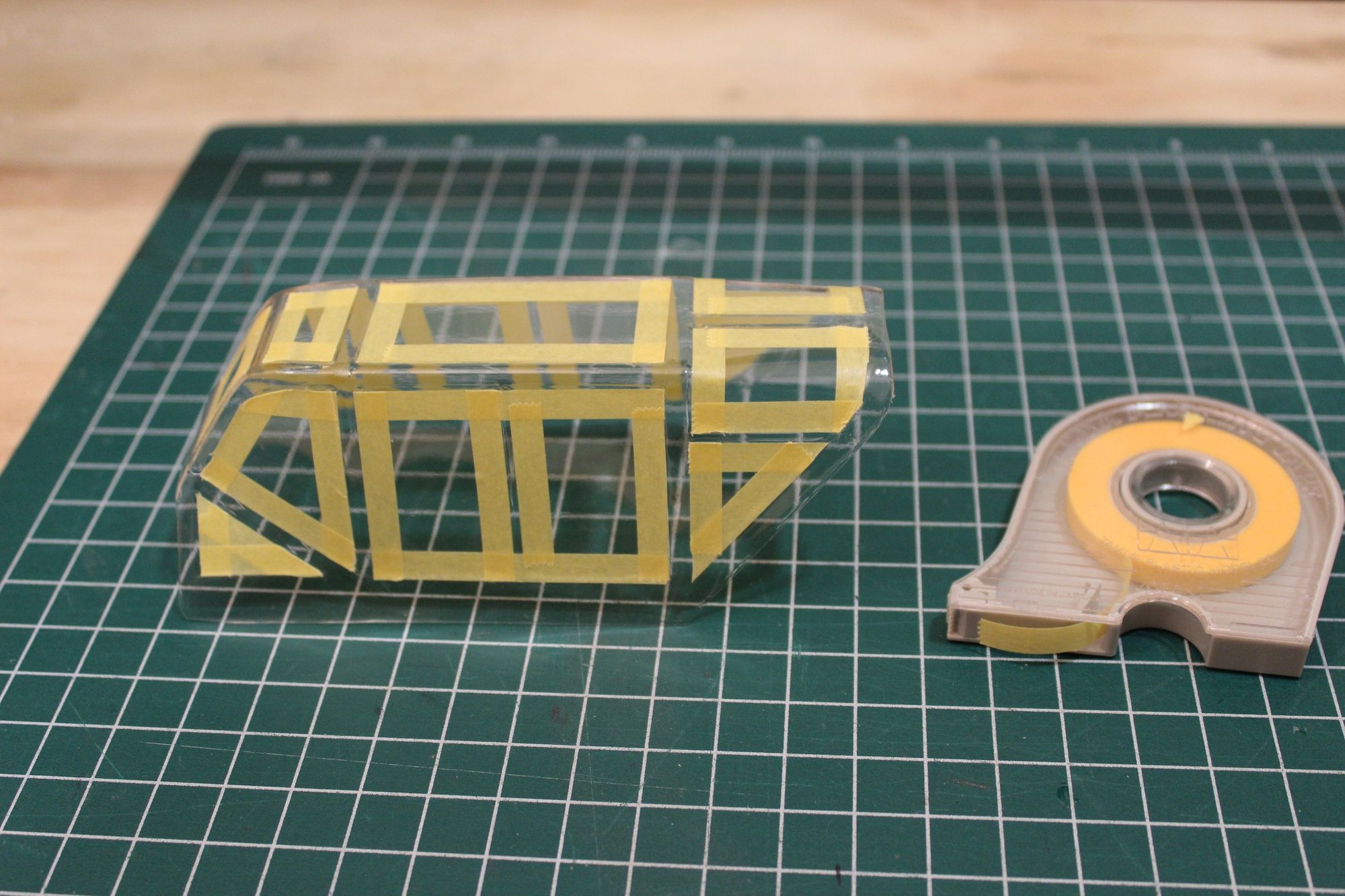

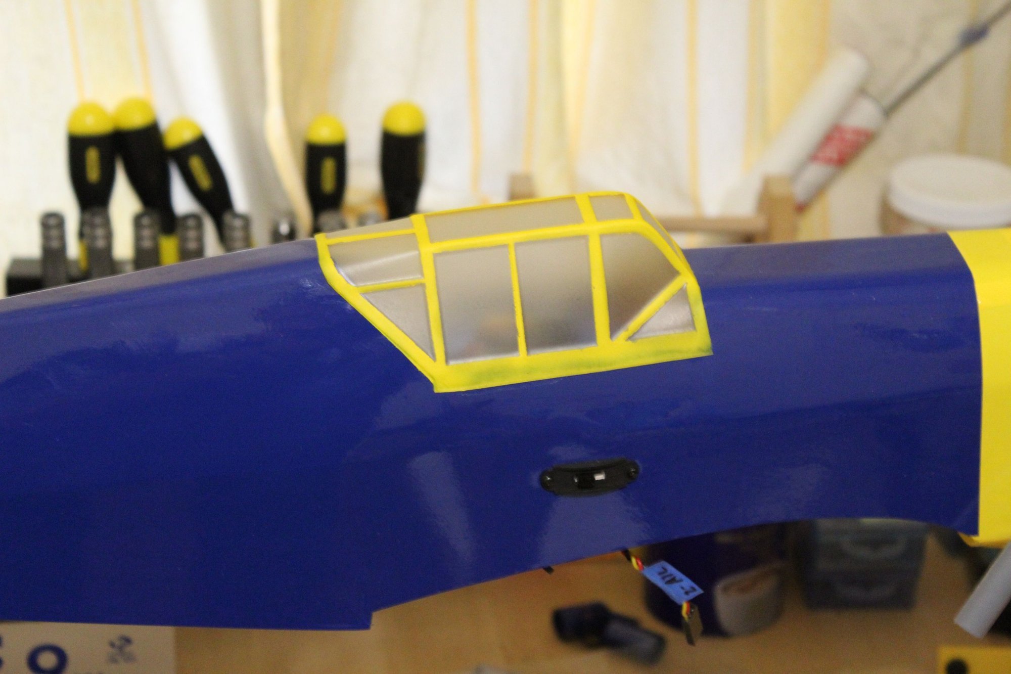

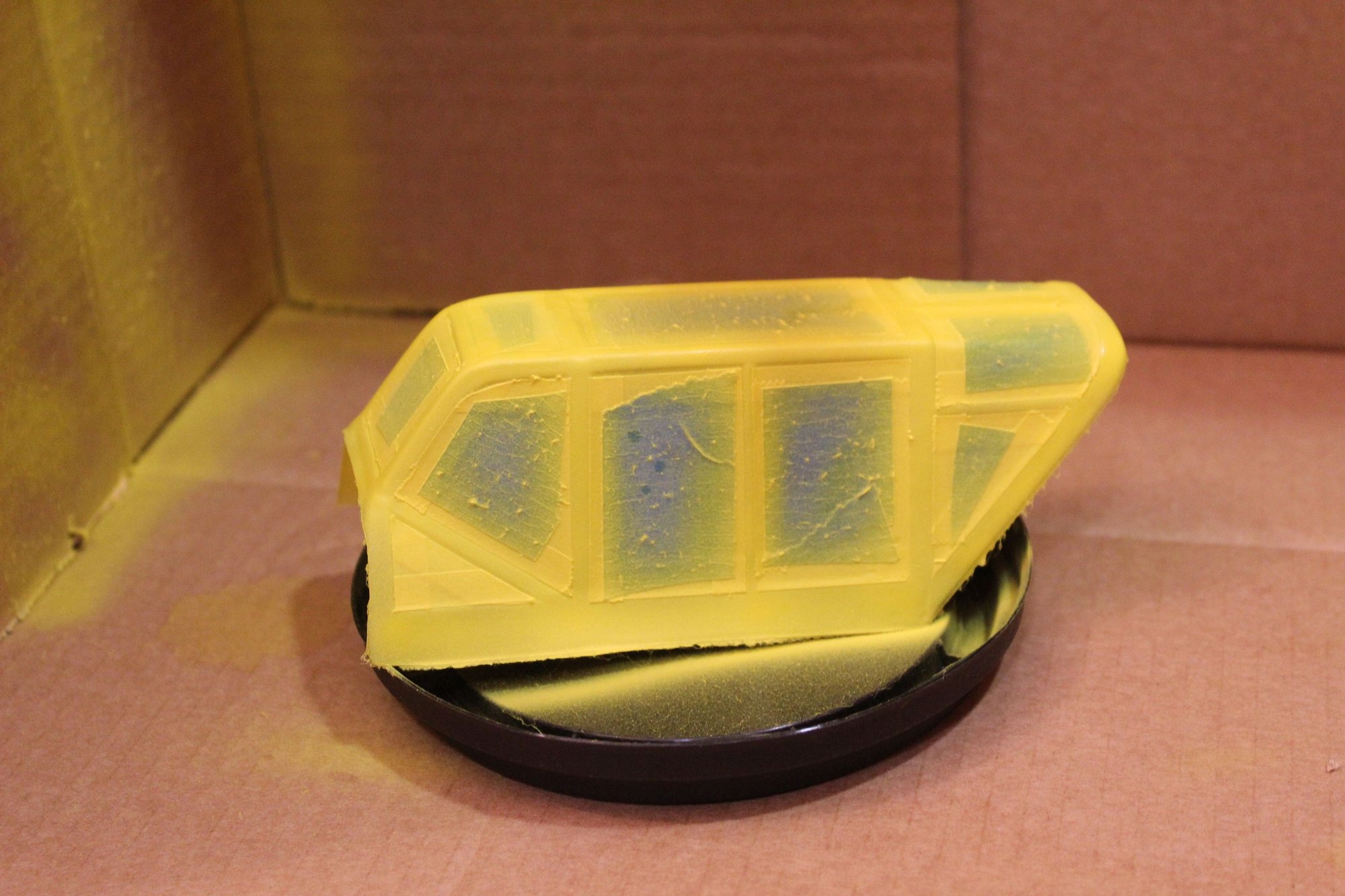

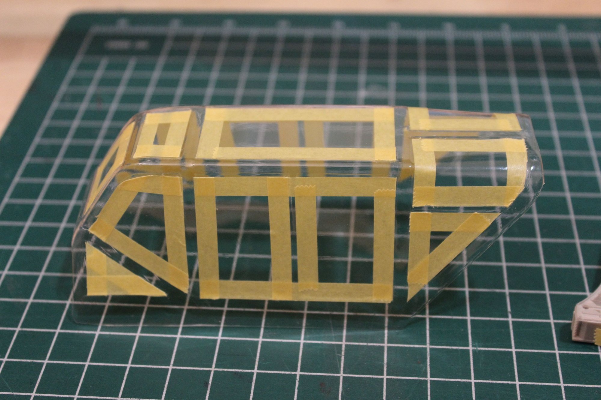

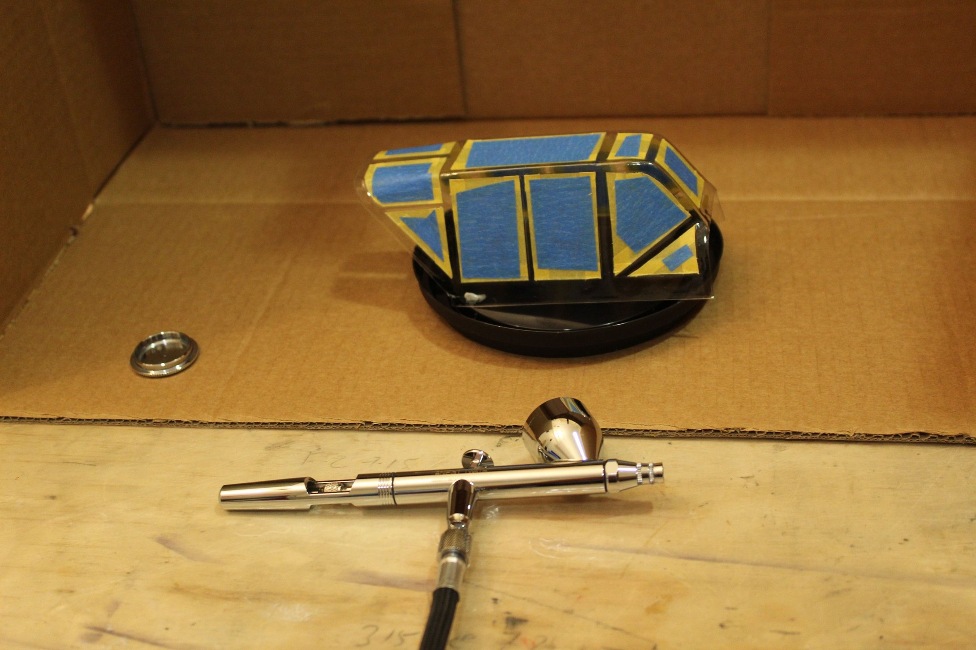

Canopy

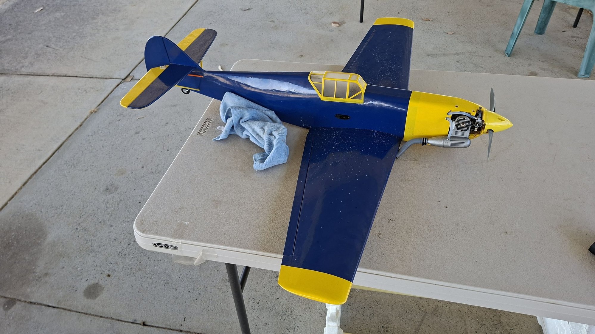

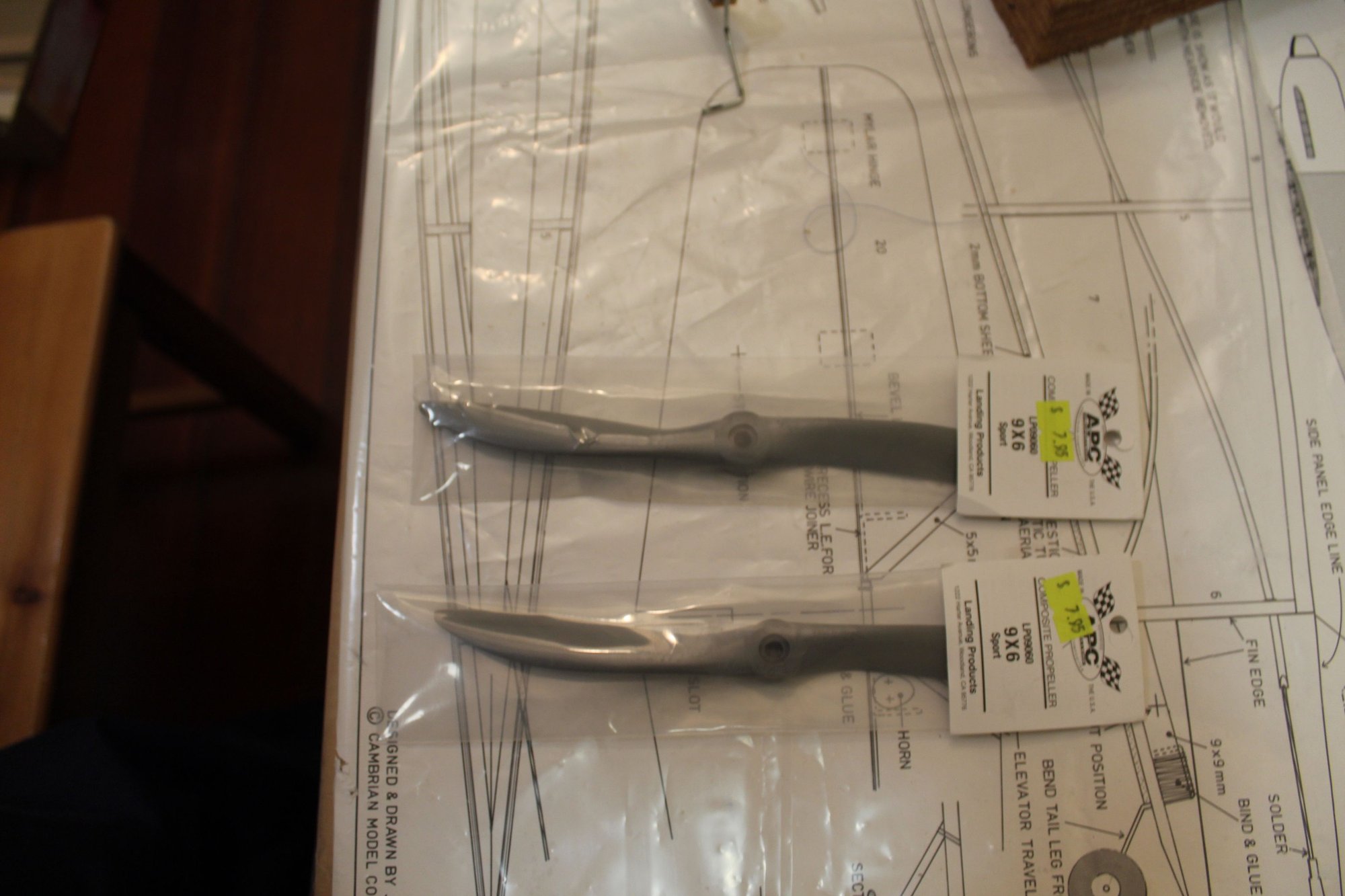

CG, prop and dirty at the airfield after maiden flight. It flew very well, the O.S. 25FSR and APC 9x6 prop provide plenty of power.

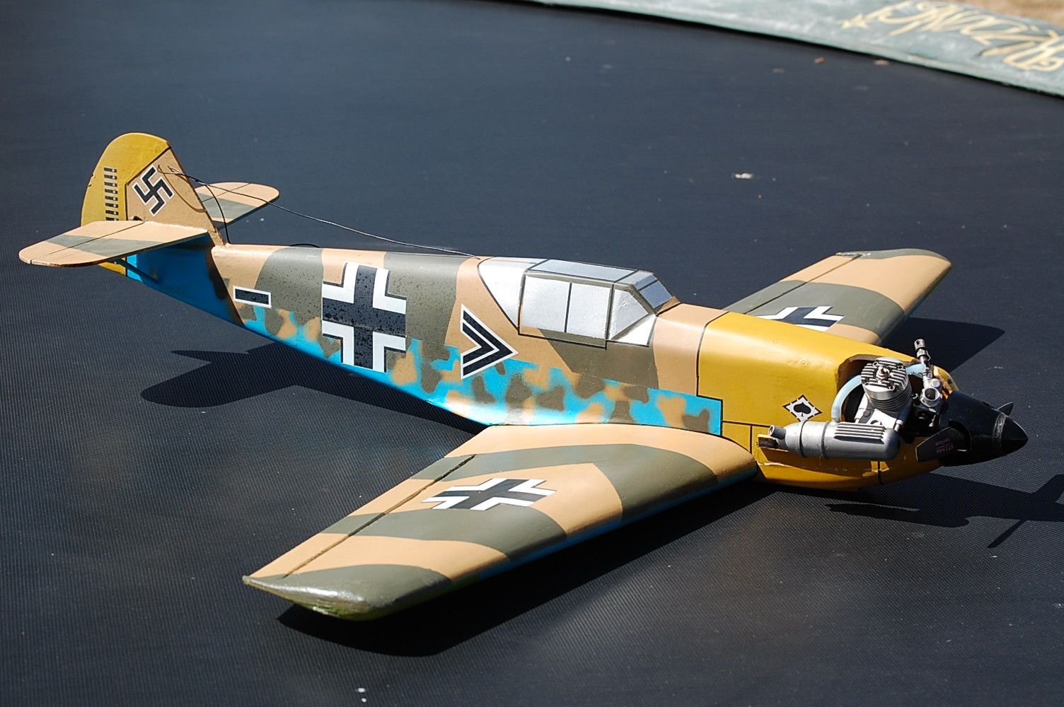

That sounds consistent with the way things are here in the US. 1/12 scale was pretty popular in the 1990's with scale combat. I never really got into competition but a lot of the planes were fun to fly. At first there was a lot of variety but it evolved to where the Ta-152 was the only competitive plane and people got bored or just moved to the other combat groups. I built this 109 about 20 years ago. It was pretty but was never successful due to engine issues.

Matt - It looks great. Do you remember which kit it was built from (if it wasn't scratch built)? Is it tissue covered and then painted?

It was built from a short kit from Lazerworks. It was a Tom Stryker design published in Model Airplane News in May 1992. Apparently there was also a kit from Progressive Miniature Aviation. It was glassed with lightweight fiberglass cloth and Kwik Poly and then painted with Top flite Lusterkote. Kwik Poly was a very low viscosity polyester resin. It only had a bout a 3 minute pot life but it would wick into the cloth very easily and spread very thinly without needing to squeegee or blot the resin. it was tough and very lightweight. The plastic canopy wasn't available at the time so I just built it up out of balsa. Sadly the guys who ran Laserworks and Kwik Poly both retired some years ago. They were both one man operations with no one to carry on. Lustercoat is no longer available. On the upside I see people using water base poly urethane over 3/4 oz fiberglass with good results and the plans are still available on Outerzone.
