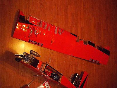

Honestly I would put the OS La 40 in there and nothing more. It's a great little engine and easy to get going. Pulls the airplane perfectly, and it will do more when you are ready. My bro has one in his.
Btw I crashed my Eagle today. Radio interference, or severe downdraft...not sure but I hit the tops of a tree. The fuse smashed in the woods 200 feet from the wing. The front of the wing lost all it's ribs or splintered the rest. But from the center spar back it was completely perfect. Very minimal rebuild for how hard it hit, and had to drop from the tall trees. The fuse, only the fin was badly damaged, and the gears ripped out (a problem already with eagles). But the fuse was in pretty damn good condition considering.
Needless to say, this thing is strong.
Could you clarify please?

I am not sure if this is still the case Maple. My kit when built was purchased over 10 years ago. However, where the front trike like wheels insert into the fuse is a flimsy design at best. There were two U shaped slotted pieces of ply that the gears inserted into on the sides of the fuse. They popped out of those things very easily as there was nothing to complete a 'box' around the gear rods that went up into the fuse. I had to take pieces of ply and glue two on the sides of the gear rods, then another larger one that created a box or block effect. Fortunately I didn't build them so strong that it ripped my fuse apart. It was enough to dampen the effect of a plane screaming toward the ground at 40mph as it ripped through brush and vines. Thus the reason why I am capable of repairing this thing in under 5 hours instead of having to rebuild it from scratch.

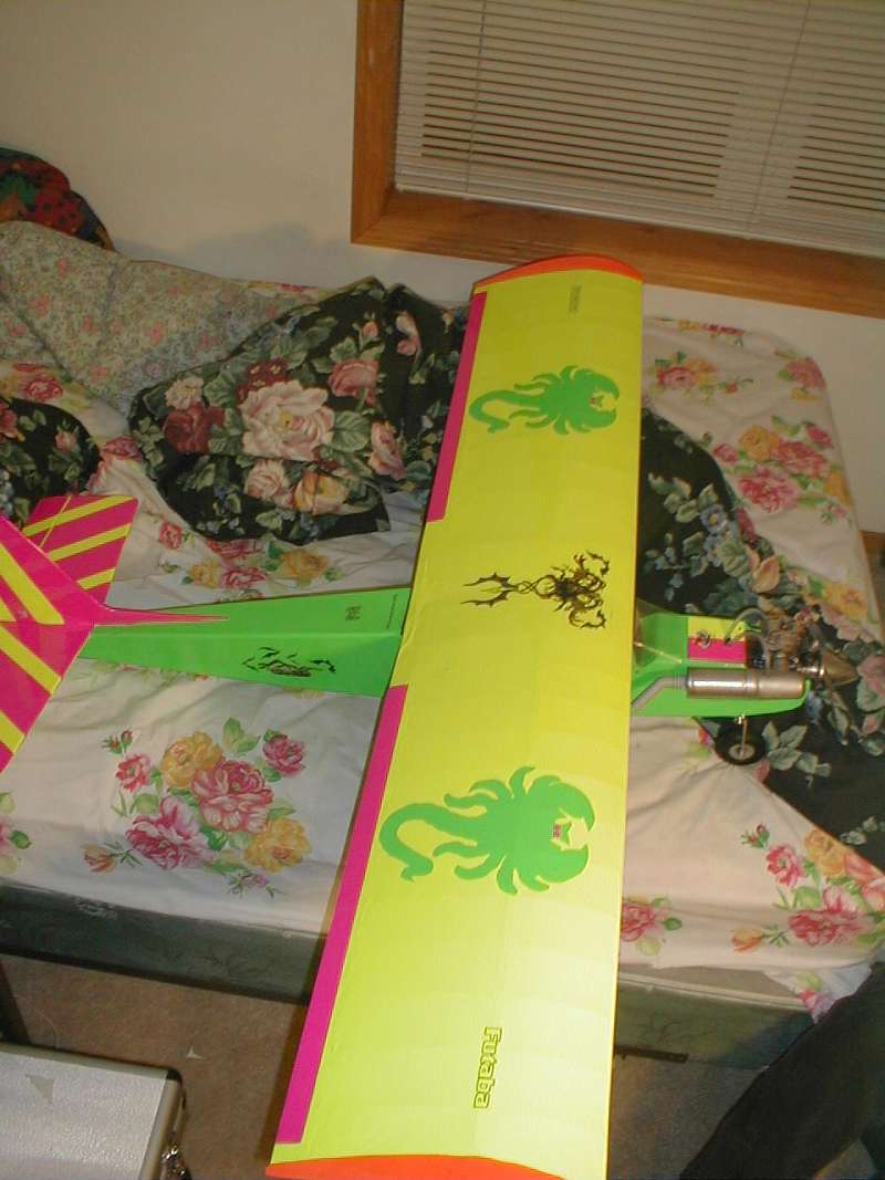

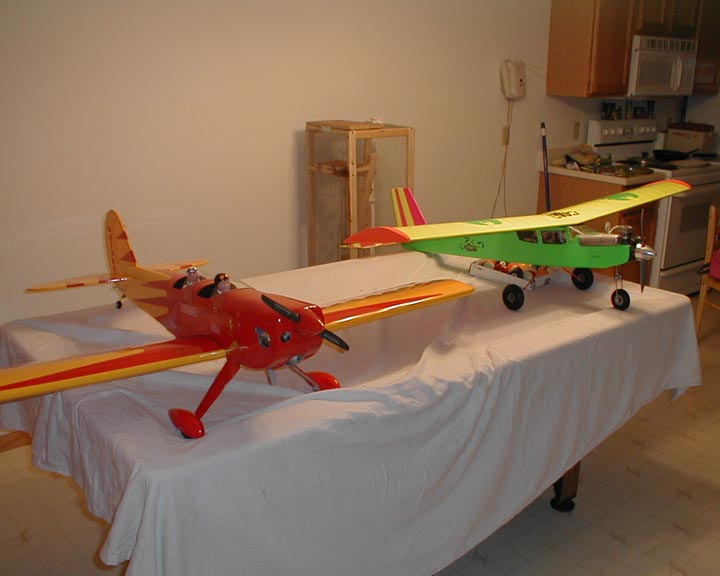

Hi all I just felt compelled to post a thread on the Eagle II. I purchased this airplane (which i believe is a eagle II) about 4 months ago including the servos, battery,reciever, engine,and futaba transmitter for $150. I learned to fly on this plane all by myself with the help of no instructor and very little previous experience besides flying a aerobird for 1 month. After flying for a couple months with the OS 40 engine I upgraded to aa ST 51 and it flew even better but the covering had been letting go everywhere on the airplane and it was in need of a new coating. The windows were beyond repair and needed replacing also. I had a hard time getting the fuel soaked airplane to accept any coating but after a week of fixing up I did manage to get it looking acceptable. I replaced the elevator with a larger one and also replaced the rudder since it was also warped. Color may be a little different than what was original but it is a little easier to see now.[8D]. I think this airplane is very eaasy to fly and is very strong, possibly because it is made from ply rather than balsa.
