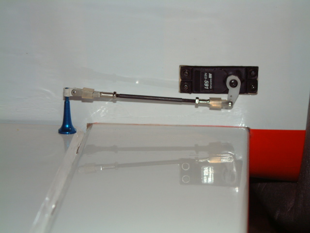

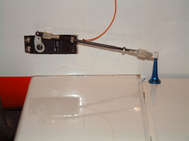

Hi im just finishing of a kangke cap 232 120 size
In the manuel it says install two servo for the elevators in the tail
I have got a spare 7 channel futaba receiver im going to use so I cant use channel 2 & 8 for the two servos so I have installed them with a Y lead so one of the elevators is working in reverse
in order to get them both working in the same sense you have to reverse one of the servo horns The only problem is the Geometry is now different from one side to the other and one elevator has more movement than the other
Any one know how to overcome this problem ?
many thanks
Geoff

A Y-harness WILL NOT allow you to adjust the servo travel. It only allows for centering adjustments. you will still get differential travel.
Either use your radio to mix it out or buy a JR Matchbox. You can also buy something similar to the Matchbox from Futaba. There is a cheaper version called an Equalizer. www.smart-fly.com
Make sure that your linkages are the exact same length. And mount the servos so that the center point of the output shaft is the same distance from the control horn on both sides.
I like to use H9 Pro Links on my elevators and ailerons. Kinda pricey, but perfect length and geometry every time. With the Pro Links- you get exactly matched lengths with both rods.

You can also cut another hole and mount the servo closer to the stab.

A reversing Y-harness simply won't work.
Here's why:
Servos don't travel the same amount in both directions. Any given servo- be it a high end coreless digital or a cheap analog servo-- will never travel the same amount in both sirections.
For example; a servo might travel 60degrees clockwise--but it will only travel 56degrees counterclockwise. This is a fact. It's a mechanical limitation of every servo. Don't know why- it just is.
So then, what happens when you reverse one servo is this:
Just an example-- play along for arguments sake:
The left elevator will travel up 1" and down 3/4". Reverse the right servo with a Y-harness and it will travel up 3/4" and down 1".
Since the servos are on opposite sides of the plane and one is reversed; they are effectively traveling at different amounts-- in opposite directions.
I've been through this. I tried to get this to work with a Reversing Y-harness one time. I messed with it for two weeks and never could get it just perfect. I got it really close, by messing with the linkages and lengths of rods and control horns-- but never perfect. By having one elevator side moving more than the other on an aerobatic plane--you wind up with a plane that flies like poop. Every time you pull back or push on the elevator-- the plane wants to corkscrew-- because one side is moving more than the other.
The best way to fix the problem is as I indicated in my original post. Mix it out with your computer radio, or get an Equalizer or a Matchbox or the device that Futaba sells to match servos. Only way to do it right.
Hope this helps.

Thanks for all your replies lads
I went down to our field today and some one more familiar with the mixing on a 9 CHP than me sorted it out
I thought u had to use channel 2 & 8 for two elevator servos but you dont
I have now used 2 and mixed it with 6 (flaps)
Thanks any way
