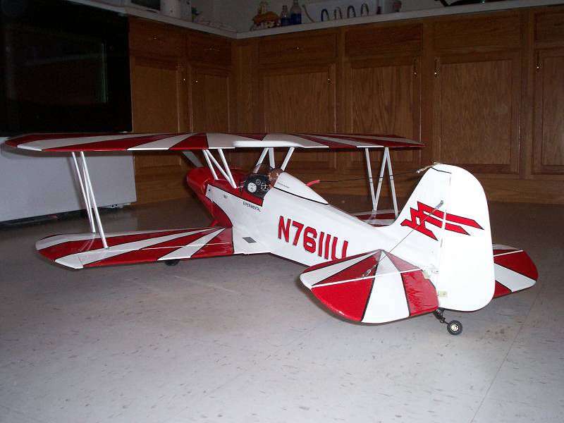

I think the OS.52 is a dog, but the .70 would be a LOT of torque to compensate for on take off. The miniplane is a ground-looping queen!!!
I use the Saito .56 GK (Close to the same displacement as the OS, but the power is far more acceptable.) and it has all the power I want. This plane is not 3D material, so I would never recommend that much power for this bird (the .70).
A pic with my motor!

Nice looking plane!
Did it come out tail heavy?

I have a ST .46 in mine and it's definitely not tail-heavy. The plane was most likely not designed with a four-stroke in mind.

Yes, it came out tail heavy. I had to put an ounce of lead in the nose. My first build balanced out perfectly-using the same set up. That was a first for me. I think the reason this one ended up tail heavy is because I scratched this airplane from the original plans of the first one I built. I changed the tail sufaces from being stick-built to solid balsa with some lightening holes. I wouldn't recommend the solid balsa choice, IMHO, building it the way the plans show is a stonger and lighter design. I also wouldn't recommend easy hinges on the horizontal. They caused a lot of flex on my first mini. I would recommend pinned hinges or hinge points if possible. I used pinned hinges on mine, but I prefer hinge points.
Did you know that you can order the plans and hardware from Sig? Plans building this airplane is not much different then building the kit, and probaly half the price of the kit-not that this kit is in anyway that spendy to begin with.
All the formers and ribs are printed on the plans. VERY nice. And then you can order aftermarket cowls and wheel pants that are top notch too.

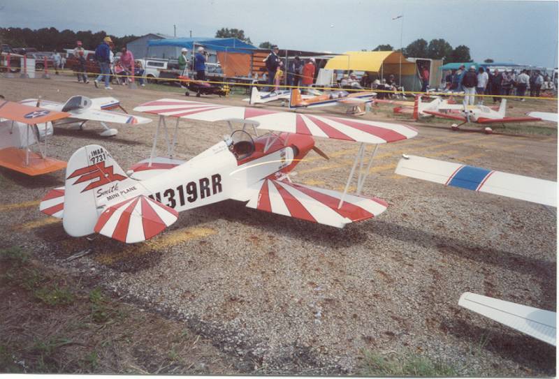

Here's a couple of pics of my long deceased 44% Smith MiniPlane. It was powered by a Sachs 5.2, Airtronics Championship 7 radio (am), was 88" wing span, weighed around 30 lbs if I remember all the details. Was sold and finally met its fate some years later somewhere in the Houston area. Have plans, wood and a fiberglass cowling aready for another after about a 15 year time lapse. Flew like a big Cub, lots of plane, but a really good flyer. Was scratch built by a fellow modeler and after changing hands several time, I got it and totally rebuilt and refurbished it.

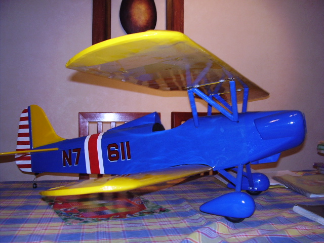

In december I started my Smith Mini Plane, it's almost ready but the construction is hard and I got a rest for it.

My Smith Miniplane flow well. It's finish.

Excellent job. Makes me want to build another one.
