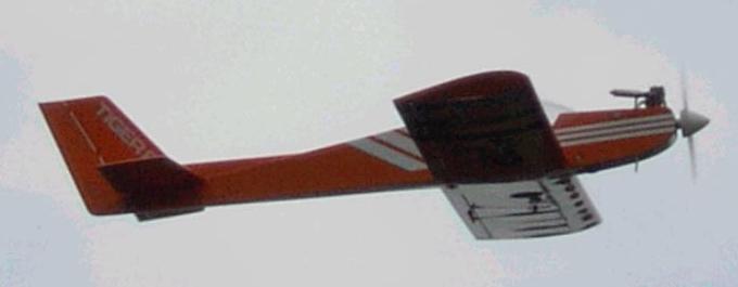

Old 03-06-2003 | 03:00 PM
Posts: 65
From: Denham Springs, LA
Default Starting a Tiger 60
I just finished triming out my Tiger 60. Hope to have it in the air very soon. Found no problems in the construction, just have patience and follow the directions.
