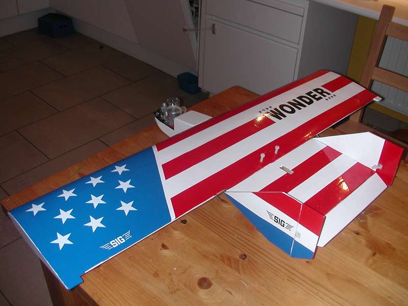

Time for my DV to arrive, because my curent project is in the very last phase of final assembly !!
another nice Bruce Tharpe design kited by SIG, I always have at least one wonder with me when I go to the field
isn't she sweet my last one ?
just need to install ailerons and the rudder sevo (it's a mod from original design) and go !
