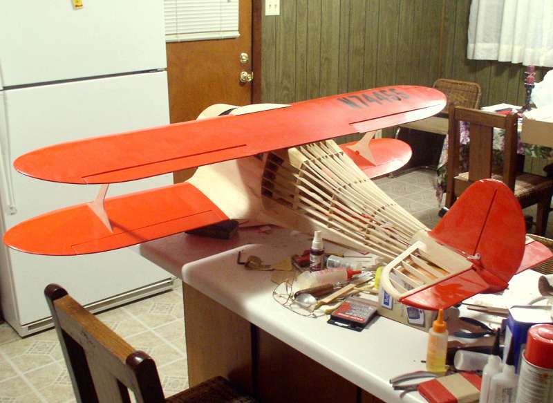

It's been a while since anyone posted on this thread. If fact it got me thinking about a Staggerwing and then I ran across a Royal kit for it. The tail feathers and the upper wing are finished and the kit really is like buying a tree and building a plane
The wing profile called for washout on a very narrow and tapered shape so I couldn't use my wing jig. Now some 40 hours later I have a pair of aileron servos installed and the top wing covered in Century 21 fabric. - Looking at it motivates me to keep the rest going. The bottom wing is next and I plan to install a set of retracts left over from a Hangar-9 P-51. They fit perfectly inside the thin wing airfoil and the wheels can be housed into the cockpit floor hidden under the interior details. Modifying the strut to a 3/16" diameter wire and adding the rear brace that the Staggerwing employs solves any drawbacks the gear had on the P-51 application. A Robart retractable tail wheel with a micro servo for actuation should add to the model while keeping the weight down. Want to bring it in under 10 lbs...
quint

Update on 2/9/2004
The plane is coming along; the retracts, radio and interior is in and now needs the engine, covering and cowl.
Just wanted to post a picture of the progress.
quint

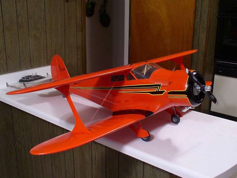

Finally got mine finished and flown. posted a picture but it didn't link so I'll make a new post for the pics.
quint
