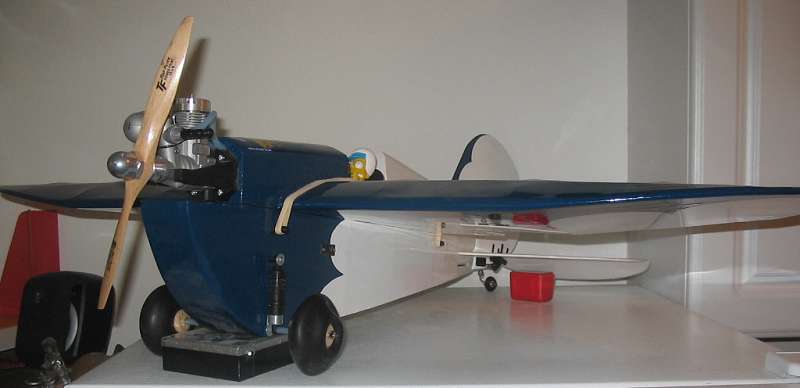

Oh yeah.....I love Speedy Bees!!!!! I am on my fourth one now. I have a gas one with an OS 26 on her and an eletric version powerd by an AXI 2820-10 brushless motor. The Speedy Bees are a lot of fun, but you do have to think light. I have done a lot of hitting hard in the past, I have pushed my Speedy Bees to the limits but I have never had the wing fold on me. Never break off the leading edge inside the engine nacelle to get the tank out.....if you do that....the wings will fold up for sure. That sounds scary!!!!! One thing I have found is inlaying a 3mm carbon fiber rod on the inside of the leading edge for strength. From the begining I never trusted the small leading edge. Another thing that I like to do is use the larger trexlers so i can use a lrger prop....and it also adds to the cartoon looking nature of this plane. Everone at my feild loves my Speedy Bees. ME too!!!!!!

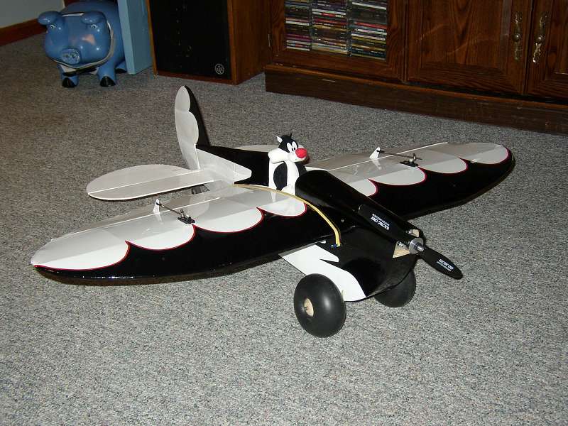

I lost my "Sylevester chasing Tweetie" Speedy Bee last week in a swamp. I have been out three times and can not find it. All I found was bad case of poison ivy. It is a real shame.....I this will be the last plane with an expensive brushless motor. I cant afford to replace it. HS 85MGs all the way around, Hitec 555 reciever, AXI 2820 brushless motor with 40 amp ESC and a ten cell CP1700 pack.....too much to list. Floating in the mud.....[:@] Oh well......I have to build something else now to take away the sting of loosing my favorite plane.
