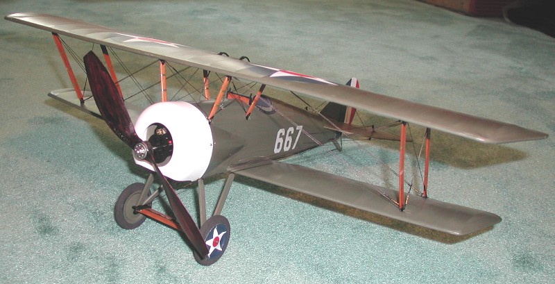

Never seen a Guillow's fly? You just haven't been around much then. Here's my Guillow's Thomas Morse S4C Scout. It's been flying for more than two years. 4 channel electric powered R/C, and weighs 8oz ready to fly. Used all the stock wood from the kit too.[8D]

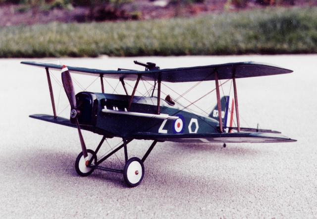

Here's another that I built about 4 years ago, SE5a. Still flys too. 24" span. Yes, used all the stock kitwood.

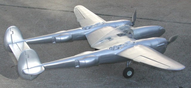

Here's my ill-fated 40" span Guillow's P-38 Lightning before final finish. Unfortunately it was lost on it's 3rd test flight due to spinning in after one of the motors cut out on takeoff.
This one was built from the stock kitwood and then sheeted. Could have been built much lighter but still flew well at 32oz. Had 5 channels, retractable gear, 6 servos, twin motors.

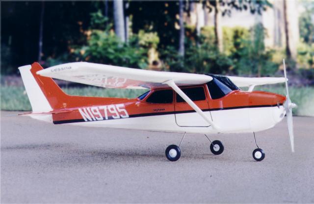

Guillows 36" Cessna 172. Speed 400 electric powered. Yeah, came in heavy at 18oz but I was a newbie back then at building for electric, this was my second electric plane (the first was the SE5a). It still flew great. Covered in monokote. 4 channel.

The Tommy uses a GWS IPS DXA motor, 8 cells of 370mAH NiMH, a Pixie 7 speed control, and 3 Cirrus CS10 servos. Prop is an APC 9x6 slowflyer clipped to about 8.5"
The Sopwith Camel is a bit bigger than the Tommy, closer to the Stearman in size, so it will need a bigger motor than the Scout.
I think they called those Joe Ott kits "Ott-O-Former" or something like that. I've never built one, got scared away by the promise of a very heavy model that would be very unlikely to ever fly. Now that would be amazing if someone really did get one of those to fly.
