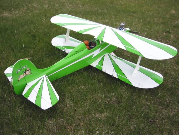

Wow, nobody's mentioned the Sig Hog-Bipe yet. Perfectly sized for a .91 4stroke! Covered in film it can come in under 8 lbs. easy and flys great at that weight. Easy take-offs and landings, gentle stall behavior. There's a broad range of performance controlled by c.g. placement and control throws. It's not a precision aerobat like a pattern plane or a 3D plane in stock form, but is capable of any traditional aerobatic manuevers and looks great doing them!
If you're comfortable with a high-powered, low wing, aerobatic monoplane you shouldn't have trouble flying the Hog. Maybe have someone more experienced give it a test flight and even get on the trainer cord for a flight or two. While it's not tricky to fly, it's fairly fast and responsive, rolls quickly, and has no self-correction behavior. In short, it might be hard to "stay in front of it" for a couple of flights.
The kit has all ply parts laser-cut and balsa parts nicely die-cut. Typically excellent Sig wood quality. I don't think a biplane can be designed simpler or easier to build. Instructions and plans are very complete, clear, and helpful.
I recommend moving the main gear forward maybe 3/4 in. for easier ground handling especially on grass without nosing over. Also, with a heavy .91 4stroke like a Thunder Tiger, I think you can shorten the nose about 1/2 in. It's designed for a light .60 2stroke.
Check out [link=http://www.fubarhill.com]fubar hill[/link] for many pics, mods, and tips on the Hog-Bipe!
Please look at my Hogs at [link=http://www.ida.net/users/paulbrab]www.ida.net/users/paulbrab[/link]
Join the cult of the Big Sig Pig!

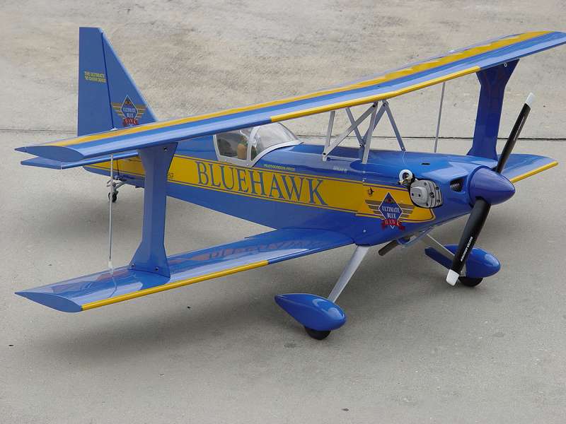

Rick, the Goldberg Ultimate flies fine with a 91 four-banger. I know of one with an OS 91 (not the Surpass, the original, which was not exactly a powerhouse), that does mild aerobatics quite well. You do want to keep it as light as possible, but that is true with any airplane. All this so-called "3D" business is fine for those who enjoy it, but the CG Ultimate is one of the best-flying models I've owned. I built the kit 12 years ago, with an OS 120, and am flying the ARF now with a Laser 150. Both are way over-powered at full throttle, for "normal" flying.
Just be sure to use two aileron servos. The kit provides hardware (bellcranks, etc.) for a single aileron servo driving four alierons. Not the best arrangement.

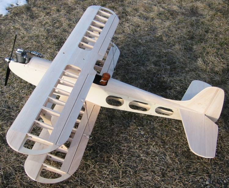

I built a Balsa USA Phaeton II last year, and I have a Hog Bike just about ready to cover. My Phaeton II flys beautifully with a Saito 80 up front. It is easy to takeoff and land on a paved runway and it looks great in the air. I couldn't be more pleased with it's flying. Obviously I can't comment on the Hog's flight yet but will try to have a flight report this spring.
I will comment on the kits and some differences in building.
Neither kit would be suitable for an inexperienced builder. Both kits have clean die cut parts and the Hog has laser cut plywood parts. The choice of wood in both kits was excellent, with only minor substitutions. On the Phaeton II the cabane, and interplane struts are formed wire and require some accurate wrapping and soldering to assemble. I made a jig to hold the pieces in place for soldering, and don't believe I could have done the job without it. It is a complex assembly and any slop will make the rigging of the wings almost impossible. Once everything is assembled and rigged, it is a strong structure. Assembly at the field is not bad if you have four hands available but with only two it is a pain. I made a cradle to fit the bed of my truck and transport it assembled.
The Hog Bipe has an entirely different approach to mounting the wings. Two preformed aluminum struts form the superstructure to support the upper wing, and with a little care, can be installed accurately with little fuss. The interplane struts are plywood and are attached with three bolts each. If everything is accurately done they should fit. It doesn't take much to cause problems. My first fit up just wouldn't quite line up and after some suitable words, I had to plug one of the mounting holes in the upper wing, and redrill it about 1/16 inch over. If everything doesn't fall into place, any forcing will result in a warp of the wing. Once everything is right, it should be relatively easy to assemble at the field. Plug in the aileron lead, bolt the wings in place and attach the interplane struts. I'm guessing ten minutes at most.
Other than the wing supports, the remaining parts are conventional balsa and lite ply construction, and other than a higher parts count should go as well as most monoplane kits.
Based on several suggestions from other builders, I did move the main landing gear forward about 3/4 inch. I don't know if it will help but it looks better.
