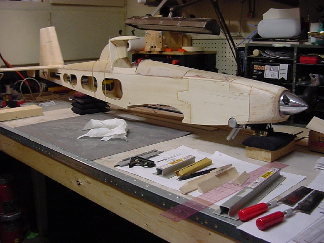

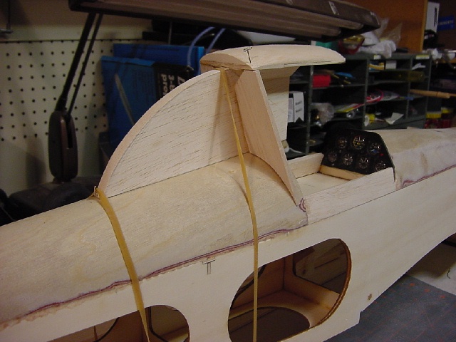

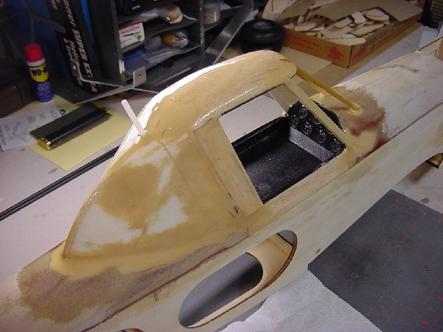

Well, I started by getting 4 pieces of styrofoam shaped to fit and match the turtle deck (That was fun
). After ordering a hot wire cutter (which was a little to narrow), I managed to get the glued blocks all whittled down to where I could start a final sanding. I think I managed to get it all to run into each other pretty seamlessly. I then started filling in some small seams with filler and the interface between the cockpit and turtle deck. I finally got a very nice seamless roll into each other. I then fit in the front window braces, and yes, I cut a seat with headrest to mount. Just need to sneak in and get some of my wifes different colored hobby paints
Since there is no structural strength in this, I opted to now use and fiberglass and simply put on a thin coat of 30 minute epoxy. I was worried about things sticking to the filler. I still haven't decided whether to MonoKote the cockpit or paint it.
I guess I also got the top curve on the Vert Stab and Rudder about where I wanted them also this week.
Next will be adding the three piece cockpit window to the front. First trial fit of the original 120 canopy shows that I hope I can cut out the windows in one piece and wrap it around the braces. With a little of the black canopy edge trip it should look all right.
I like the profile I have. It's as close as I'm going to get to the real thing for now on this kit.
Well, what do you think........ Am I just building a lead sled ?? I never planned on this being a 3D plane
, but I hope it at least flys scale.

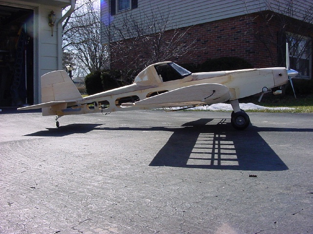

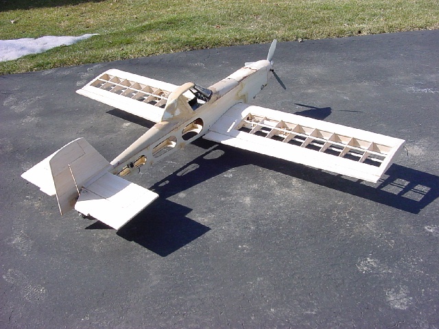

Hi All - Well it's been a slow 2 weeks of building. Played hooky last weekend with a trip to Cleveland for a Rodeo (Yes, thats my Wyoming Native side kicking in
) only got a few hours a night of building for awhile. These will be the last pictures I'll post until it's covered, I'm getting into some of the smaller detail work now and I won't bore you with all of it. I had to do a dry fit of everything today, so I thought it would be another chance for a photo op.
Our Club's Mall show is next weekend in Findlay, and so I am going to take it in the bones so folks can see what's actually under all of that pretty covering they always see
I'm sure it should create some interesting questions.....
Well here are four shots of it just sitting out in the driveway.
GUESS WHAT - IT WAS 56 TODAY WITH LIGHT WIND BUT, WE HAD OUR CLUB AUCTION TODAY, SO NO FLYING[
] BUT FIRST FLY TOMORROW

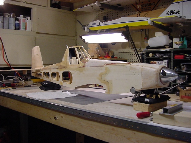

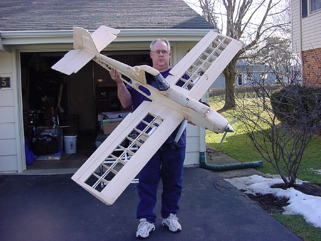

Since the Saito 150 is inverted, I didn't want to try and fish around with the glow starter every time I wanted to fire it up. I got one of those remote glow plug extensions. I built a box for it, mounted it, and then fit the box up under the front fuselage so I hope it sort of looks like the slurry/water hatch used for filling the tank. Please excuse the sloppy extra black paint, I'll get that covered later. AirTractor's also run an awesome turbo charged engine and have these huge dry stacks coming out the side of the cowl. I got a couple of 45 degree brass fittings, took the propane torch and did a heat treatment on them so they kind of have that heated oil slick metal kind of look (if you know what I mean).
The last shot is just me and my ugly mug to give you a size comparison if you don't happen to know much about the SIG 4 Star 120. Wings have ended up 83.5".
Well like I said in last reply, next pics I hope are of it covered and ready to go...........

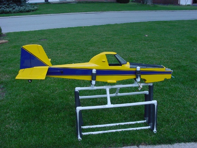

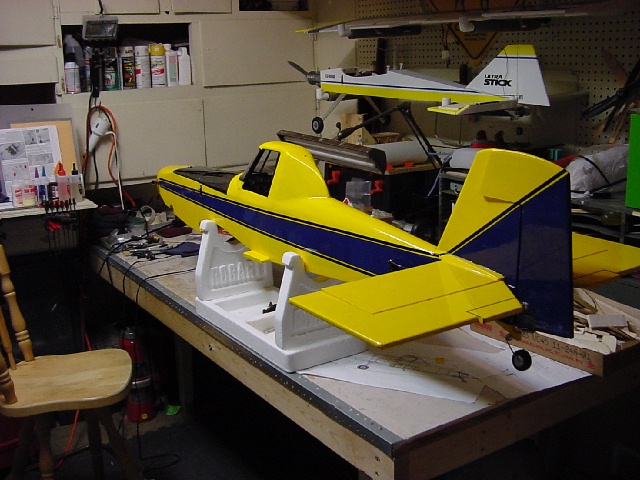

Hi All - Well, I have the bulk of the covering on the fuselage, so I thought I'd share 4 quick shots. Stayed with the traditional color scheme from AirTractor so far. I think the ends of the elevators will receive some treatment. Trying to think of some type of slurry bomber, forest fire fighting type decals. I haven't started covering the wing yet because I've decided to rebuild the ailerons and flaps. The 4 Star's taper out to the end where as the AirTractors are same width from inboard to outboard. I'll see after I get them done.
Next shots hopefully will be with wing attached, engine mounted, and everything balanced and ready to go
Later All - Thanks again for the compliments............

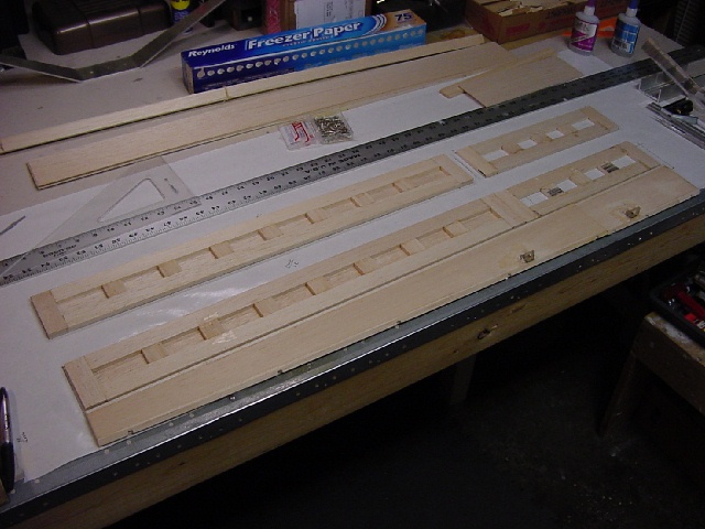

Well - I got the new stick frame Flaps and Aileron's built. 3/8th x 1" for LE and TE and covered with 1/16th. Added the 1/2" tri-stock to LE and sanded down flush with sheeting. The full size AirTractor's flaps and ailerons have no taper from inboard to outboard end, so I decided to see what it would look like. I now have the flaps at exactly 12" by 3.5" instead of what I had started to call my 'Token Flaps', which were only 9" long. That leaves the Aileron's at 28" long each. I went from 6oz with all of the originals to 9 oz's with these. I think they look better then the tapered. What do you all think?? I also have the SlimLine muffler headed in for repair, hopefully back before I know it

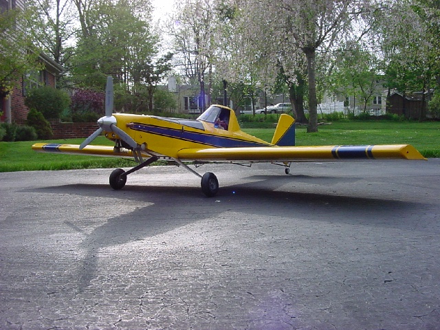

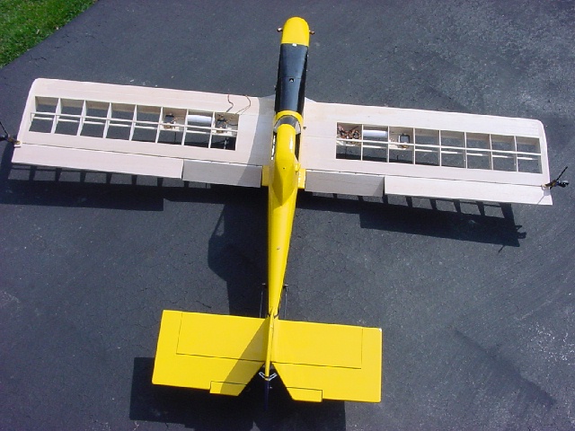

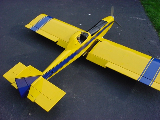

Well - Believe it or not everyone - it's 99% complete
Hi Jim J - That is a pretty cool kit bash of the racer. I really like how you formed the top air intake. Let me know how it fly's with the gasser in it.
Thanks Scale Dreamer - Glad you've enjoyed this thread, I've had a lot of fun doing this build. I think you should be able to do something similar with the 40. The real AirTractor has some dihedral in the wings so I left it all in mine as well. I knew I was adding weight and I didn't want to take the chance of it getting to squirrelly. I also left the wing full length because I wanted all the lift I could get. This is for flying scale, not 3D, although I've seen the cropdusters do some pretty amazing aerobatics at times
We've all been wondering and asking about the final weight - well according to my new digital fish scale it came in at 15 lbs 4 oz's. Which is 3 lbs over.
The reason I say it's 99% complete is I have to do the permanent Rx install and CG. Hopefully I can move things around to accomplish that.
I also need to come up with some cool final graphics and numbers that will fit, and be worthy of the slurry bomber role
