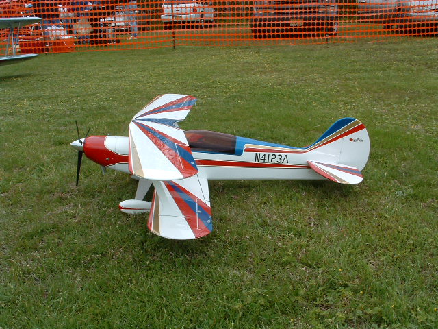

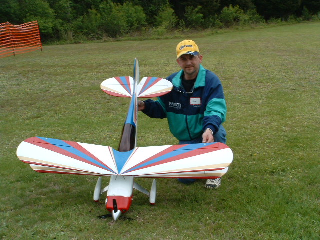

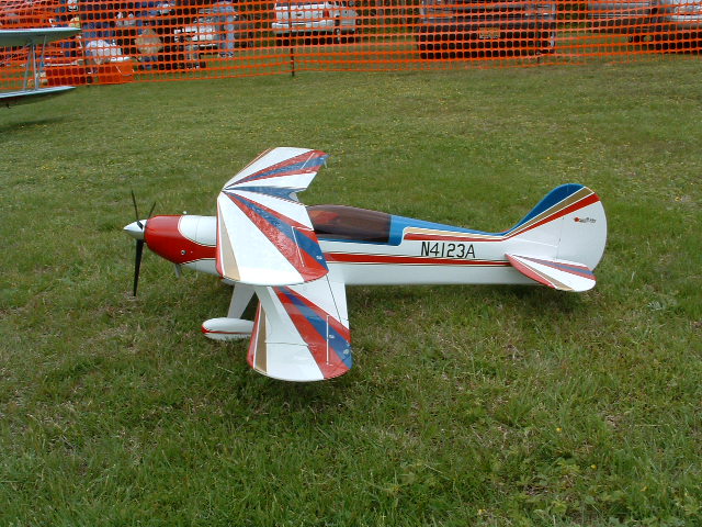

The GP Skybolt is a fantastic looking bipe. Its a little tricky to build, but I had a lot of fun building it. The instructions are detailed and the wood it great. The most fun I had with the kit was covering it. Not as hard as it looked.
Mine has a OS 91FX and flies unlimited with that combo. I think a 60 size would have been plenty.

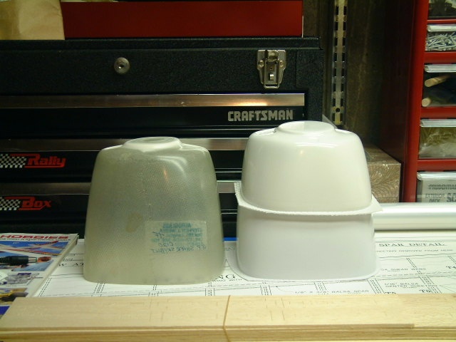

I purchased an Aeroglass fiberglass cowl for my Great Planes Skybolt. Very nice when compared with the two piece ABS kit cowl. I bought it from Dave at www.Quantummodels.com here's the link: http://www2.mailordercentral.com/qua...item=1&mitem=1
And a pic of it next to the kit ABS one.
ID:	99706   Click image for larger version
Old 02-12-2004 | 02:34 PM
LQUAN's Avatar
My Feedback: (17)
Posts: 337
From: El Monte, CA
Default RE: Super Skybolt Bipe
Hello,
I've made a mistake by waisting time on the ABS cowl that came with the GP Super Skybolt kit. With an OS91FS, the cowl only lasted 8 flights. The vibration cracked the cowl in several places, especially at the mounting holes. I planned to CA some light fiberglass at the mounting holes to reinforce but there is no room. I've made the fuselage fit snuggly to the cowl. Believe it or not the ABS cowl came out heavier than the Aeroglass cowl. Because the top half of the ABS cowl is slight smaller than the bottom half, I ended up patching the top half with automotive bondo to make it even with the bottom half. Also, the Monokote matching paint by Top Flite made the ABS even more brittle. The nice thing about the ABS cowl is that the built-in thrust angle is perfect. The built-in thrust angle on the Aeroglass cowl is not all that perfect - leave an uneven gap between the cowl and the back plate of the spinner. This is small imperfection that I can live with. But overall I must say Aeroglass builds the best fiberglass cowl I have ever seen. For the price and durability on Aeroglass cowl, I will never touch the ABS cowl again! I also have ordered Aeroglass cowl for my Top Flite P-40E and P-47D yet to be built.
