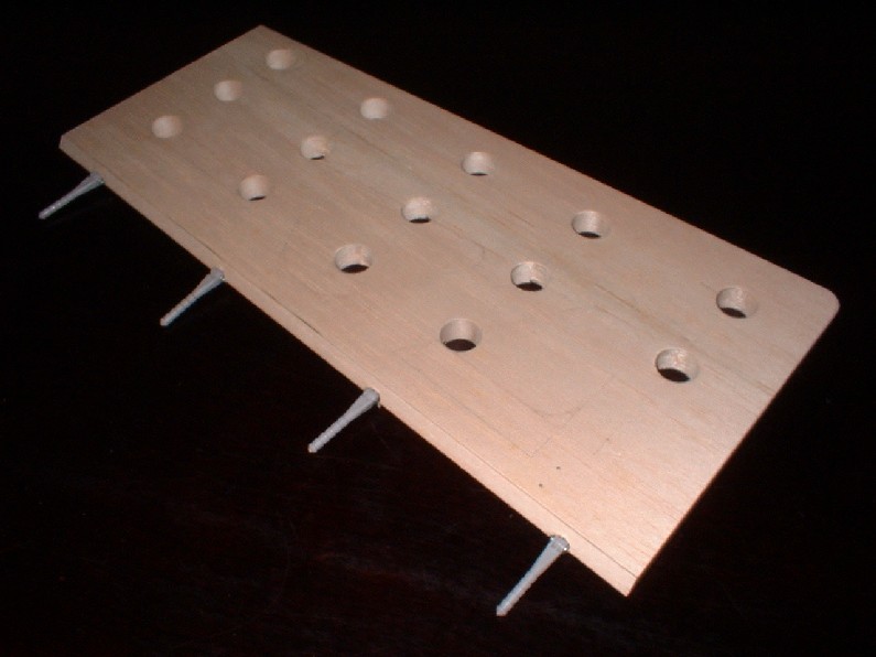

ROFLMAO ! Well I am taking some time off now figuring where to put the lightening holes in my new 1.5-inch-longer rudder for my 4*60. I had a longer "time off" thinking why I didn't modify the original rudder the first time around, having to rehinge the whole ?!@# thing all over again
. Hoping for a better knife edge performance

I am glad I did this mod ! The 4*60 knife edges effortlessly at 1/2 throttle (61fx). It pulls a little towards the belly, but a little up elevator fixes it. I also noticed more crabbing in crosswinds, but that is expected with the larger rudder area. Very pleased with the results
